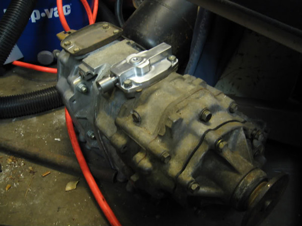

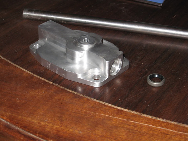

In Patch the second lever would have come up right thru the only cup holder in the cab. A cup holder that I used a lot since I tend to drive long distances. I designed my own shifter cap and a friend with a CNC made it for me. The parts that are incomplete are the pieces that make up the really long shifter rail for the 2-4 shift, and all of the air cylinder bracketry.
Ah-hah! I do have some pics of the cap:
Pretty slick. I think making my own would be a fun project. It would take a while for an amateur with a manual 1948 mill (no DRO) and I really would like to get moving on this build.
I'll get a pic of the bottom of my shifter. There has to be pins or set screws under the sealer. Maybe whatever is under it allows the shafts to slide outward enough to get to a recessed screw on the ends of the inner levers?? Splined or press fit? The inner levers are butted against each other and they're not that thick.
It would definitely suck if they were able to come loose and fall into the case.
Yeah, I was dreading making it manually on a step head Bridgeport, also with no DRO. Then Jack said "You've got a CAD model of it right? I can whittle it out on the Millicron 10 pretty fast since I mounted a mill vise on one of the tombstones." Talk about using a sledge for a flyswatter.....
I was thinking to use a roll pin for the shifter finger with a loop of Ø .020" safety wire down the center of it to keep it from falling in should it come loose.

@gnob, I agree that it's probably a screw holding a pin maybe. I still don't know how the end pieces inside are secured to the shaft to be able to pull the shafts out.
No pin or screw visible in the sides of the fingers way up at the shaft center-line by laying the fingers over as far as they'll go? I was thinking grub screws too, but that requires a hub feature that there is no way to install in the housing.

Regarding the inside levers on the shifter base. I can not see any pins or set screws down inside.
Maybe the end of the shaft is shaped and a press fit into the lever and pinned under the epoxy to prevent the shaft from walking out??

I got the triple shifters finished up. Tighter, smoother and painted.

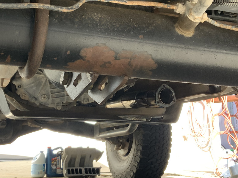

Tomorrow my plan is to pull the tires and drop it on the bumps, as low as possible in the garage so I can put the bed on to look at fuel tank mounting options. And where to put my tailpipe.

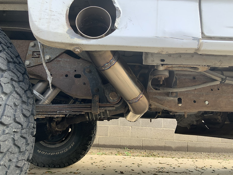

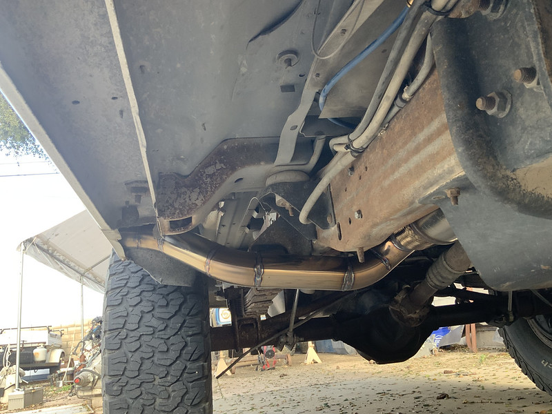

A couple pics for inspiration or thought re: exhaust, this is my current project (not a crawler, a go faster mo betta in the desert) and that is a 3" tube, pics are in the build process - needs a little tweaking:
Hole in the 1/4 was put in by the PO so I had to either fix it or use it. FWTIW anyway....
That 3" stainless is tucked in pretty tight. Mine is definitely low buck comparatively. That through the side tailpipe location was my first thought until @gnob mentioned the noise factor. Still a possibility IF I put a fuel tank behind the axle.
It is tight to just about everything. Without well placed supports it will rattle on the frame and I still need to make a heat-shield for that spring-eye bushing. True, it is on the passenger side, but I only ever notice the exhaust note when driving next to some Jersey Wall. Truck does have two cats stock and when I bought it there was no muffler at all. Should have been obnoxious sounding, but it wasn't. I added the small muffler when I increased the post-cat tube size to 3" fearing that such a move would make it louder.
