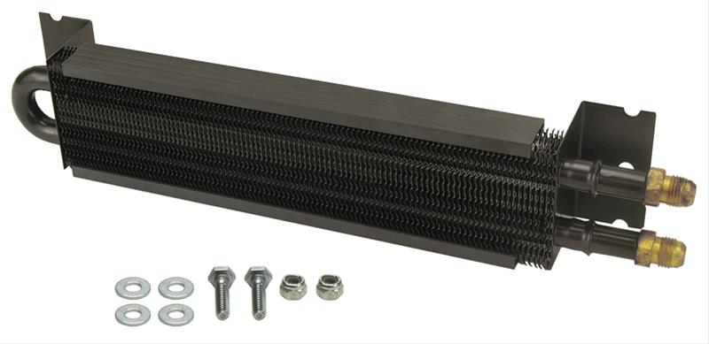

I plan to use one of these (they are available in a couple different lengths) for the PS cooler on the Wagoneer. I'll likely place it on the inner face of the frame rail somewhere in front of the engine mount.

I liked that PS cooler because it had the inlet and outlet right next to each other. Makes plumbing and mounting it simpler. I forgot that you're running a ram though. That's not enough cooler for a system like that. I've used OEM aux trans coolers from the JY for heavier duty PS coolers. Mid 80's to late 90's Ford F-250's and 350's are my favorites to source from. GM's tend to have a proprietary fitting that's a PITA.
