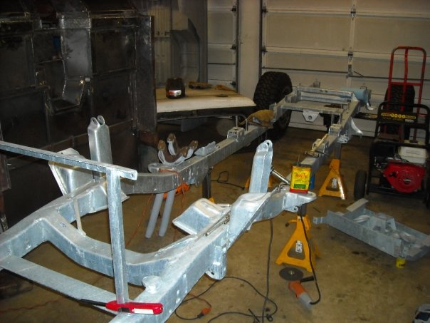

Ok, time for an update. I finished all the welding that needed to be done for now. I'm sure I'll be adding brackets and various items to the frame as needed later.
I managed to move the frame out of the garage, down the scary sloped driveway and under my tree so I could degrease, scrub and pressure wash the heck out of it.
I managed to get it back up into the garage with a floor jack, engine crane and my 52 Ford.
I hit the frame with a DA sander, 1/4 sheet palm sander, and whatever air sanding tools I had to get rid of the mill scale, surface rust and old paint.
Welded any links that were still just tacked and prepped them for paint as well.
I have a very short window to paint in these temps. "Supposed" to be under 90 degrees but it's been 93 in the morning in my garage. After I mix in the hardener things happen fast and I'm painting with a brush. I could only mix up 4 oz at a time and do it twice before it was just too hot.
That let me get the bottom painted and all the nooks and crannies of the link brackets and such.
Flipped it over a couple days later and did most of the top side. Ran out of paint. I ordered more because I couldn't find any in town. Was supposed to be here next day but got lost in shipping. 🤬
Anyway, finished the frame today. I still need to paint the links. Hopefully tomorrow.

It's Rust-oleum Hammered Gray. Its just lumpy looking if you spray it on. But it looks like galvanized when you brush it on. Same stuff I used on my axle.

The texture isn't as rough as it looks. It's pretty smooth and glossy. It should be pretty easy to clean off.

Well I was actually able to paint the entire afternoon because there's clouds and the temp stayed in the 90's. Got it DONE. I'll give it a couple days to harden up and start putting it back together. Yes I actually painted something black. The steering shaft.

Sitting pretty tall with no weight on it. Shocks are fully extended. Good height for me to maybe run lines and such. Exhaust is easy access right now.
Tomorrow I'm hoping to get the engine, trans and T- cases set in.
I need to take the steering box apart so I can drill a port in a better location for the power assist. Maybe if all goes well I can install it.
Here's a couple pics. That's not rust on the front section of the frame. Setting sun hitting it.
Got it all in. Gave it a quick bath with some orange citrus degreaser and the hose. Had a lot of grunge from oil spilled on it and Arizona dust.
