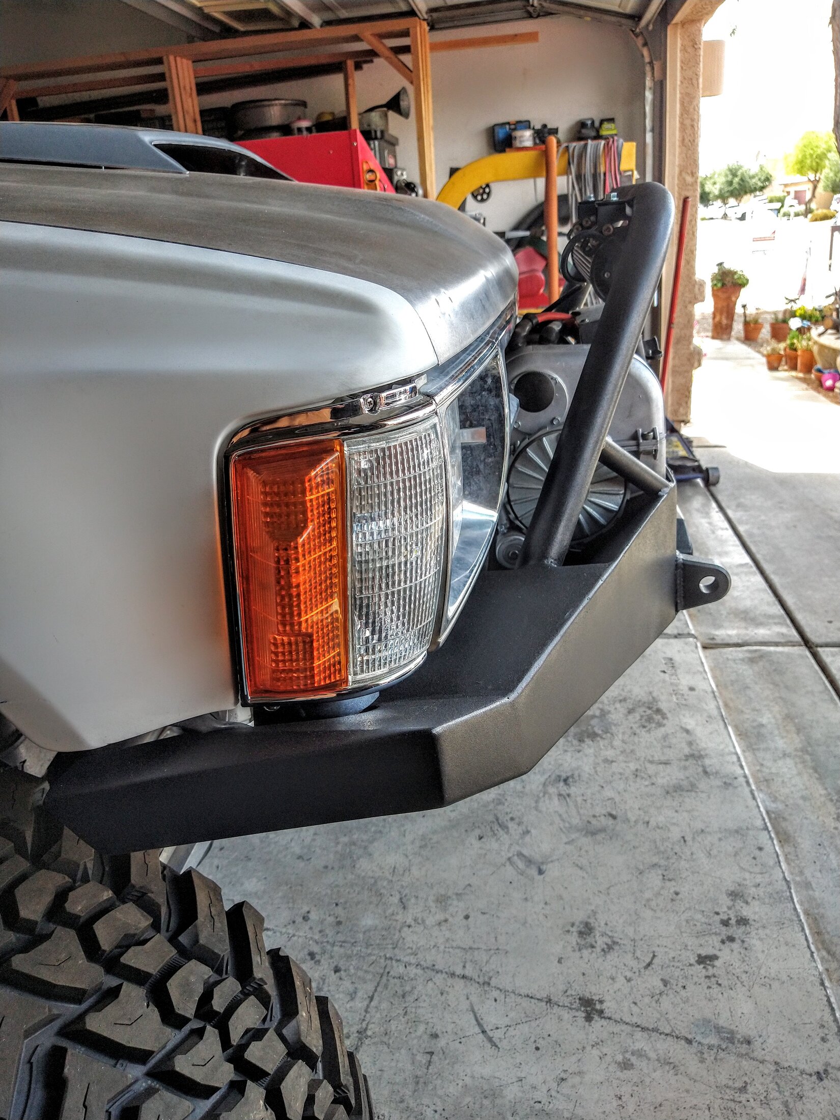

I'm still waiting for some electrical items to get here so I finished my bumper........FINALLY. I like the way it looks but it's a heavy sucker. 102# so I'm not really liking that fact. I see a few areas where I can trim some fat to save a few pounds but this is what I'm running until I maybe come up with an aluminum version or a tube bumper.
I have to remember to clean off the mill scale BEFORE I start building things. I used phosphoric acid to get it all off.
I don’t think 100lbs is bad for a needed piece of armor.
