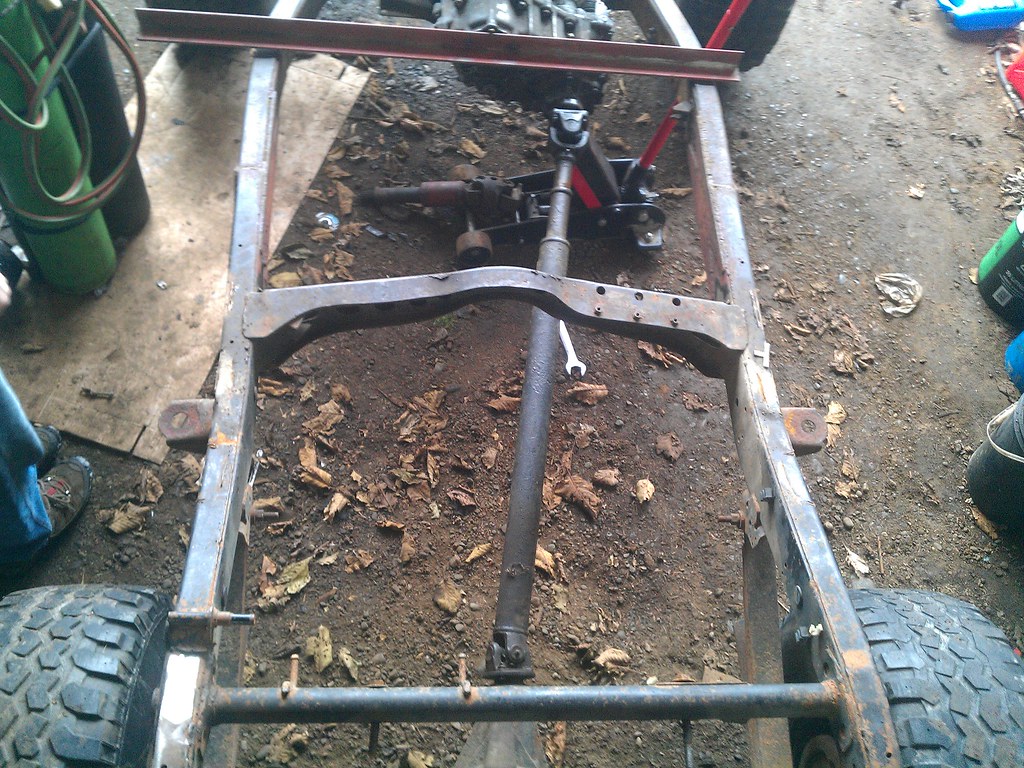

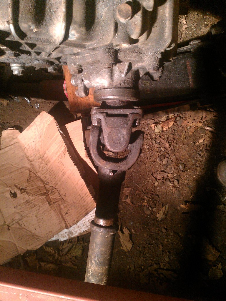

I'm using the lc offset t case and regular center toyota axle. QUOTE]
Keep me posted on this. I am REALLY interested to see if this works, if you have u-joint problems, vibrations, etc. or if it works just fine.
I am just the opposite. I have a Pickup transfercase and would like to put the FJ60 off-set rear in my project but am not sure if there would be any drive line problems. Most folks say don't do it. It would be a street truck with minimal lift, all highway miles on mine.
Keep me posted on this. Thanks.
It really only takes a tiny amount of driveline binding to destroy a transfer case. With those angles, you're signing up for trouble. I would be careful.

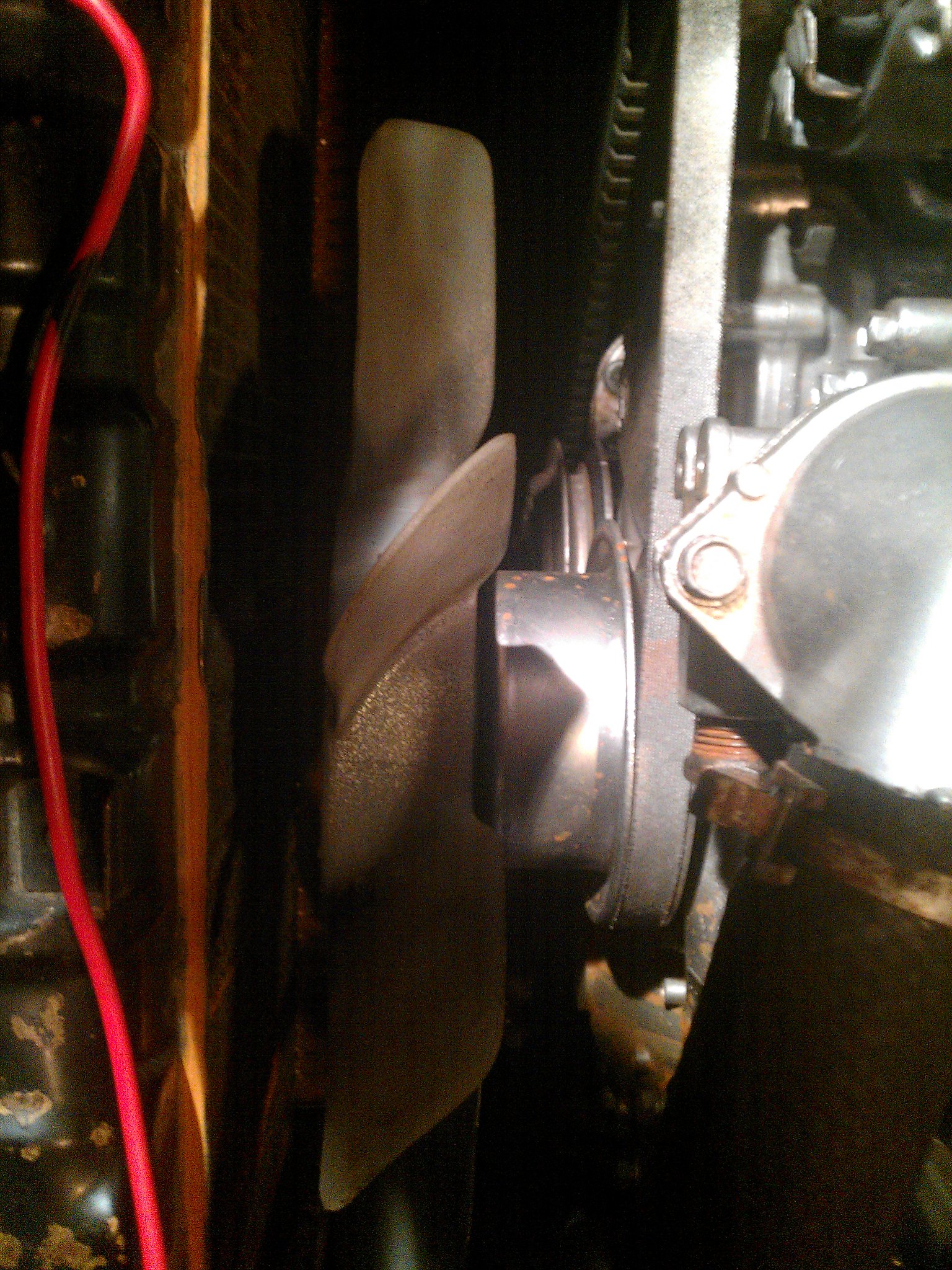

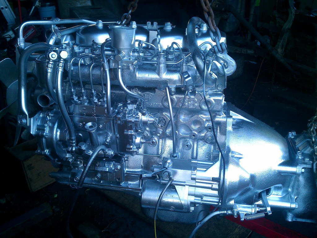

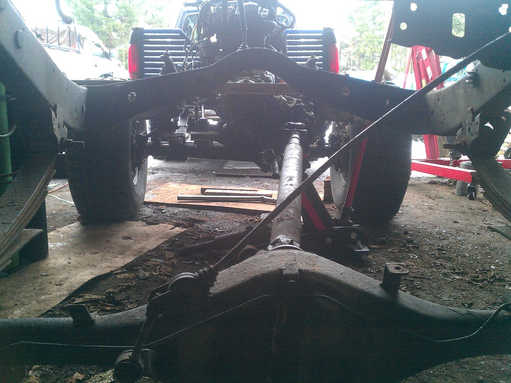

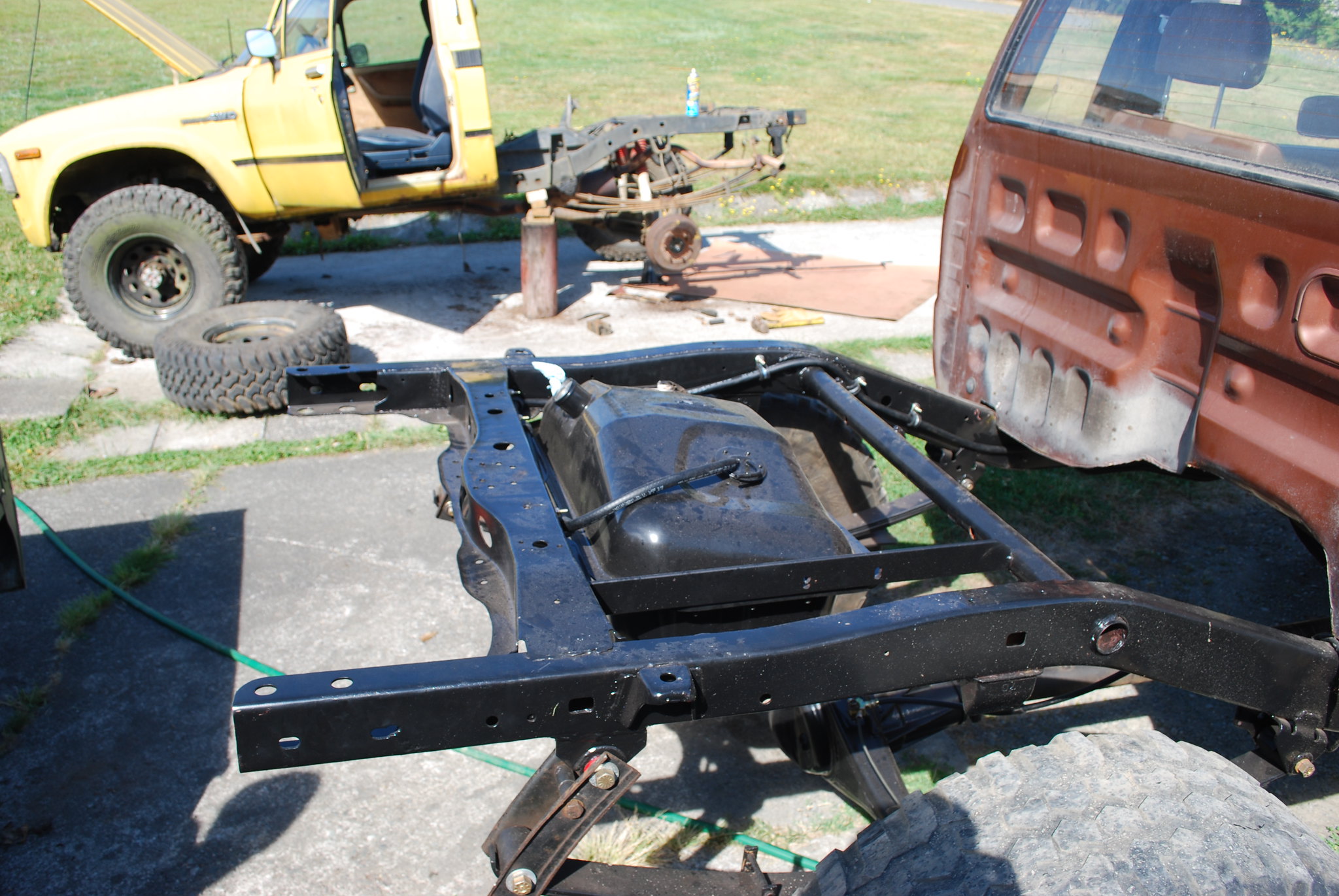

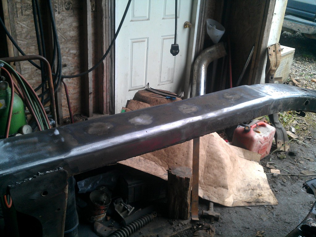

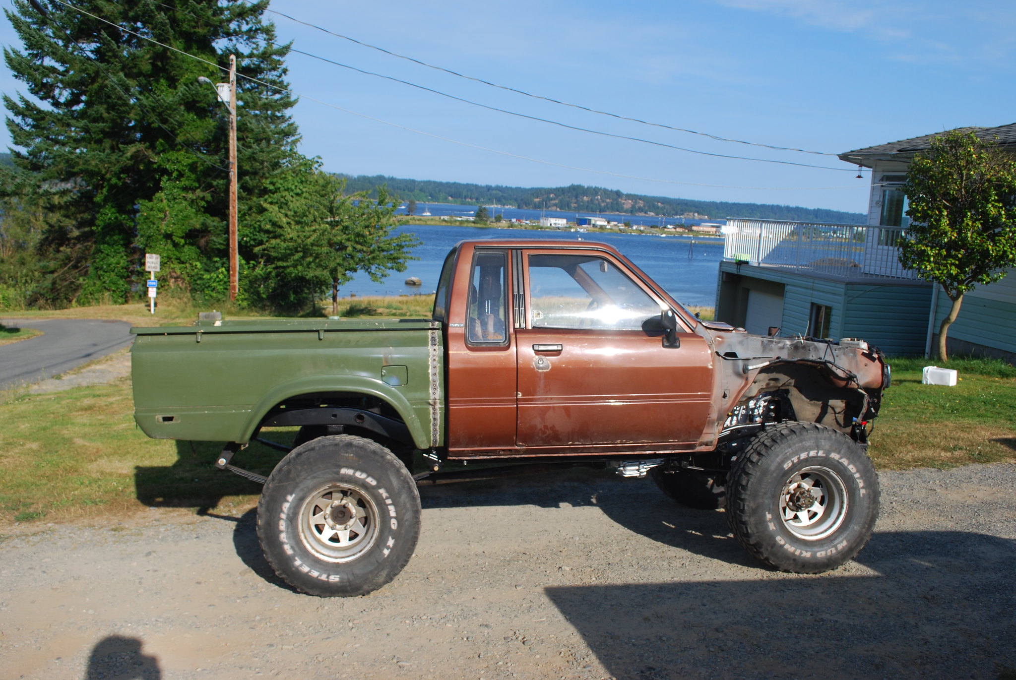

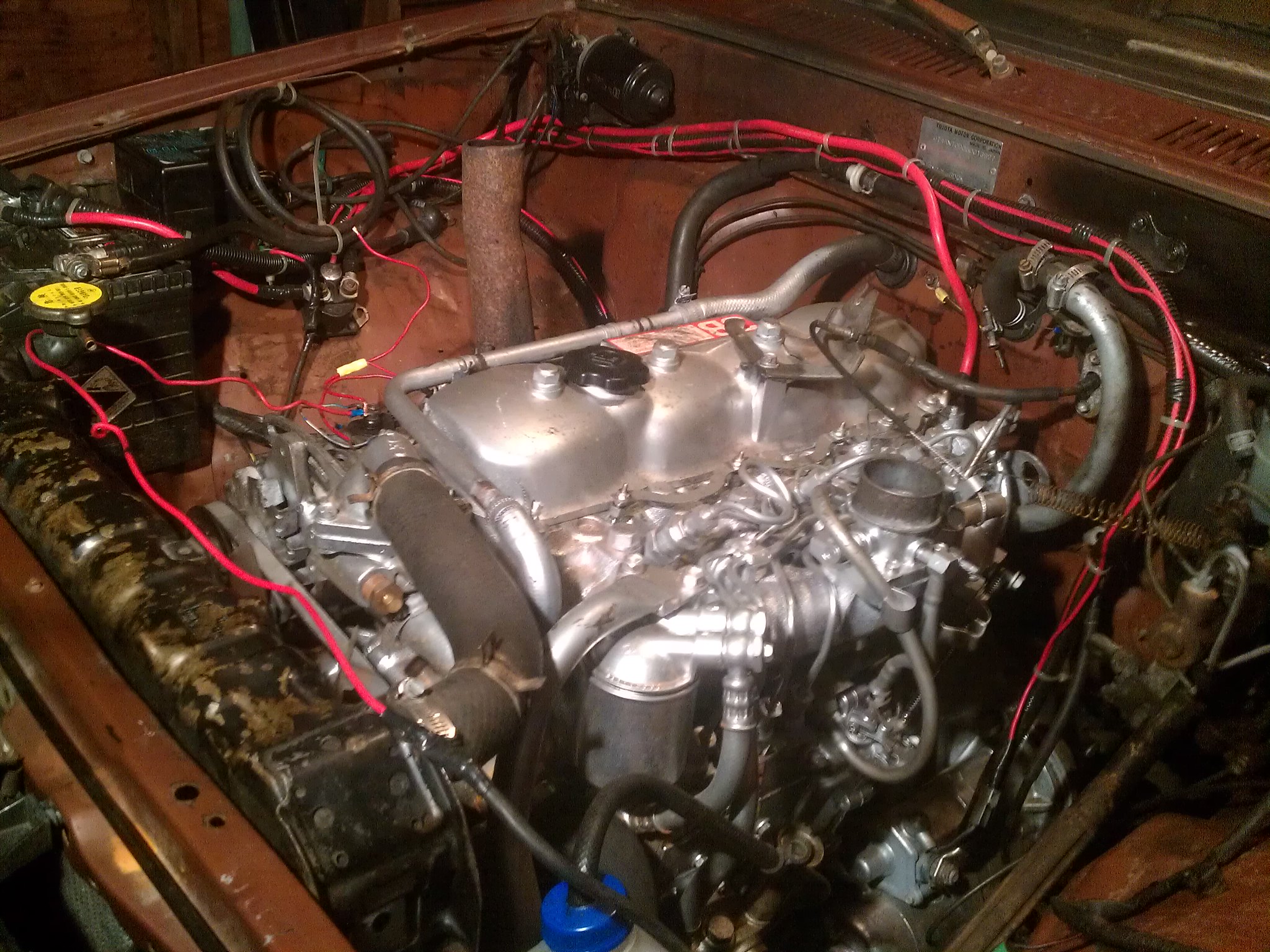

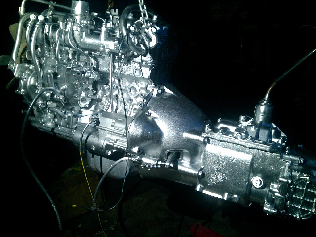

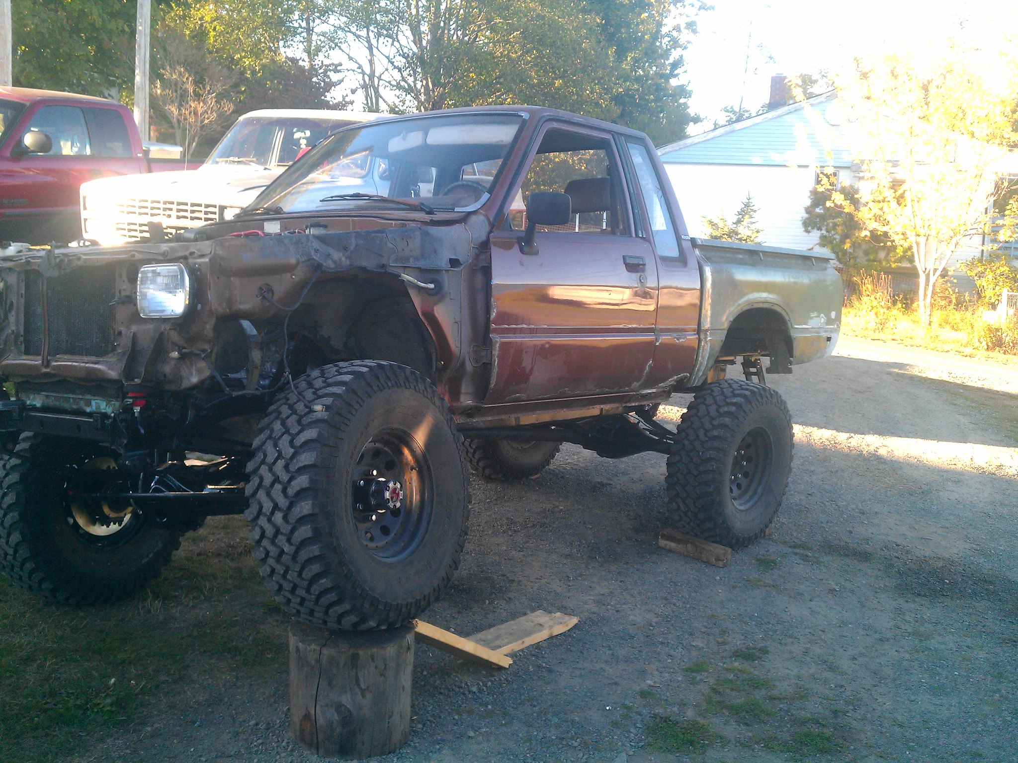

Finally found a box for it i was planning on a flat deck. I bobbed the box 12 inches in the front its off an 81 and my frame is from an 82 so the rear box mounts bolted right up just gotta build the front ones. I also removed the fan clutch took it apart and welded it solid and bolted the fan to the backside of it giving me 3-4 inches of space i can now fit the stock rad with about an inch and a half of space in between. The frame got painted gloss black as well as the axles and springs. Rear axle got rebuild with a locker and i just ordered a knuckle sandwitch for my front axle which has to have the knuckles rotated because of the angle of the t case output
been a while since my last post new stuff: Front axle cut and turned rotated half an inch and completely rebuild and painted, Fan clutch shortened 4 inches by removing the cover plate and welding the clutch to the housing so its always spinning now and i bolted the fan to the backside of the assembly i can now fit the 60 series rad with 2 inches to spare. Glow plugs wired to a switch in the cab starter wired to key switch all brakes done with new lines all around. Had to do a 2 inch body lift so the box lines would line up with the cab, Fuel tank mounted and fuel line ran down the frame. New tires and wheels 33x10.5 r 15 BFG MT KM1's lockright in the rear axle, Got rid of front backing plates, New calipers, Road tested it to 60km no vibrations. Thats all i can think of at the moment im sure theres more.... some pics.
Not rust just rusty water...
