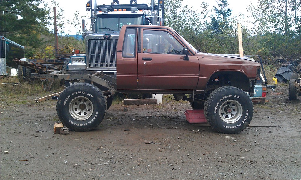

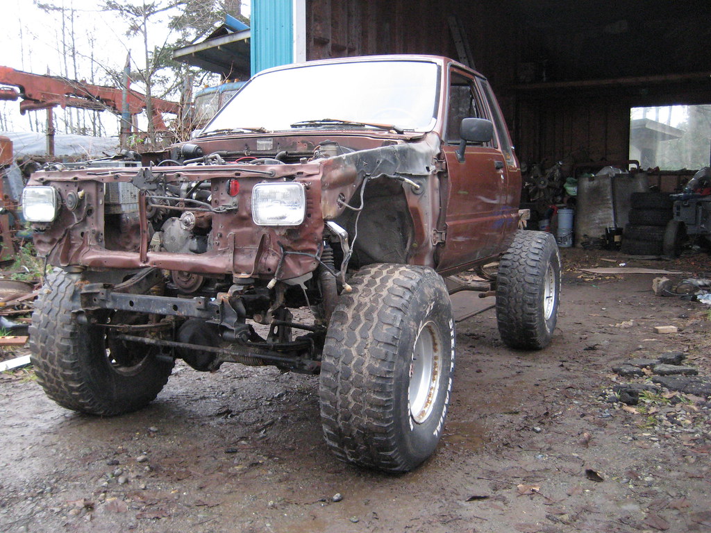

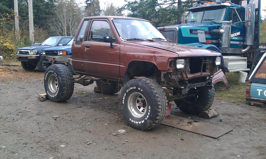

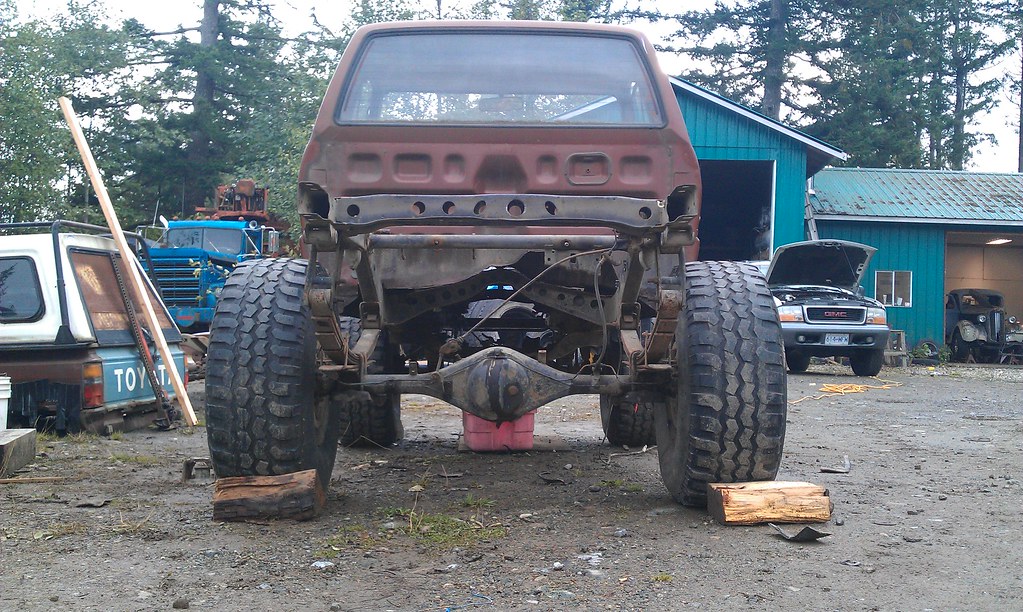

Body if from an 86 extra cab 2wd automatic. Frame is from a 82 singlecab 4wd. Engine is a 1982 3b diesel w/4 speed manual trans.
This is not the frame i will be using this is an 86 bj60 frame i am only using the engine and tranny.

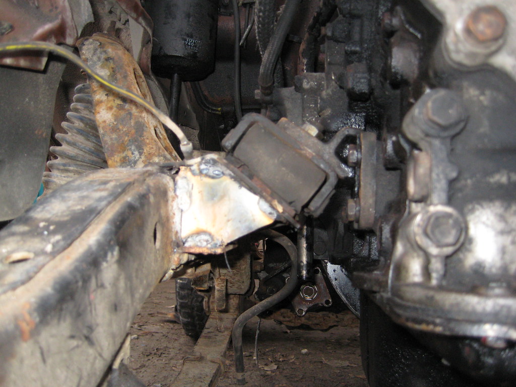

These are the only pictures i have taken they are pretty old. I am going to take more pictures this weekend the engine is in it fit nicely didnt even have to move the engine mounts just had to cut a slit in the bottom and bend them up now they sit perfectly.

Took some pictures today s***ty quality but all i had was my ipod and it was dark. The engine is bolted to mounts.

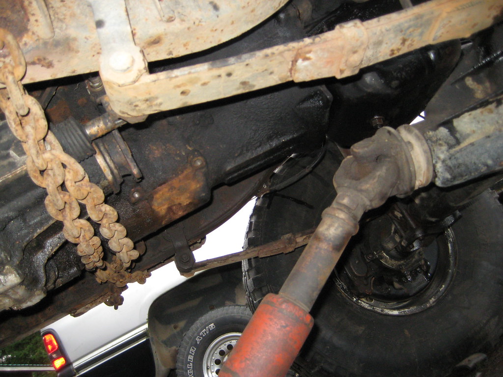

If you can find one, a Marlin Crawler Toybox will do the trick.
They're no longer in production, so you'd have to dig one up from a previous owner, but they're pretty stout.
Some folks use some Dana case between splitcase and a transmission, but I can't recall the model number.
does anyone know if you can get dual cases for the 3b 4 speed lc t case?
