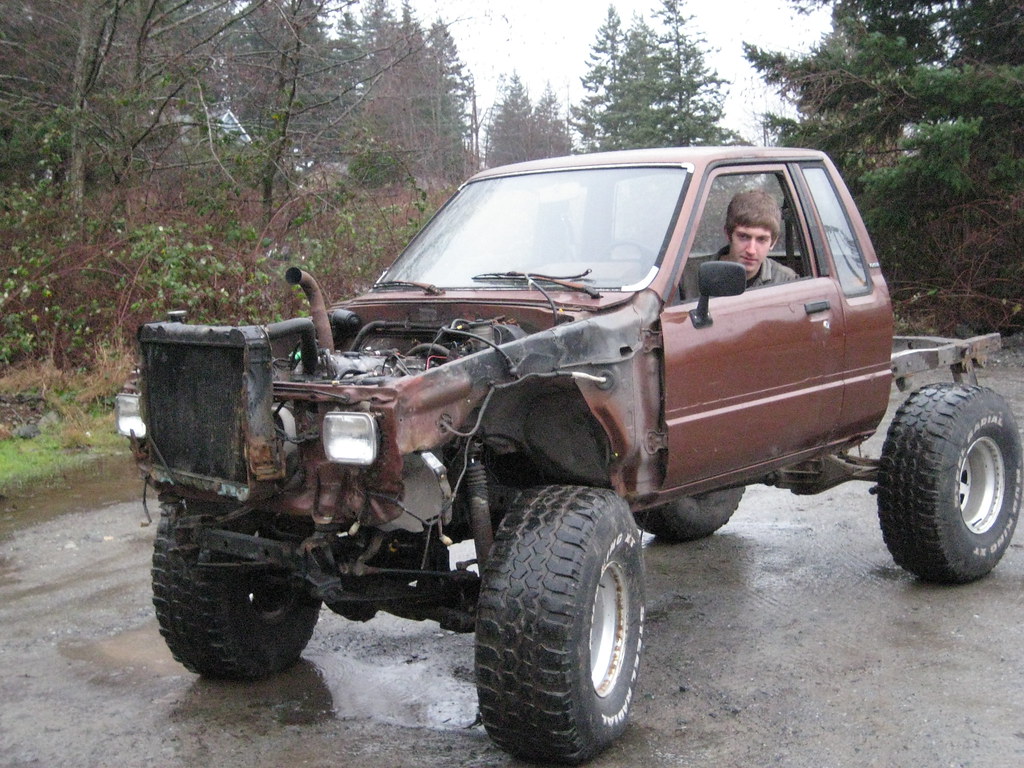

I got the clutch hooked up today and took it for a test drive it has no brakes throttle or power steering and no transmission mount just a chain across the frame to hold it up. I had it in high range and just popped the clutch and it didnt stall just took off then i put it in low and it would spin the tires if i popped the clutch. It has stock 82 pickup axles 4:10s i think and 35's tons of torque i plan on putting a turbo on it eventually.

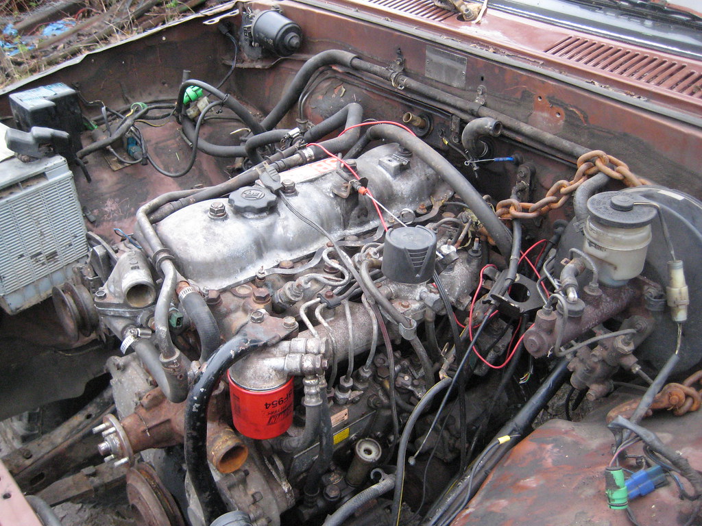

Is that the rad from the 60? Hence the fitment issues? I'd guess the 22's radiator would be too small, is that the case? Electric fan maybe?
yea its from the 60 i might be able to fit it if i cut into the rad support. The rad for the 22r has the ports on the wrong side and i think it would probobly be too small also i am using the 22r fan which is smaller. If it wont fit an electric fan will be my next choice.
What about a 2L/3L radiator? the ports will be on the correct side.
Do you think that would be enough to cool it i do plan on putting a turbo on it in the future aswell.
It might just barely work for NA, but with a turbo, I doubt it.
I'm beginning to think having a radiator built may be your best bet. A custom 4-Core 3L radiator might do the trick.
I think with an electric fan i can fit the rad from the 60
What kind of clearance behind the engine?
Got a shot from the top looking down on the fan?

This is the only pic i have it doesnt really show the gap its about and inch and a half to 2 inches from the valve cover to the firewall.
damn that's a lot of space.

Ya he has a lot of room in there now because he has no radiator, fan. Wait until he builds a custom radiator and tries to squeeze an inter cooler in there for that planed turbo.
