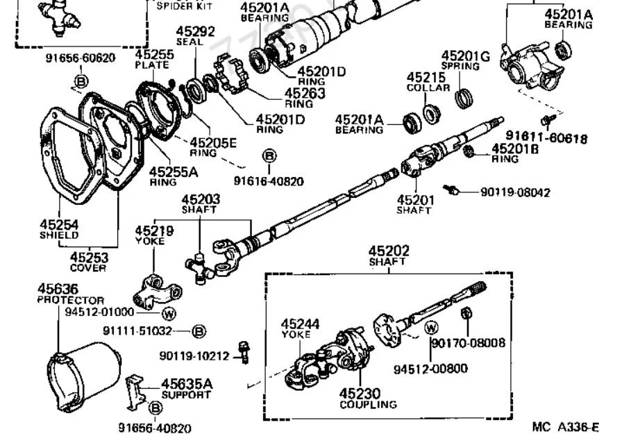

I went through this over a decade ago. I was not successful in finding a part number for just the joint. Looking at the digital microfiche it's not sold as a separate part number. The shaft is an assembly. NLA from Toyota. See pic.
I guess you could take one apart, take some measurements, and see if NAPA can match it up.

I've thought about taking it apart and pulling some measurements but I dont want to be stuck with a blown apart shaft and no replacement U joint. I have a feeling once I remove the joint(s) they wont go back in and function the way it is now. Might do a prelim still installed set of measurements. See if anything is even in the ballpark.

Could possibly be looking into newer era Toyota's if something is still available. And mod length to fit. Depends if they changed the spline/yoke.
Splines are the same. Shafts are not. They more or less, interchange.
