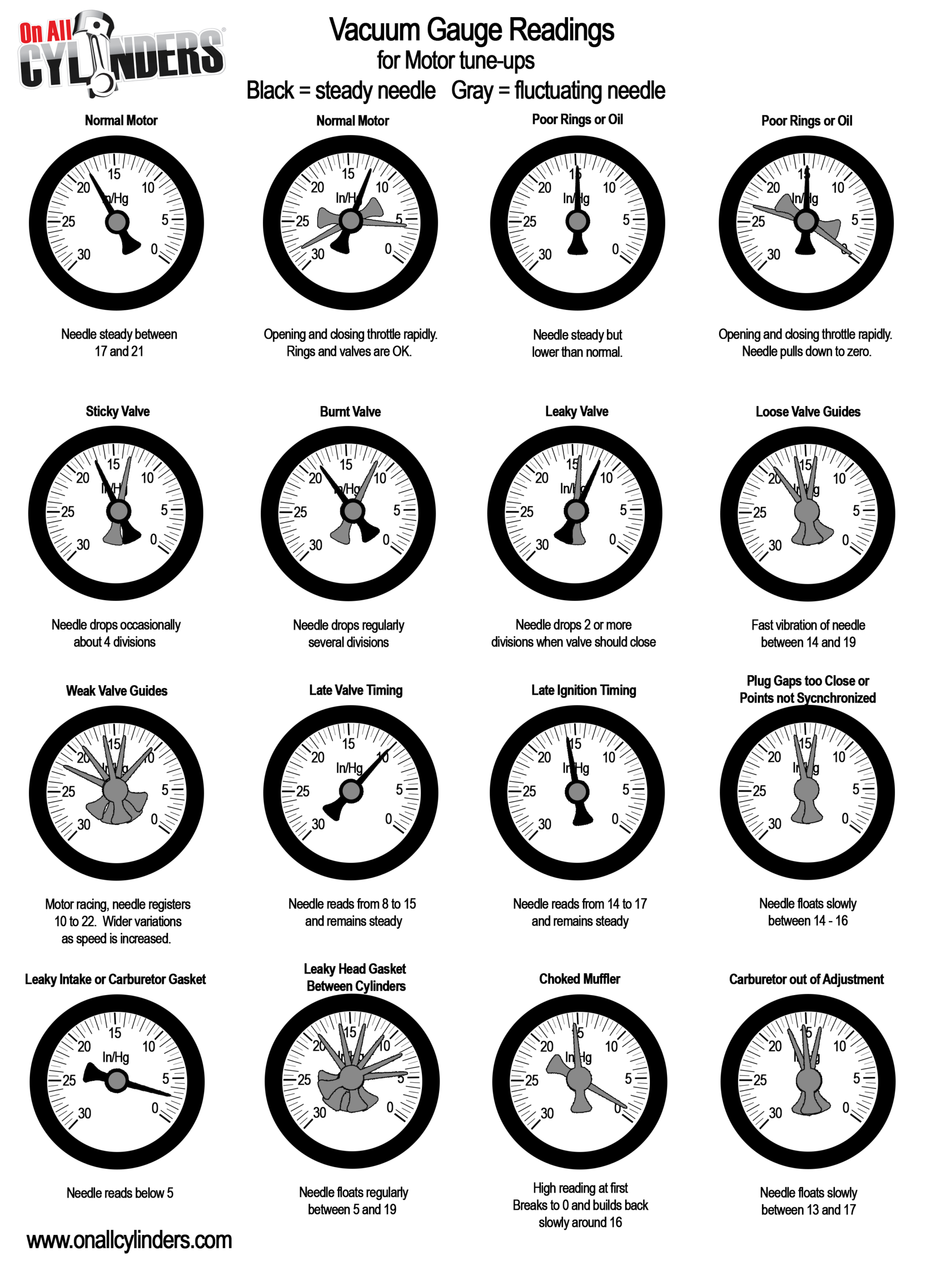

The Vacuum gauge be an amazing tool to help quickly narrow-down trouble, particularly on these old Carb'd engines.
Here's a guide on what to look for:

I have that gauge guide as well, Alex sent that over to me, and that’s what I was using when trying to determine what ever issue I might be having, which “seems” to be “Late Valve timing”.
