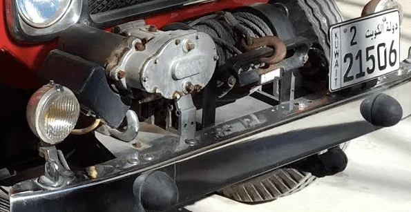

Anyone know who actually does a 8274 mount for use with the OEM bumper? I realize this has been asked in numerous threads, but all my searches result in folks showing their aftermarket or home-brewed bumpers. I'd really like to have a mount like the one pictured. Can anyone shed any light on who did the one here or has done one like it?

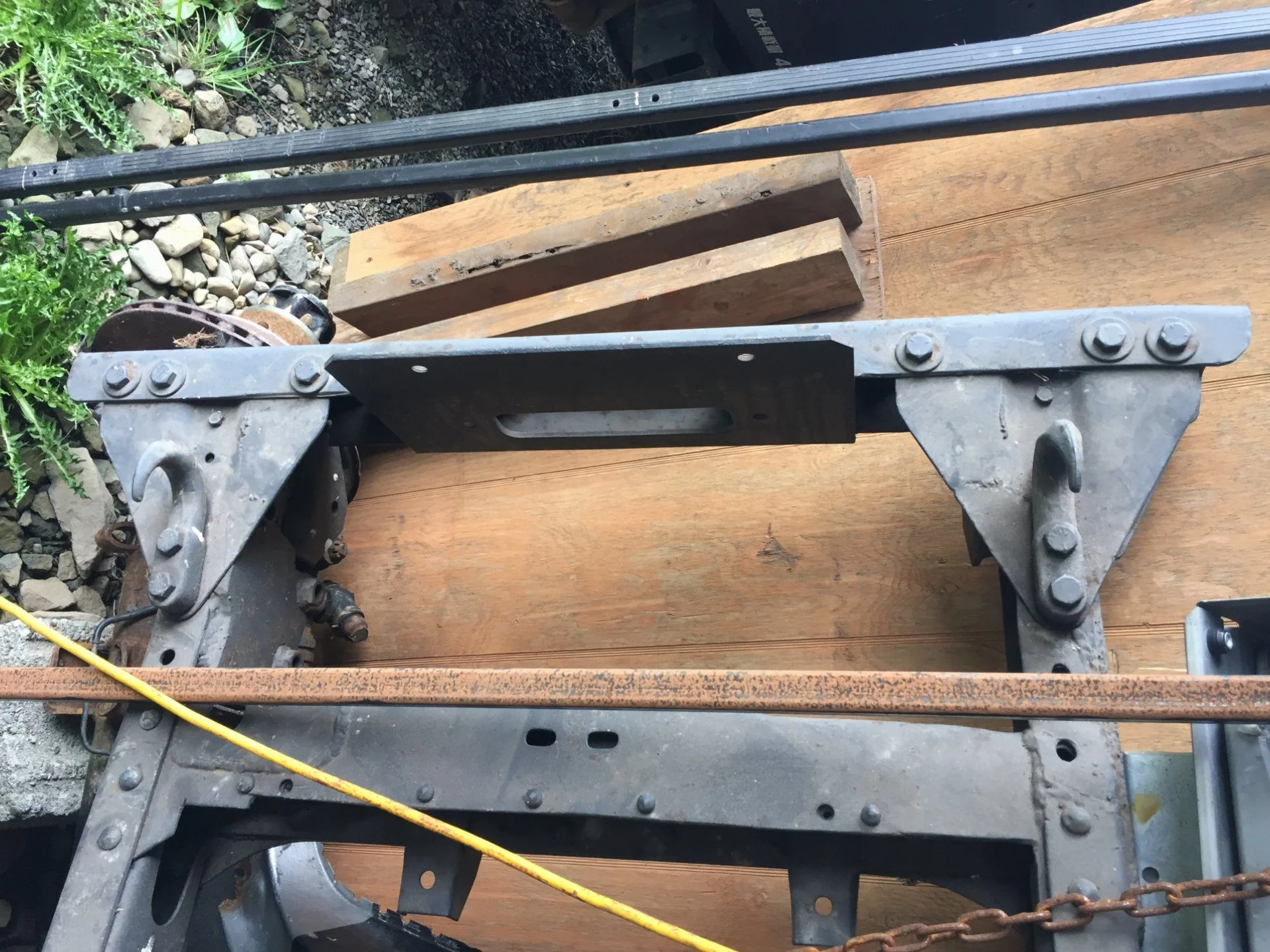

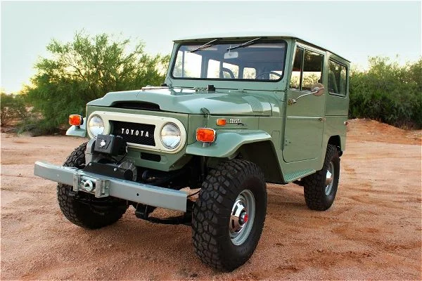

any idea whose fj40 this is? lookig for more info/pics on how they braced the backside of the bumper. cheers -max

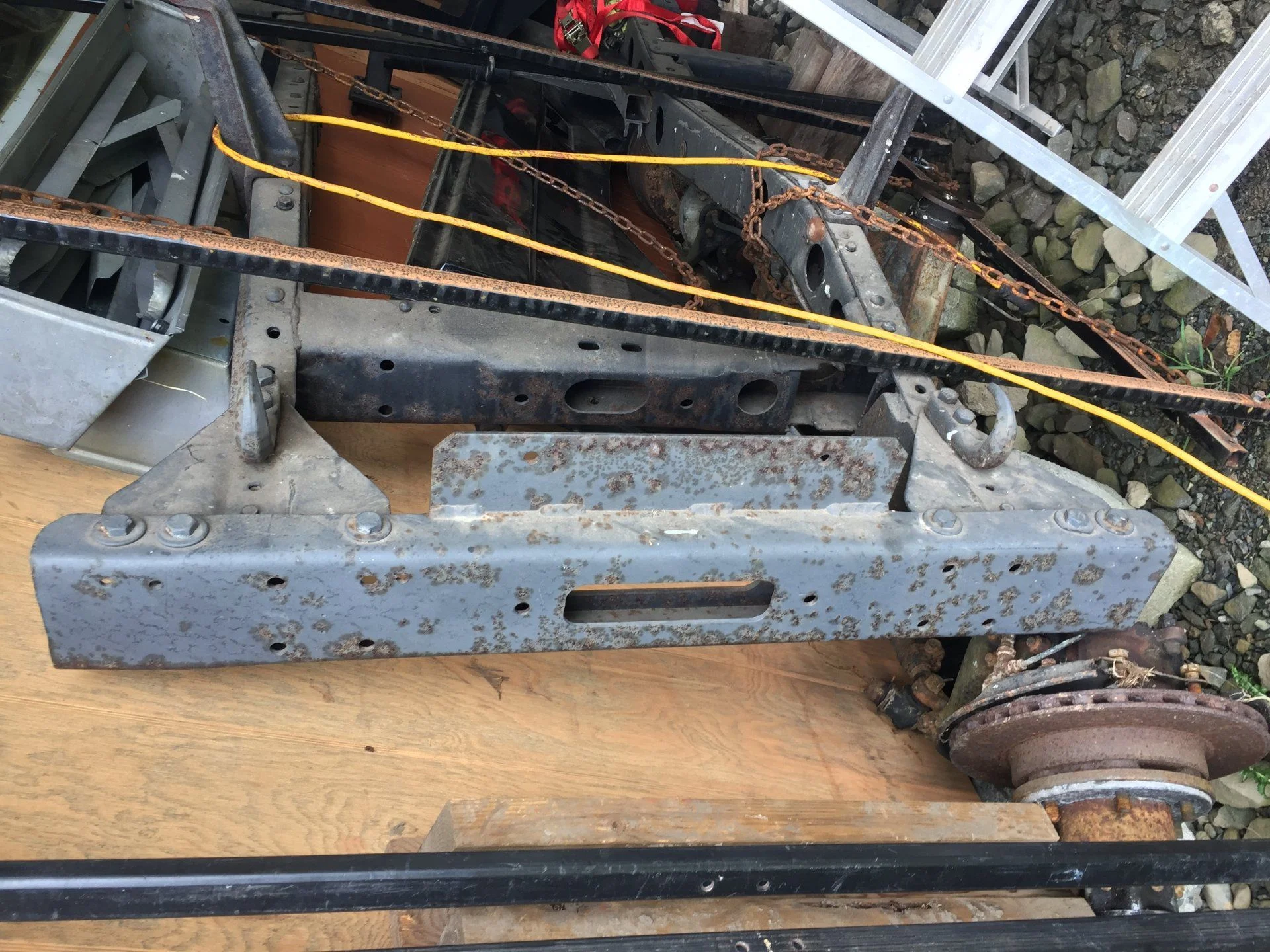

Did you look at that old pic of my FJ40? It’s just a flat plate drilled for forward bolt holes
of the winch with the slot cut for the rope. You will have to cut a slot in your factory bumper
and just weld the plate to the back of the bumper. That’s it. There usually isn’t any extra
bracing

I've winched up a slope so steep the front wheels 'bounced' 2' up and down by hand. No, no issues with strength.

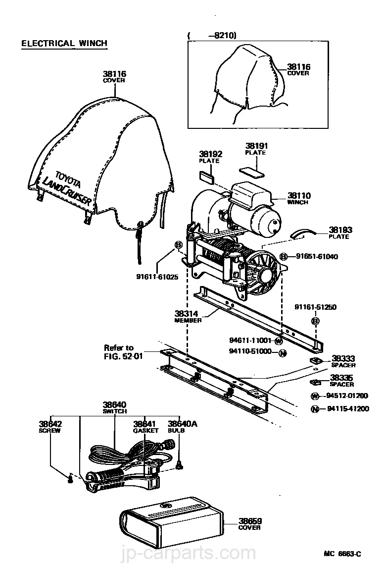

This is how oem does it
