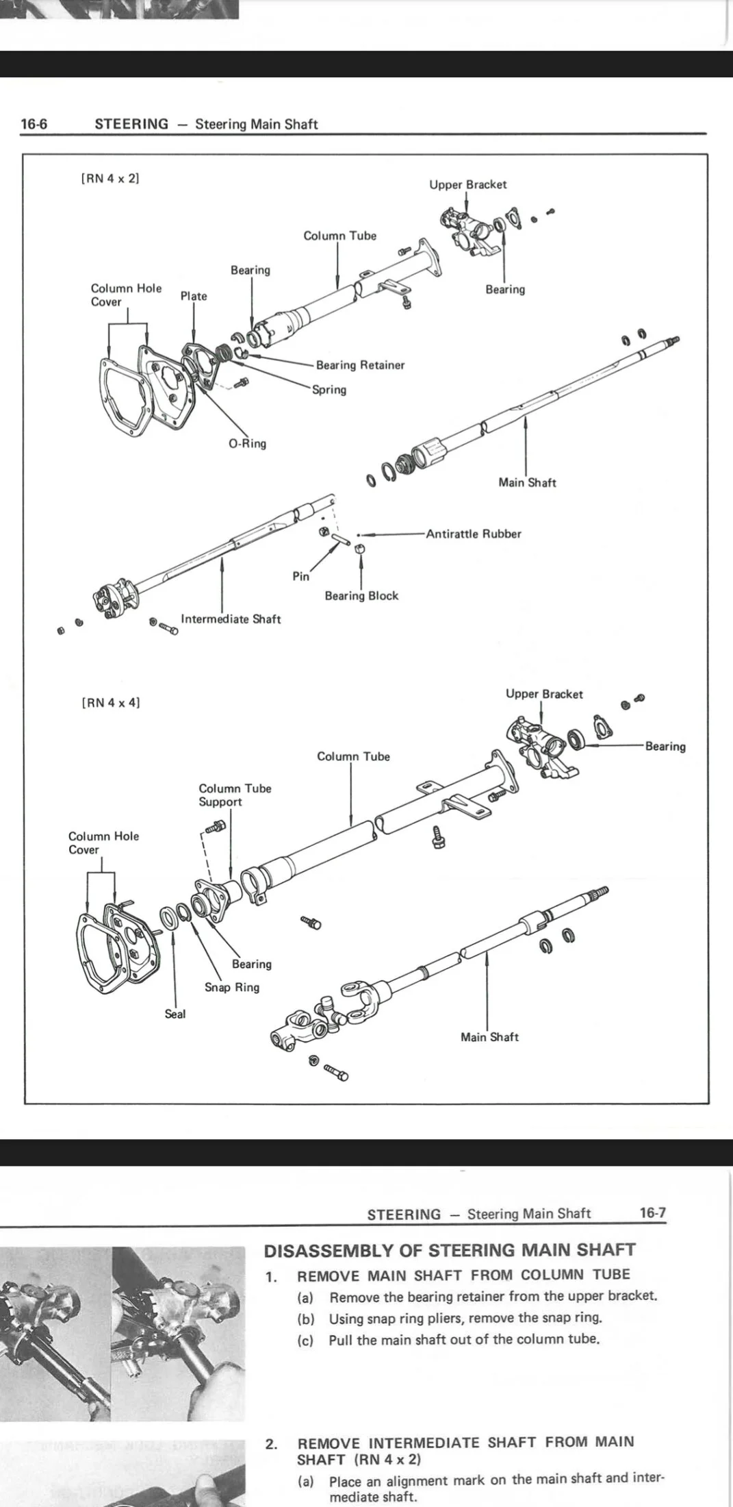

Finally just about have the 2wd cab all converted to 4wd frame. I had to swap the steering columns. Has anyone else had a problem with 4wd steering column interfering with the universal joint on the steering column?
i guess i missed that one🤣
make sure the column is assembled properly.
if you don't have efsm, i can pm you a link to this 80 manual. or i believe there's an 83 in the resource section
Sorry for late response to your follow up question. So the universal joint on thev4 wheel drive column interferes with the larger diameter vacuum brake booster from the 2 wheel drive cab. The 4 wheel drive steering column seemed to have to stay with the 4 wheel drive setup after swapping because thev 4wd column uses a universal joint and a splined shaft in conjunction with each other and the 2 wheel drive uses a steering column with a rag joint attached and thats it. So I guess I need to install the smaller diameter brake booster from 4 wd cab so the universal joint has clearance. Has anyone run into this issue?
