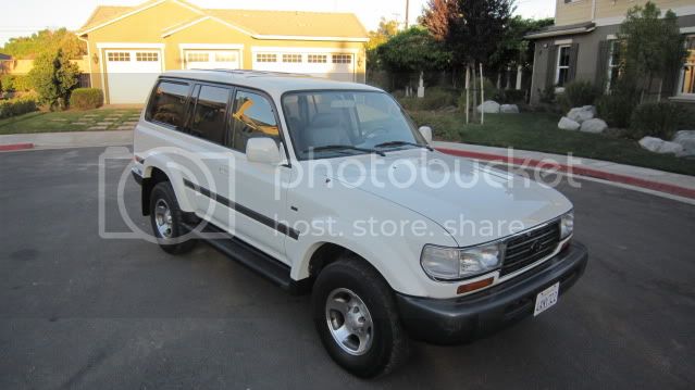

Since owning my Land Cruiser it has only received bi-annual car washes, regular maintenance and a diet of 87 octane fuel. It has been my delivery and tow vehicle for the past 3 years and 45K miles. It performed every duty I ask of her with out any hesitation. When I bought a Tundra to fill in for her duties this year. I wanted to reward her for the years of service. I decided to do an extreme make over of her since she is now promoted to a garage queen.
I attended one of Meguiars Thursday Night Open Garage classes in Irvine, California. Basically, how it works is you bring in your car and one of the paint experts will teach you the proper procedure to correct your cars paint. Here is the link to the TNOG with some pictures of the Land Cruiser. Pictures from Thursday Night Open Garage - August 26th, 2010 - Car Care Forums: Meguiar's Online
Armed with my new knowledge of paint correction and with the assistance of my friend who is a professional auto detailer. We went to work last Saturday. After 25 man hours later, (drum roll please) here she is!!

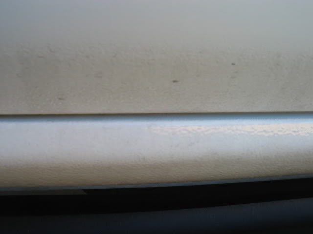

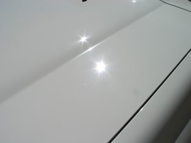

Paint is dull from years of UV damage.

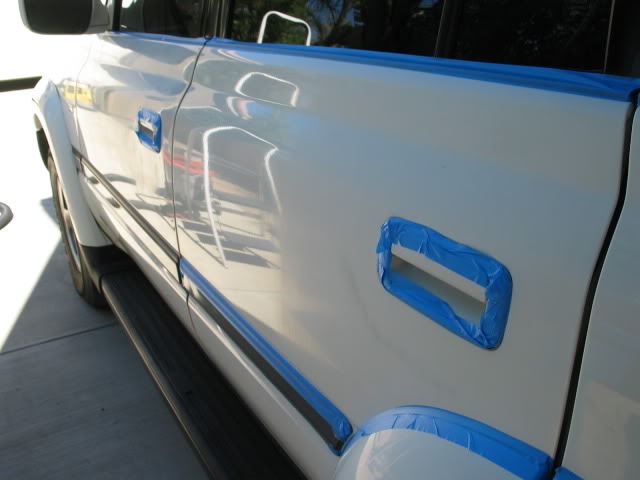

My friend working on the mirrors with a dual-action polisher.
Before
After
Before
After
Before
After

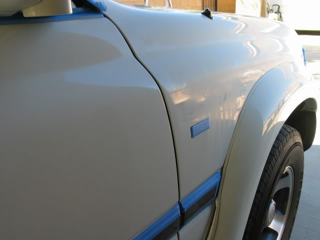

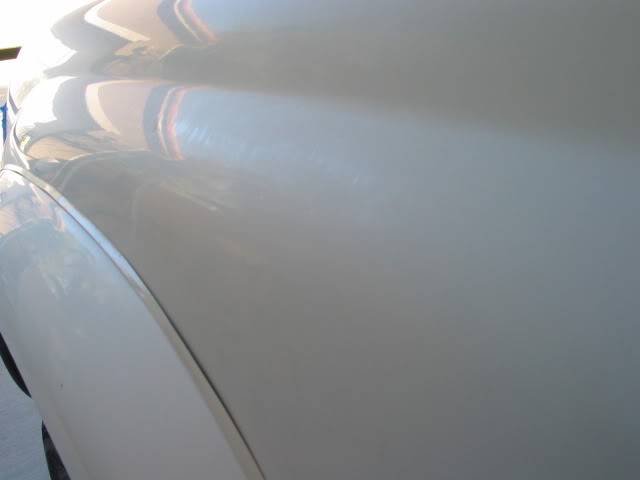

Half corrected panel
After Shots

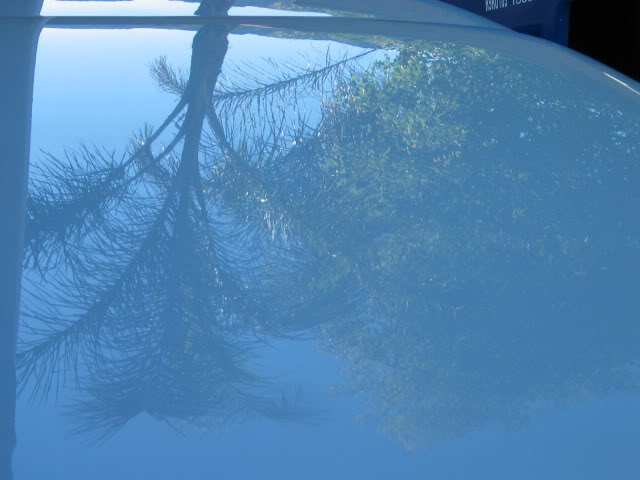

Paint is now almost swirl free!

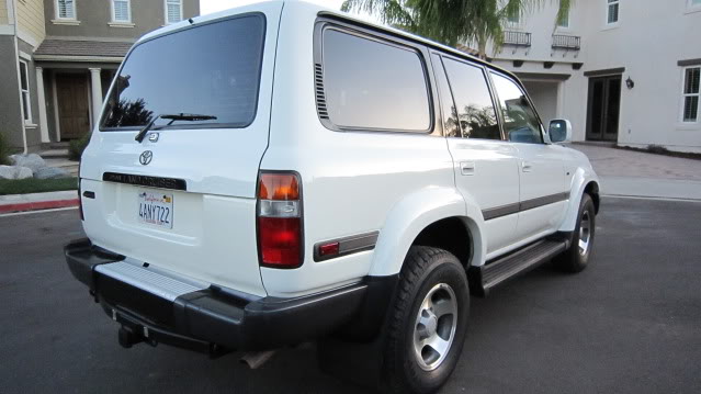

I had the sliding rear windows originally but the reflective glass has fading streaks and is bugging the hell out of me. So when I did the 91-92 non reflective glass conversion. I took the opportunity to converted to the non-sliding rear quarter glass for a cleaner look. Before installing, they are tinted with 3M film and I use Toyota weather stripping and all related parts for the project.

After claying the paint we used Meguiars Ultimate Compound with a mid cutting/polishing pad. We worked on each panel similar to this guy on youtube YouTube - DA polishing-KB Method
Overall, it came out pretty close to what we wanted. We think we might be able to achieve better results with the Meguiars 105 (their professional line with a bit more aggressive compound) versus the Ultimate Compound (their consumer line).
We were taught to always use the least aggressive pad and compound combo to get the job done. This way we are not removing any more paint than necessary.

Are you sure you used Meguiars #7? Thats a glaze and adds an oily/waxy film which is probably hiding the dullness of the paint. The guys at meguiars told me our single stage white paint is probably one of the hardest paint to polish since it uses Titanium Dioxide as the pigmentation. Think of it as polishing Titanium!! :crybaby:
