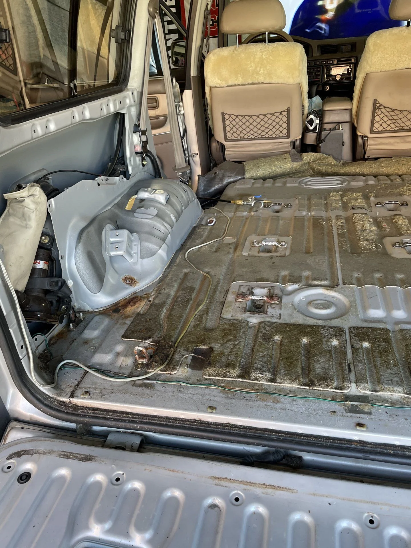

I have a ridiculous leak at the drivers side rear quarter window. I just ordered the belt moldings for those. I think some sites hang up on the old part number (60020 vs. 60021) This only applies to front left and right though.
Just a note on the rear quarter belt trim: If it's in good shape, you can pull out the rubber end caps w/ a flathead or trim tool and slide it out.
Pop out the clips and clean/seal and slide back in. Eliminate the common leaks that go through the clip holes.
Noted. Thank you. I've got main gasket/run problems back there too. Belt moldings are the final pieces to my window and door refresh adventure.
Don't forget that back vent thingy on the d pillar. Pretty sure a lot of jack rust is from that thing as much as the window molding. I need to open and look at mine still.
Right. I haven't pulled anything apart yet. My other parts are supposed to arrive tonight. My vent louver panel isn't broken on the exterior surface, we will see what's lurking underneath.
