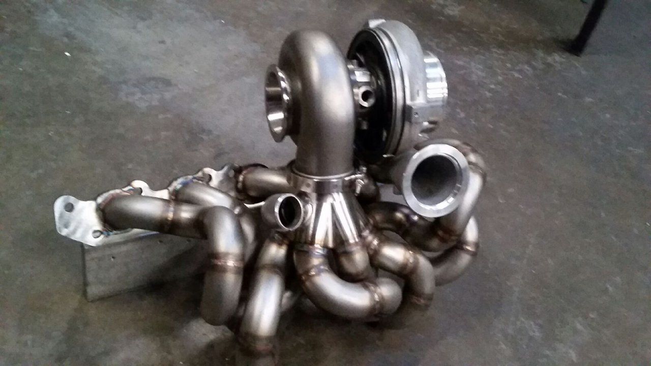

Yeah I am sure it's the s***ty photos. You can see the setup to perge with inert gas and the guy is pretty much a tig artist. I will take better pics when I actually get it in my hands.
Maybe it's just the picture quality on my phone, but I don't really like the color around those welds.

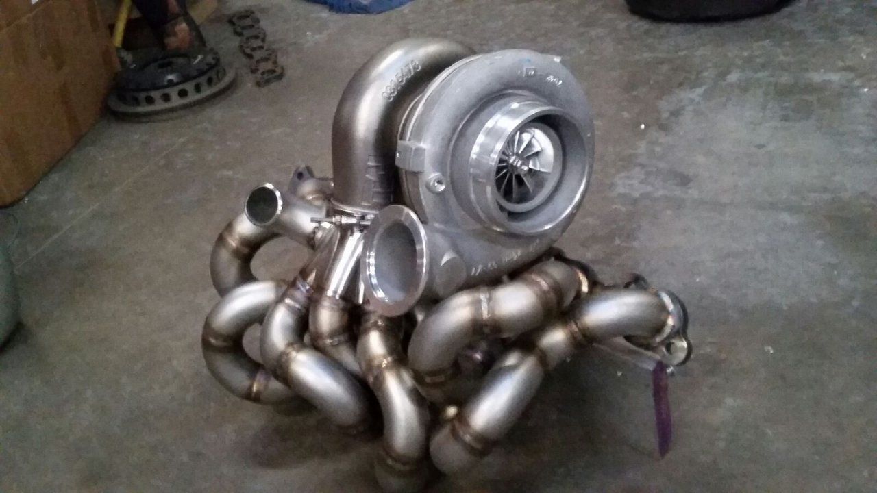

Ok not quite done last night but so damn close! Just finishing up the wastegate flange.
Pic #1 looks like The Kraken! Geez...you don't mess around! :)
You going to wrap a blanket around that snail?
Think I will have the manifold and hot side of the turbo coated by swaintech with their thick ceramic coating. Unsure on if I will use a turbo blanket or not, I have one on my current turbo but this one is going to be a lot more center stage. Lol
