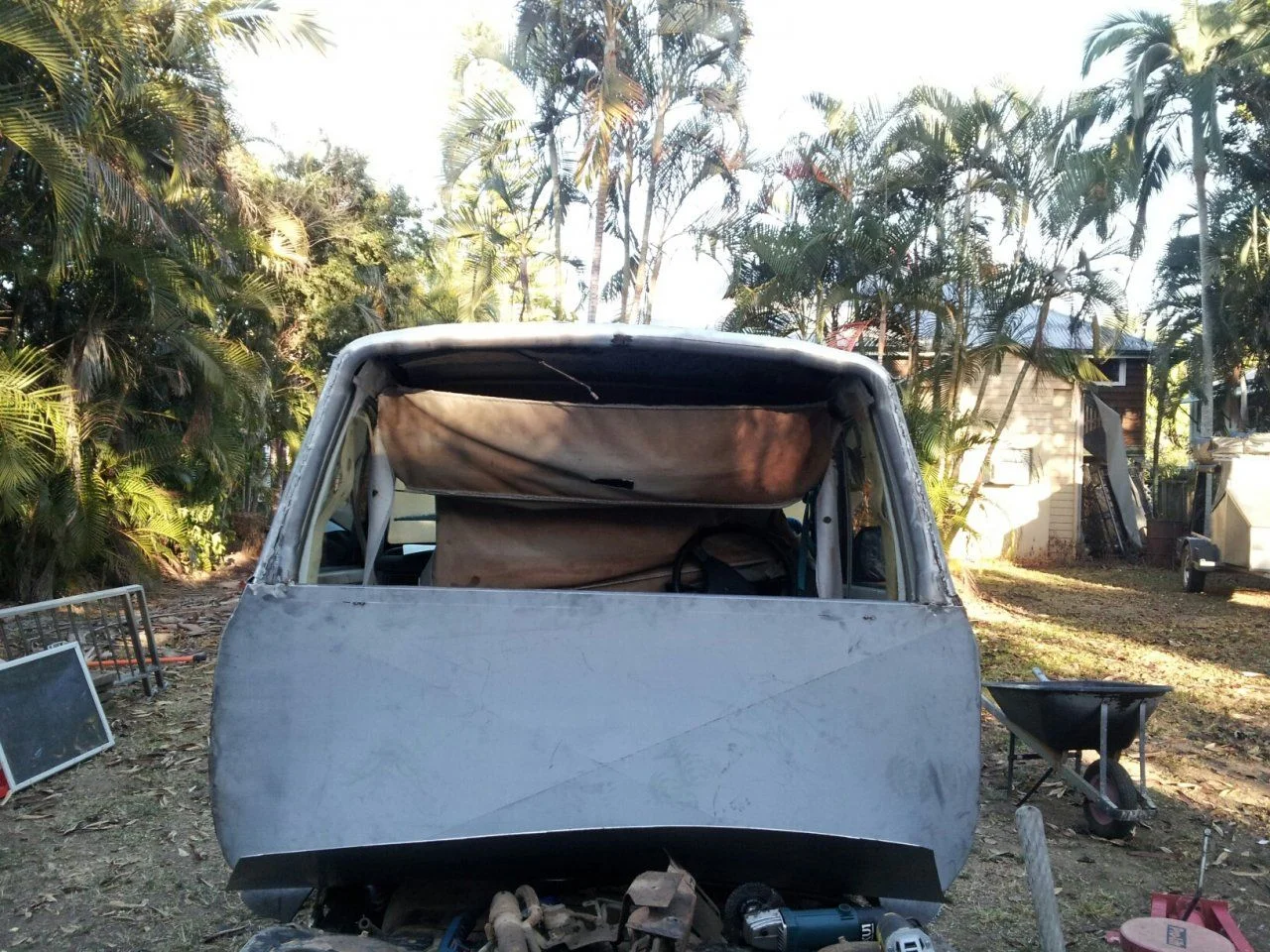

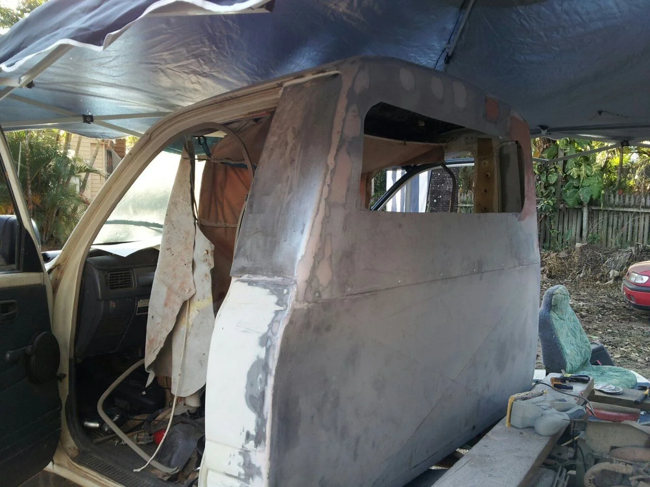

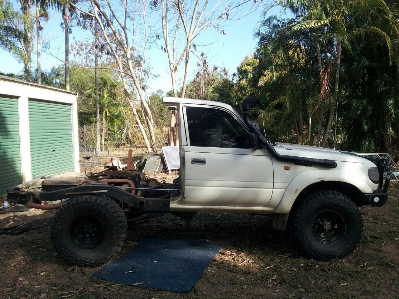

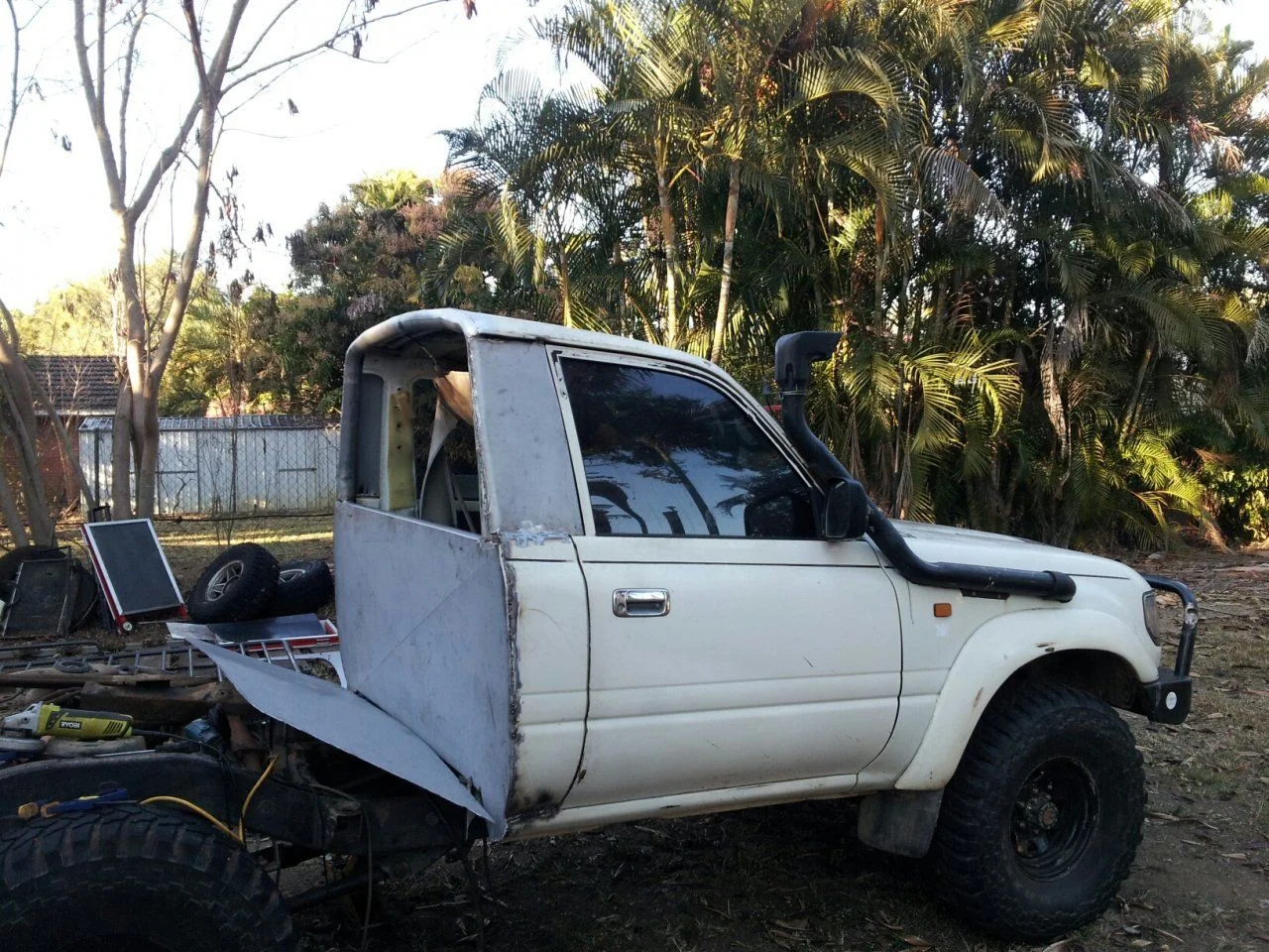

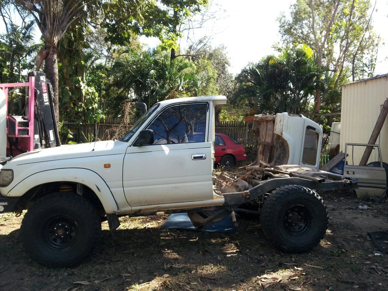

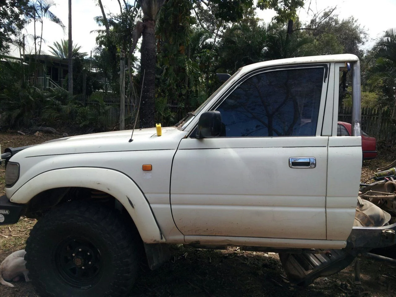

Hi all, just thought I would share photos of the build of my 80 series ute. I have only had the 80 for a few weeks and I bought it already chopped. The previous owner was kind enough to send me photos of the build. Unfortunately I will unable to answer most questions about the conversion as I had no part in it.
Enjoy
Here's the last of the photos the previous owner sent me of the ute conversion.
If you have any questions don't hesitate to ask. I might just be able to answer your question..

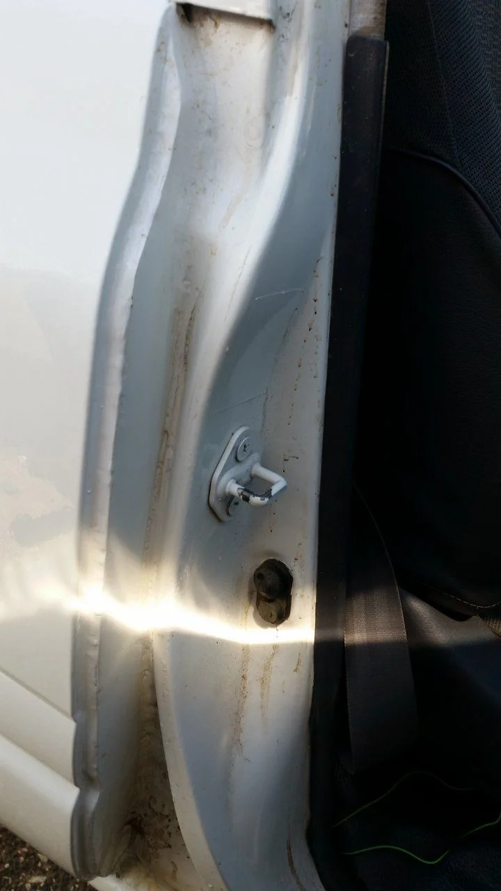

Could I trouble you for a picture or two of how the front part of the now-welded in rear doors (where they were hinged) are sealed? I've noticed that I'm going to need to do something or I'll have some water in the cab.

This is what I'm talking about... Need to figure out a way to seal this all up. Seems like it's going to be a pain...
Expanding foam and bondo (kind of kidding) Or just weld in some more metal.... That's probably what I'll do.

Hey mate. Using stock gxl seats (mine is a dx). When I bought the car it came with both bench seat and passenger bucket seat with centre console options.
The tray is steel, I was told it came off a Nissan patrol and mounts were modified. The internal length is 2.4m.. so it is a full size single cab tray. I probably wouldn't use a high lift Jack on an aluminum tray. Its a lot of weight in one spot and I don't think the alloy tray could handle that. I have a 48 inch high lift I used for my old ute but it isn't long enough for the 80.. I will need to upgrade to a 60 inch.
Ill just grab a picture for you
Just make sure, whatever you do, you vent the cab well. My vent isn't big enough and it can be hard to close the doors with the windows up.
