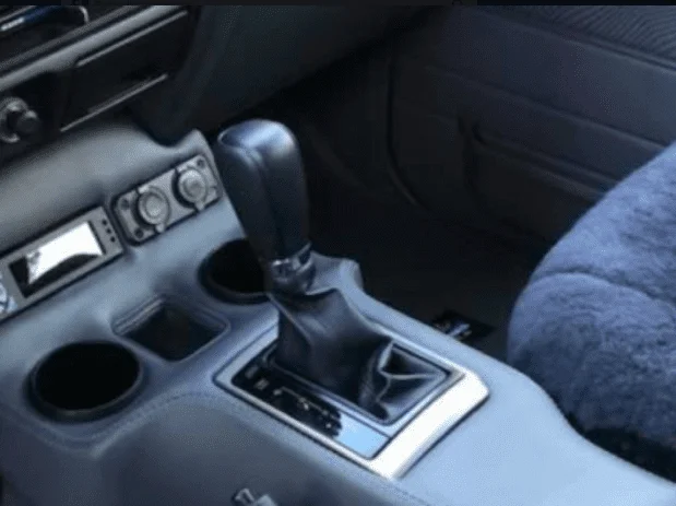

While there last week, we discussed offer of a kit to fit manual shift A750F transmissions to 80 Series with A442F and A343F from the factory. These would be upgraded with HD valve bodies, TC lock up kits, add-on transmission controller and (optionally) billet torque converters - along with Tiptronic-style shifters as in a 200 Series.
Get another gear, wake up your 1FZ-FE, get better shifts in auto and manual shifts when on the trail or going downhill. Total cost at or below that of a manual conversion with bellhousing, clutch, tranny, pedal bucket, misc. kit to make the swap happen.

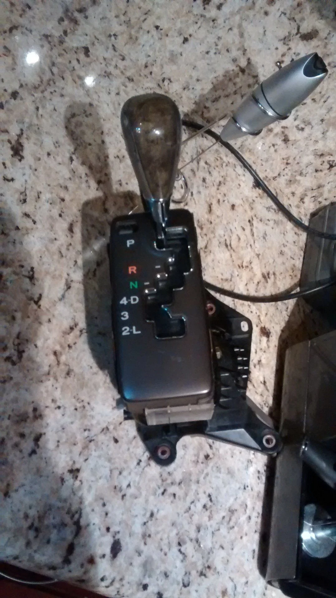

What floor shifter would you use?

shifter... $60-$90 on eBay

IF we offer anything, it will be Tiptronic/manual shift vs. gate shift.
