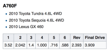

Speaking of A760F 6 speed, I understand that mechanically it’s basically the same as the A750 5 speed, with an altered control system. If it was done on the front end, could the “manumatic” be designed for the A760F too? Buy 5 and get one free? ;)
Stepping aside from the debate of whether the 1FZ could use another OD gear on the freeway, the other exciting possibility is that as deeper low range gears hit the market (currently 3.1, with Marlin testing the waters for 4), a 2nd OD allows deeper low range to still cover the range the stock ratio did.
Stock setup ratio in OD and low range .753x2.48=1.87
A760F 2nd OD and 3.1:1 low .586x3.1=1.82
A major criticism of the Rubicon 4.0 low range was it was too low for everything else. I go down to Easter Jeep Safari often, and have been stuck behind those guys that were geared too low for moderate trails.

When CORRECTED 4th gear ratio, the A760F and the GM 6L80/90 have virtually identical ratios.
GM 6L80/90: 4.03/2.36/1.53/1.152/.852/.667
Note that 4th gear is NOT 1:1, but 1.152.
Multiplying A760F ratios by 1.152 (equivalent of selecting a different axle ratio)
4.06/2.35/1.61/1.15/.825/.675
I am just saying that A760F is the functional equivalent of 6L80, except from Toyota instead of GM so that means way better! If the hard parts of the kit work with both the A750F and A760F, I would go for the A760F. I am assuming I will have to regear my axles regardless.
There is no reason that 6 speeds couldn’t work for 1FZ. It’s true the current 8 and 10 speeds are used with gas engines that generally rev higher than 1FZ, the they are also used with diesels that have a lower redline than 1FZ.
