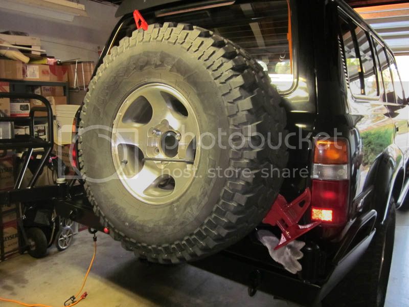

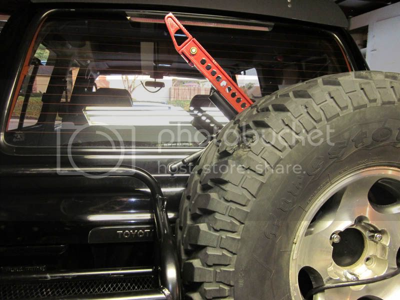

i was trying to find a better spot for the high lift jack mount on the tire swingout today, and this is what i came up with. there are sleeves welded in for the bolts to go through. fits with a dual swingout setup too. and still have the jack mount on the jerry can swingout as well.
That looks very similar to the picture I sent you, and how I would like you modify mine. I think the jack fit better on the other side of the tire carrier riser(i.e. with the top of the jack pointed towards center of truck). I'll see if I can post some pics.
You really need to have the bumper on a truck to work out spacing as tolerances are very tight with the jack mounted like that and it is hard to visualize.

Here are some pics from the mockup on my truck. Some of the tolerances are pretty tight. I had to move the tire out away from the truck about an inch so the jack would fit.
Hi Sean, your bumpers look awesome! I haven't searched the whole thread, I have a stock 1989 FJ62. can you build one for my rig and how much would it cost? You can PM me. I don't know a whole lot about welding but it looks to me like you have talent. Thanks, Chris.
those clearances for the jack are very tight this is true. believe it or not the swingarm pictured in the mockup has its 45 deg riser a few more inches away from the spindle hub which makes things a little different. with the jacks base on the inside the way I have it now it seems to be happy there. the pins that stick out on the jack are facing toward the back of the truck giving it a little more room between the swingout and the tailgate.
