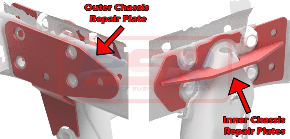

My rig has developed a gradual crack in the normal spot, so I started searching for bracket kits.
This is what I found & most likely not every kit available, just got on the web found this info:

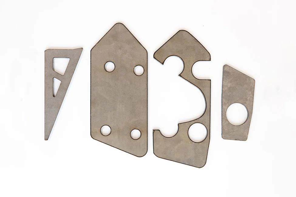

I only found one Made in the USA so I went with Delta VS kit.
Delta Vehicle Systems - DeltaVS Frame Supports - Weld It Yourself Kit - PREORDER - https://www.deltavs.com/all-products/deltavs-frame-supports-weld-it-yourself-kit
The rest of the kits are from AUS, some have more brackets to address the front panhard cracking on the frame.
80/105 Series Land Cruiser Steering Box / Pan Hard Braces - https://refab.com.au/shop/80-105-series-steering-box-and-panhard-braces/
80/105 Landcruiser - Steering box brace kit | Rampt Customs - https://www.ramptcustoms.com.au/product/80-105-landcruiser-steering-box-brace-kit/7
80 & 105 Series Steering Box Chassis Repair Plates - Black Mamba Racing - https://www.the4wdshed.com/80-series-steering-box-chassis-repair-plates

My 80 frame is not cracked, but I'm thinking of installing the Delta VS kit preventatively. It seems better to strengthen the known weak points and not get cracks in the first place. @GW Nugget and @motormayhem how did your installs go?

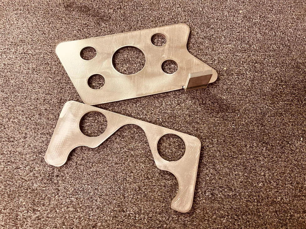

My install went well. Ended up getting a right angle die-grinder to do the stripping on the engine side and found a crack there in addition to the ones on the pan hard mount. I ended up designing my own plates up as I wanted something that was a bit different than the gen 1 Delta VS design. It actually looks like their current design is closer to what I made. I did a few weld passes to fill in the pan hard to frame rail transition under the steering box where it cracked effectively gusseting it and removing the stress concertation there. It looks like the Delta kit now has a plate that welds into that area to do the same.
