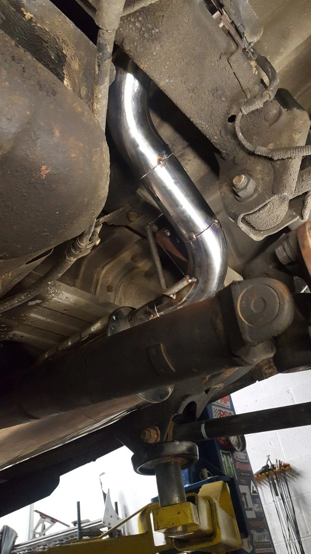

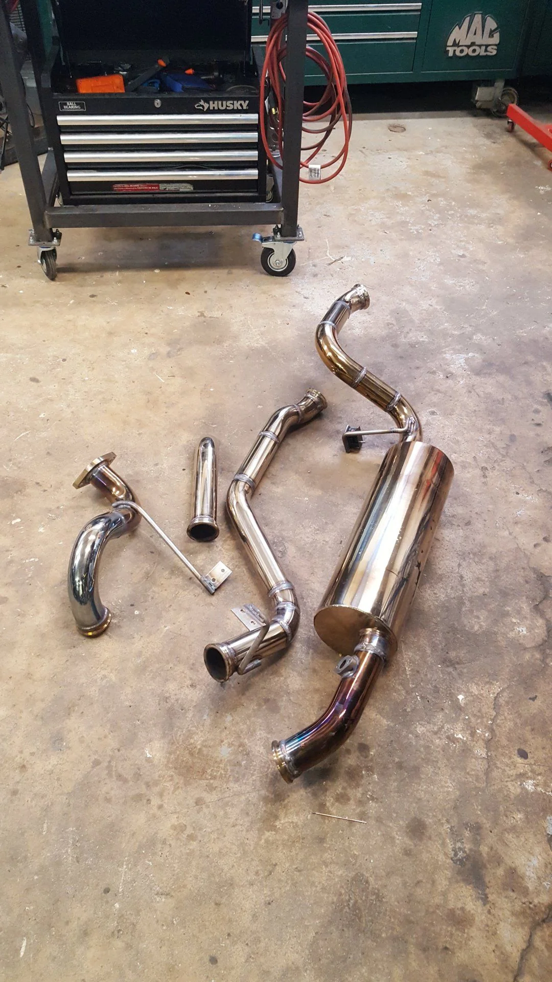

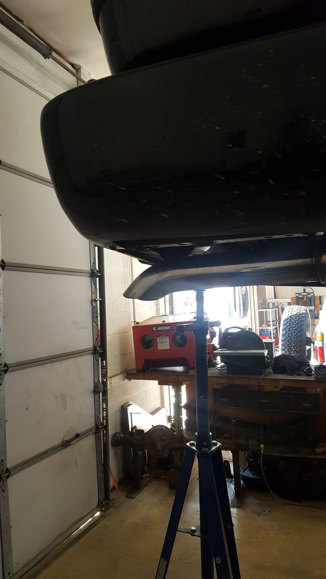

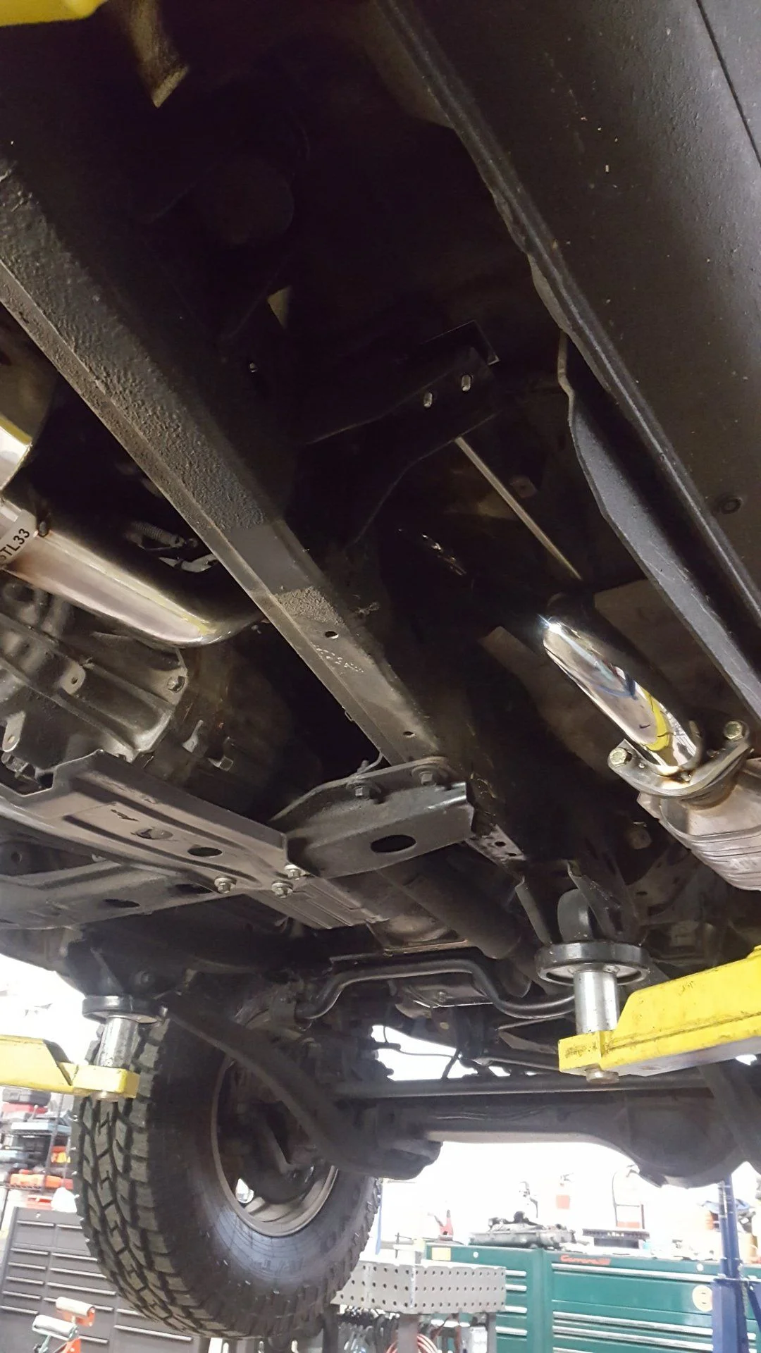

I've been working on an 80 series exhaust kit over the last few months. I've been posting about it in the 80 section but now that it's done it's probably time for it's own thread. It's 2.5" 14 gauge 304 stainless with a Solo Performance Stealth muffler. The muffler keeps it nice and quiet but still lets it flow well. I've done two sets on super charged 80's and it perks them up. It runs up over the frame rail near the transfer case. To get it up over the rail I had to leave out the rear catalytic converter. It uses the stock rubber isolators for a rattle free mounting set up. After the connection at the converter all of the joints are v-bands to allow a bit of tweaking and a gasket less seal. I added an extra v-band connection at the tail pipe to make it easy to remove prior to wheeling or easy to replace if the tail pipe gets squished. More info at Stainless Exhaust View attachment 1594623 View attachment 1594624 View attachment 1594625 View attachment 1594626 View attachment 1594627
