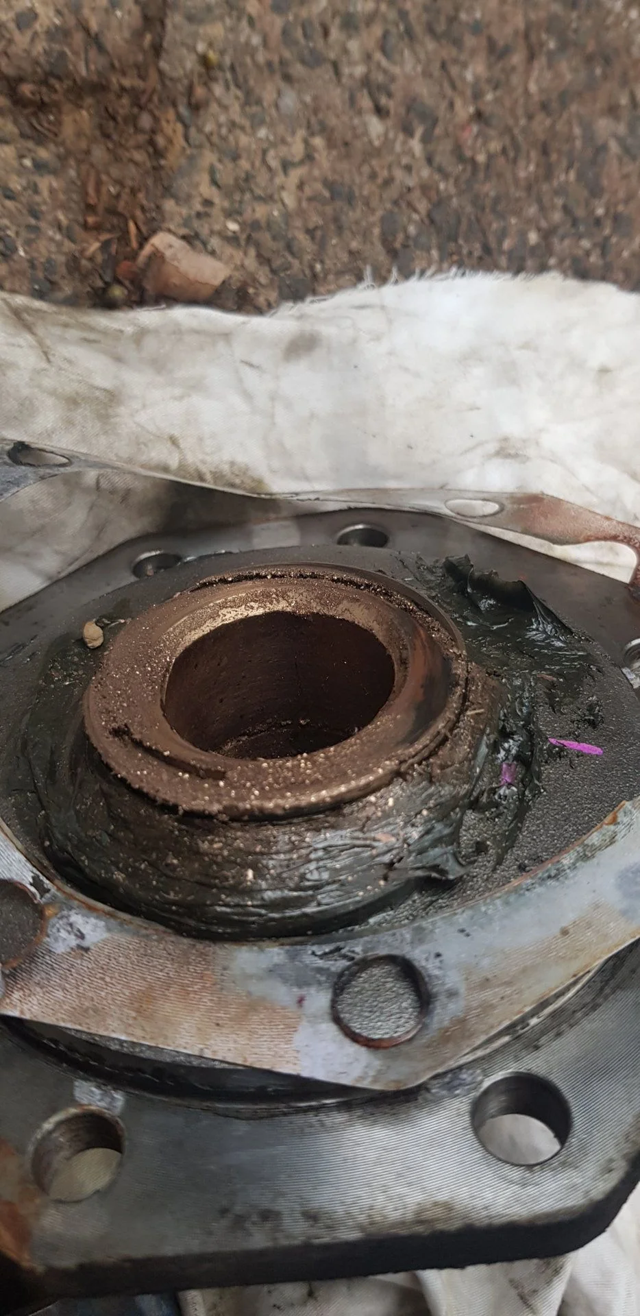

Today i pulled the axle out and found this.
I didnt grease the bushing when i first installed them and im thinking maybe i didnt put enough moly grease in the knuckle. I had packed the joint and put a tube through the fill plug but im thinking that wasnt enough.
Do you guys agree?? I thought the races in the bushing would make it self lubricate, but i spose if i didnt put enough moly in to start with it wouldnt have worked. i will be greasing them this time.

Not enough grease for sure (bushing, bearing surface of CV joint, or knuckle).

Yeah, with the bushing you want those grooves packed when you install it. Also, just one tube of grease in the knuckle sounds insufficient. Probably you need more like two or enough to bring the level inside up to at least the bottom of the hole you fill through.
Greasy balls = good, dry balls = bad, and those were dry. Needs to be half or a little more full of moly grease.

If it's this bushing giving trouble, the bushing has been superceded by a needle bearing. This gives better running performance (less drag, more MPG), but the failure mode is generally worse than the bushing. On the other hand, look at what seems to be the limp home capability of the bushing even after it was sorely abused, so there is that in its favor and some still prefer it to the bearing since it's still available.
