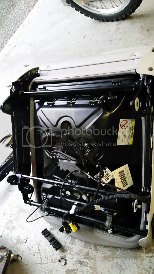

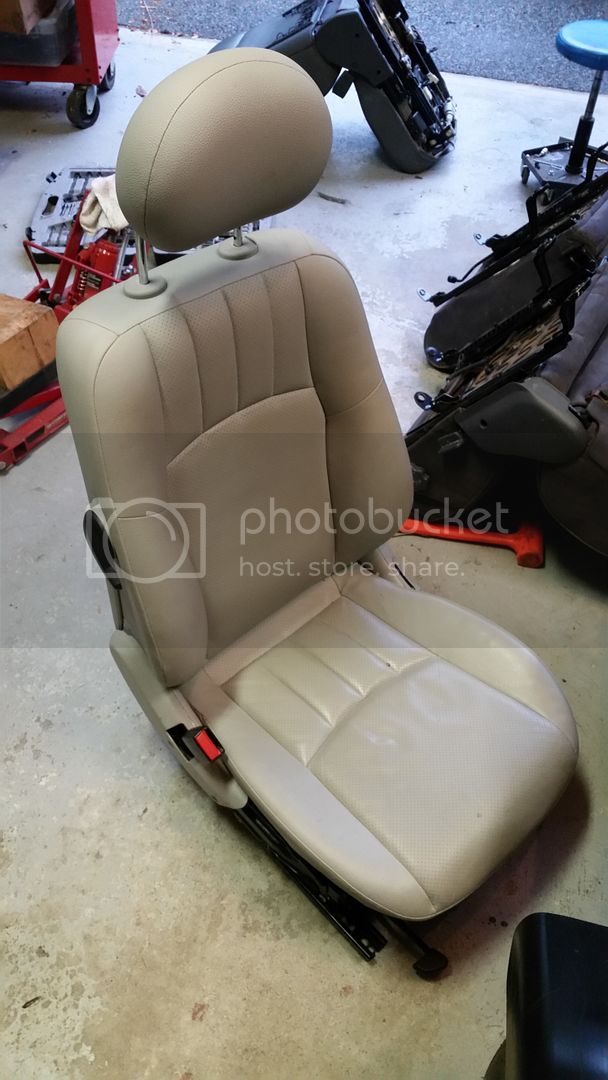

After an hour of measuring and seeing what is available I found these bad boys in mint condition from a 2005 C240 Mercedes. These have manual adjustment forwards and backwards and electronic tilt and lower section raising and lowering. Well I took a chance and so far so good.
The bottom of the seats have 4 vertical tabs and since I will need to narrow the seat rail by 3 inches I plan to simply taking some angle iron and bolting it to the vertical, then I can take the manual adjustment base from the cloth RHD seats and bolt it to this angle iron. The sizes seem close but should work, the drivers side is the big worry that I can get it centered infront of the steering wheel. I will post pictures of how it goes but here are the seats, I have already removed the Merc. manual adjustment track from the seat.

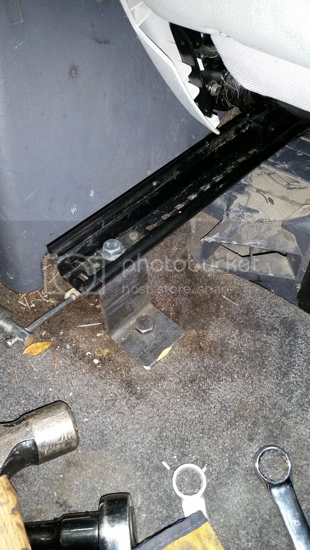

After some recovery from a dirt bike crash I finally got back into the garage and made some progress. I decided to not use the RHD land cruiser sliders but to use the Mercedes sliders. I did this because the Mercedes sliders looked beefier and to make a rail adapter from 17 " to 13.5" would require some long bolts which I felt did not make it as strong as possible. Using the Mercedes rails and then just adapting the feet seemed a lot stronger. Here is a picture of the seat as it will sit in its final resting position, it is about 1" taller than the other seat which I am not stoked on. Hopefully i can get the drivers seat a bit lower with some fancy brackets but the Passenger seat is now about 1/4 above the heater which is all I am comfortable with.
Here is the rear bracket, it has a nut welded on to capture the bolt through the sliders, I will have to make some gussets for it just for insurance. Since the seat belt is attached to the seat all the force of a crash will be going through these mounts and I want to make sure they hold.
These sliders are a lot longer than the Toyota ones, I can get the back of the seat about 6 inches from the front of the rear row and then slide it all the way forward until it almost touches the glove box.

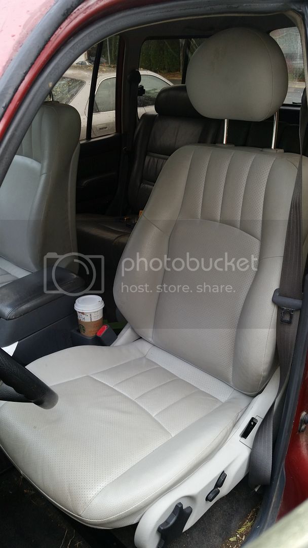

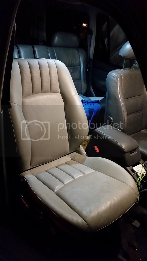

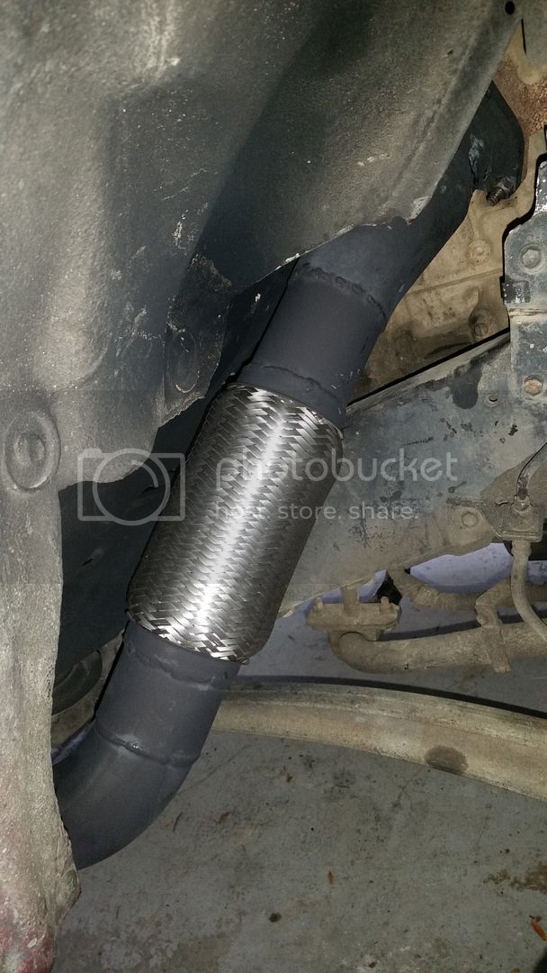

Well got the drivers side done on Friday, it is actually lower than the passenger side so it is the perfect height, I think I am exactly where I was before with the other seats, these seats have a higher back, they are about 4 inches higher and a much higher headrest so I can actually adjust it where it needs to be. Here is the final pictures.... Also welded a new flex coupler into my exhaust, rebuilt my power steering pump and added a new valve cover gasket, all in all I had a productive two days. And since everyone likes pictures.
And some shiny bits.
Yes the exhaust is painted black... and everything around the exhaust is black because of the soot from having a rotted out flex joint
