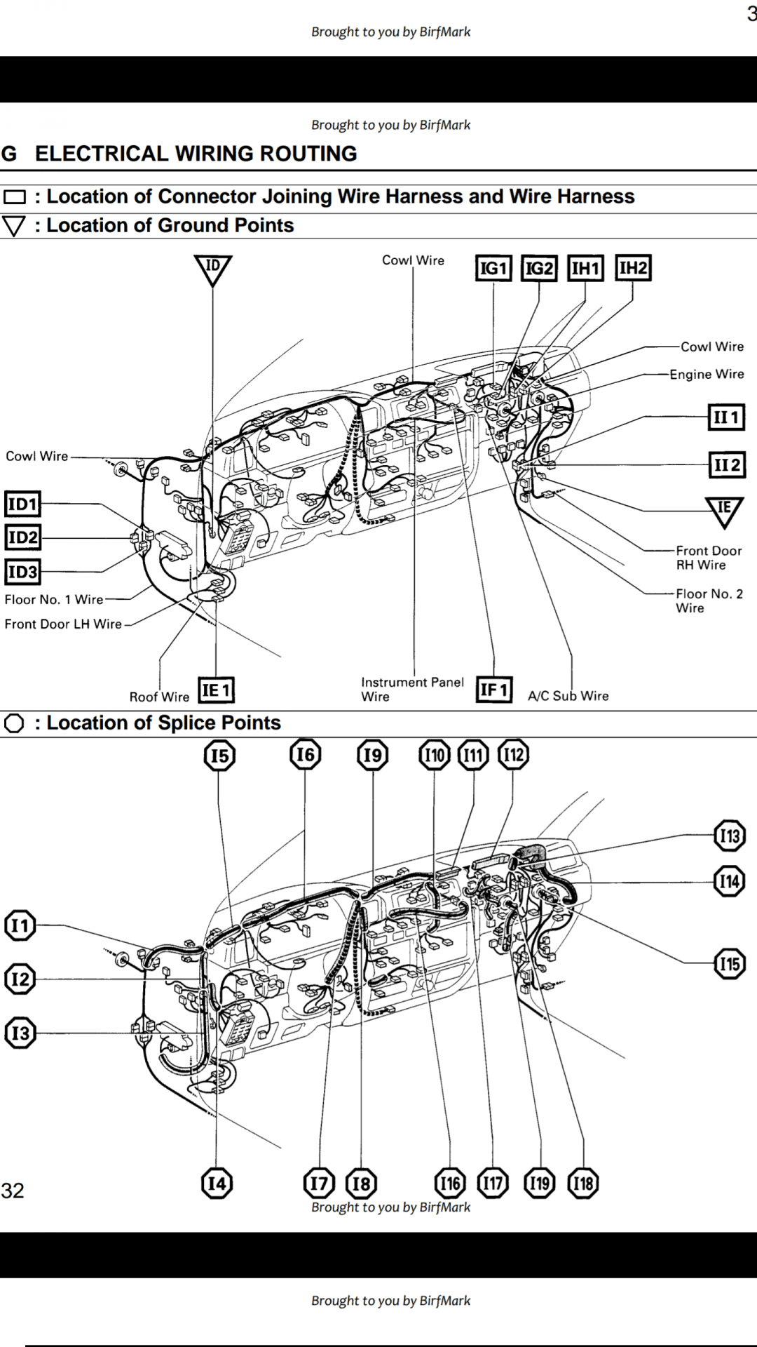

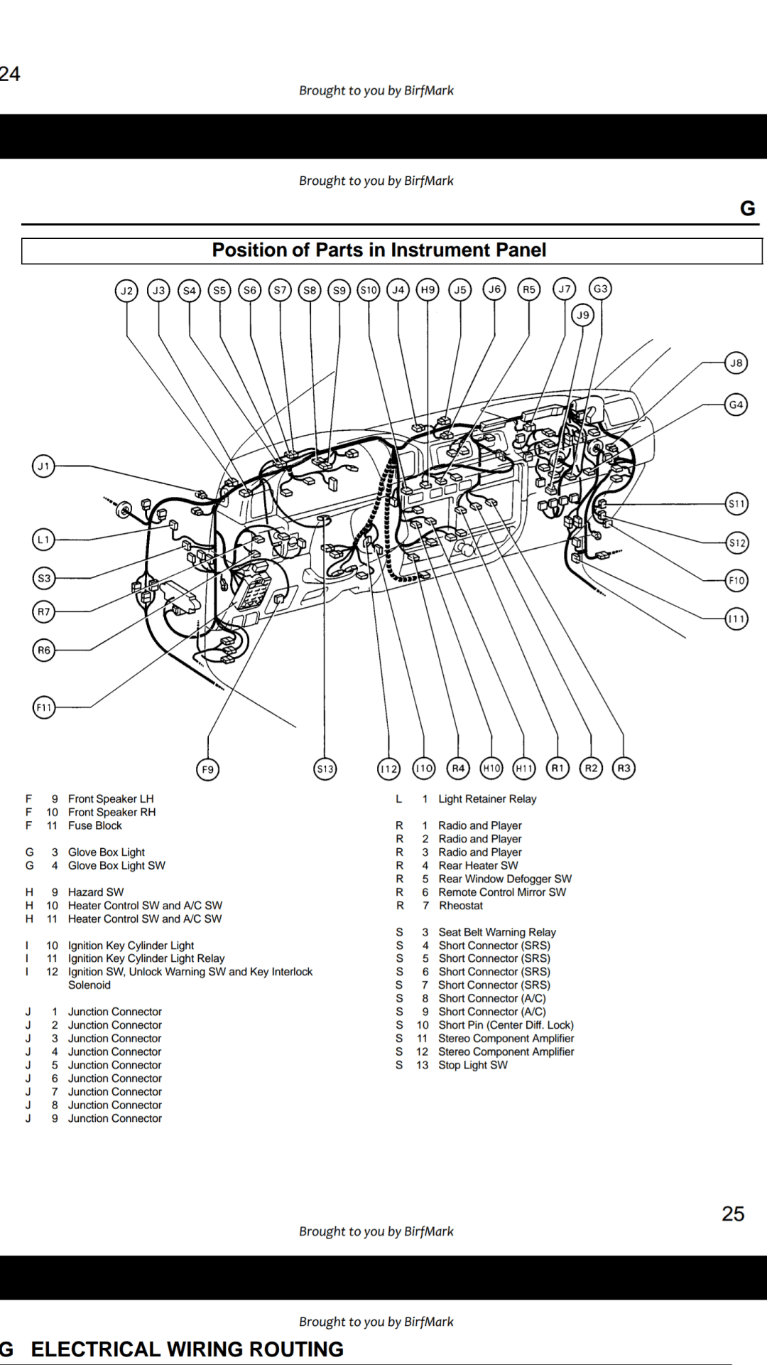

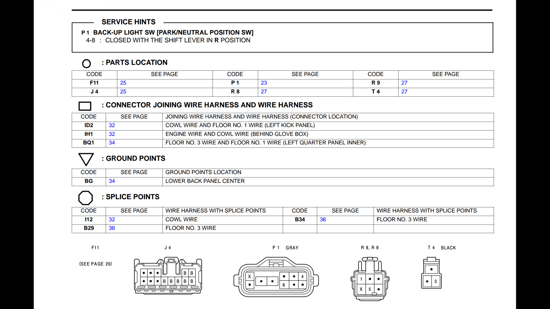

The EWD is your friend.
Thanks . Let me make sure I got this right if I went with ID2 thats red with a black strip behind the left kick panel that should be the line after the switch and after the dash light and on its way to the back to the backup lights . To check if I have the right one I can just disconnect it at ID2 and put the truck in reverse and if I don't have backup lights and I did before I disconnected it I got the right one and I can join my reverse line from the radio into it right ?

The port that is highlighted with sharpie is where you're looking to go. the wires might be different colors depending on year but it'll work. Did this about a month ago in my 97 lx450
Thanks Lastresort thats not what I thought it would look like going by the wiring photo ,I thought it would be 3 separate smaller connections with only 1 or 2 wires coming out of each connection . I would have never found it . My radio has a built in switch so when it gets power when you put it into reverse the camera turns on by its self or you can push a button on the unit and make it come on any time in case you want to watch what your pulling . I will unplug that wire and make sure the backup lights don't come on .Thanks for your help and MDarius's help .
more easily you could always use a multimeter instead of the other. I hate screwing with 20+ old plug connectors if I don't have to..Too easy for things to break.
