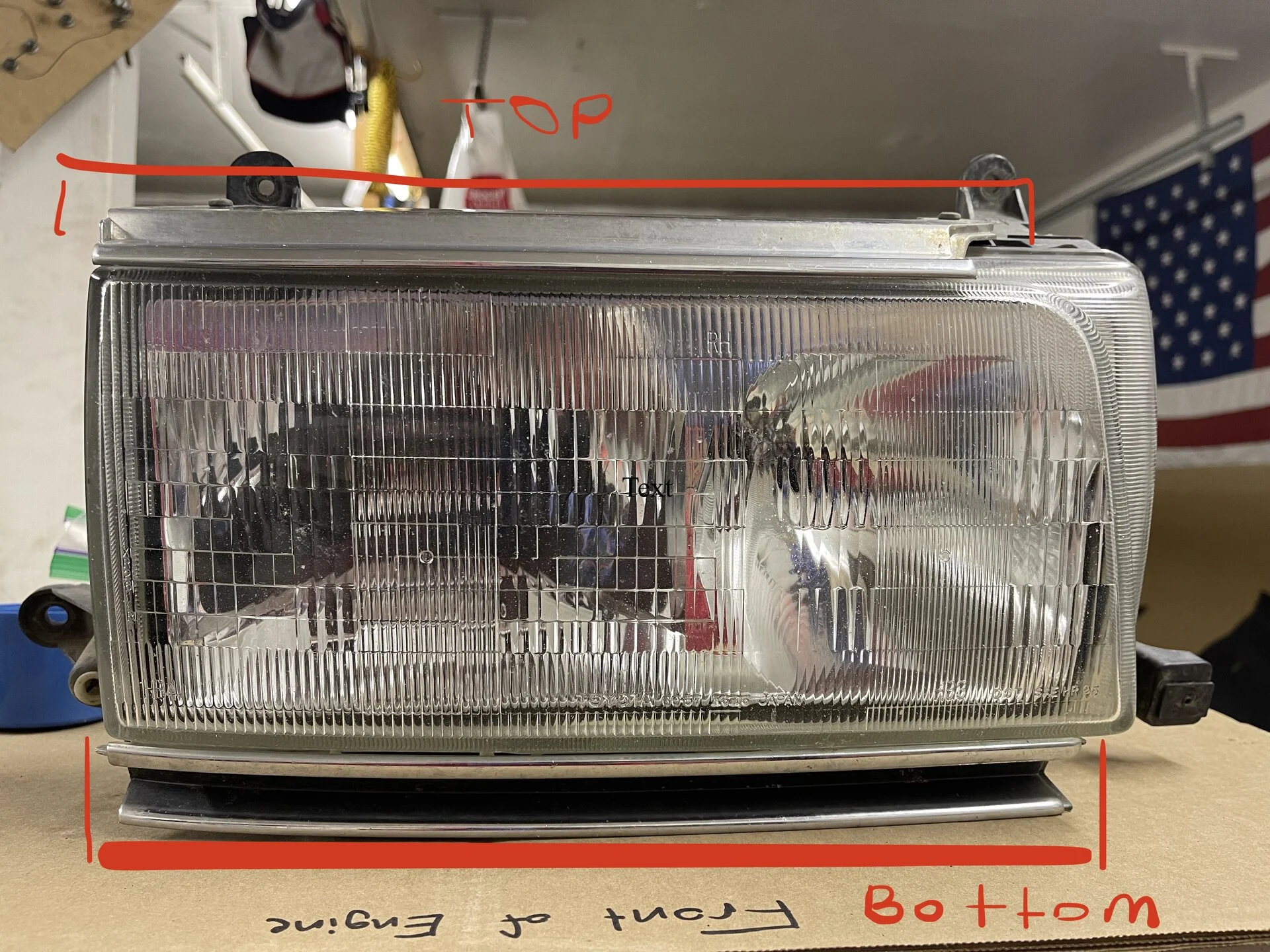

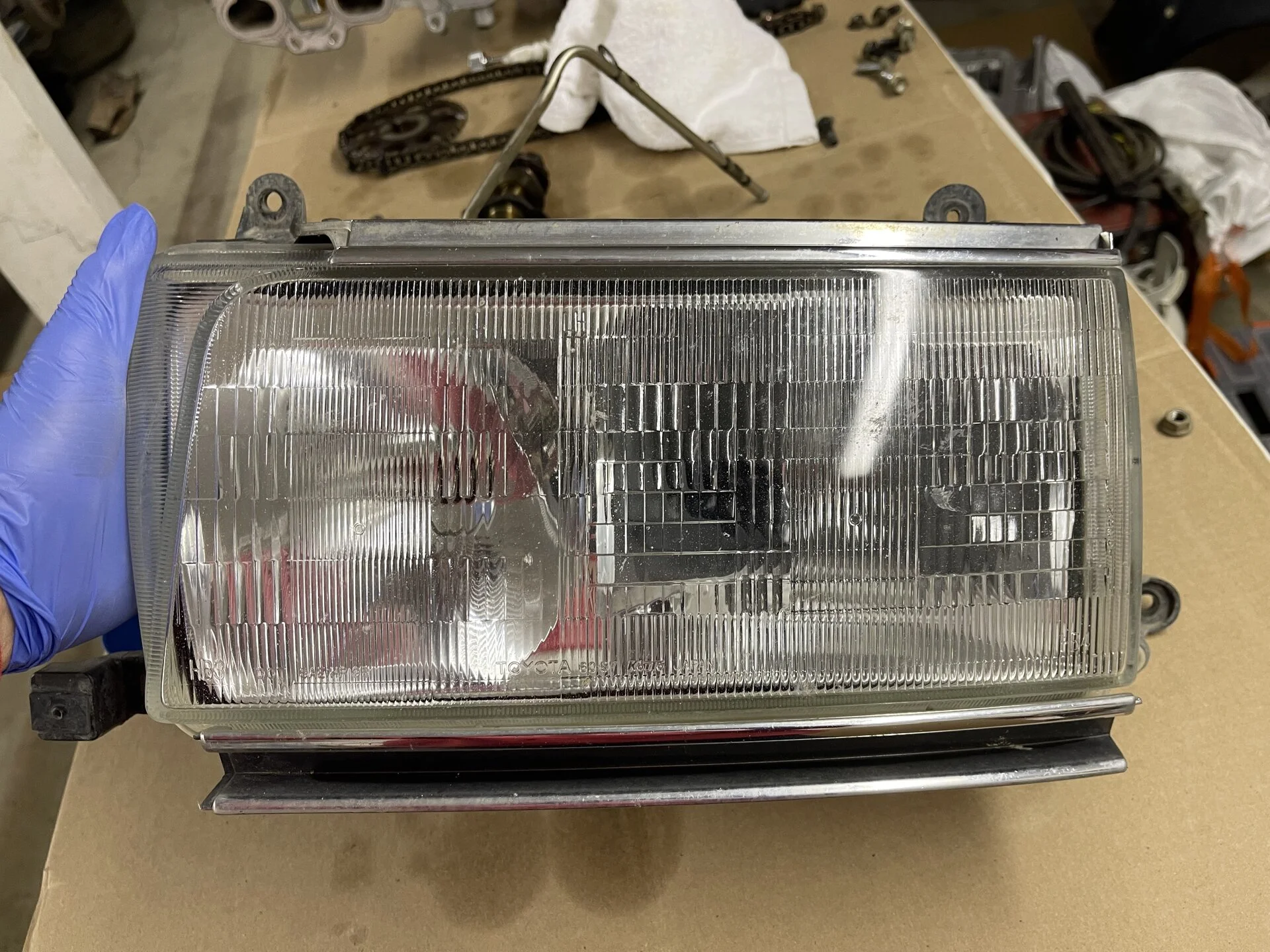

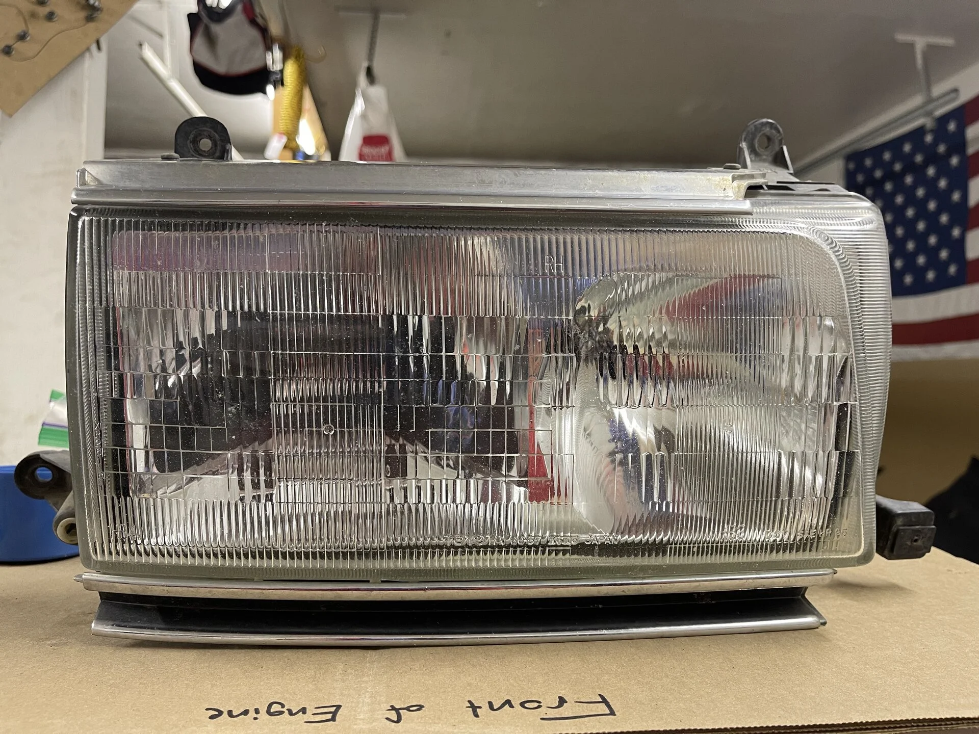

After a lot of thought I'm going to swap out my LX450 front end and replace it with a 93/94 style front end from a LC. That being said there seems to be a few differences between the years which will affect the overall fitment and I want to make sure I'm buying the proper parts. :wrench: So please correct me if I'm wrong!
Based off of my searches on our forum looks like ill need the following:
  • Headlight LH/RH (NLA)
  • Lower Valence (still available from Toyota 2/23)
  • Grille (still available from Toyota 2/23)
The US Land Cruiser headlights are different for the following years, and proper grilles and lower valences will be needed for the following
  • 91-94
  • 95-97
The headlight trim pieces (according to parts.toyota) seem to be interchangeable but there are different part #'s for the different years. (still available from Toyota 2/23)
Additionally, how much would a complete set of LX 450: LH/RH Headlight assembly (with trim pieces), Grille, & lower valence w/ turn signal lamps sell for?

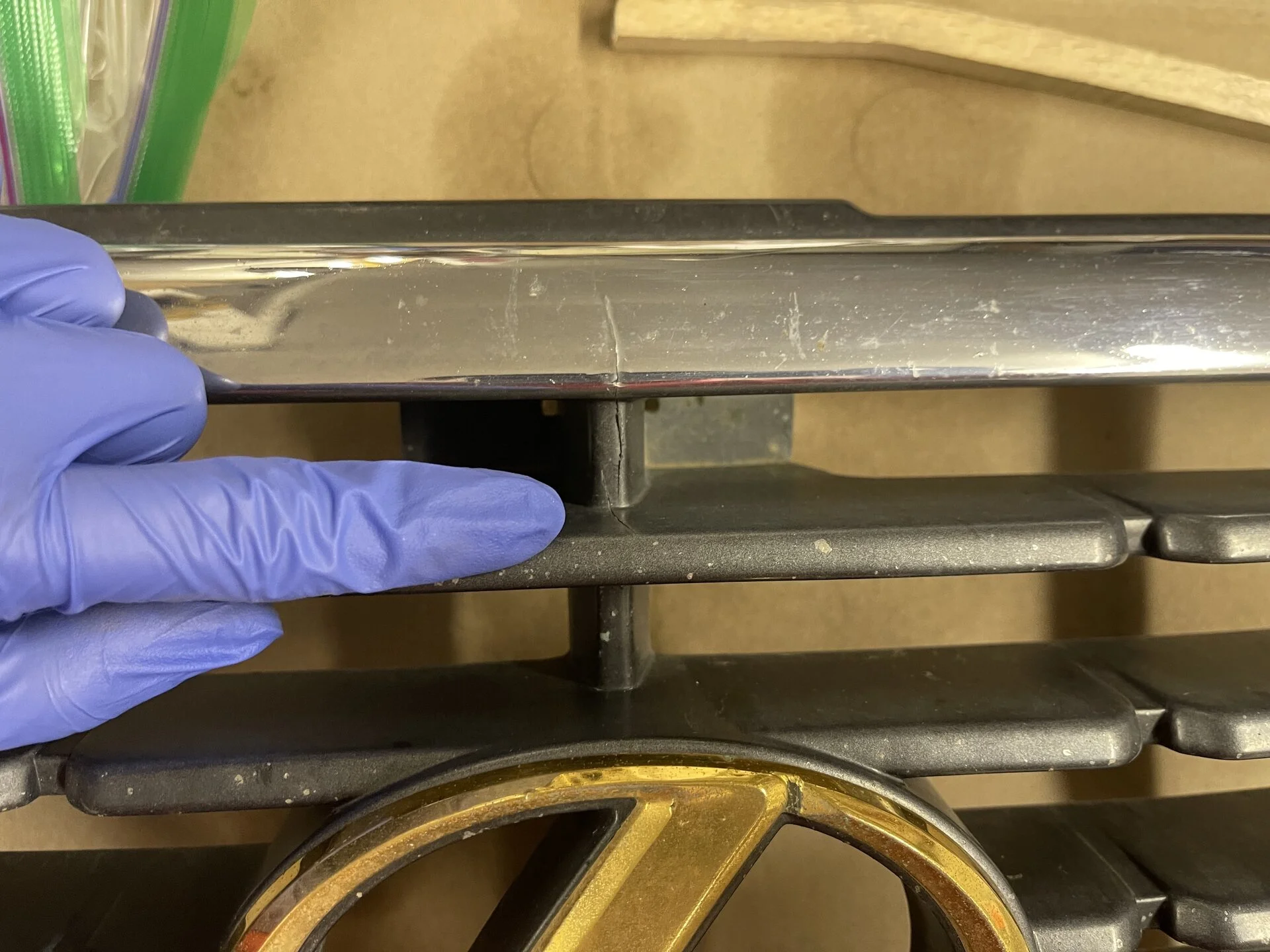

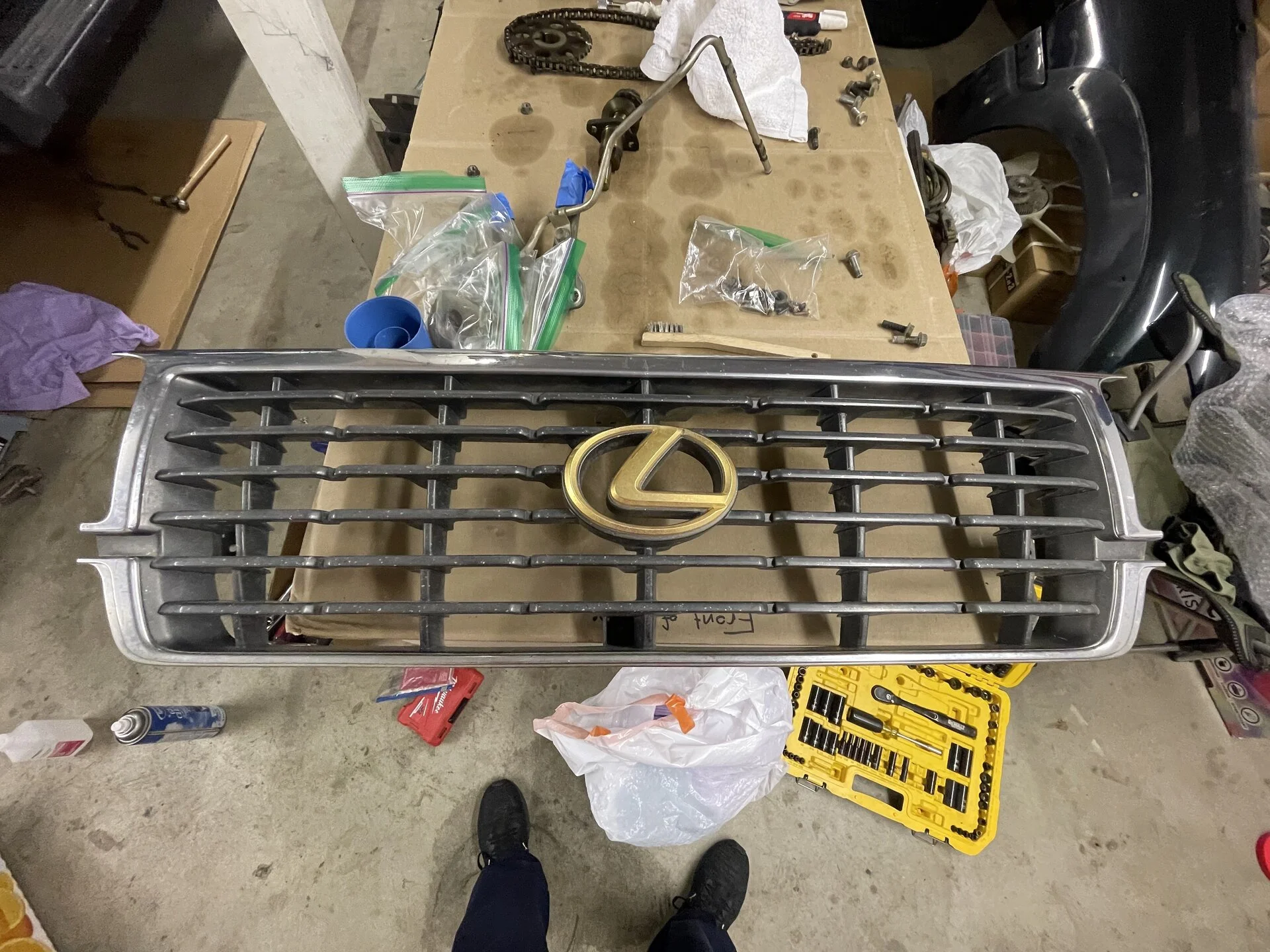

All are in excellent condition although a bit dirty, with the exception of the grille (small hairline crack towards the top)

The grill for the 91-94 Land Cruiser is an updated part number. You will find it has three holes on the left side. Why? For the Turbo emblem used in non USA trucks.
if you don’t want the holes you will need get a used part from USA spec truck 1991-1994 in a junk yard.
I already got it! A little bit of epoxy wouldn't hurt to fill in the holes, I'm planning on painting it anyways.

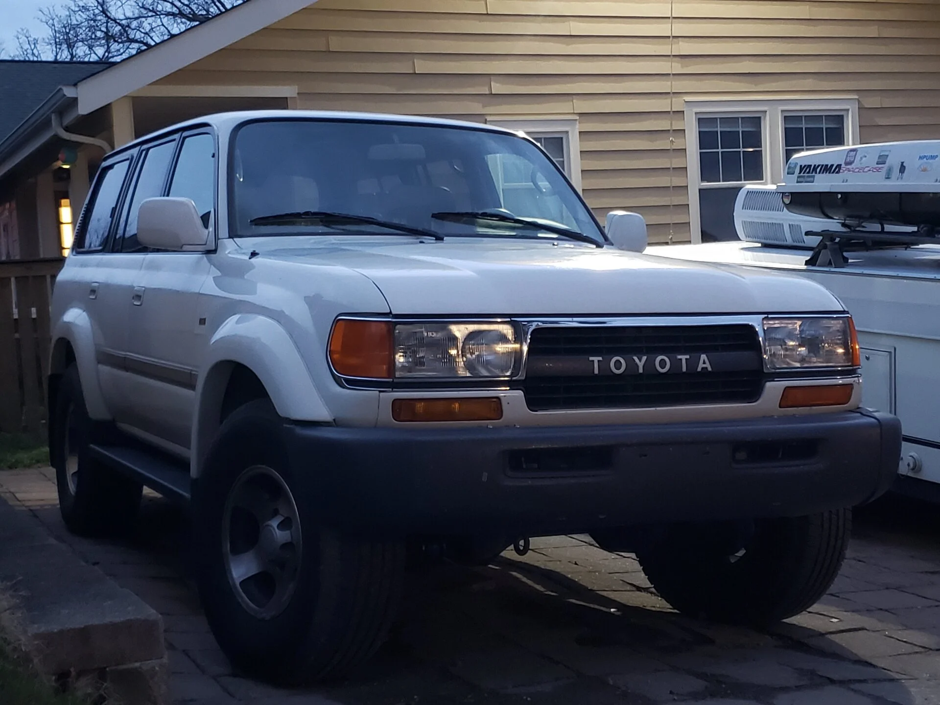

You don't really need anything other than the grill. The gap at the valance is pretty minimal. Pic of my 97 with only the earlier grill installed
