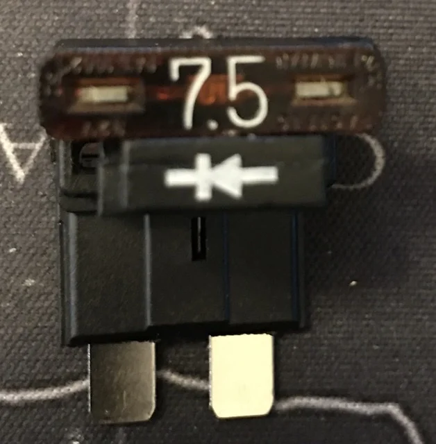

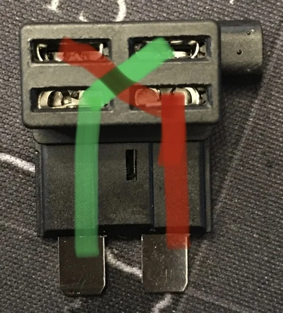

So is it me or does Mike at Ob have something adverse. My alt output is 14.7 on a stock setup 96 1fzfe. Agm in the start position only current accessory is m12000. I’m going to be adding a second battery fridge and radios. Maybe some lights. Do I need this diode upgrade? I have one not yet installed. Like which way does it face? Or how do I figure it out for correct direction ?

did he just cram a 1A diode mini fuse into a standard fuse atc/ato fuse slot?

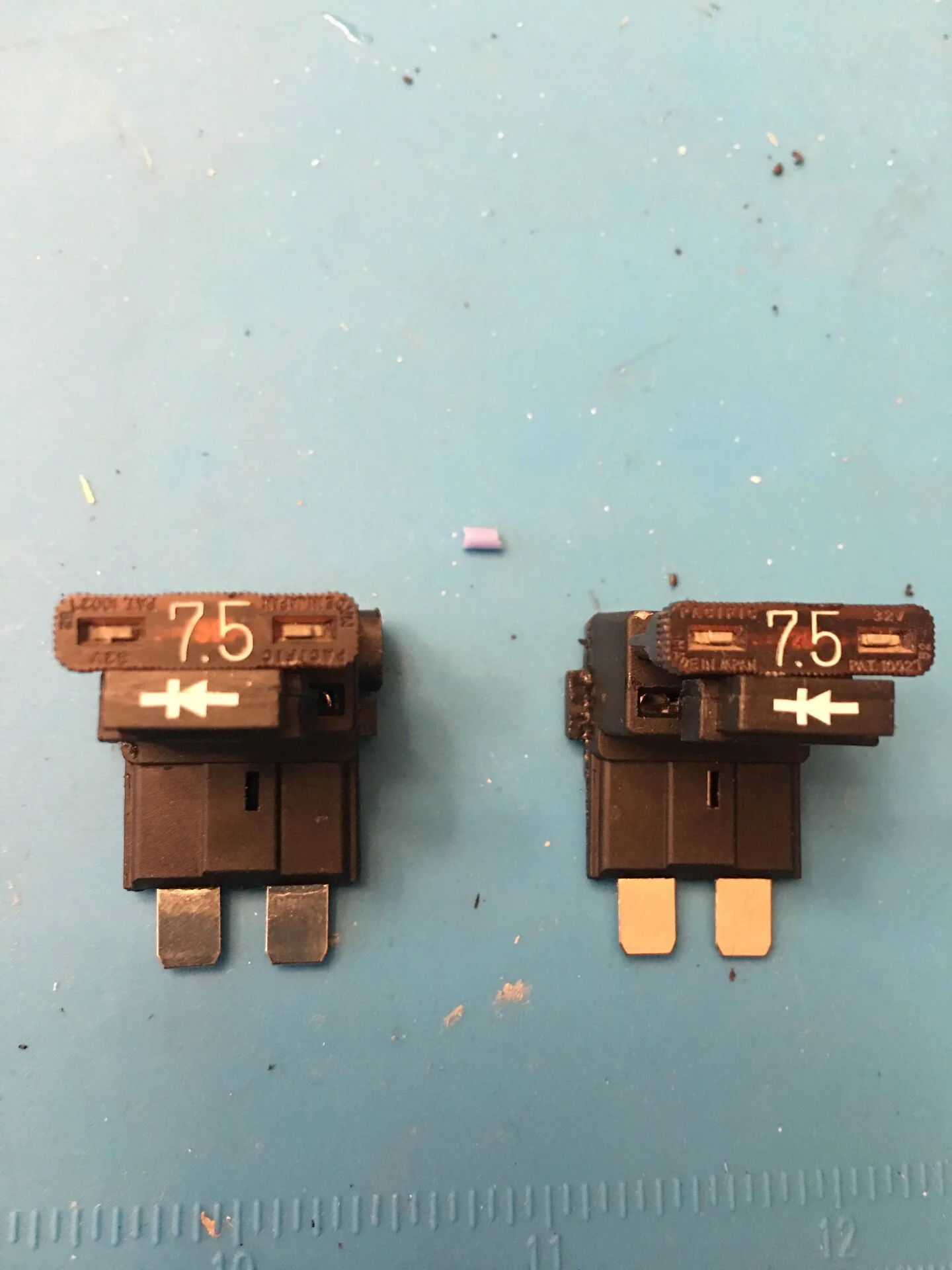

found on the 100 series forum i like this low profile design i just don't like how the wire is coming off the side
im thinking ill do a internal version take apart a fuse tap and wire in series.
from this
to this

There was discussion earlier is this thread about doing a 1A Diode in place of the 7.5A fuse for the alternator to increase the ability of your factory alternator.
I just ran a 2 gauge wire from the positive side of the starting battery to the alternator. I checked voltage with the LC running. The starting battery was just over 14 volts, the house battery was 12.7 with out the Blue Sea ML-ACR on, with the ML-ACR on it was over 13 volts. So for now I will go with this as I am happy with the results and the LC idles smoother as well.
