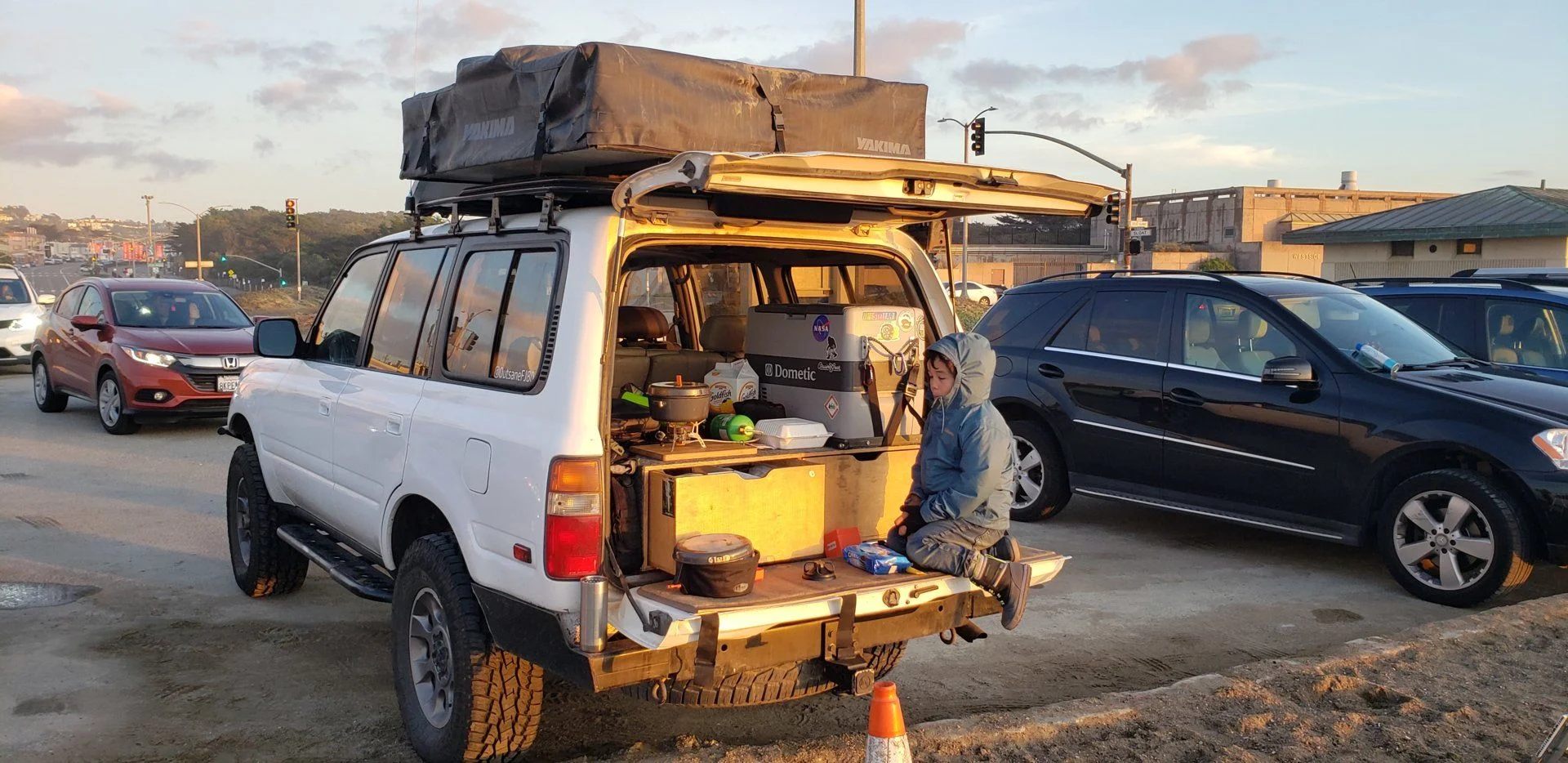

I have the LABS bumper. Wish I had integrated a trailer wire receptacle and recessed cut outs for rear facing floods. Lights that would illuminate out to 30 degrees to the sides also would be on my wish list.

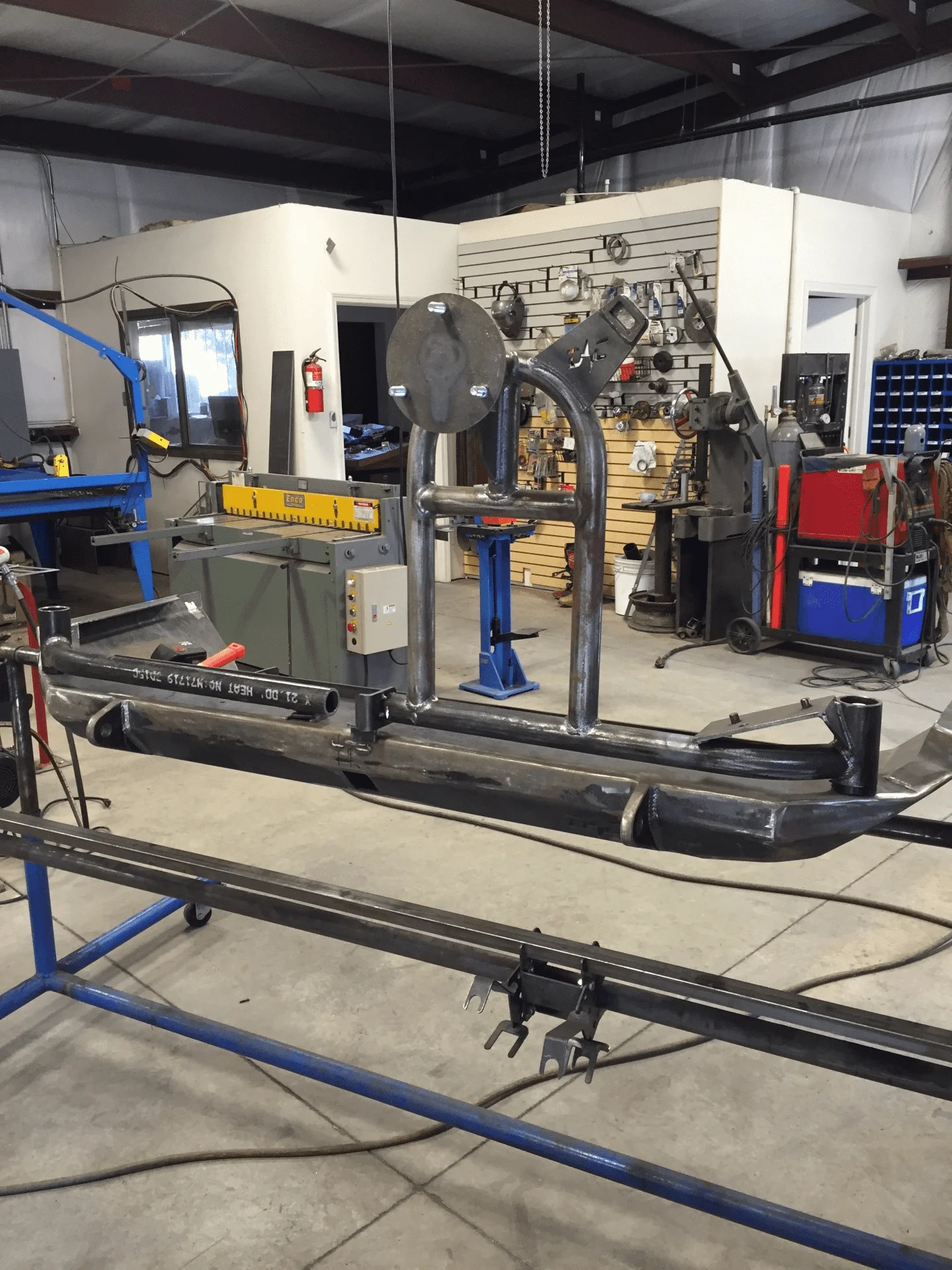

the rear I had used the 6 bolts from the carrier, the 4 from the spare hoist, and bolted the front wings to the frame using the stock hanger location from the resonator. Made a captive nut plate for the driver side to match. You’d be amazed how the wings can flex if you come down hard on a rock. Pic from when I was building it.
on the wing movement, I can imagine. The wings tips are pretty far from the captive nuts. That’s a long lever.
