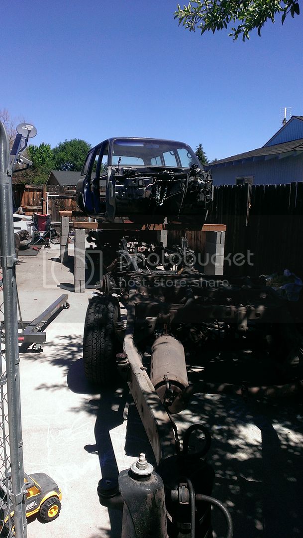

You mean like this?
Its a 92 going on a 96 frame. I picked up the flopped 96 with a low mile babied drive train after I drove the 92 for about 50 miles after buying it and the motor took a dump. A lot of guys here just throw money around like its nothing. I am back in school full time at the age of 39 and dont have that money anymore. I bought the 92 for 1200 bucks and it went poop soon after. I found the 96 at a wrecker and got it delivered to my house for 1500. Yes its a lot of work but I am richer on skill and time than I am with money right now. I can also go through and pick and choose the best parts from each. I also found the dash wont work but you can just switch out the center box with the climate controls into the older dash. In my case I have to switch wiring harness and all the heating and air too, so you need to do the dash section too. I have the best of both vehicles. I am just about ready to do the monstaliner to the underside and firewall and inside. Then I will do FatMat and install the interior out of the 96. It too was spotless. Then I will be doing paint. I have parted out alot of parts and just found I am into the donor about 200 bucks at this point. I just have to sell a few more parts and I will be in the black. Again..... alot of work, but I dont have the money to just buy a different one.

Gosh that single stack of cinder blocks looks shady.
Go
I used the cinder block method. Single stacked also. I put 4x4 posts inside the blocks, with a 2x8 screwed to the posts, to add stability. However, it wasn't necessary, since the blocks are incredibly stable. I have a 2-3* slope for my driveway, so I added a couple scrap blocks to keep the pipes from rolling.
I wanted to do this in the garage, however, my garage ceiling height is a shade too short.
The bottom picture is how it sits now.
