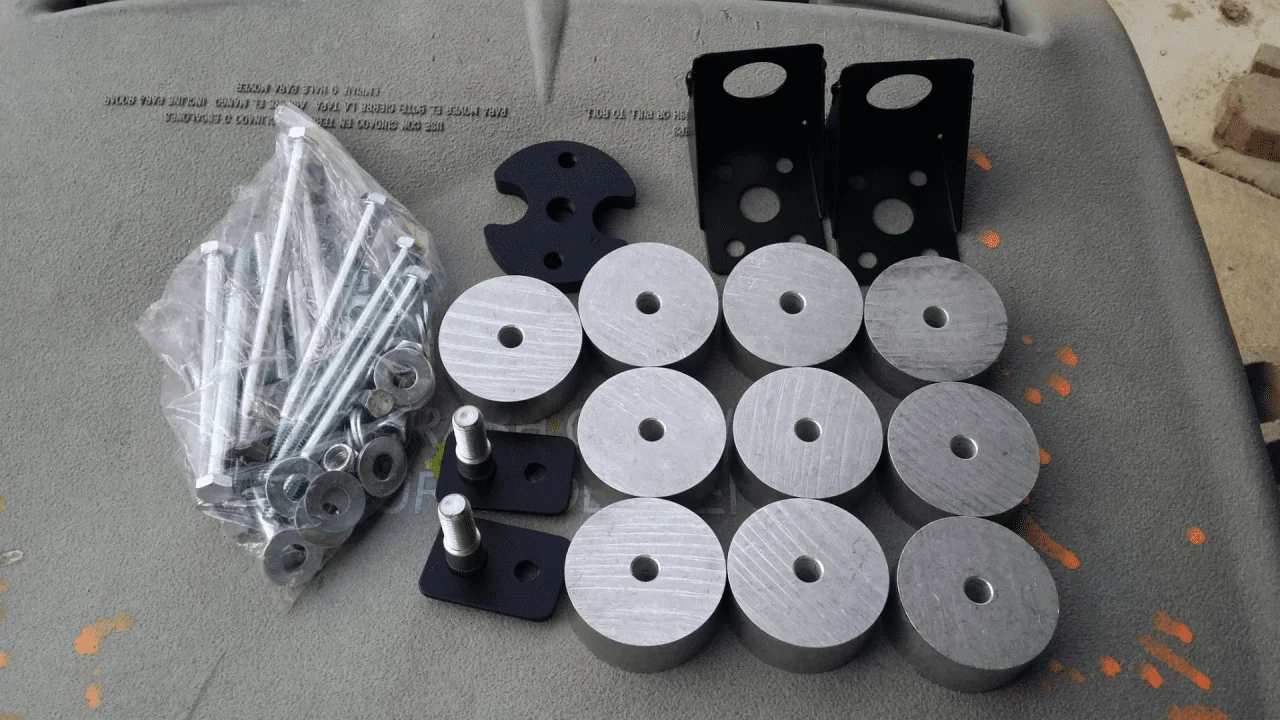

I just got this 1" body lift from Duiser.com, it was a long wait but after I received it I noticed some changes, changes for the better. All the pucks are now aluminum & they added a steering spacer that was only for the 2" kit. I don't know if they where having problems with sourcing the poly pucks or if this was a one off to fill the order, but the product looks to be of good quality & I'm a bit excited to get this on & report back with my findings. Here's a pic.

I just recently installed a Duiser body lift kit said to be a the only complete kit on the market. I'm really happy with it. The install went very smooth & hear is how it went. My rig is very clean underneath so I didn't have any rust to deal with. It can be done in a half day easy if you stay focused. I have small curious kids that want daddy time so I did it slowly with many family breaks in about 10 hours. Here is a pic of the parts.
The first thing I noticed was the all aluminum pucks... I don't know if that was just a one off to fill the order because of resourcing the poly good or bad for corrosion, but I live in the desert, so I'll move on. The bolts are 3/8" by 5", 5.5" & 7". The 7" are for the front & 5.5" for rear. Don't get them mixed up like I did.

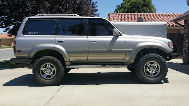

The radiator bracket did not fit my 97 LX very good so I modified it. In the picture below is a metal strap with a wheel lug stud in it. It was hitting the support & making it go up at an angle. I installed the stock bolt in there & it fit better. I have no after picture. Sorry. Other than that it went in just fine. Here is more random pics.
