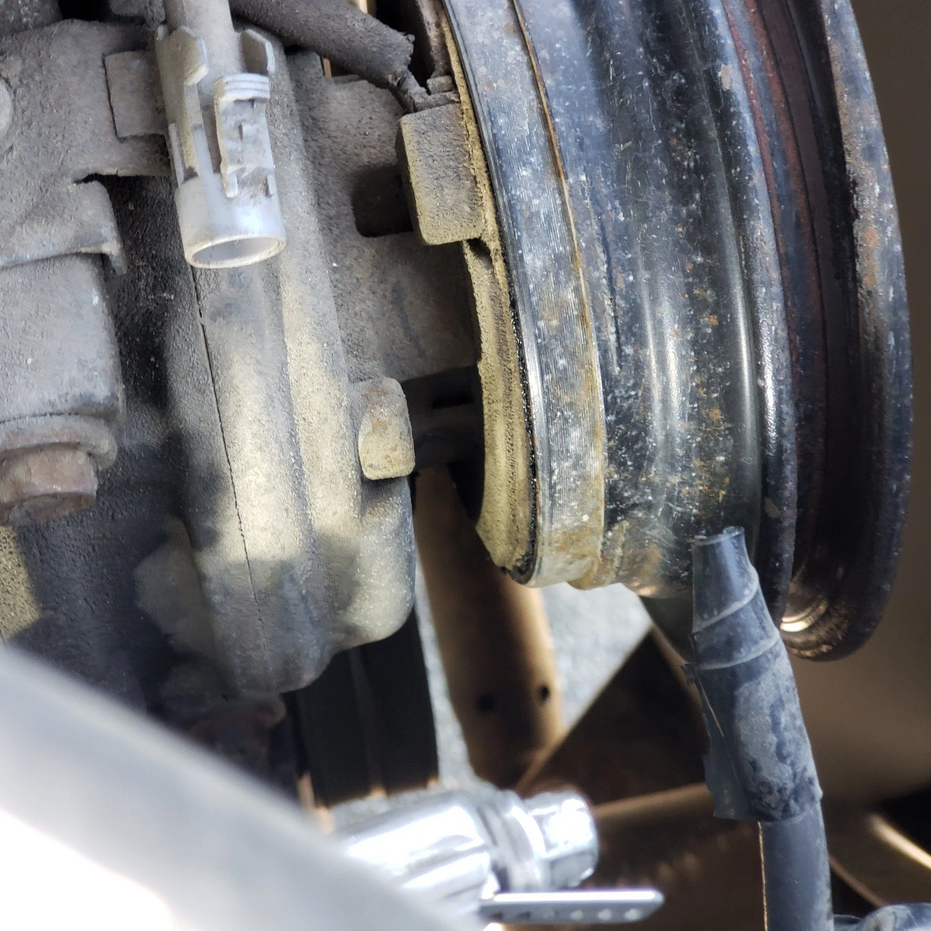

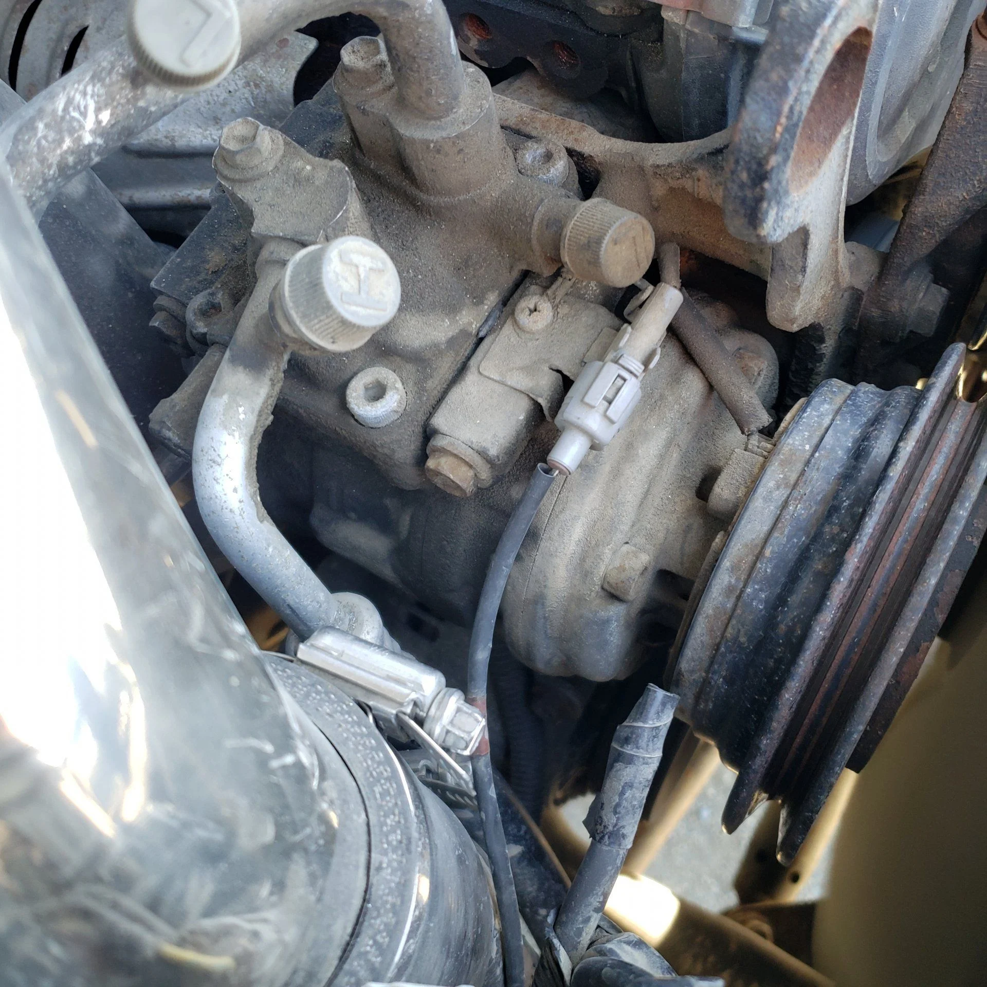

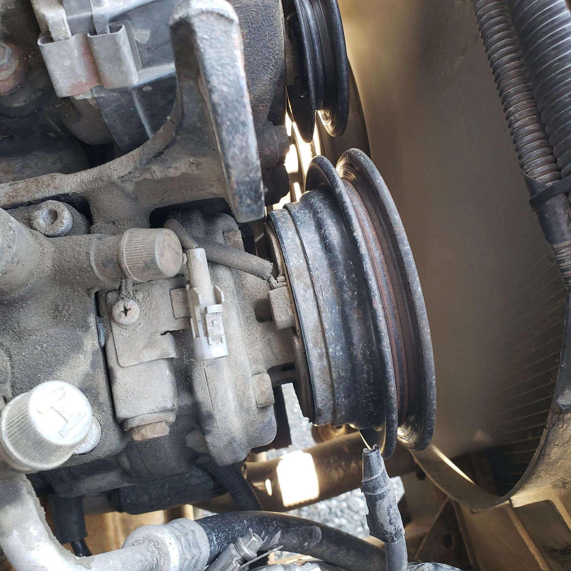

Well, the AC compressor clutch decided to check out. It's from a 96 JDM 1hdft, engine came from a half cut so I have no VIN and am trying to figure out the best route to go.
Partsouq doesn't have any complete units. They do have the clutch assembly & various parts for the interior of the compressor itself. Just want to get everyones thoughts.
Any sources for a complete unit?
Should I just replace the clutch assembly? Or rebuild the entire compressor?

What is the part number/model compressor, do have a pic of it? I wouldn't recommend trying to 'rebuild' one, it's pretty involved. I imagine a new/reman is available.
Toyodiy lists the on as 88320-60630.
Anyone else beside CruiserParts.net...
Called and spoke with John at cruiserparts this morning, he told me if the website doesn't say back ordered the part should be on is way shortly. Just in case I took screen shots of the page after reading the terms and conditions. Hopefully, the coin toss goes in my favor.
Amzn had the Denso compressor at a decent price last time I checked.
Seems like @Lumpskie went through this recently...
That's a 10PA15L. That's a tough one to find although I do have one supplier that has the correct body and can put the single groove clutch on it to make a complete unit. It's new, although it's an aftermarket not a Denso brand for the same $299+shipping.
