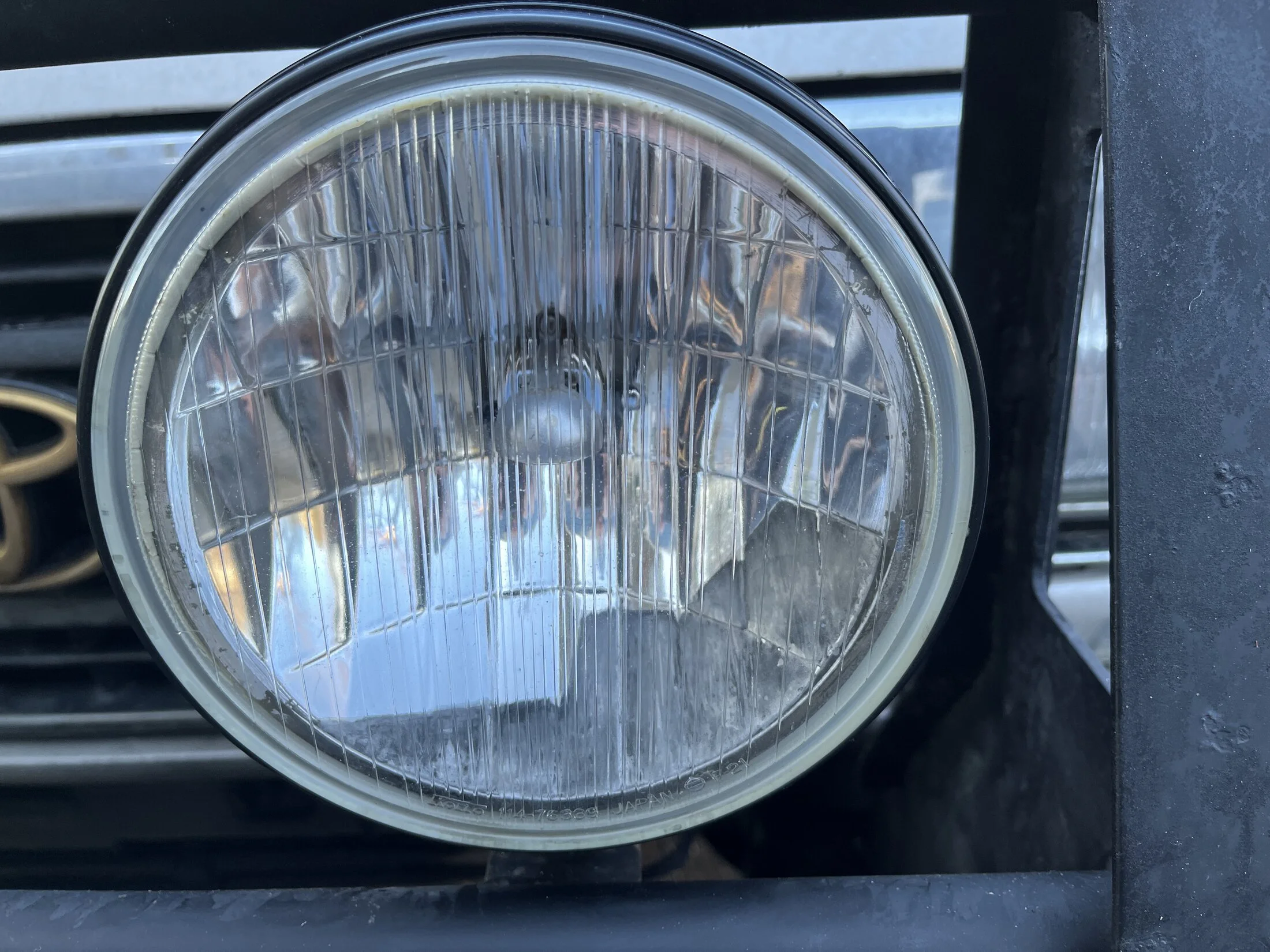

My Glass sealed headlight got water in it and it’s beginning to rust inside making the reflection element(paint) not reflect effectively anymore.
My thought is to open it up, sand it down and order the German Revell Chrome spray paint from Ebay and re-do the reflective area for better visibility. Has someone already done this ? Is there a trick to opening up the Glass-plastic seal?
Is there a video on this ?
Any help is appreciated.

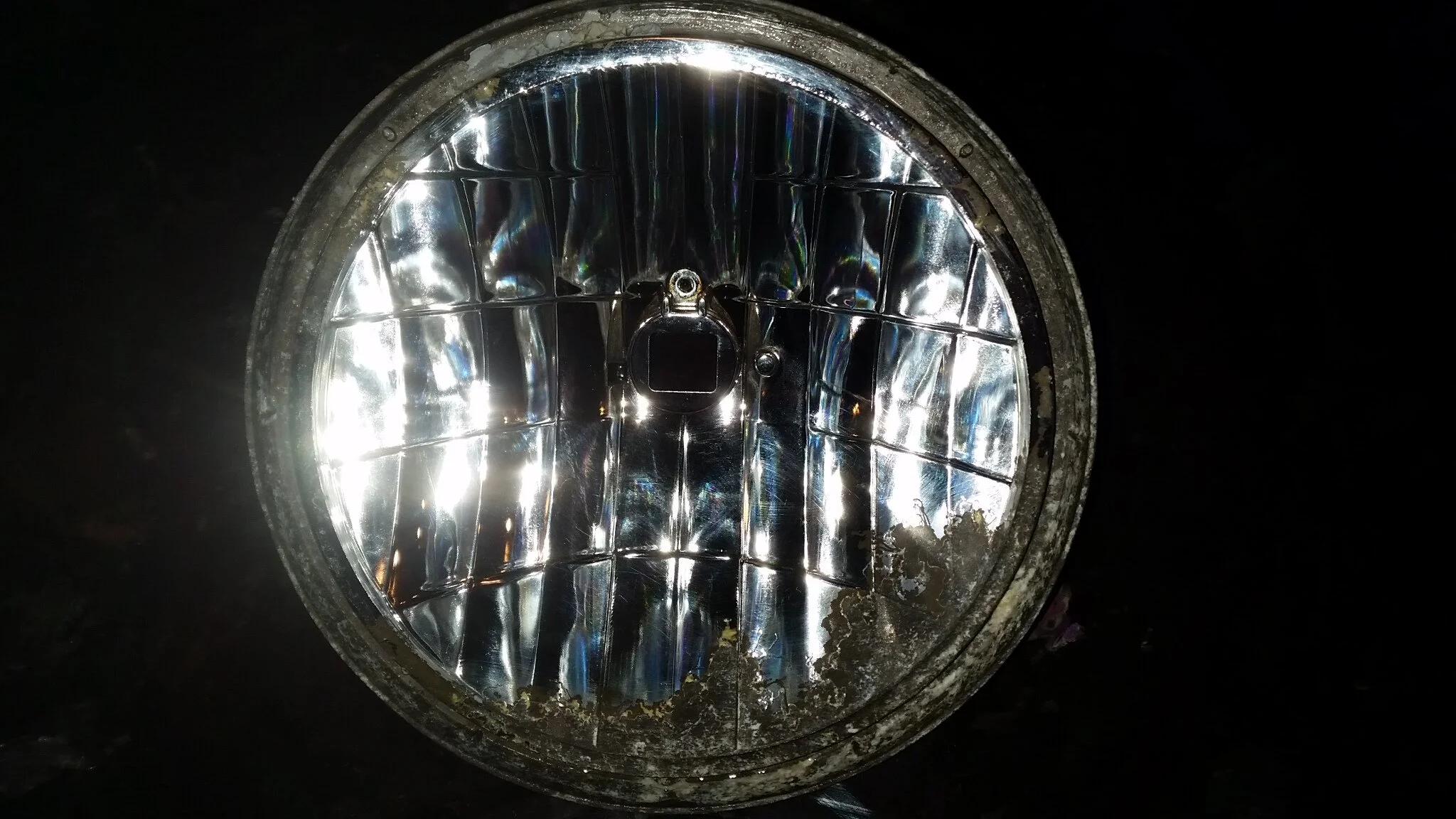

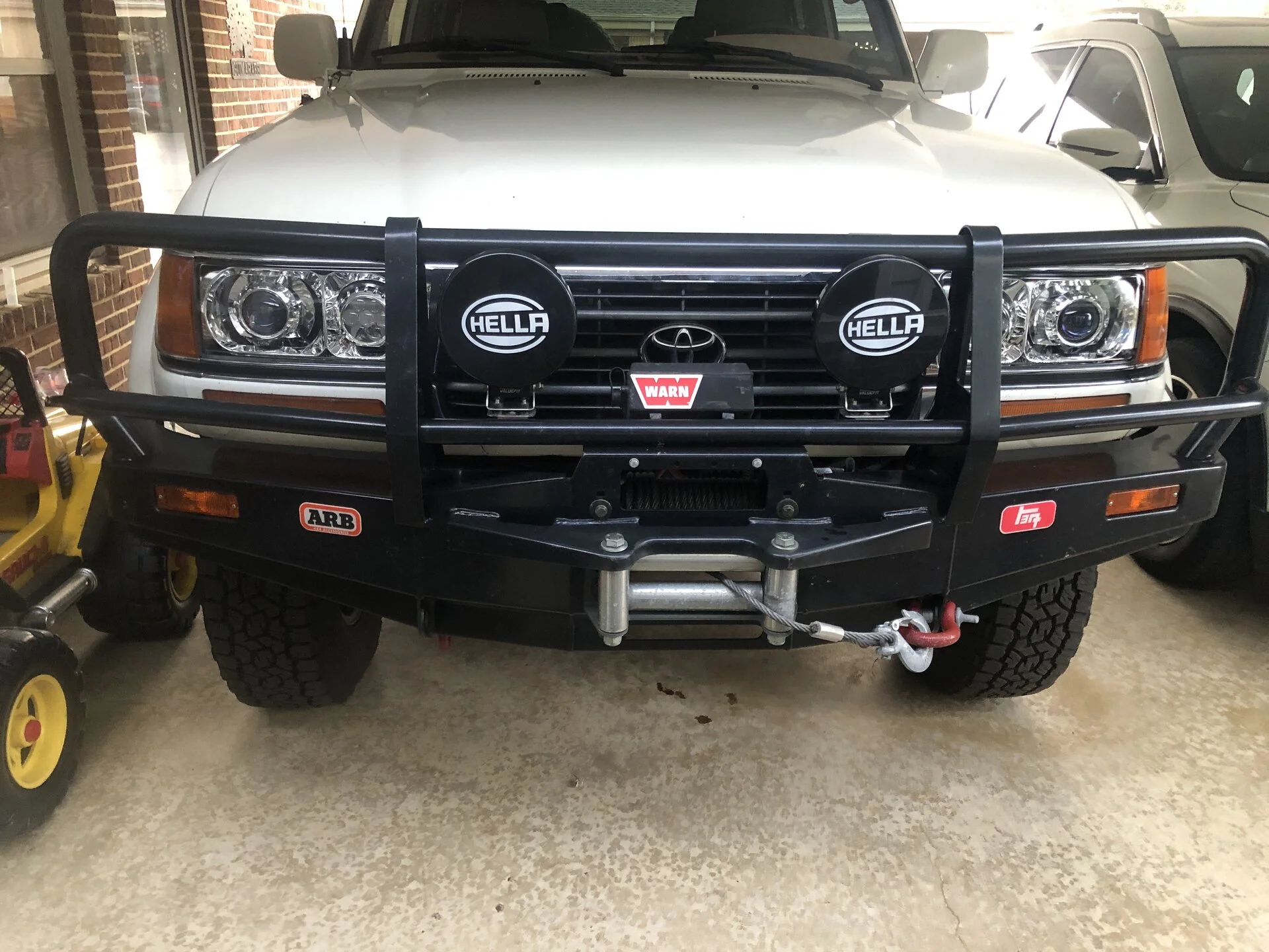

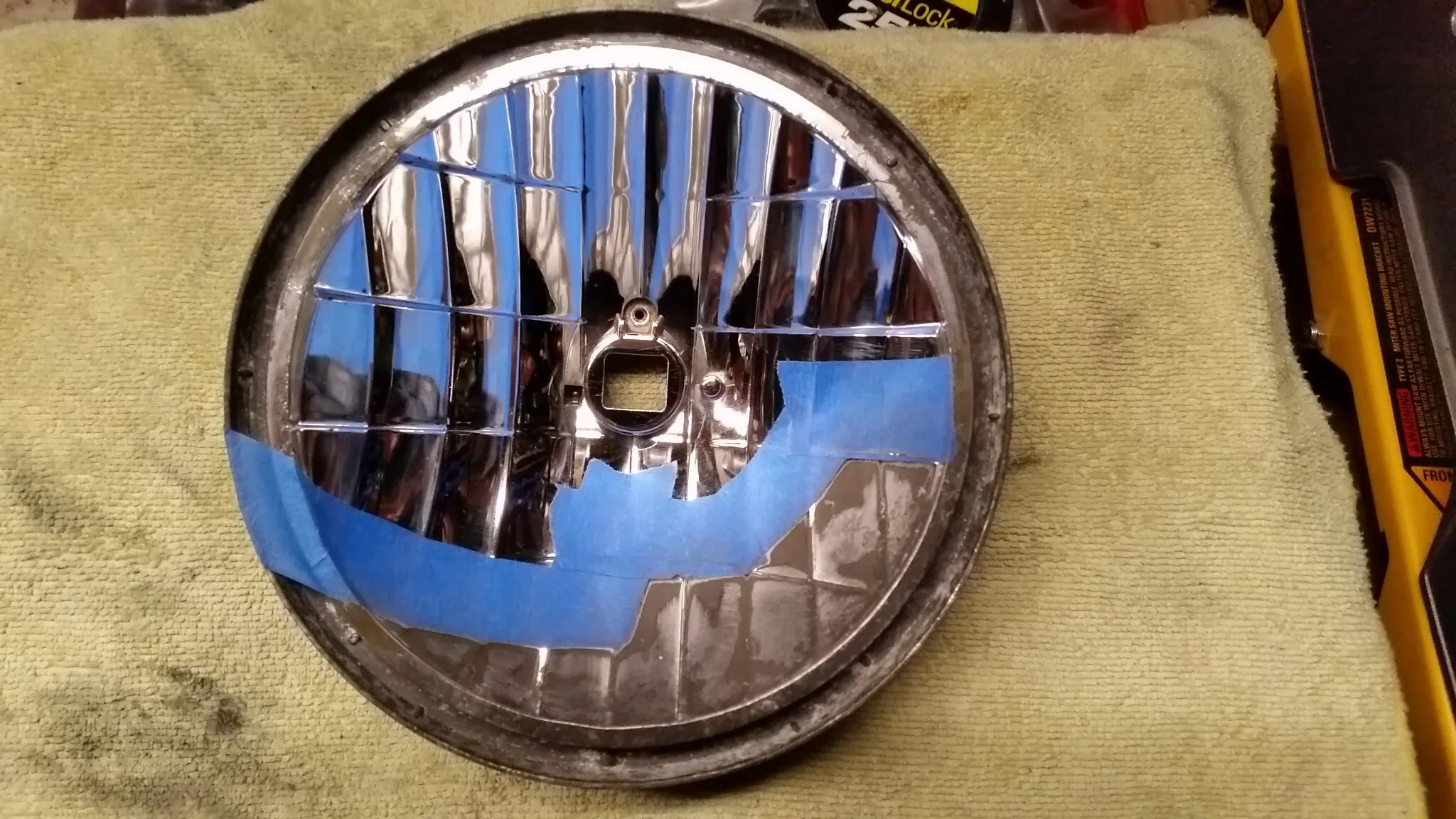

I did this with a set of fog lights and probably wouldn't waste my time doing it again. The "chrome" paint really doesn't produce a good reflective chrome finish. Maybe different paint would have helped. I looked at getting the chrome redone but it was in the $200 range and I didn't want to spend the money. Disassembly required heating in the oven, just like the Depo process. I resealed with Morimoto RetroRubber.
Some pictures. Doesn't look like I got any pictures after painting.
Initial condition
Prepped
Today
Paint
