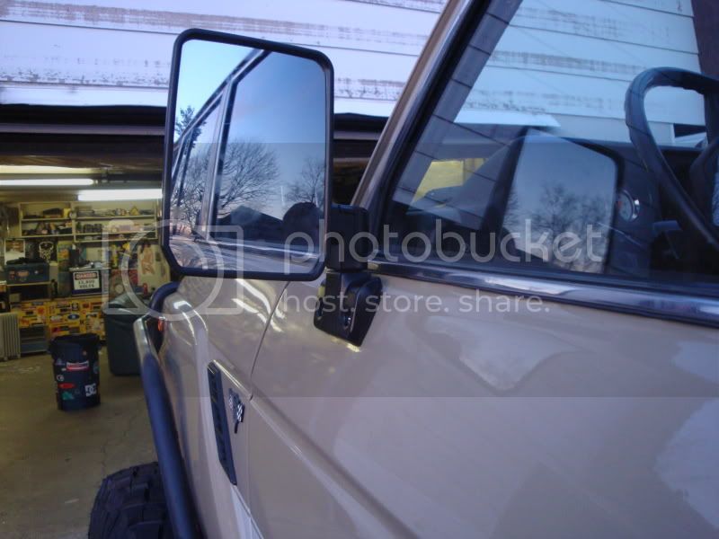

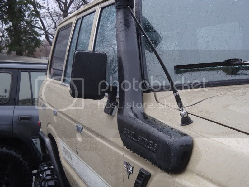

My ps mirror on the 60 has been held on with super glue since the first day I owned the van. I had been looking for a replacement without much luck when a buddy dropped off a brand new set of 79 mirrors. They look to be a lot sturdier and fold a lot smoother than the ones I have on there now so Im thinking of trying to make them fit.
The problem. All of the mounting holes line up which got me super excited but there is a hitch. The body lines do not match up.. They are close but the 79 mirrors have a more pronounced "curve" at the top of the mount than the 60 doors. I am considering either cutting the mounts to match up with the 60 door or making a spacer that sits behind the mount. I dont really want to start cutting the new mounts so Im thinking of trying to make the spacer first since I already picked up longer mounting screws.
My explanation is probably as clear as mud so Ill post a couple pics later on. Just wondering if anybody else has done this swap and how they went about it.

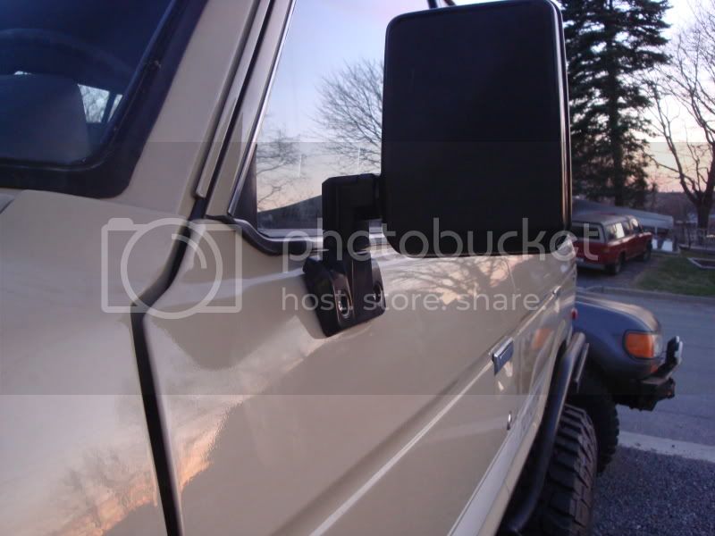

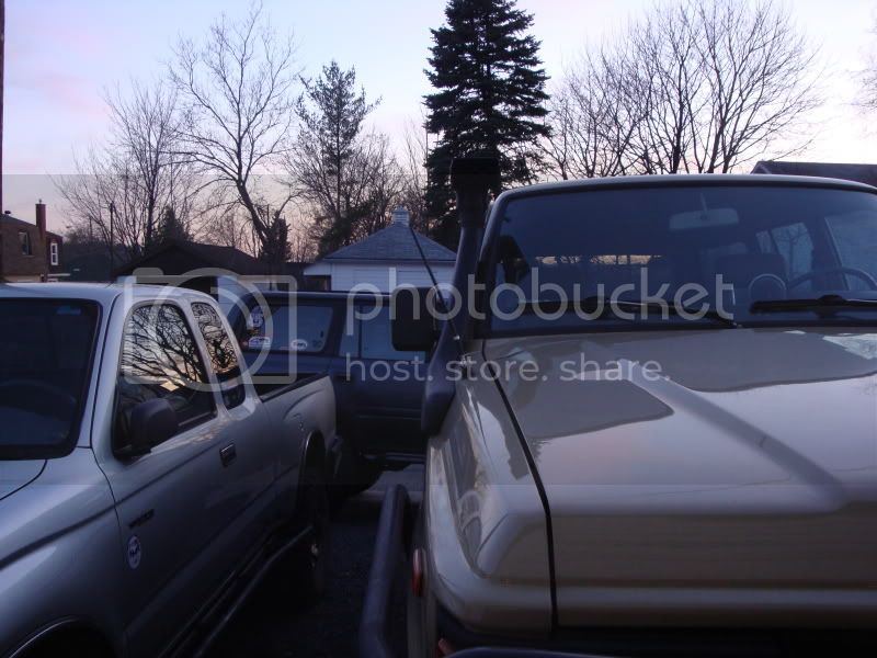

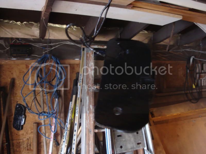

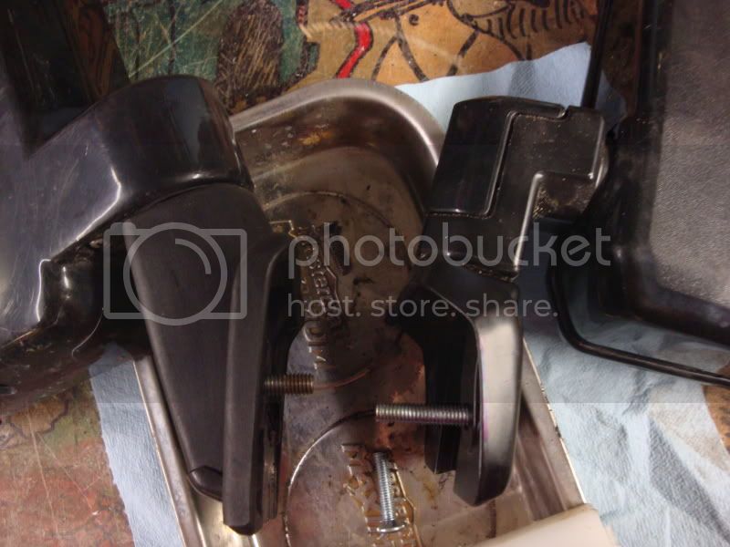

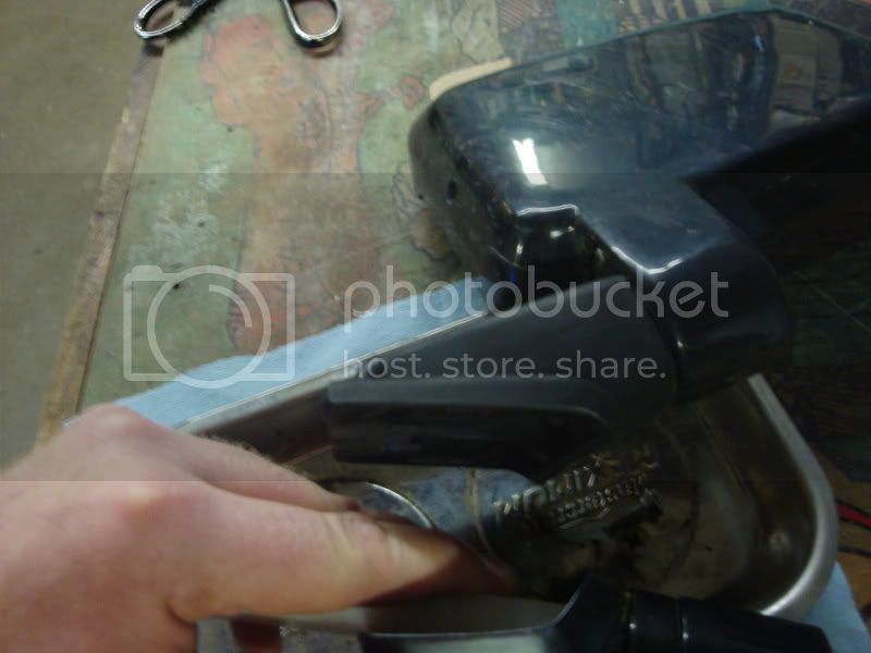

Took some pics of my mirrors.
Template

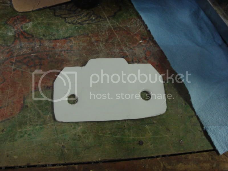

If I manage to cut the plastic right I should be able to get the lines to match up pretty good. Id paint the spacer black and I have some rubber I can make gaskets out of. Gonna give it a go.

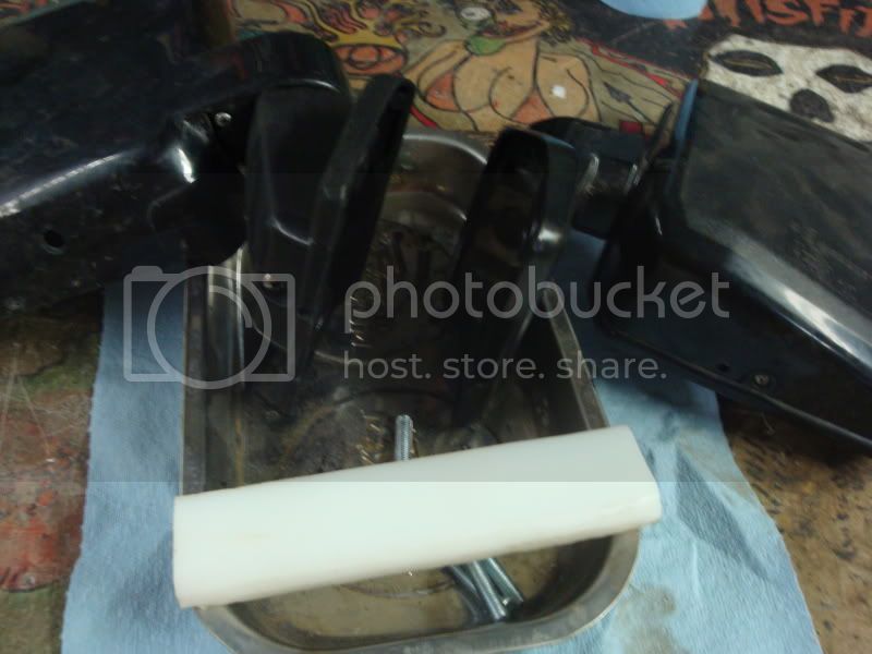

I cut out the spacers from my stash of uhmw plastic. They turned out decent and I threw a couple coats of black plasticoat on them. The mirrors fit pretty good now.

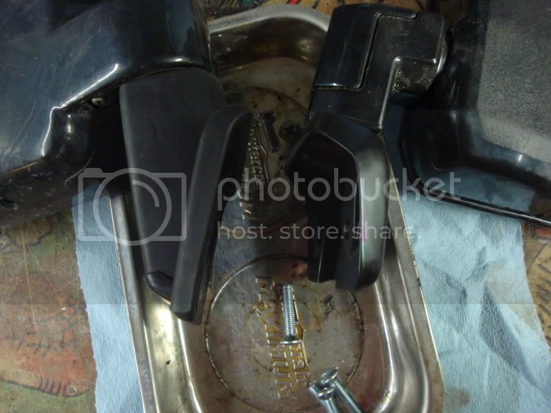

Keep in mind I've never seen these mirrors in person...But it looks like the mirror head arm on the 70 mirrors may be able to be swapped over to the 60 door mount??? Just an idea as the mounting point/pivot looks similar???
Doug
Yeah, thats the first thing I thought of... The 79 has a pin cast into the mount while the 60 mirrors use a bolt/spring. Would have neen easy for sure if it had worked.

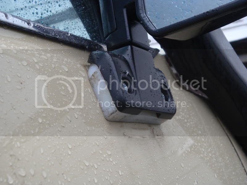

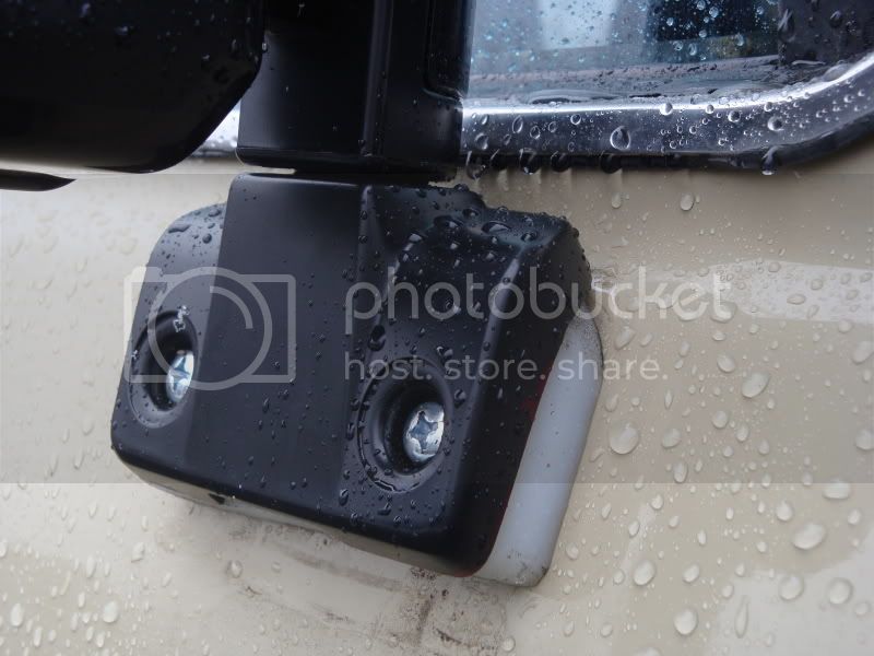

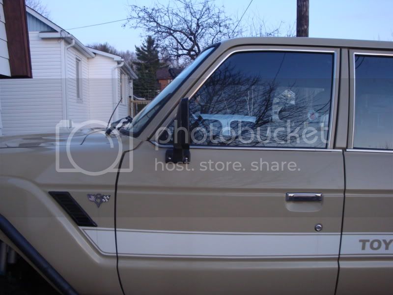

I bolted the mirrors on with the spacers I made and didnt like they way they fit. The mirrors were angled and looked all goofy so I made another set of spacers. The version 2.0 spacers are a wedge shape and have a rubber gasket between them and the door. The mirrors now fit perfect, arent angled, and dont vibrate as much.

For the spacers I used 1/2" thick uhmw plastic and cut it with a skill/jig saw/chisel.
