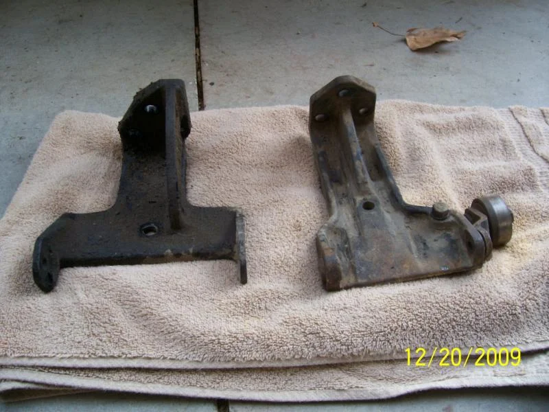

Here are two different A/C pump brackets
Left is from an '83 60
Right is from a '79 Pig
Cool, So if I read Cruiser Brett correctly, my '74 would run a different style compressor than a '79 would?
I think so. I don't know if one of my mounts would work for you or not.

Those mounts are for the later swash plate rotary compressors. The flat stock one(bent and welded) without the idler pulley is the 4/'75-1/'79 bracket for the large ND compressor. the cast FJ60 style one is for the later compressor...
The correct mount needed has another plate that is nearly horizontal, that the base of the compressor mounts to. Will get pics in the next few days...

Those mounts are for the later swash plate rotary compressors. The flat stock one(bent and welded) without the idler pulley(on left) is the 4/'75-~1/'79 bracket for the large ND compressor. the cast FJ60 style one(right) is for the later compressor...

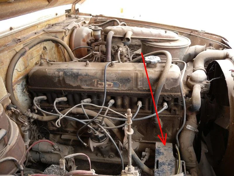

shamelessly pirated from an another thread: the red arrow points to the factory RH motor mount for pre 4/'75 piggies with A/C. the bottom of the compressor bolts to the four slotted holes. that is what adjusts the belt tension. there is a specific lower a/c hose to clear the bottom of the belt. hose is shaped like a question mark.
Hmm, pirated from my pic. Does that mean the one I'm looking at buying might have had AC at one point, since the compressor mount is there?

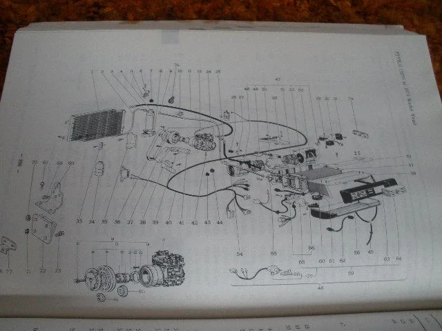

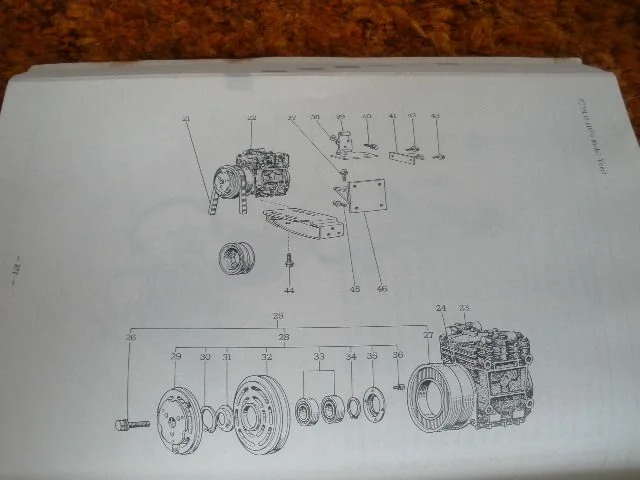

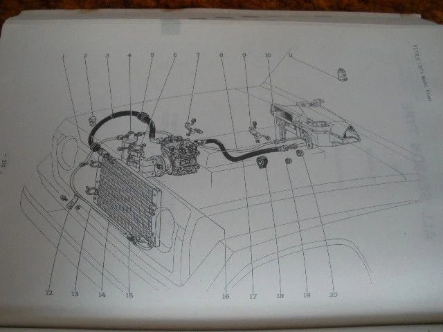

here are a few pics of a Toyota A/C parts catalog I picked up, I don't have a scanner, so hope these work.
The catalog covers 1974 and before for all Toyota models.
firt 2 pics are of 1974 stuff and the last is for 1970-73s
