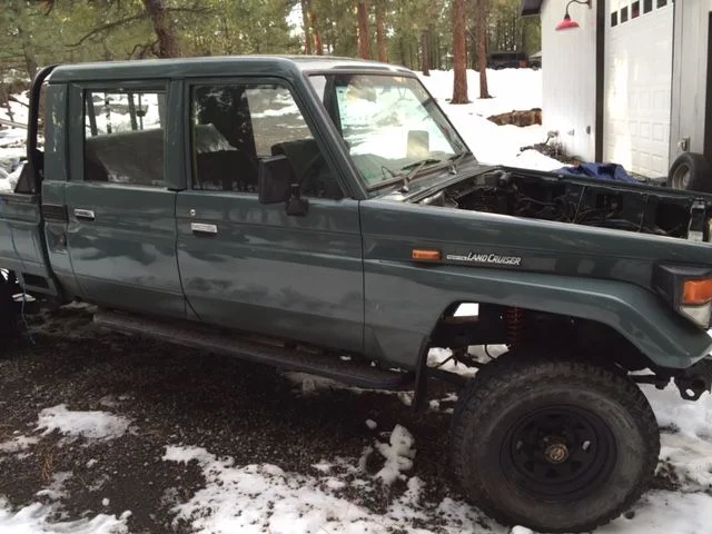

Guy in my neck of the woods wheels a 75 1HZ super short double cab, mining truck from Australia.....
this one:
For Sale - 1990 75 Series Dual Cab Bargain Truck
img_3991-jpg.1439450

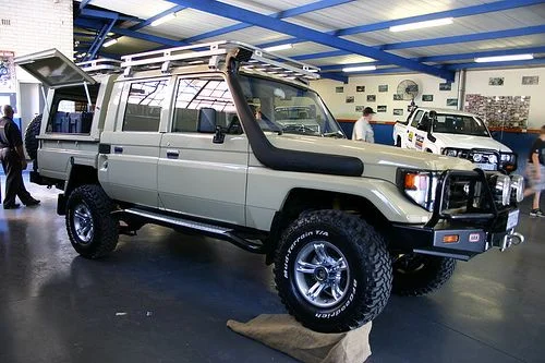

A much cheaper option would be to buy a HZJ75 Meano (79 shown), and convert the suspension with 80 series components like this toyota-landcruiser-extra-cab (if you don't mind RHD)
