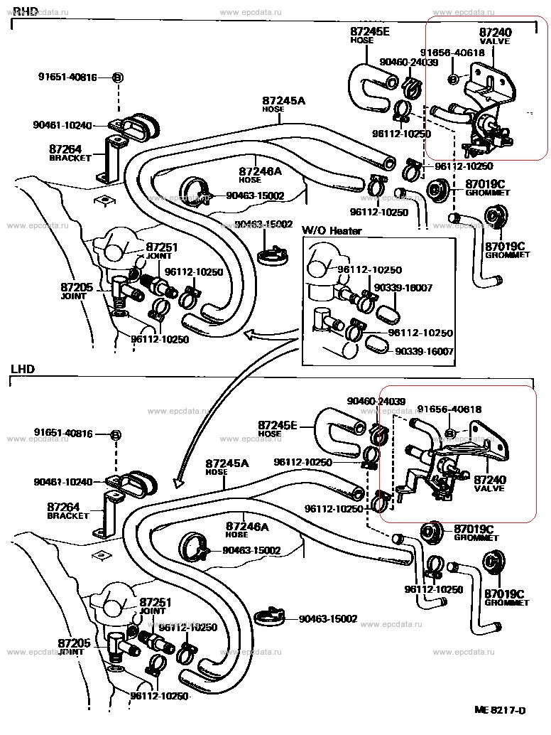

I'm hunting for a new heater valve, 79-83 pickup. A guy was looking for one on facebook, and it got me curious.. so I started digging
87240-89111
Valve Assy, Heater Water

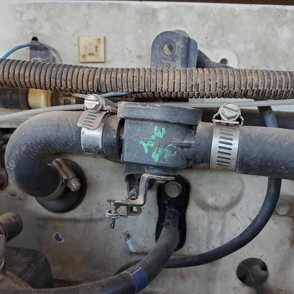

I wonder if it would be possible to retrofit the later valve that goes right to left. This one is from a 1990-95 pickup/4R.

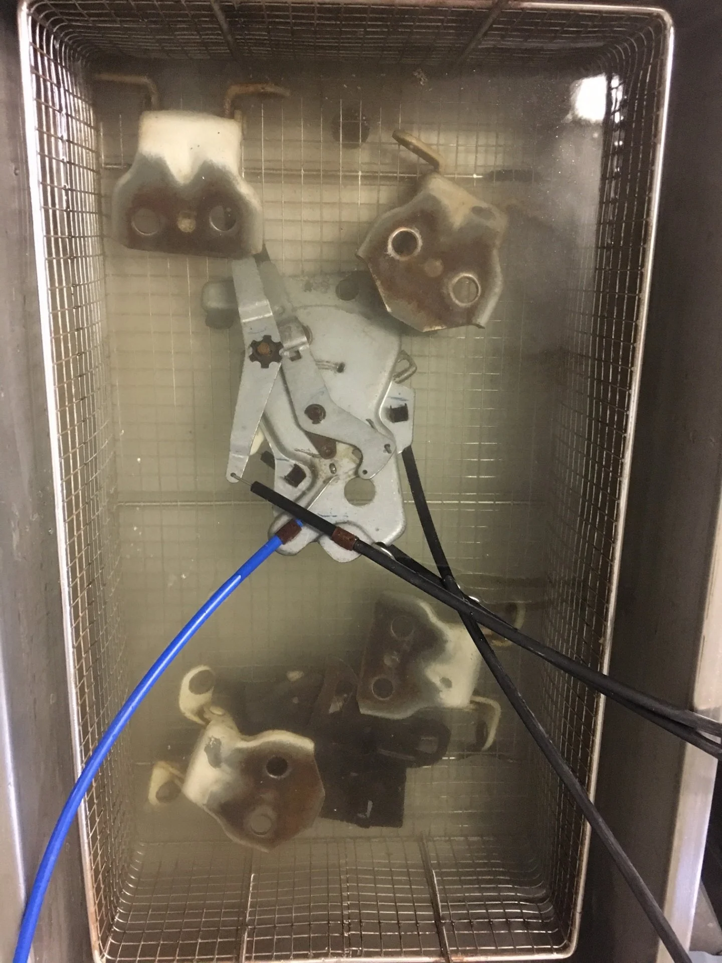

This is only one part of the puzzle.

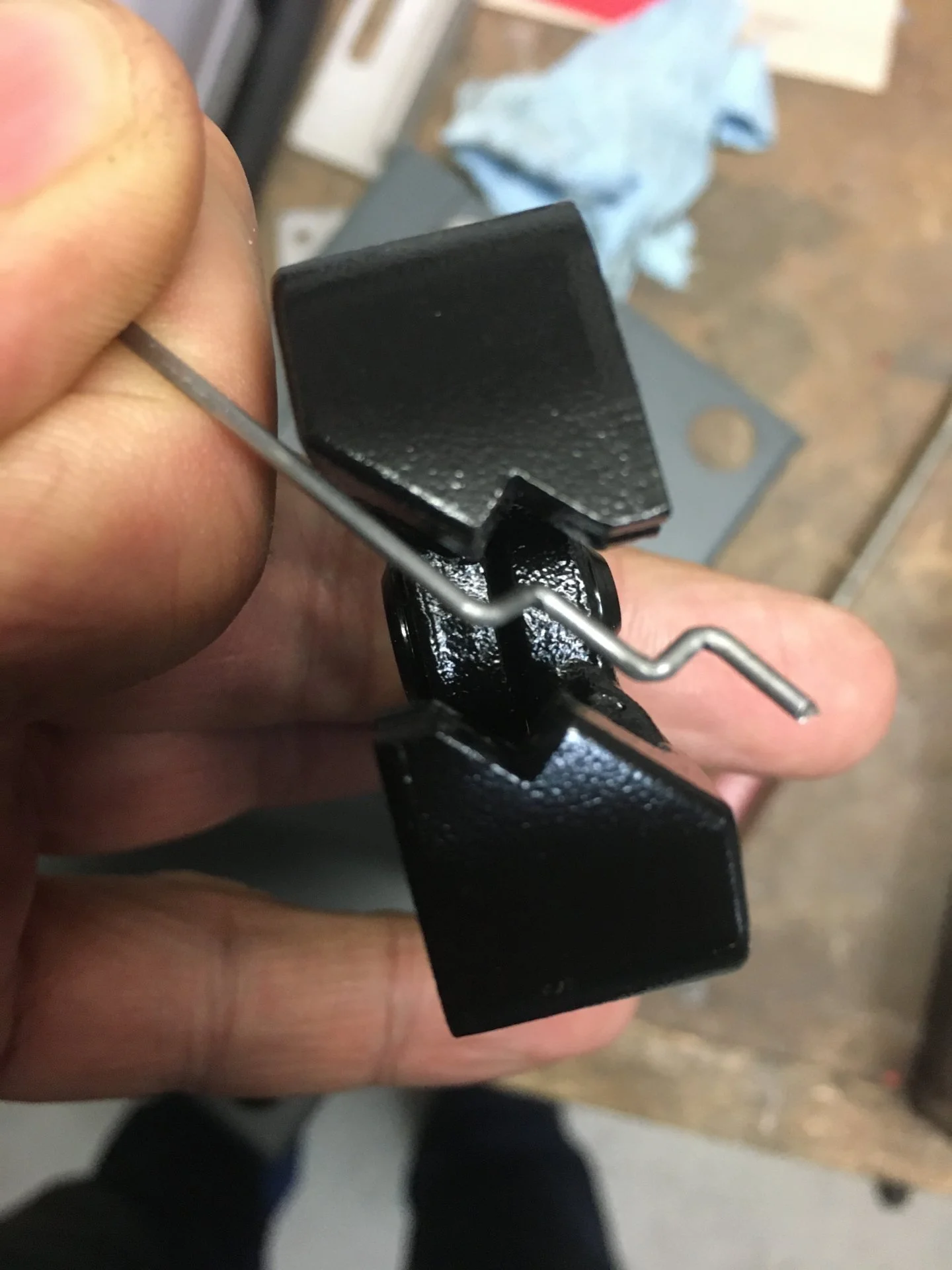

The valve lever can get rusty and hard to pivot, the cable can corrode in the guide tube and get hard to push/pull, the control lever in the cab can corrode and get hard to pivot, then the operator gets impatient and forces the lever breaking the cable (solid metal wire) just before it enters the tube in the cab (blue tube in picture)
The truck I worked on last year had a donor cab with a spare controller and both had the cable/wire broken at the exact same location. Those control cables are not apparently available anymore so I had to "borrow" a longer wire from another tube and rebend it after cleaning the control mechanism and lubing up the wires/tubes.
