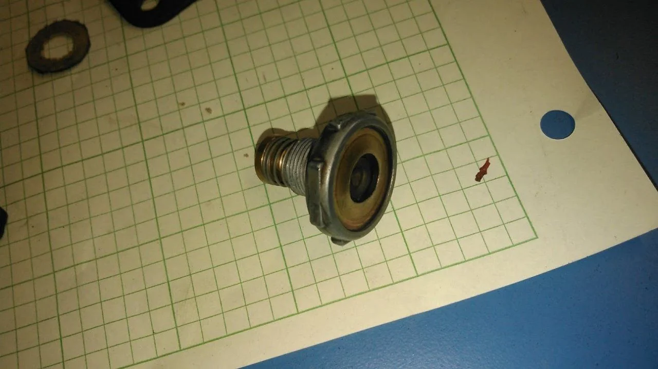

We got the Holley carb installed, and it was still dumping gas. I say dumping gas because one of my employees noticed, as I had, a liquid sort of burping out of the Exhaust manifold. Also, insane fuel consumption, and you could look into the carb and see. So I bought a fuel pressure regulator and installed it - easy. I think it helped, but we decided today to rebuild the carburetor from scratch. That proved VERY fruitful: We found a torn paper gasket inside that was clearly passing fuel through some channel. Also, there is something called the power valve: it evidently opens under vacuum to inject more fuel. The power valve in the Holley we have was bent, so we are pretty sure it wan not closing correctly. Snaps to Advance Auto for having the rebuild kit on the shelf on Sunday, and double snaps to Holley for having 3 replacement power valves or 2 different settings in the basic rebuild kit. Amazing. Anyway, we replaced all the gaskets, O-rings, etc and the new power valve and acceleration pump diaphragm. All the jets and passageways are clean now, etc.

Eureka! We got it idling very nicely. Turns out it was a combination of factors. The carb rebuild was key - it was missing the little cork sleeves around the two idle mixture adjustment screws, so they would creep a lot when the engine was running since they were so loose. Also, the messed up power valve didnt help. And we were evidently huffing bozone because neither we nor the mechanics we worked with thought to adjust the (ta-da!) IDLE SPEED ADJUSTMENT SCREW on the side of the carb. It occurred to me that I would not mention this part because it makes me look like an idiot. But I hope it helps the next guy avoid walking this path when he reads these posts.

You evidently got your rig running right before I got around to responding. The number one problem with new Holley 350 installs is a blown power valve. You can't set the timing until the engine is running, engine won't start easily since timing is not set, so you pump the gas, get a backfire, which can blow out the power valve. A blown power valve does 1,000% what your problem was. Now that you've rebuilt the carb, you'll be tickled pink in off road terrain (steep hill climbing) if you install a "float bowl baffle" and "float bowl chimney", they eliminate 1,000% of any off road problem you might have. See ebay #252568209402 for this.
