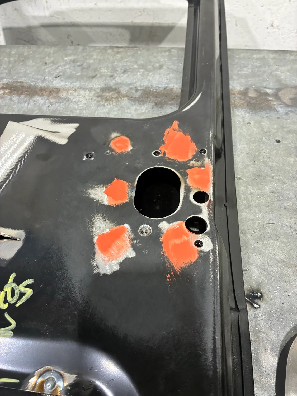

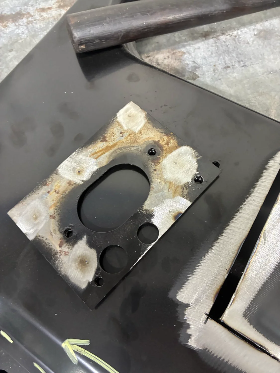

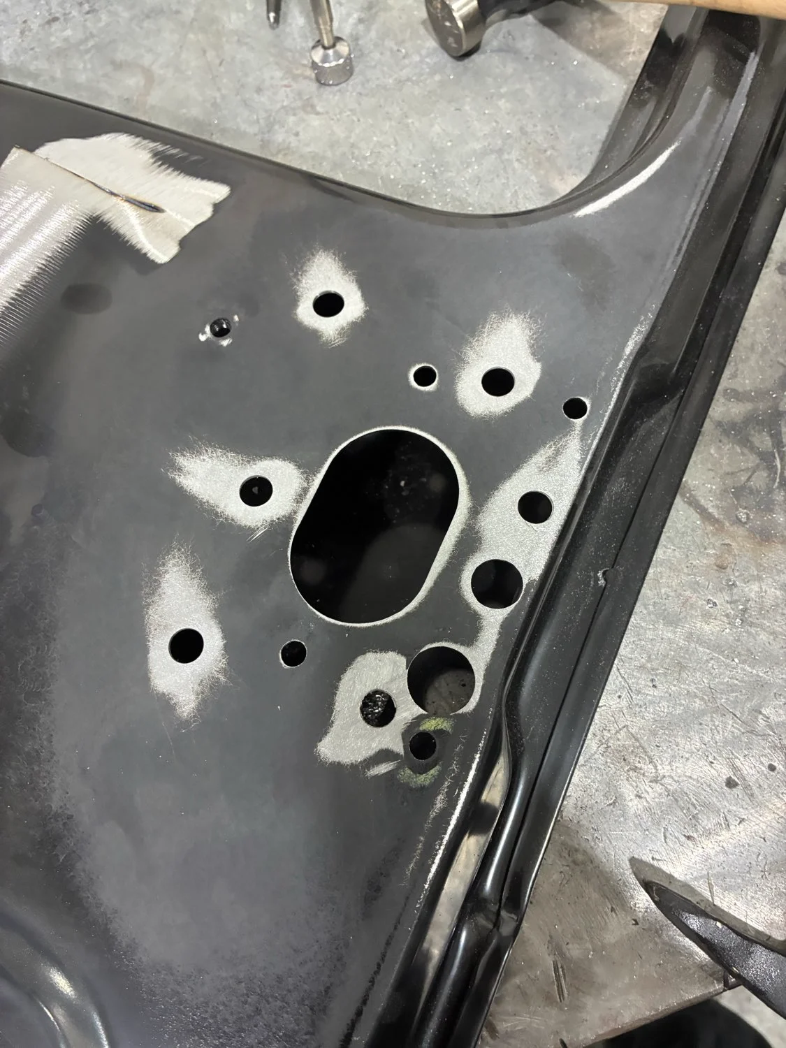

Yes.
The LH side was ok (minus the spot welds bwtween the inner and outer skins seperating, not a huge deal, easy fix, may have been a one-time thing), the RH side the big issue was the reinforcement plate for the inner handle/latch was welded inside the door crooked. My welder was able to make one slide to the inner skin, drill the spot welds, remove the plate, clean everything up, and put it back in correctly and then weld up where he cut seamlessly. Again, may have been a one time accident. Overall fitment was fine after that. I would say worth the money if your original doors are rusted out. Alternatively that would make excellent lower grafts, just kinda expensive to discard 80% of the door.
