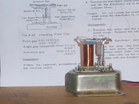

It's not a matter of adjusting the points. To adjust the VR you have to bend the adjusting arm under the black spring.
It's not an easy job but it's doable. The easy way out is to buy a new one.
If you want to do it yourself...... look at upper photo in this pic.
The pic is a 6 wire VR. You only have the part shown in the upper photo. I have to find a better photo for this.
The adjustment is done with a running engine and needs a steady hand.
Rudi
