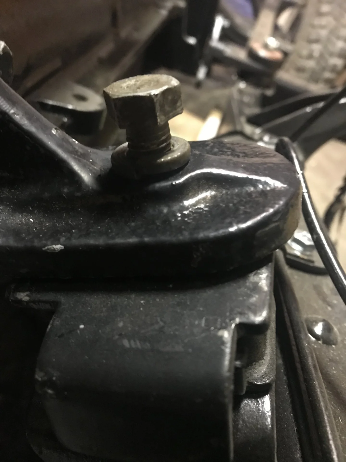

Having a hard time finding Toyota front/rear motor mount bolts, bolts that attach mounts to the bell housing and bolt that attach tranny to bell housing. Any recommendations on where to find these? Or does anyone know the required size, thread pitch and length on these.

Maybe Luis can post up some pics of the hardware I got him hooked up with. :)
Thank you @kunzma! @cruisermatt had already hooked me up with the needed bolts. I’ll post a picture later
@cruisermatt Wondering if I could get a couple of the long bolts for the rear engine mounts?
Unfortunately those are NLA.
They're the odd-duck 13mm.
Your options are used OEM, I think Mark @65swb45 has some NOS ones, (he probably has good used ones as well. I'm sure Georg/SOR/Classic Cruisers/MAF/BTB all have good used ones as well), or use generic 1/2"
