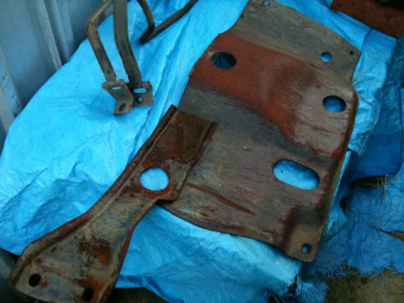

Is it just me, or is the factory skidplate on a 73 about as thin as paper? The one on my 40 series seems much stiffer.

Yep, it IS thin.
Don't know a sturdier one being available.
I reinforced mine by welding strips (5 x 30 mm) to it from 'left to right'. The 5 mm side touching the metal of the plate.
It helps, but it doesn't work miracles.

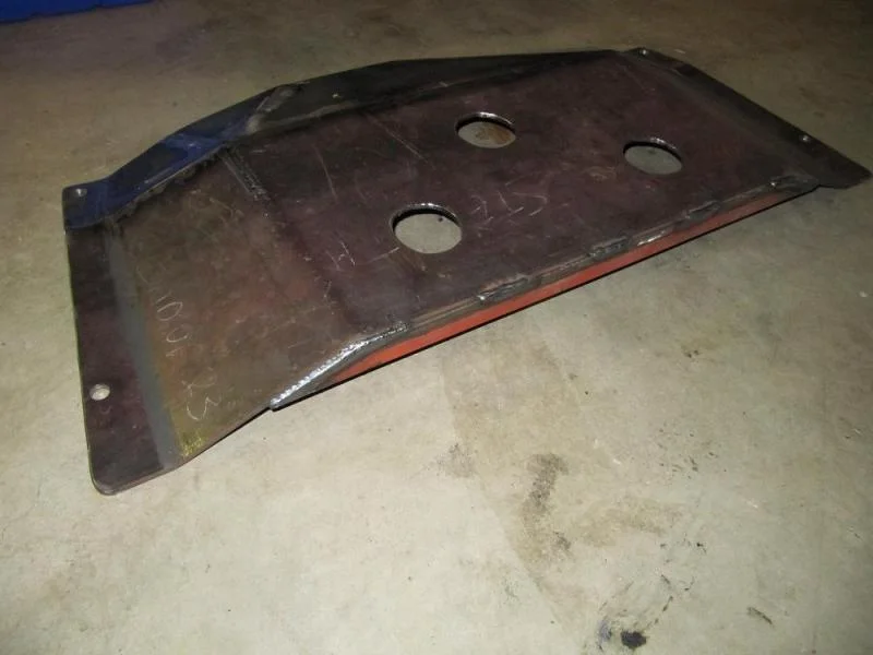

It will be similar to the design I've come up with for the 80 series, Cruisin Off Road but there are some more complex shapes to work around on the 7* truck. The basic theme of the design will be the same though: Bolt on to existing threaded holes in the frame. Full width coverage. 1/4" plate, and 1 or more stiffeners welded on for rigidity.
I should have a prototype together sometime next week. I'll post up some pics when I have it done.
Lowenbrau, I'd have to know where the toybox sits to make that work. Might be a one-off.

Made some good progress on the 7* Series t-case skid plate. This one was put together with several peices cut and welded together to get the funky shape I wanted to follow the line of the tranny cross member. Getting a couple more formed up tomorrow to go on some local trucks for some "product testing" next week. I'll try to get some good pics while on the trail.
Holes are 2" so they should facilitate good mud drainage, and one of them lines up with the t-case drain plug so you don't have to remove it for servicing.
I don't usually name my products, but I'm calling this the "Stealth Plate" since is has those funky angles, and maintains a low profile.:grinpimp:
-Jason

I checked today, and the skid plate bolts up to 5spd BJ70, HZJ73, BJ73 and BJ74 models. I don't have any better pictures than the ones Greg posted above (which show the unit quite nicely), need to get the website updated.
Just thought I should let you all know what model coverage I have with these. I have one complete one ready for delivery, and if there's interest in more I can have some ready in a few weeks. Contact me via Cruisin Off Road - Contact Information if you're interested.
