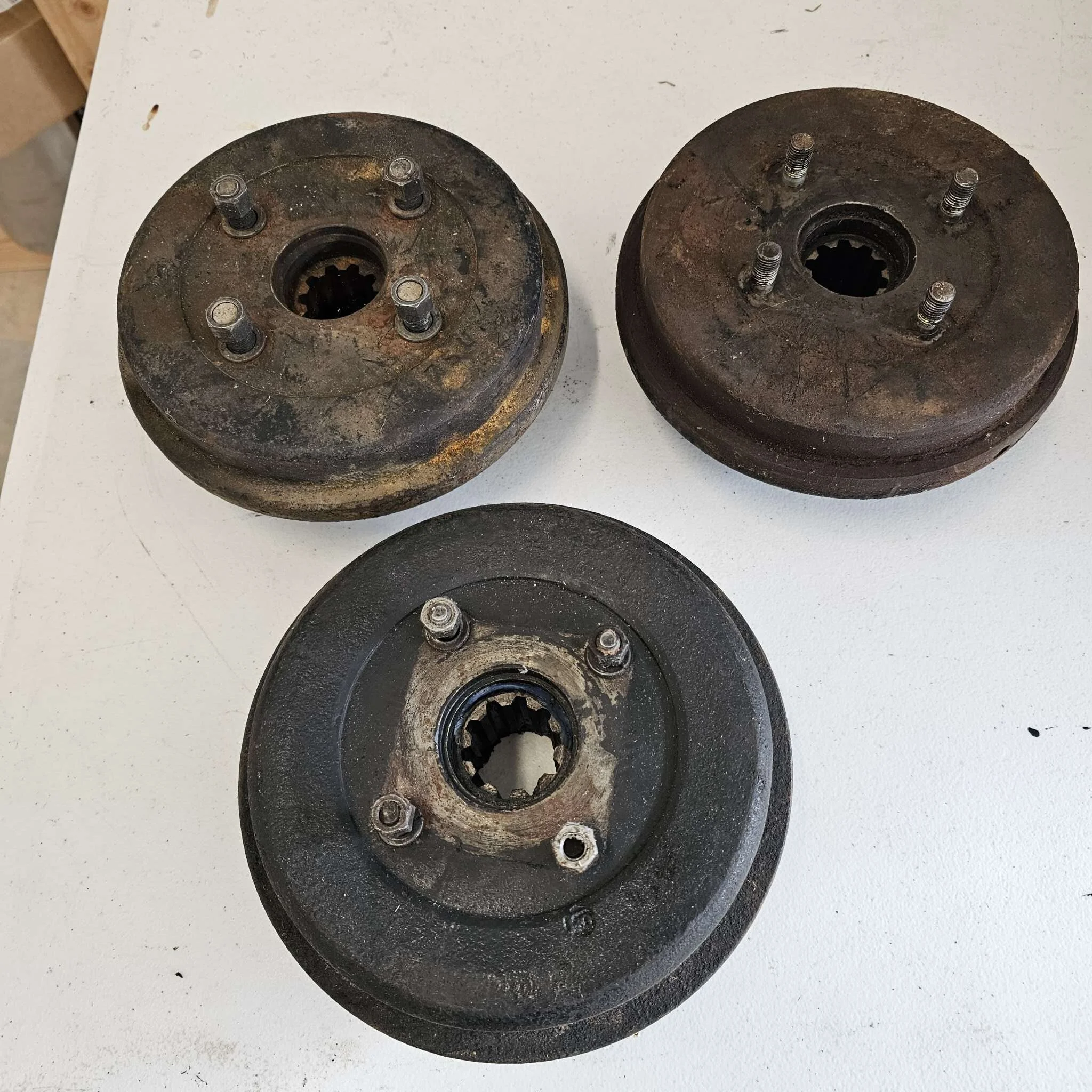

I have a few drums, stay tuned....

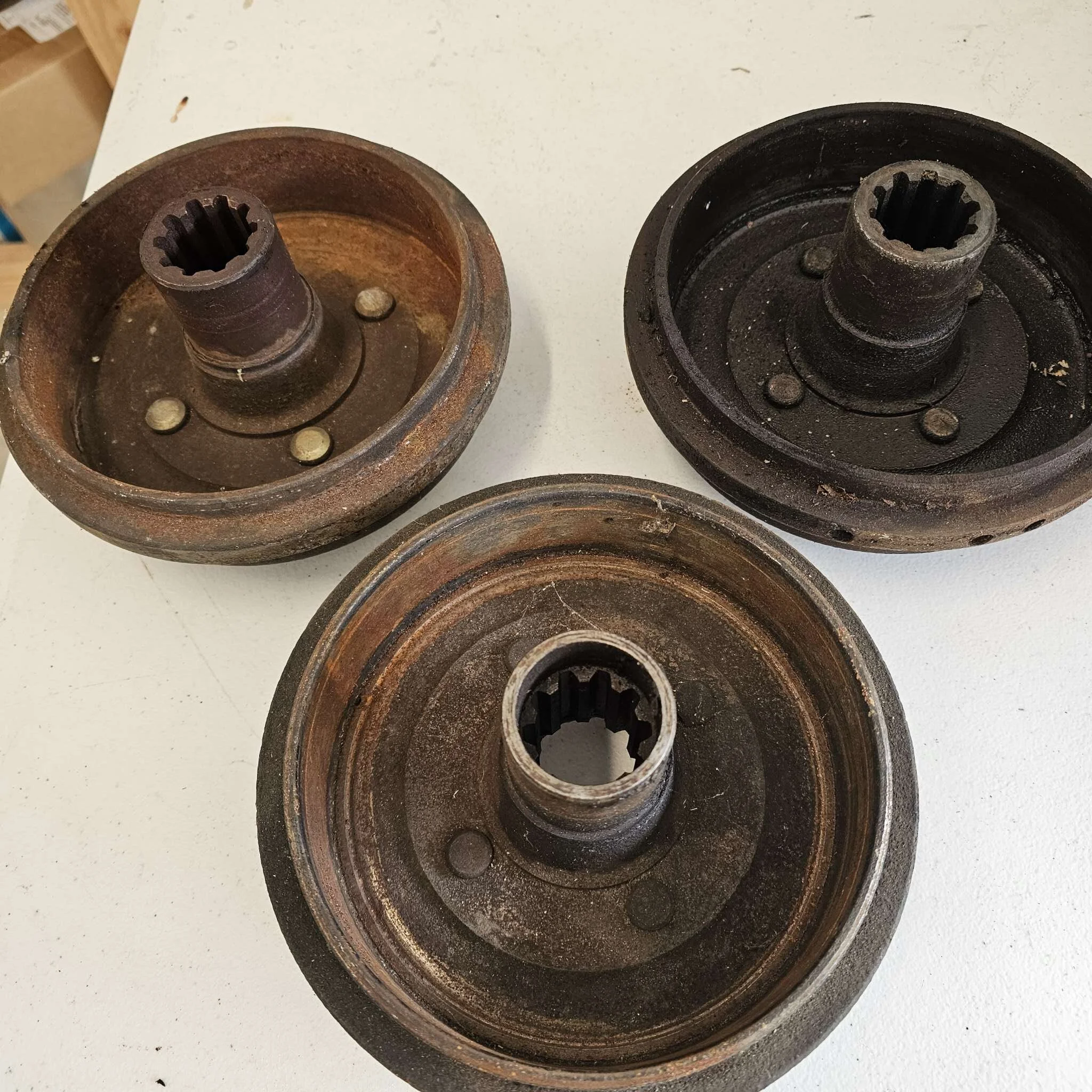

2 different styles on hand

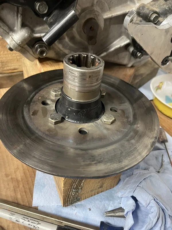

Drake2, Thanks for the response. I am not sure what style it was and do not have the drum parts anymore. The yoke I have now does not have studs but uses the bolts as shown in the first type of drum. Its going on the transfer case for a 1972 fj 40 where I adapted it to my 700r4 transmission many years ago. I have attached a pic of when I disassembled to install new oil seals. Mu old yoke has worn grooves that results in leakage.

Well, two of the three have grooves but the other does not have grooves, only witness marks. This is the one with the recessed spline (bottom of the 3) in my previous pictures. PM me if you're interested and I can ship today if you need it on the way quickly.
Thanks for the offer, how much do you want for it? Does it have any numbers on the casing or hub that I may be able to refrence to a new one? finally, is the bolt pattern for the driveshaft the same as the others? Thanks again.
Drake, @pardion is looking for the first drum, the one with the large studs.😉
Funny, I thought he had like 20 of everything :) . I will reach out, thanks.

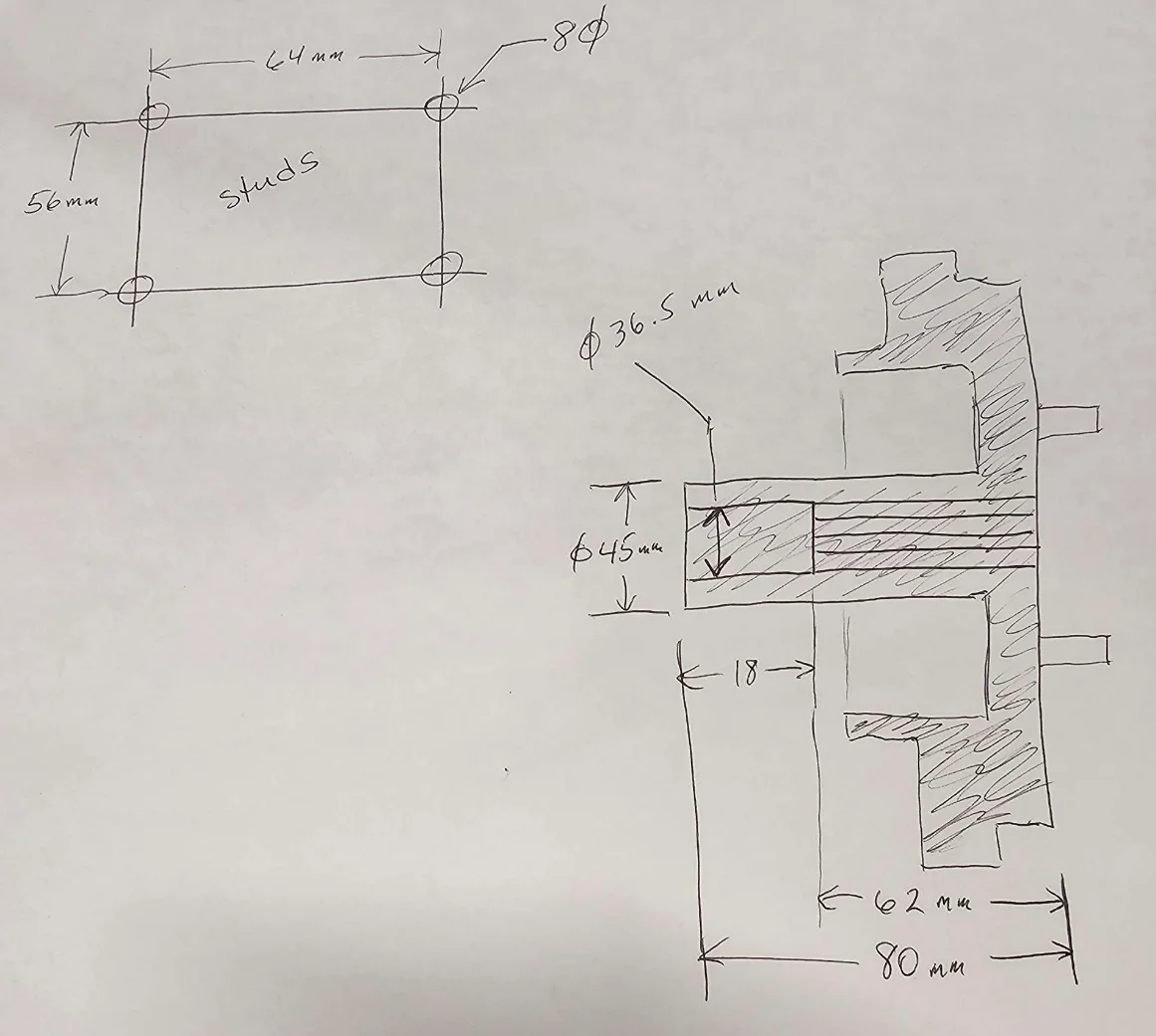

Drake2, I appreciate you looking into this and am wondering if you could take a few measurements for me, no rush. I would like to see using calipers the OD dimension of the 10-spline yoke, the overall length of yoke from back of drum to end of yoke, the dimension from end of yoke to where the diameter appears to be larger near the back of drum, the dimension at end of yoke to where the splines start (it looks like the splines are set-back) and finally the drive shaft bolt sizes and spacing. Any help would be greatly appreciated. If this is too much I totally understand.
I will try to get you the info tonight assuming I can find my caliper

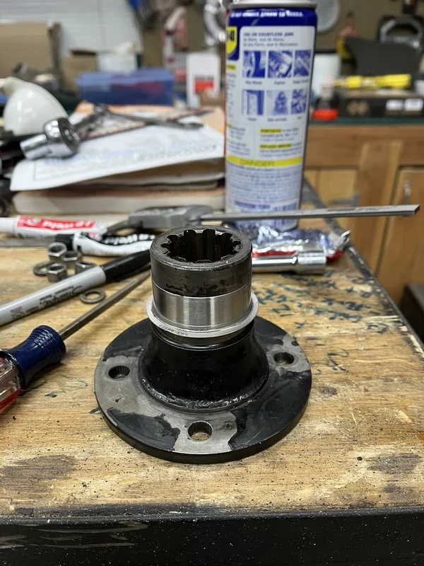

  • I would like to see using calipers the OD dimension of the 10-spline yoke (45mm)
  • the overall length of yoke from back of drum to end of yoke (80mm)
  • the dimension from end of yoke to where the diameter appears to be larger near the back of drum (62mm)
  • the dimension at end of yoke to where the splines start (it looks like the splines are set-back) (set back 18mm and the ID is 36.5mm)
  • the drive shaft bolt sizes and spacing (see attached picture)

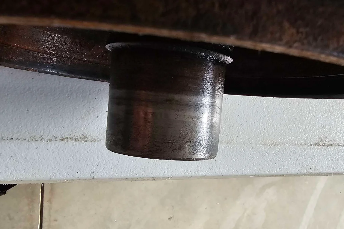

Cruisermatt, Thanks for the suggestion on the speedy-sleeve. I found that their part number 99177 was of the right size. I got one and it fit perfectly snug (had to make grind out the inside of a pvc pipe coupler to fit over sleeve and drive down further than their supplied tool would go) and used a small amount of JB Weld to fill in the grooves then drove sleeve on while wet. Wanted to post this incase others are having issues since the 10 spline brake drums are becoming hard to get and expensive.
