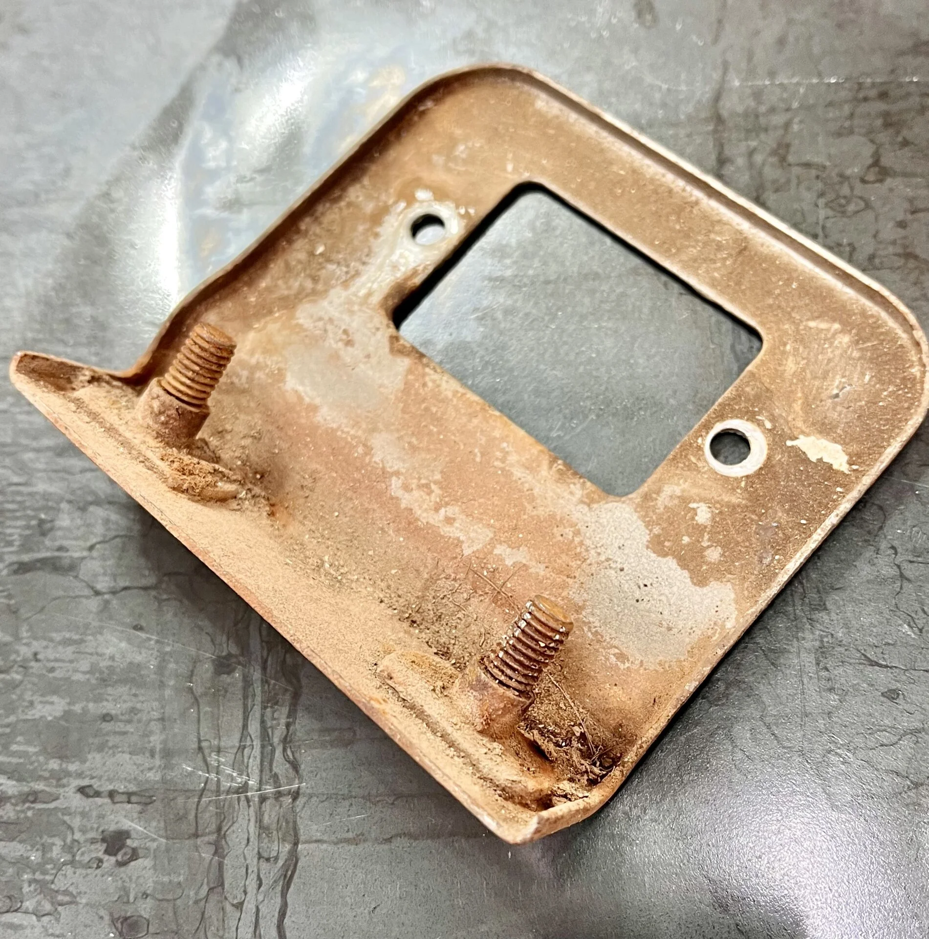

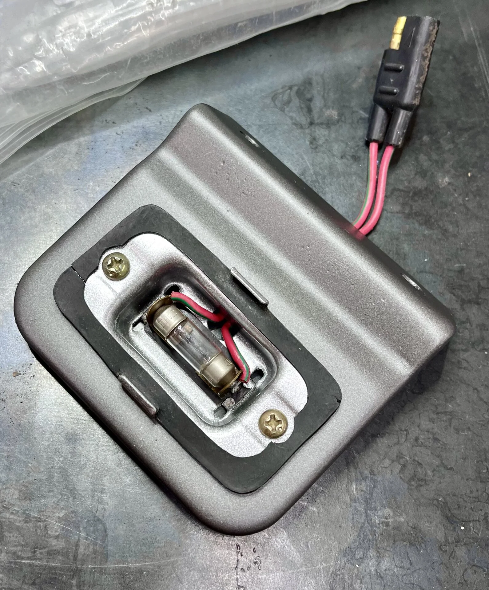

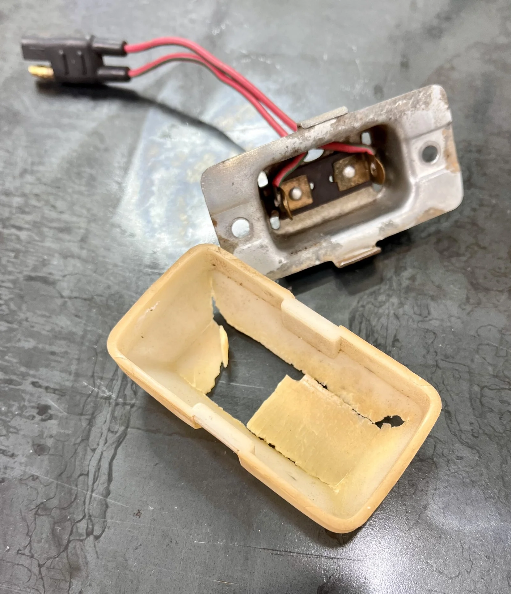

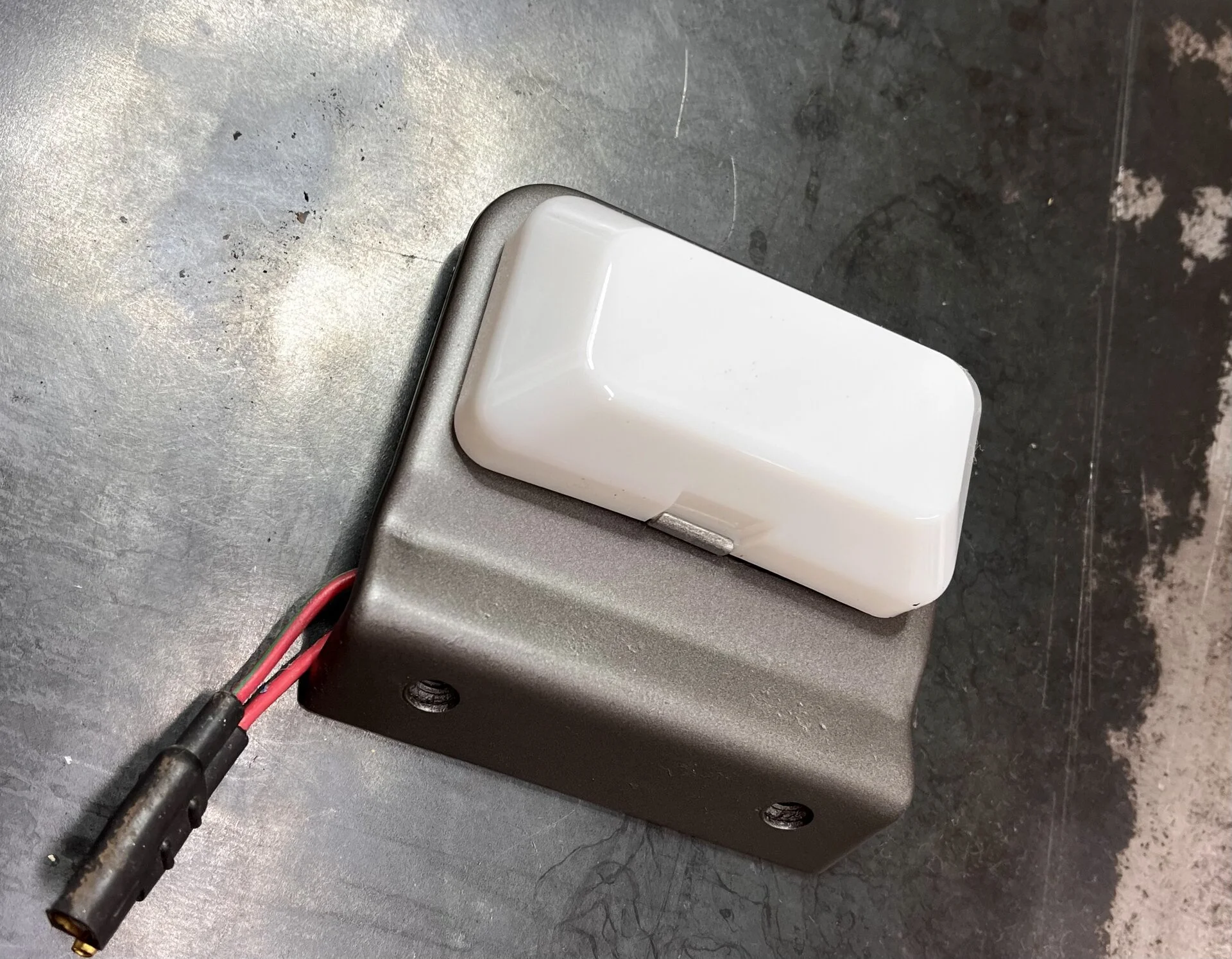

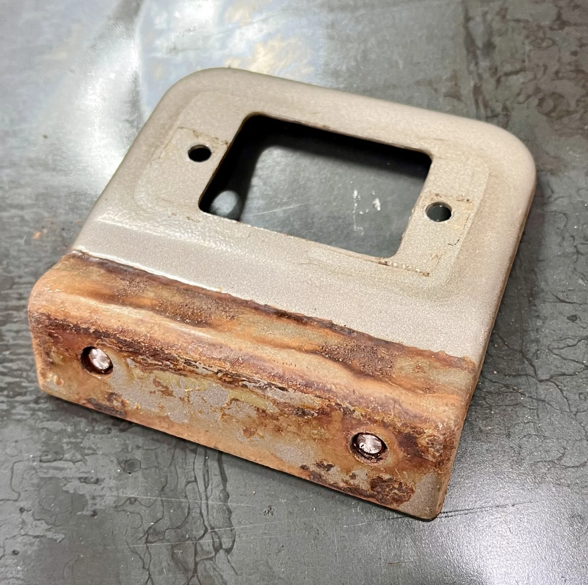

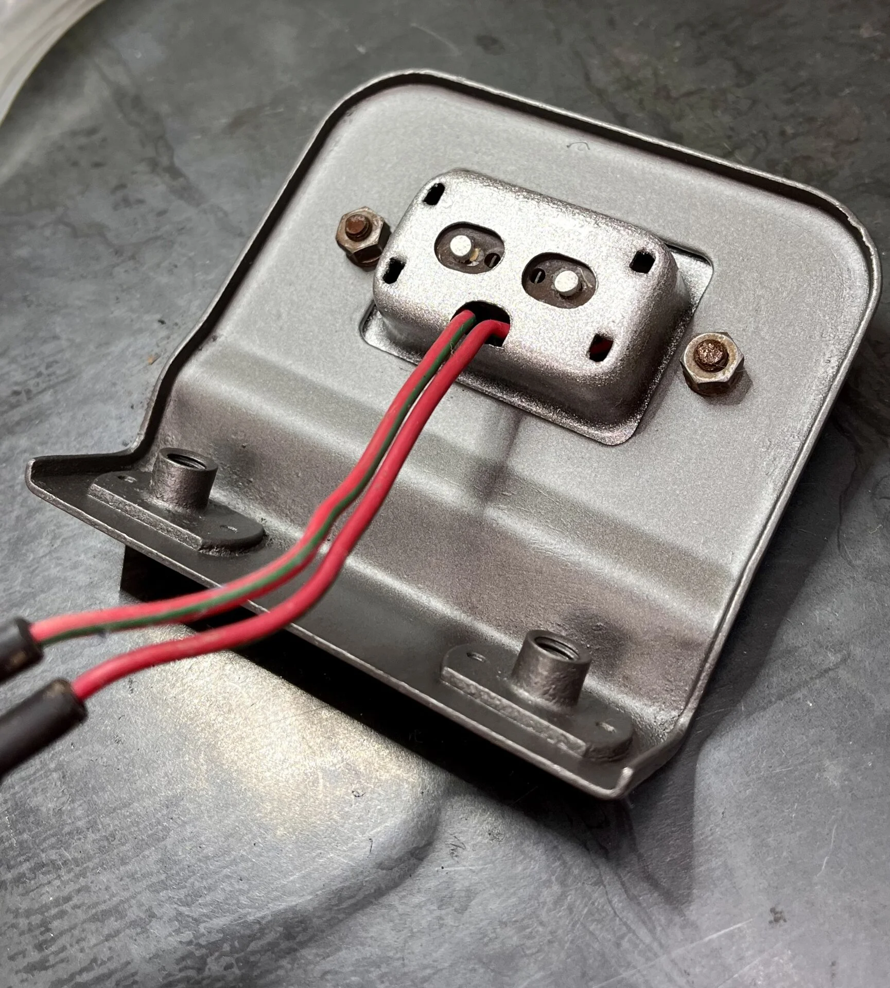

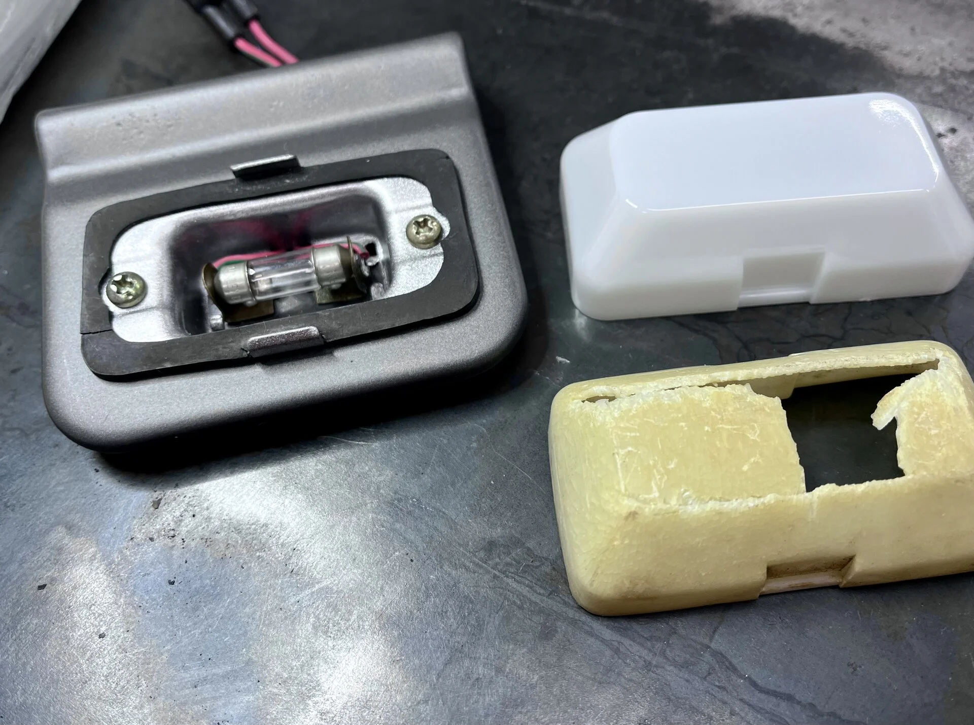

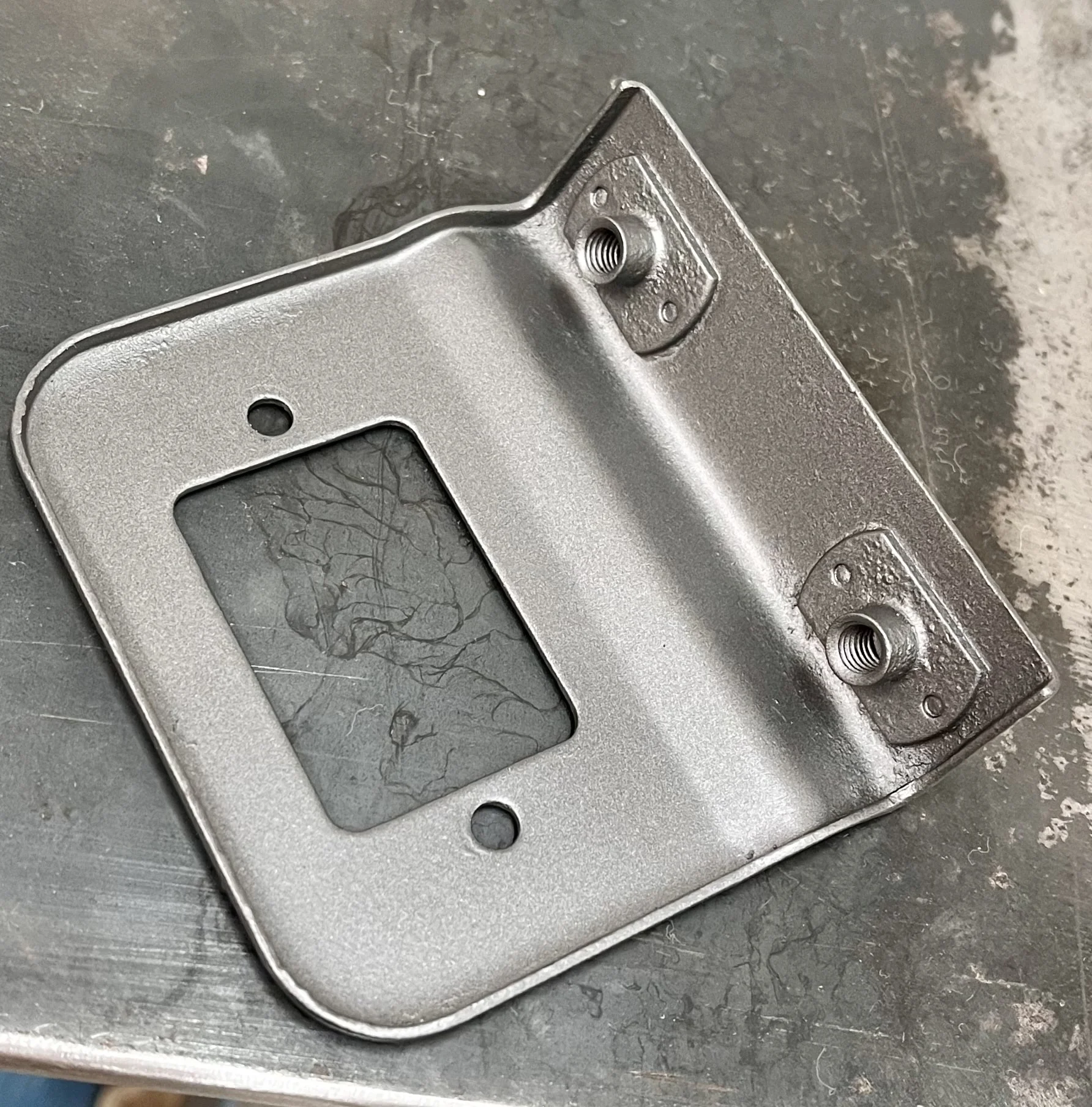

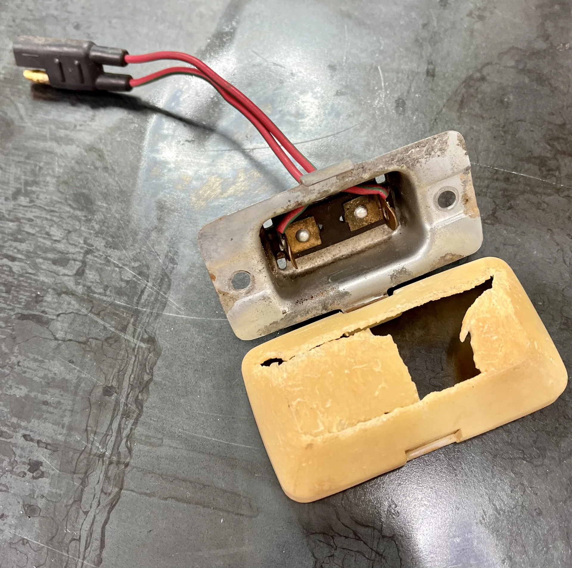

Not a concours restoration by any means but it cleaned up nicely, new lens from CityRacer completed the build. I figured if nothing else, some good reference photos for anyone that needs them.
the bolts had snapped off when I removed it - a little heat from a MAP torch and they came right out
Reassemble - fortunately, the lens gasket, although a little dry, survived the process with only a slight tear on one side. The irony of the whole exercise is that, due to my roll cage position, the light won't fit :rofl:View attachment 3471963View attachment 3471964View attachment 3471966View attachment 3471967

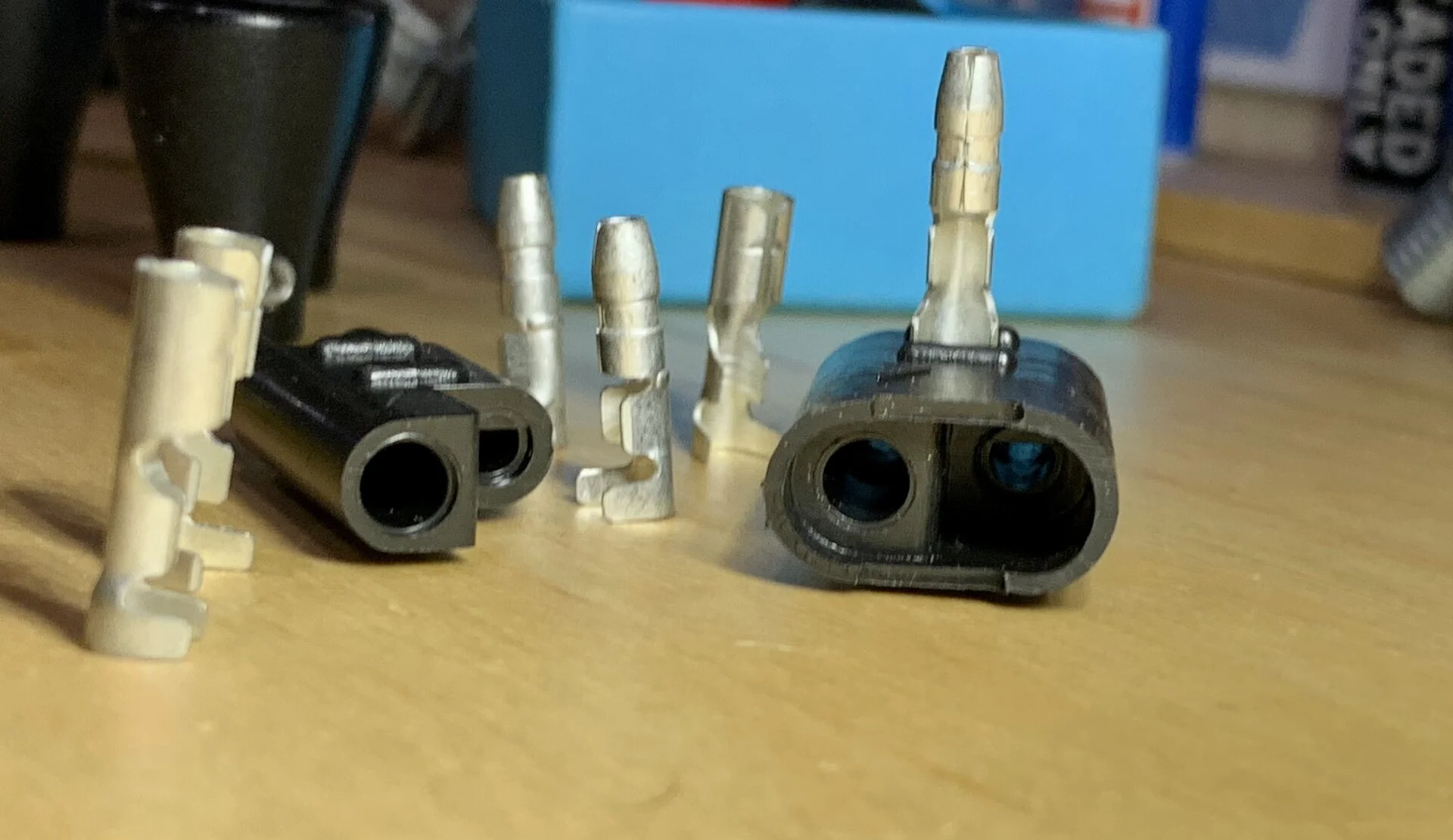

. for helping to enlighten me , would you like a KIT mailed out to you , ? ( no cost involved ) this is the later UPDATED OEM YAZAKI style , its a way way more sealed
SNOW VERSION , overlapping BOOT cover detail feature , way better then the old style you have , i could include a string of OEM Tracer stripe wire too ,

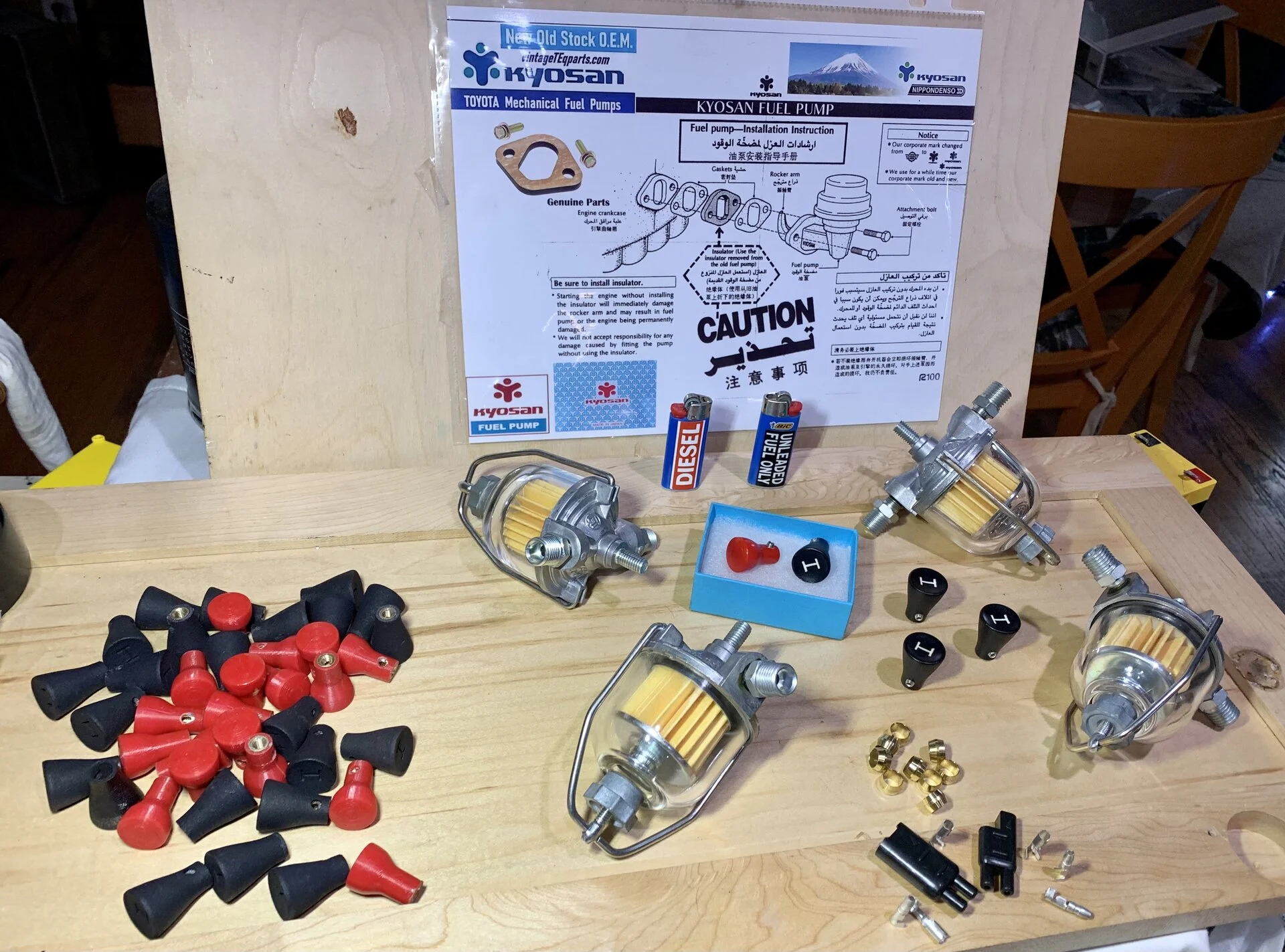

The specific parts I would like to have the icing on the cake final bling. Sauce on your fly dark pewter room
Lamp are the black rubber 2 pin bullet Connectors and the 6 SNOW VERSION tin plated bullets male female , my added genuine SUMITOMO grey general service lamp tale boot is for your current room lamp u have now ….
Im assuming you have one like the NOS on hanging out here in my random parts dia-Rama set-up below ,
