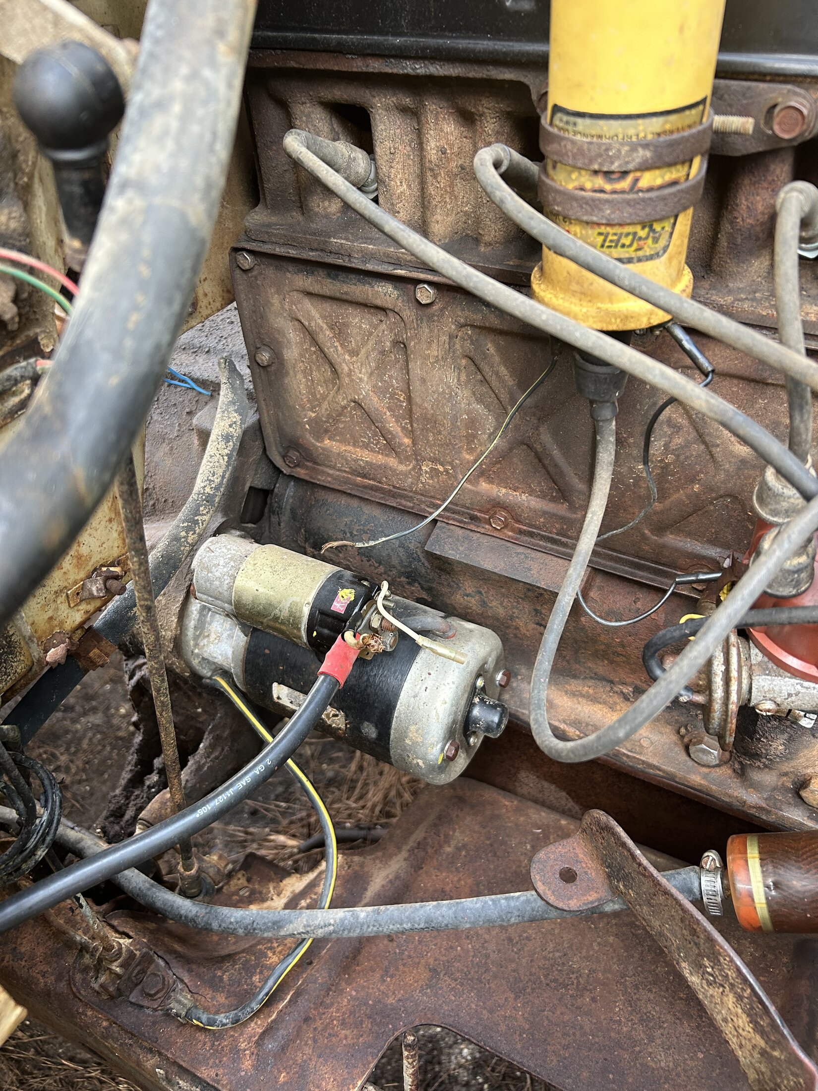

There are no wires at all going to the ignition / to starter where do I go from here ?

Pic 3 That thick black wire with the yellow stripe need to be removed and provided clean connections to be an effective chassis ground.

I could be wrong but I think that black wire with yellow strip supplies + power with ignition, not a ground. What year is this Cruiser. My coil power wire came out of the firewall to the left of the heater hoses and it is (was) black/yellow.
The lower thick black wire yellow stripe goes from the starter mounting bolt to the frame (very rusty) is a ground tho a poor one as is.
I see now that the title of this post has the year. I believe that your ignition plug should have black wires, not green. Are you sure that this is the correct plug for your ignition switch? It seems like the color of the light wiring?
I believe that year should have a black/white wire for starter and black/yellow for the ignition
Yes, I see that now. I agree that it needs attention, though I’d start with the two wires that are disconnected (coil and starter wires).
So the starter wire (white) should go to your ignition switch + when the key is turned to the start position. The coil wire should go the the ignition switch + in run position.

Also you can see in the picture of the starter there’s a bigger white wire (it’s to the left of the blue circled area) what’s that one for ?
