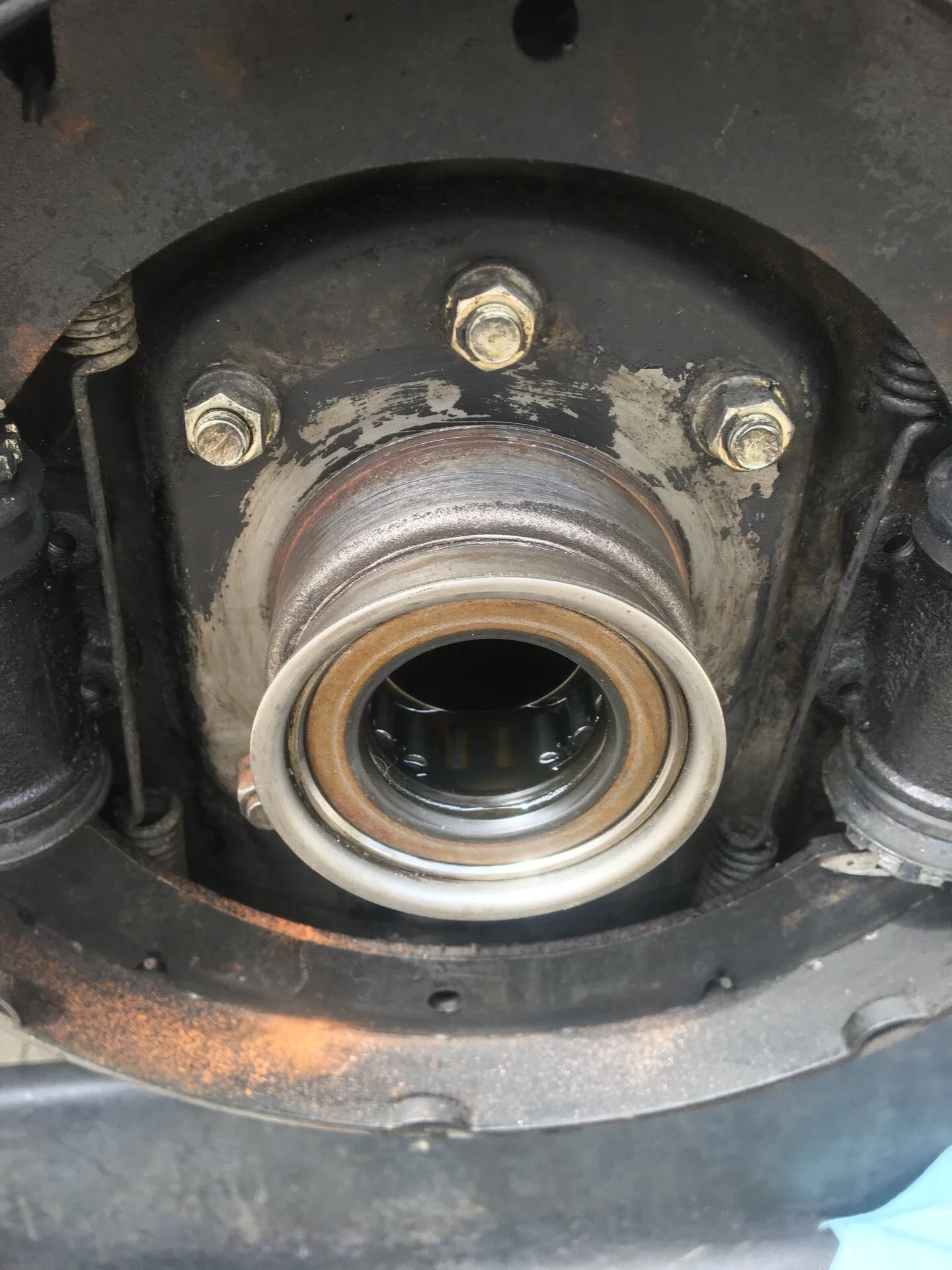

I parked it and come the next day I went to start it. And I heard this horrible screech. I shut it off and looked if anything was in the way.
Fired it up again and the screech got louder.
I removed the fan belt and spun the fan and it was fine then spun the alternator and it was fine. Checked the oil the level was good Radiator had water.
So I started the truck again and still loud screech and grinding noise. I think I determined that it had spun a bottom end bearing.
I put a screw driver to the block and listened and it sounded terrible.

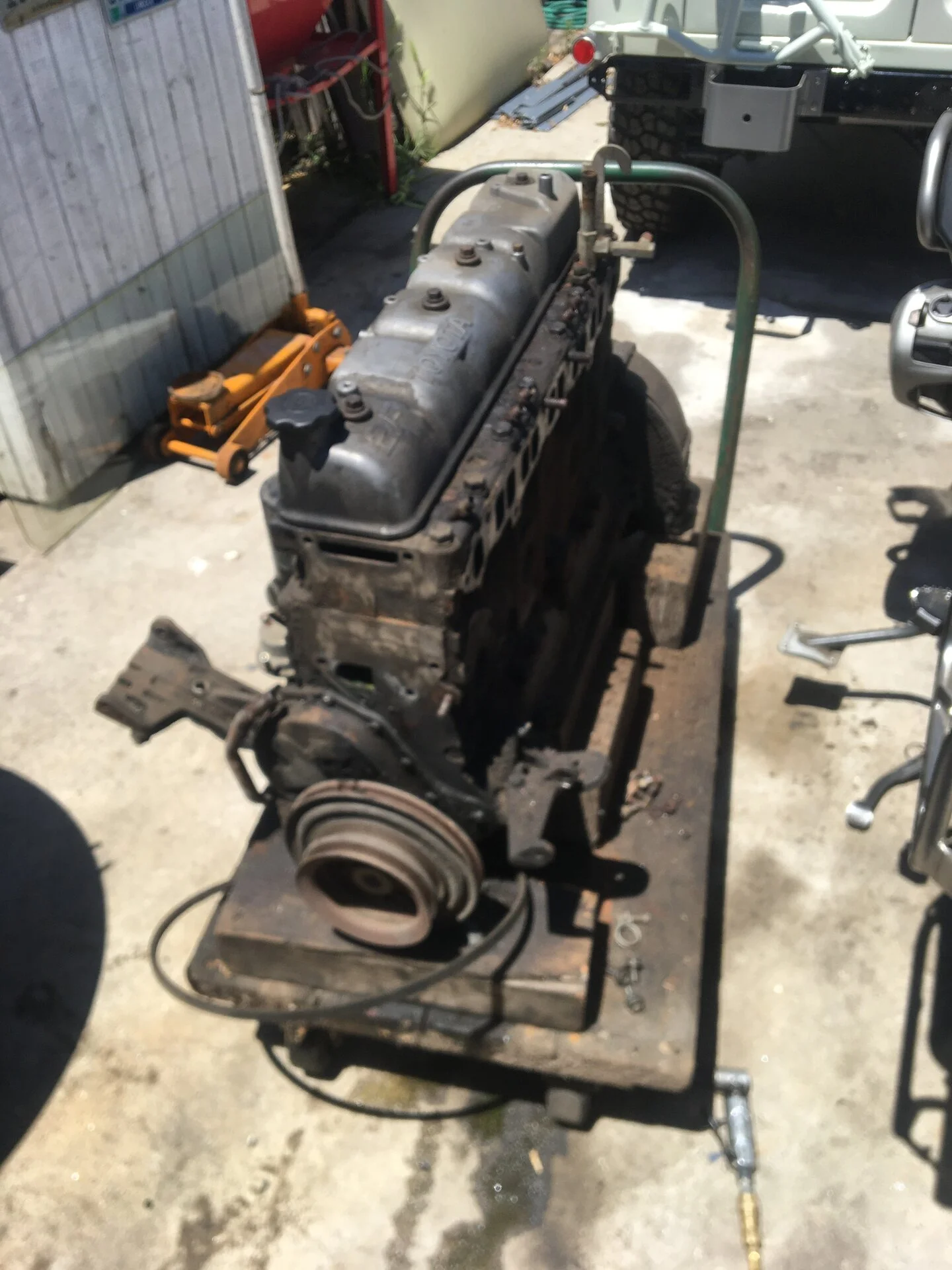

Pulled out the spare 2F from the garage.
Started tearing it down.
The 40 is getting a 2f swapped in.

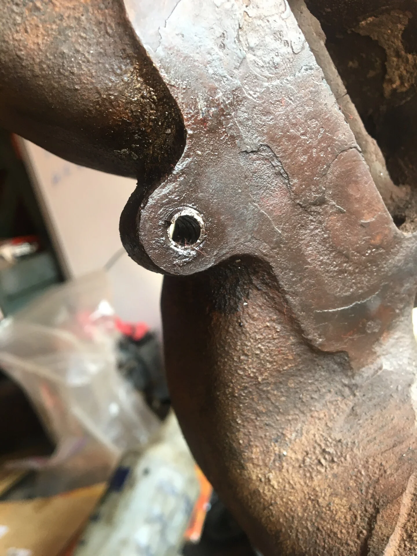

I pulled the intake and Exhaust manifolds off the F engine. Tried splitting it and broke the long bolt at the rear of the intake. That bolt is was seized and welded on. I tried heat I tried extractors and nothing. Even used a Blue point extractor kit and that bit broke. Now just drilling it out and waiting for a Helicoil repair kit.

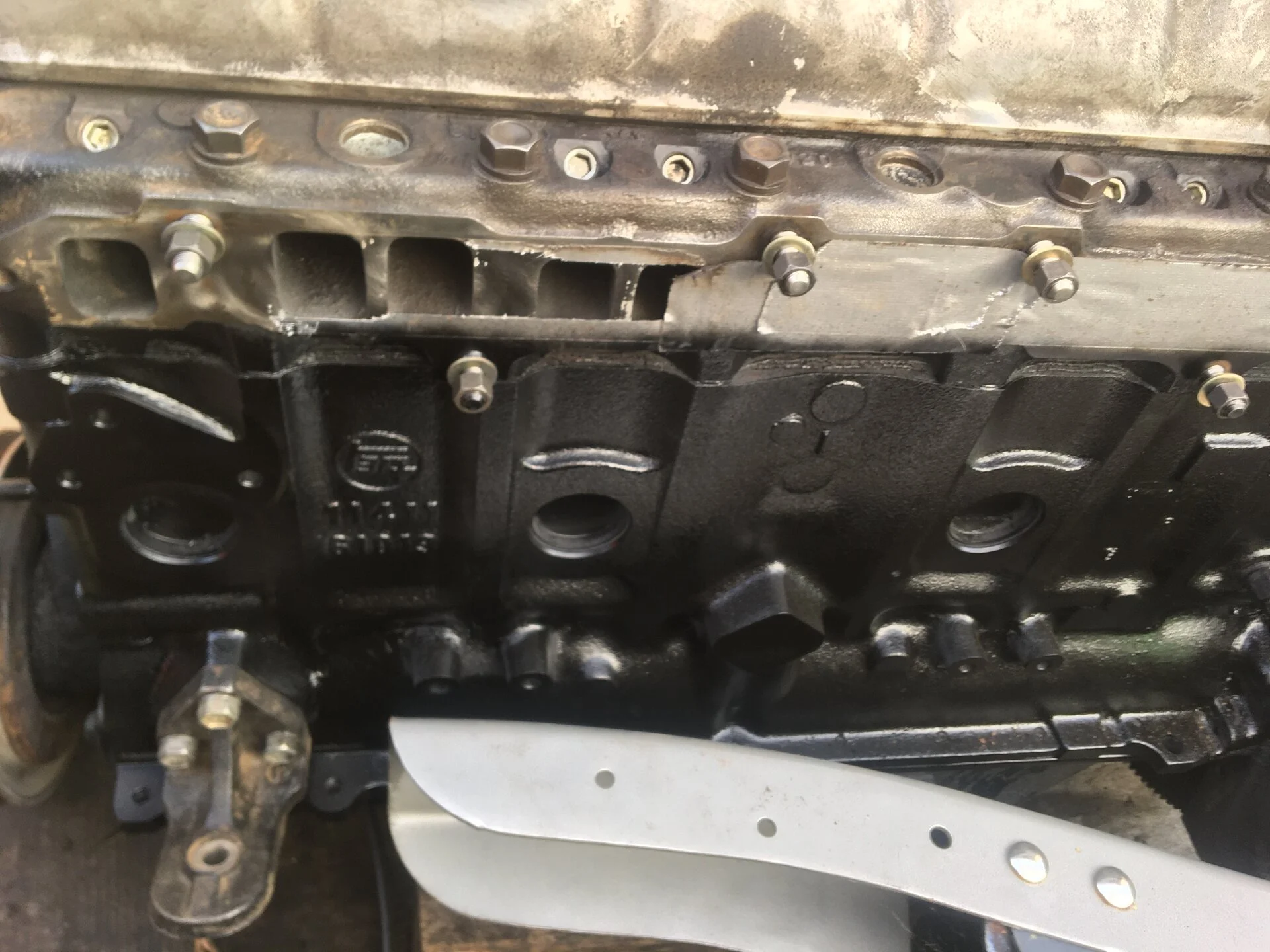

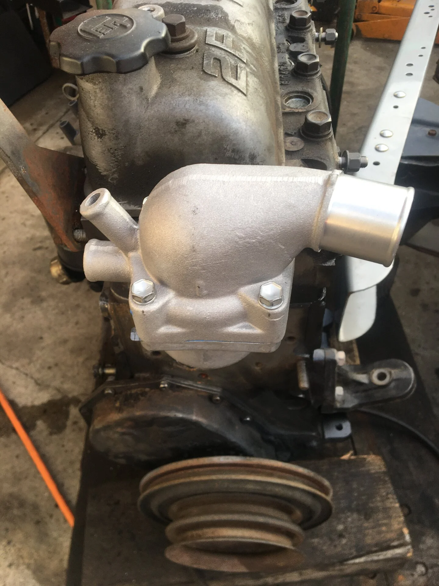

In the mean time I have been cleaning and scraping years of dirt off the engine painted the drivers side of the engine block, installed a CityRacer Thermostat housing, removed the oil cooler and cleaned it up and painted it. Bought new washers and o rings for it.

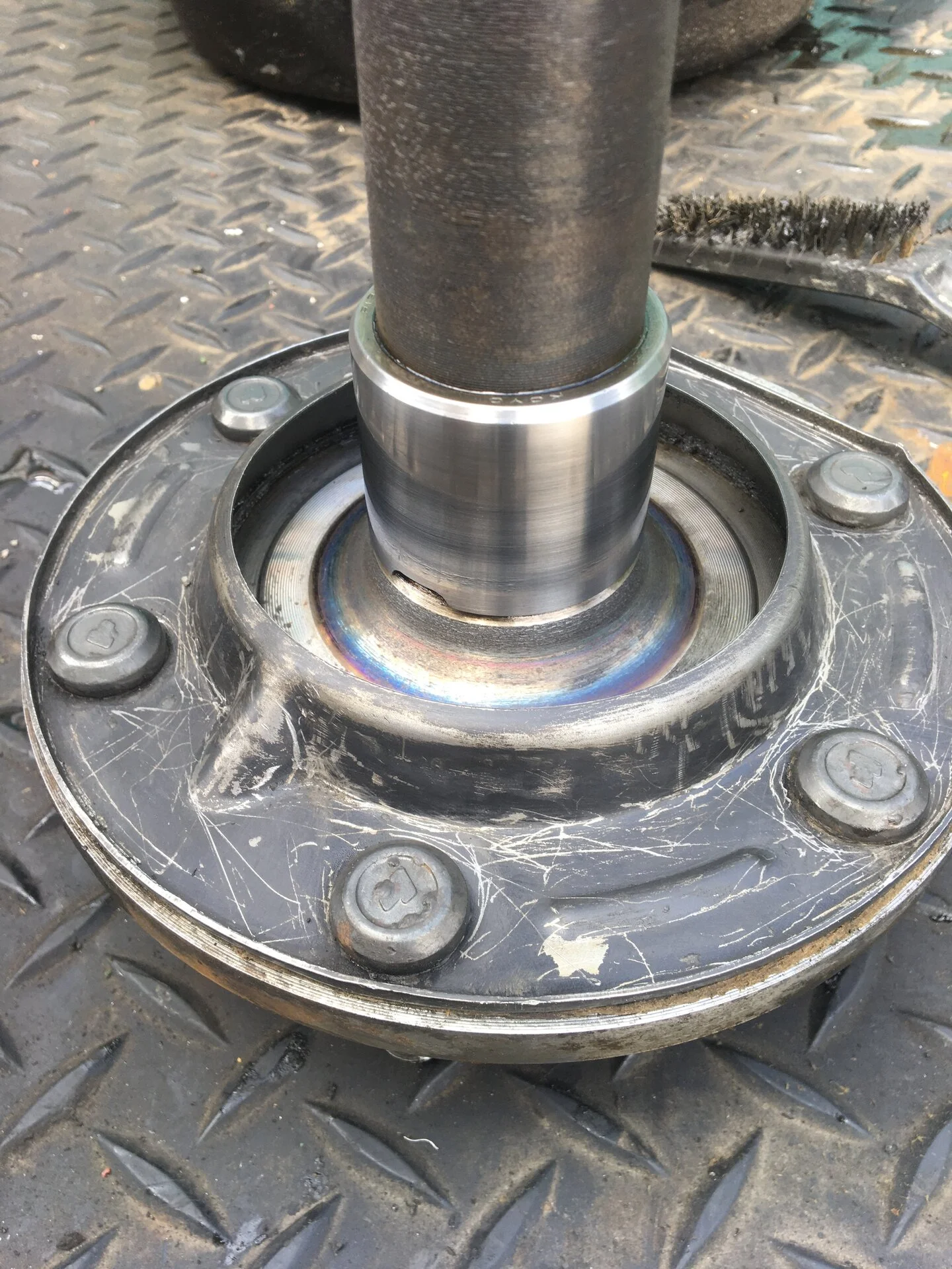

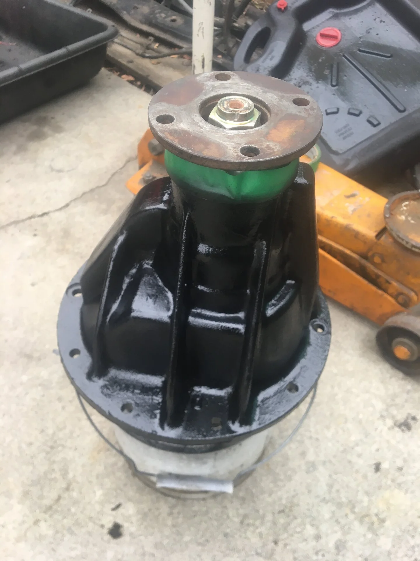

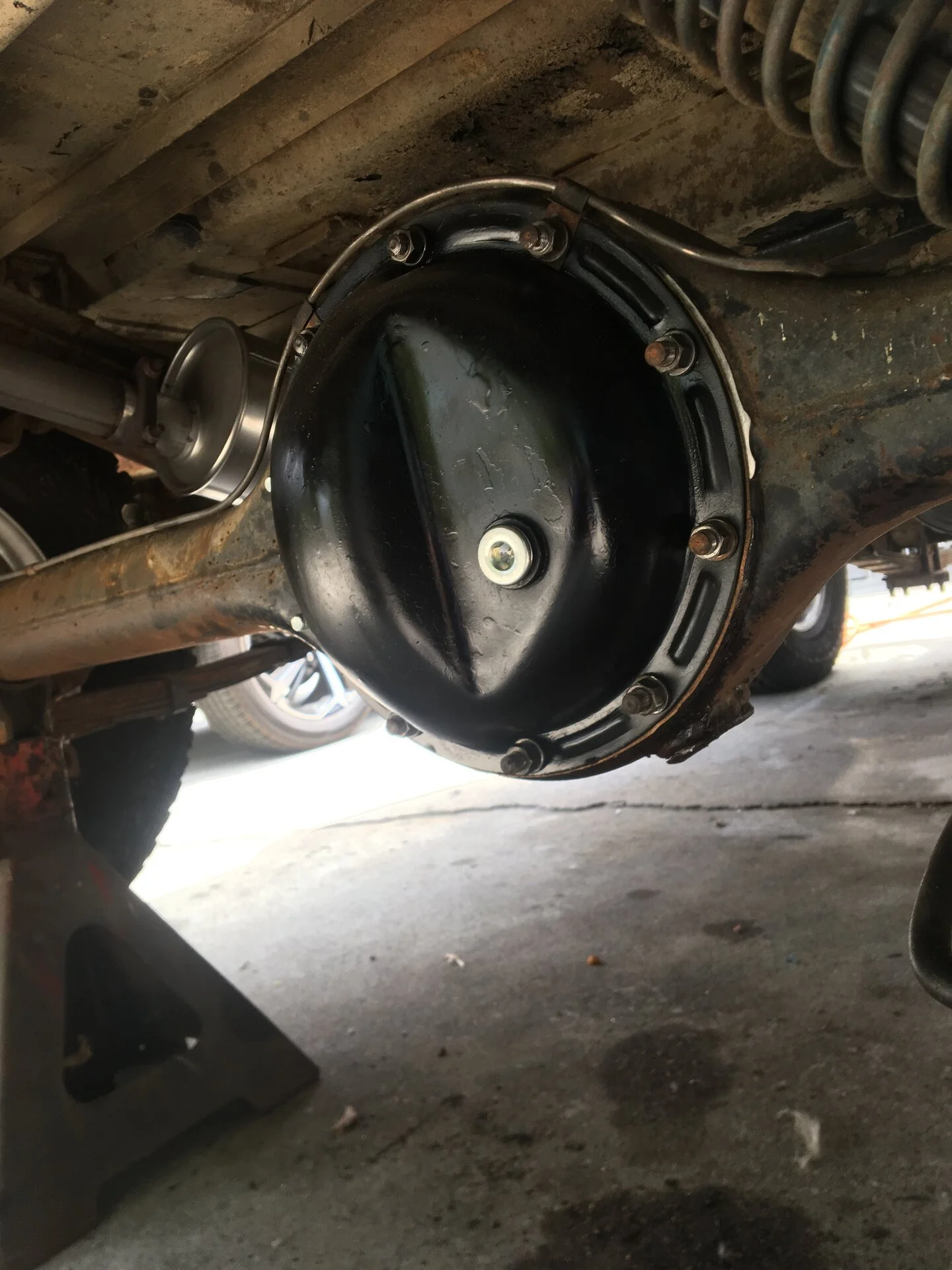

While waiting on parts I decided to switch the gearing to 3:73’s. I had these carriers from my previous fj60 I lost in a accident.
Now going to good use.
Just finished buttoning up the rear end. I had a few studs that where pretty wiped out.
I should of replaced them all but I’m on a budget. So its replace what is needed.
Removed the axles and cleaned out the outer part of the axle housing and replaced the oil seals. The bearings where good.

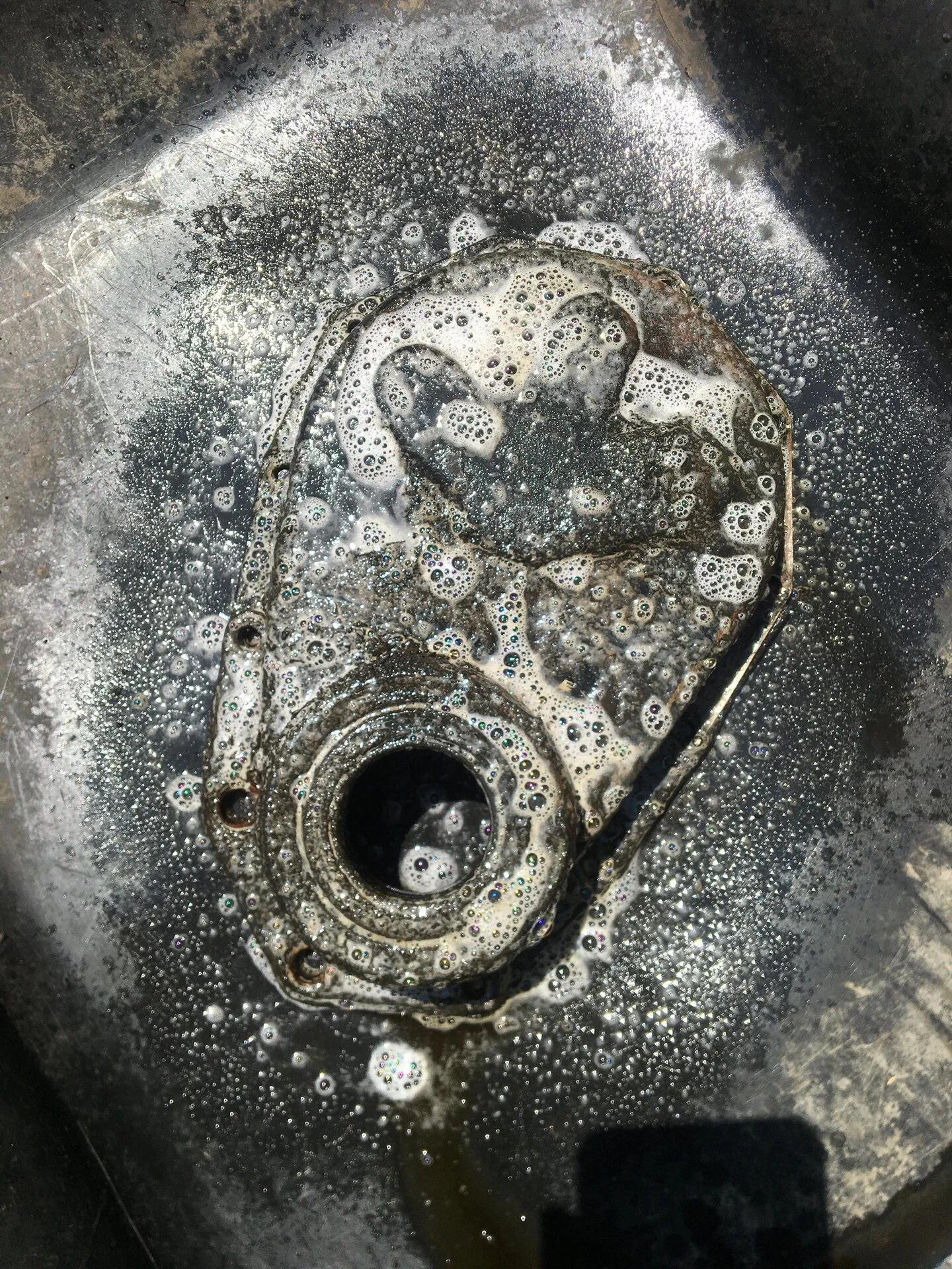

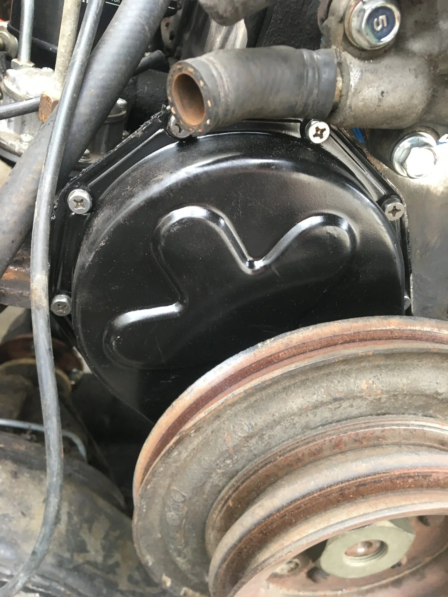

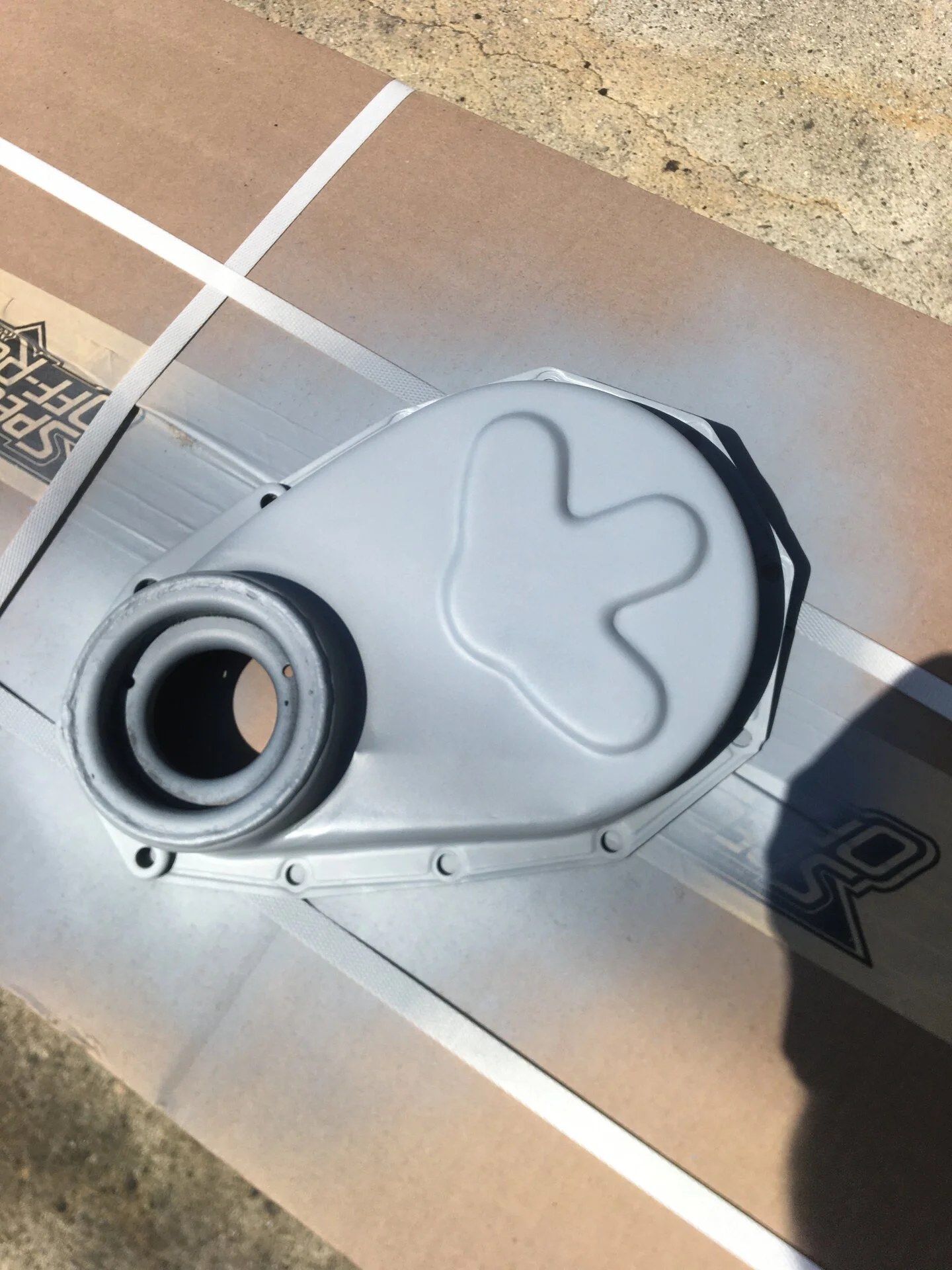

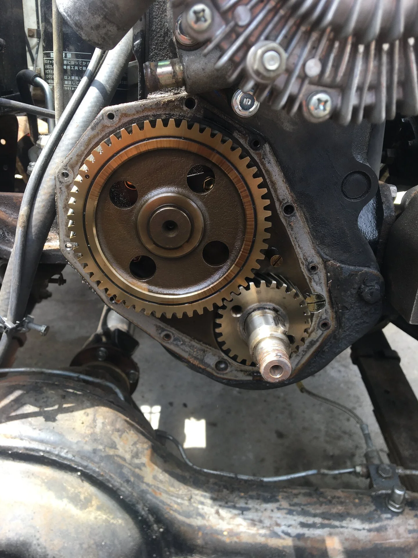

Removed the timing gear cover cleaned it up and and prepped the surface. Cleaned and sanded the cover and painted it. installed new seal and gasket.Got the crank pulley on and started the installation of parts to finally get it running.

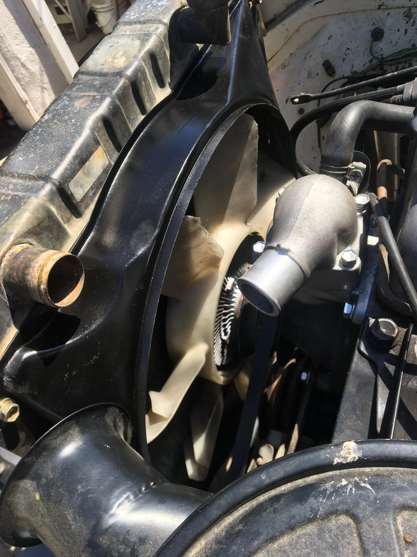

Prepped the fan shroud and painted it.
Installed it and had a little rubbing from the fan on the edges. Installed and removed it several times to get it right while trimming the tips of the fan.
No more rubbing.

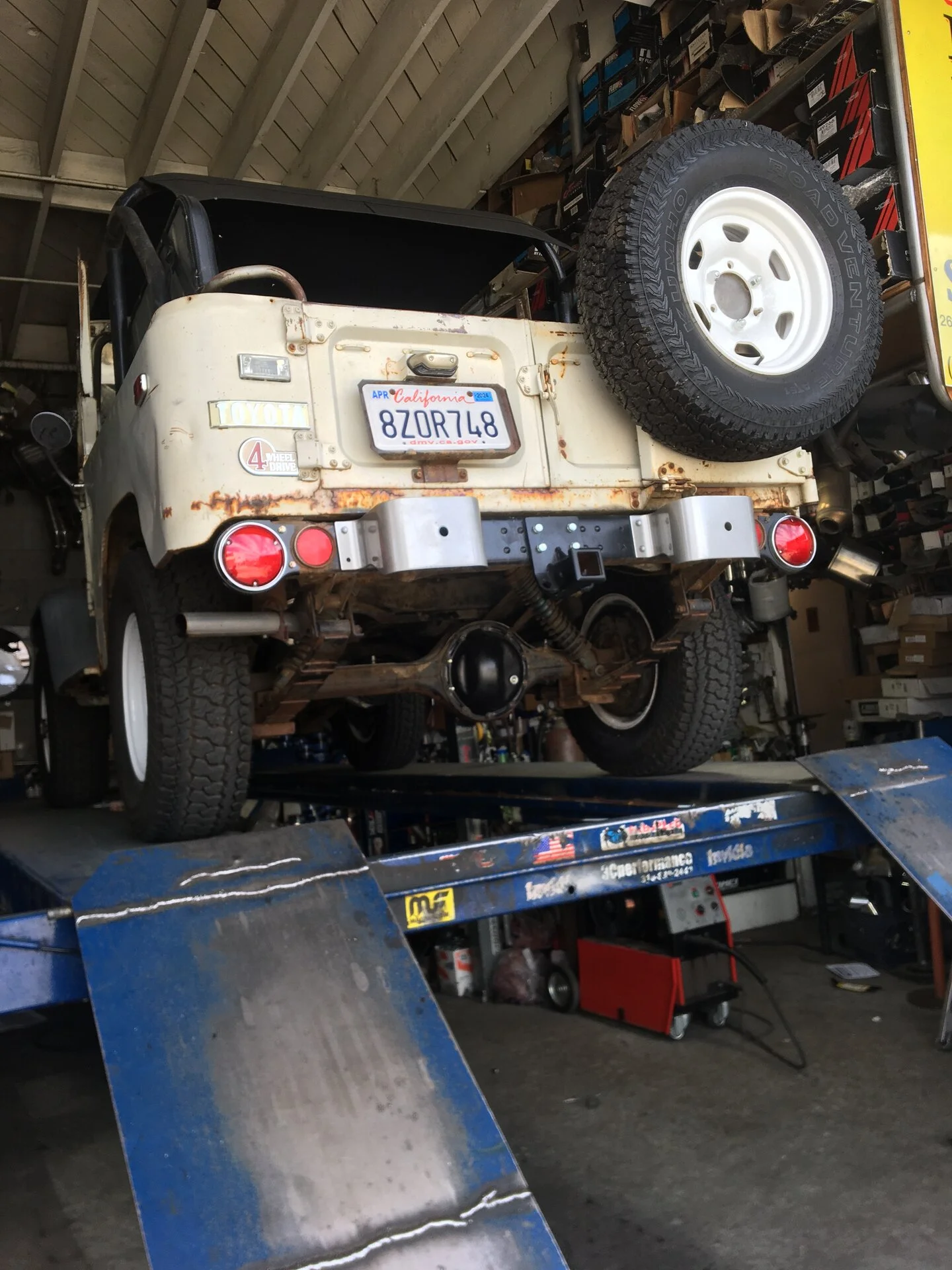

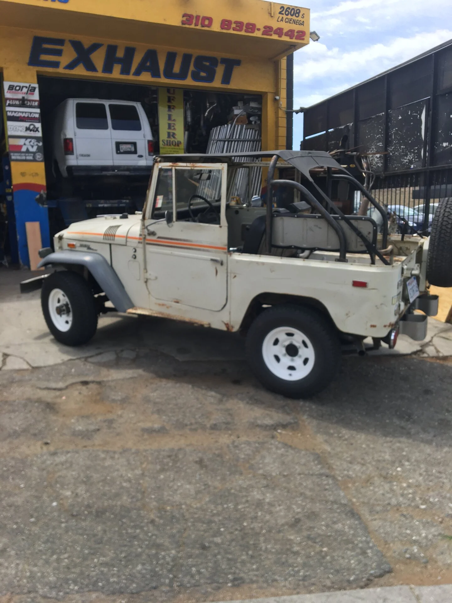

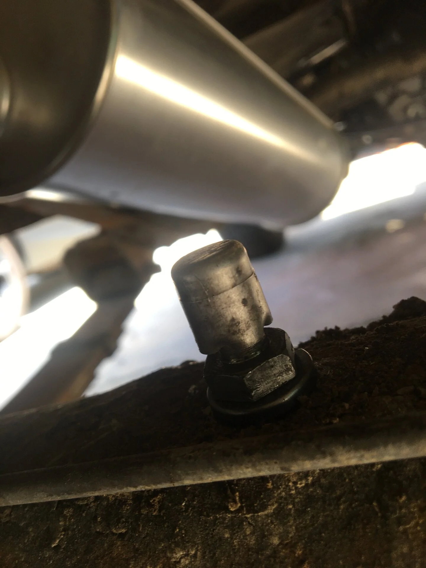

That day earlier I had taken the cruiser to muffler shop to have all the hangers fixed. Since some broke and was poorly done.
Muffler shop hooked it up and made it more solid than it was. 👍🏽

Did my maiden voyage drive with 2F installed and drive like a champ.
Only a few minor hiccups
One: the starter wire came loose and wouldn’t turn on
Two: slight water leak at the heater connections at firewall.
Three: fan belt loosened up and started to squeal. will get an adjustment bracket from VintageTeq.
Four: definitely need to update suspension. It is rough.
Overall good drive!

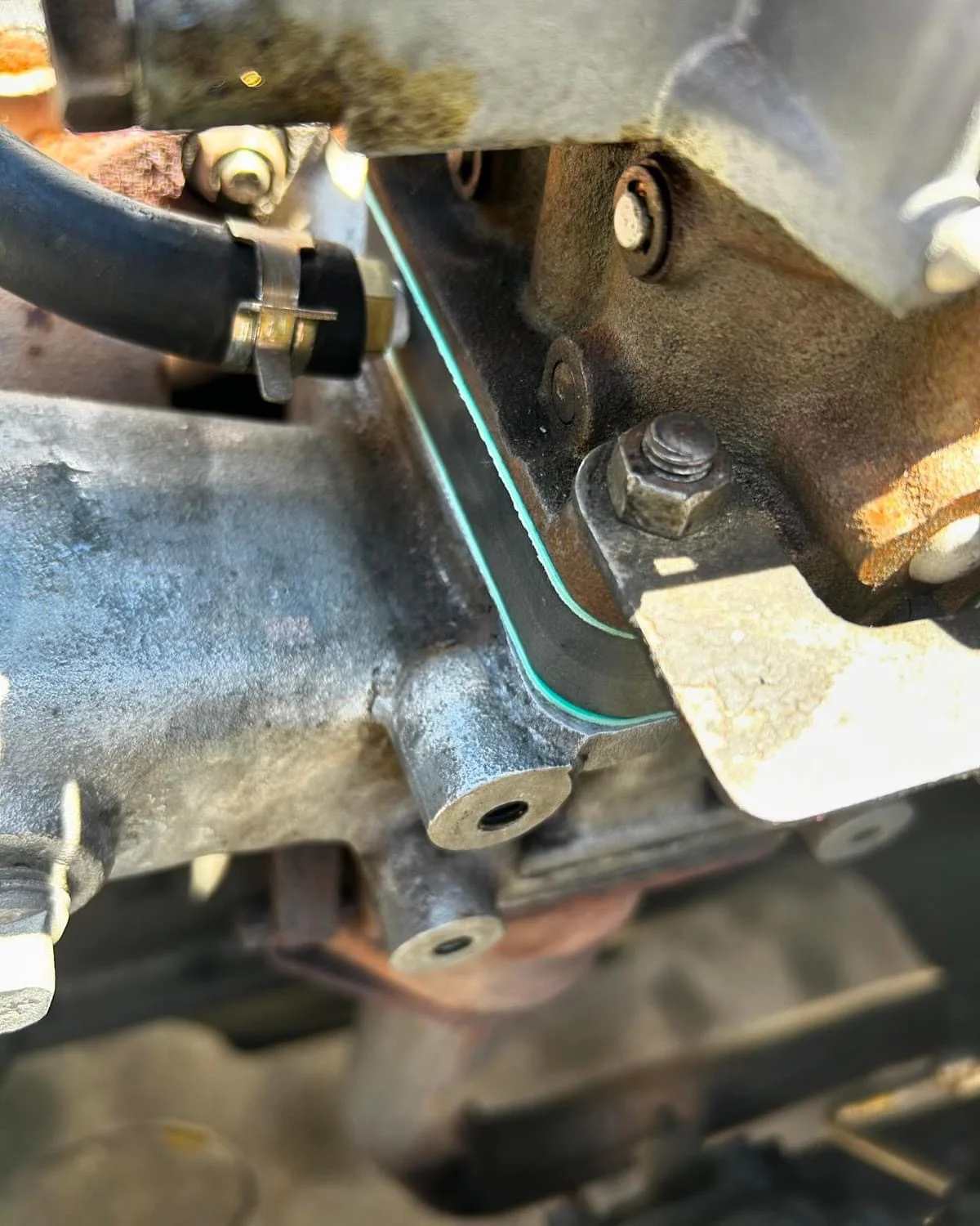

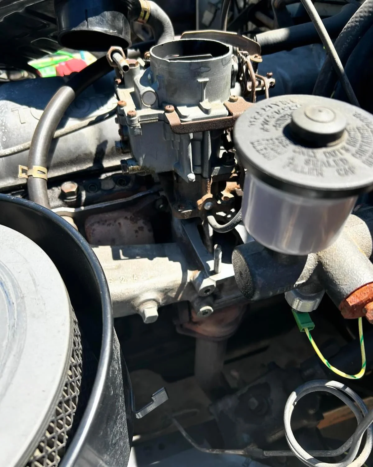

Worked on the 40 series today. And replaced the old original carb base and gaskets with a new base from @Redlinecruisers.
I feel like it made a difference and have no more vacuum leak from that area. If the prior base had one I couldn’t pin point it.
Nevertheless truck idles better and no more hesitation.
Now to get them darn springs replaced I dislike how this drives with them worn out springs.
Just bottoms out and jars your teeth and whole body.
Did some more work on the 40 this week.
I did a lean drop and adjustment on the carb. Now she is running better. Idle was to low after it warmed up. She would shut off coming to a stop. I got good vacuum steady at 20.
