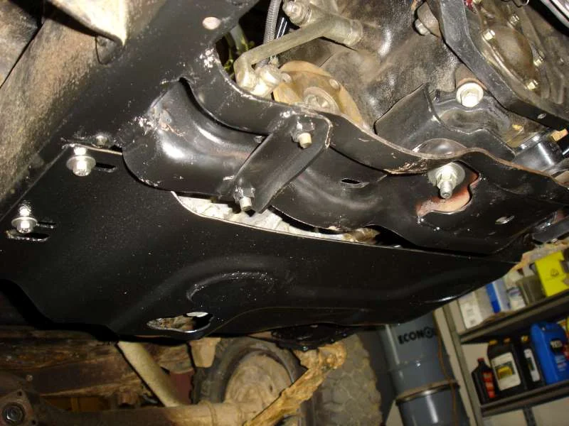

We were able to use most of the FJ60 X-member and fit it into the FJ40 which allowed us to keep all of the 60 mounts and t-case linkages without having to swap bellhousings.
We also installed the MAF e-brake kit onto the split case to retain an e-brake. We did run into a clearance issue between the e-brake drum and the rear cross member so we moved it.

I chose to do what Poser did in his H55 install and mounted my cross member just a bit lower to allow for clearance. Looking good.
