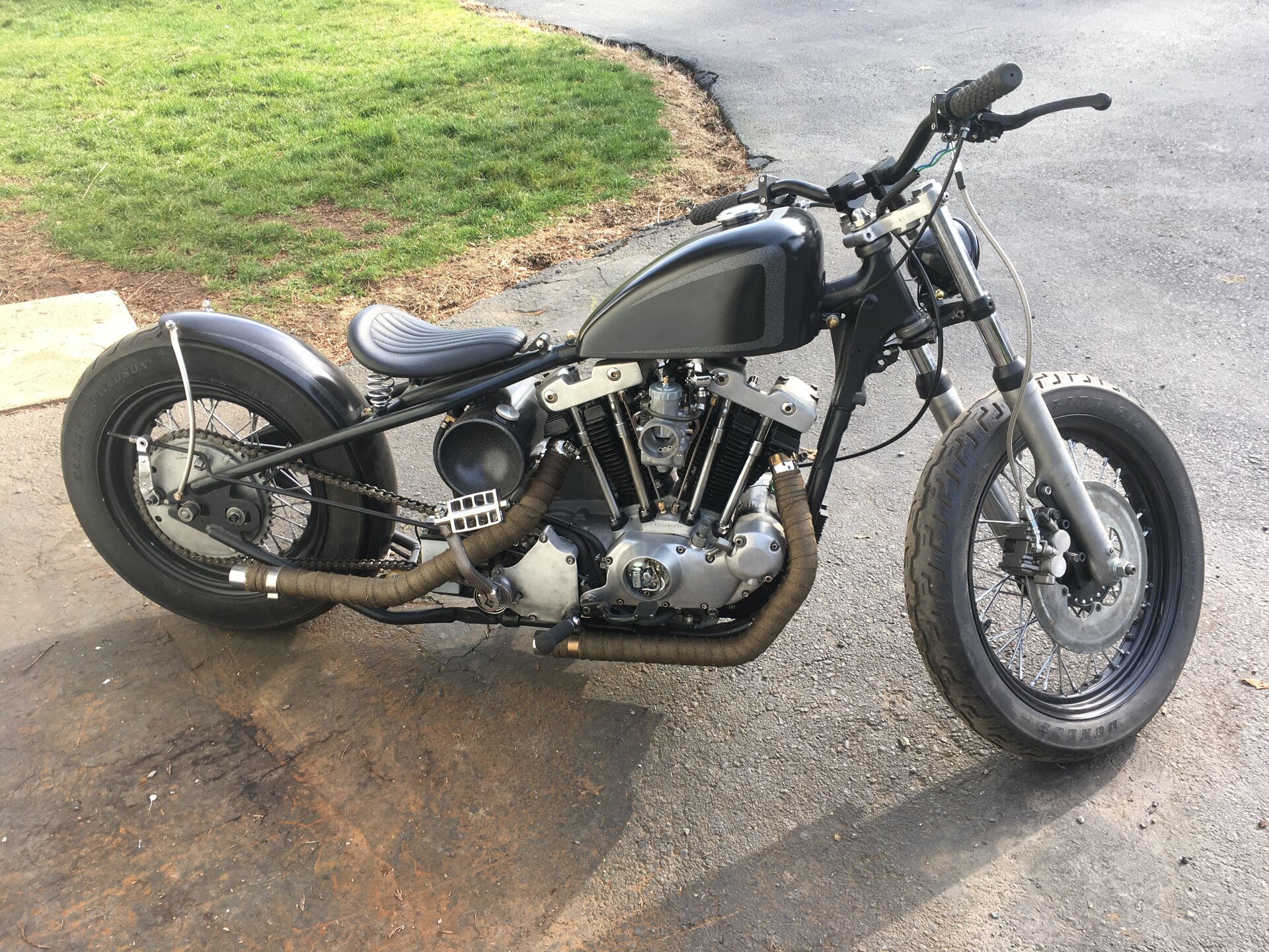

Short thread interjection. Last custom bike I finished up about 2 years ago.

Here's the shovel as it sits today - 85% done:
Always good to see someone spending time on an Ironhead! Nice work!

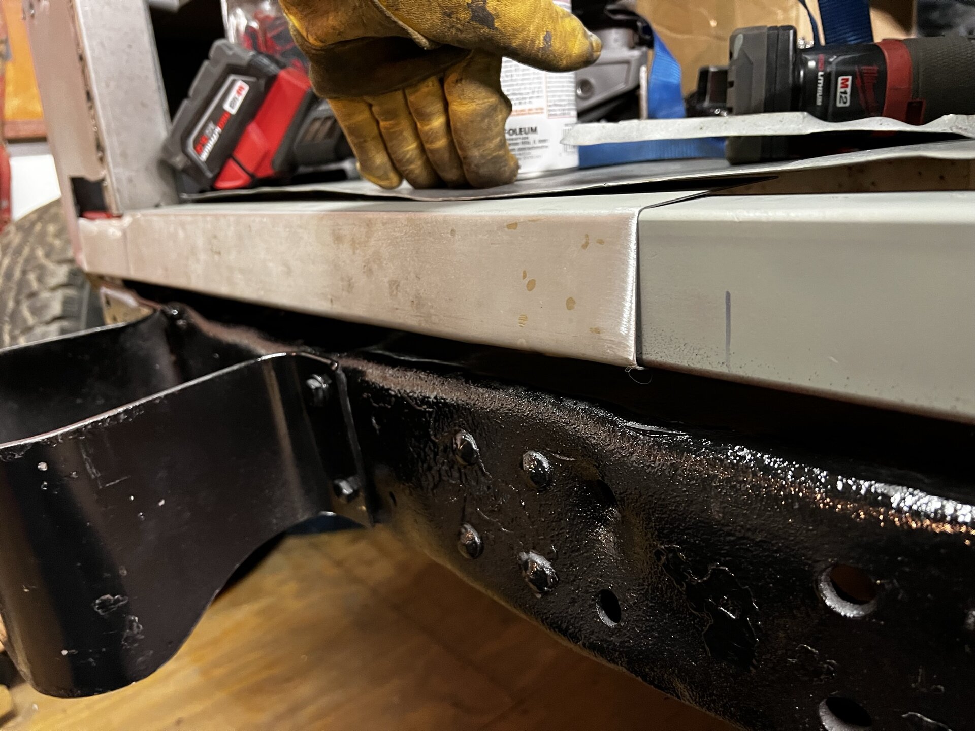

Rear sill made out of 2x2x.125" square tube.
Cant see but the bottom is slotted for access to the body mounts.
Fabbed up a rear sill "cover" and spaced it out .187 to sit flush with the rear tub.

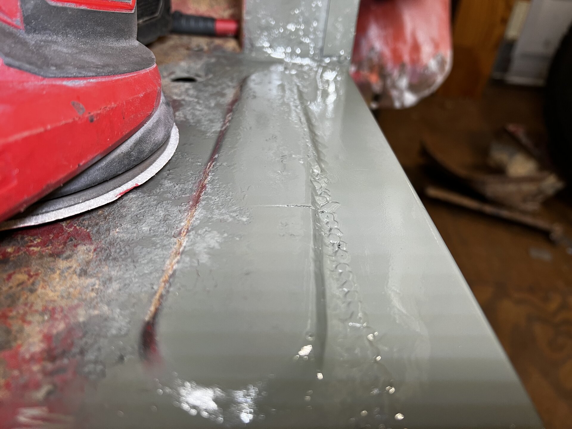

Several hours of grinding and hammer and dolly work later. Looks like it never happened.

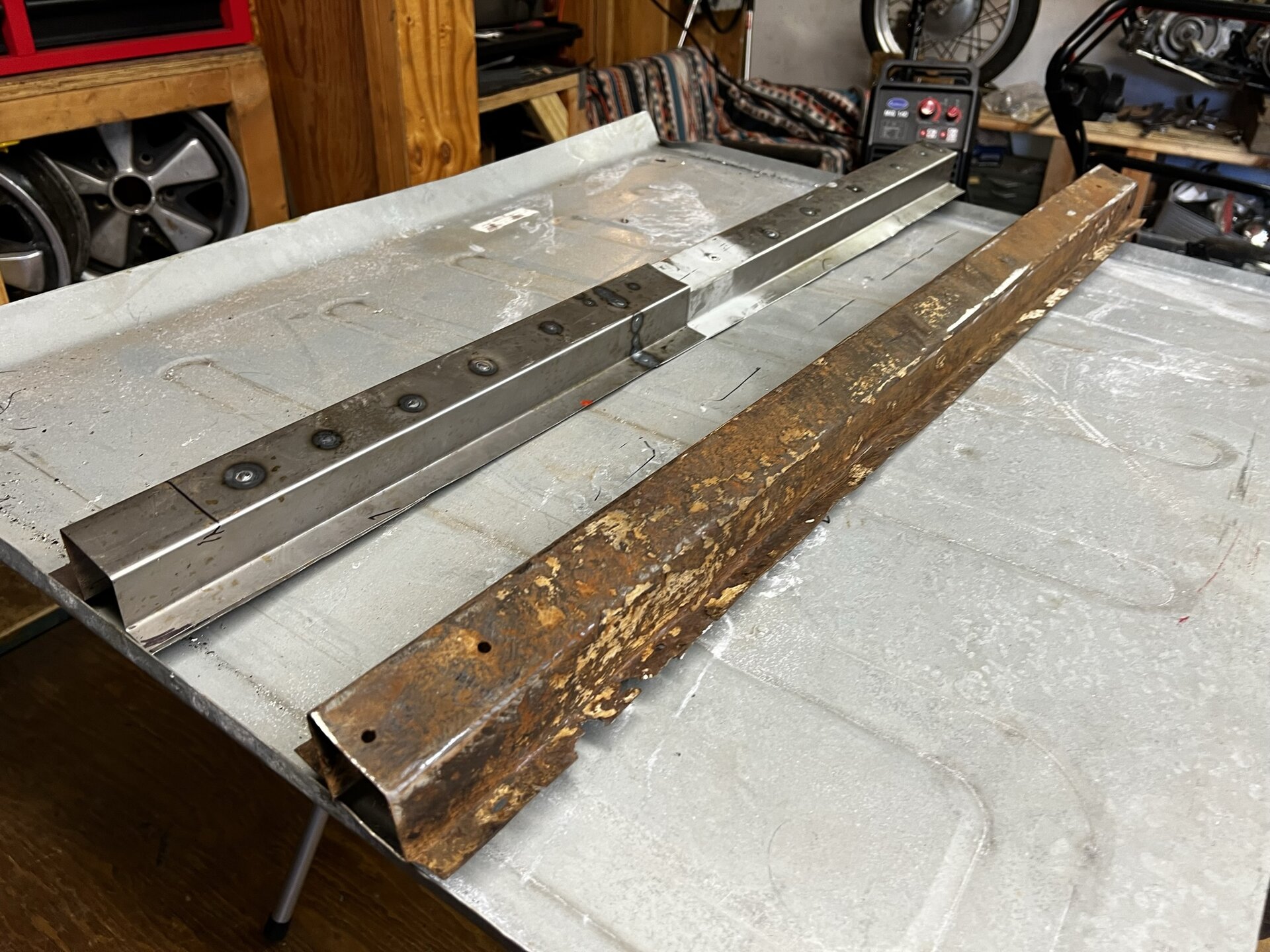

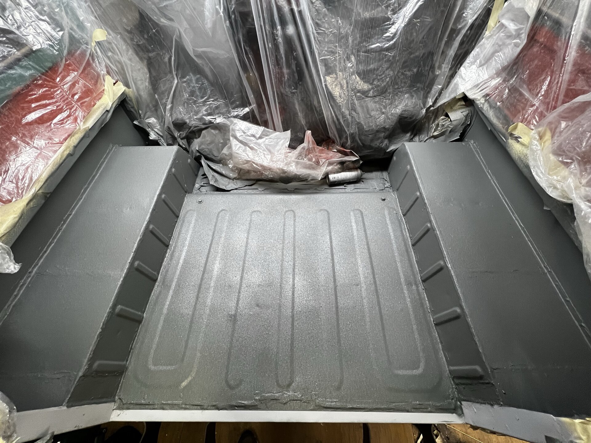

That brings us up to last night. Same but different. I cut out the final large body panel that needed replaced - the passenger rocker:
I already shared a photo up top of the inner rocker and floor structure that I fabbed up.
Some trimming to do, but really nice to get this SOB out of the way and on the car!
I'm not sure the manufacturer of these rockers, but they don't fit that great, (FYI, most replacement panels don't) Almost everything including OE needs massaged.
These are about 3/8" too wide (you can see in older photos, I actually had to cut the other side to shrink it)

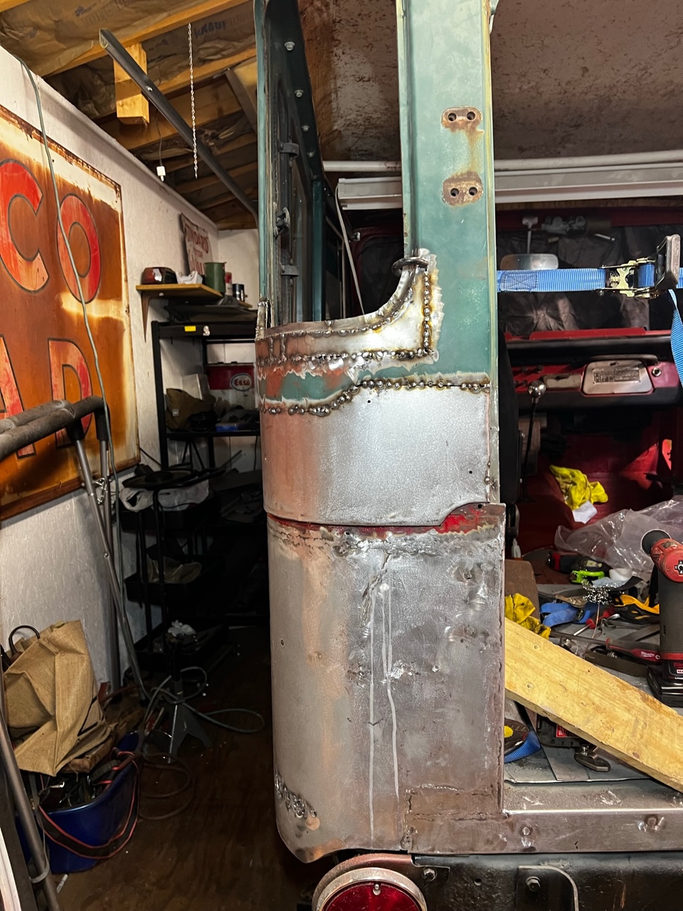

As for the top, the rear lower (either side of the rear doors) flange and the “swallow tail” shaped curves are almost completely missing.
This is causing my top to sink down into the tail gate. Makes it’s tough to open the rear doors.
Each side of the top will require recreation of the lower quarter skin, the inside flange (where the top bolts to the tub) and most difficultly, the vertical post that supports the top.
Let’s make some cuts.

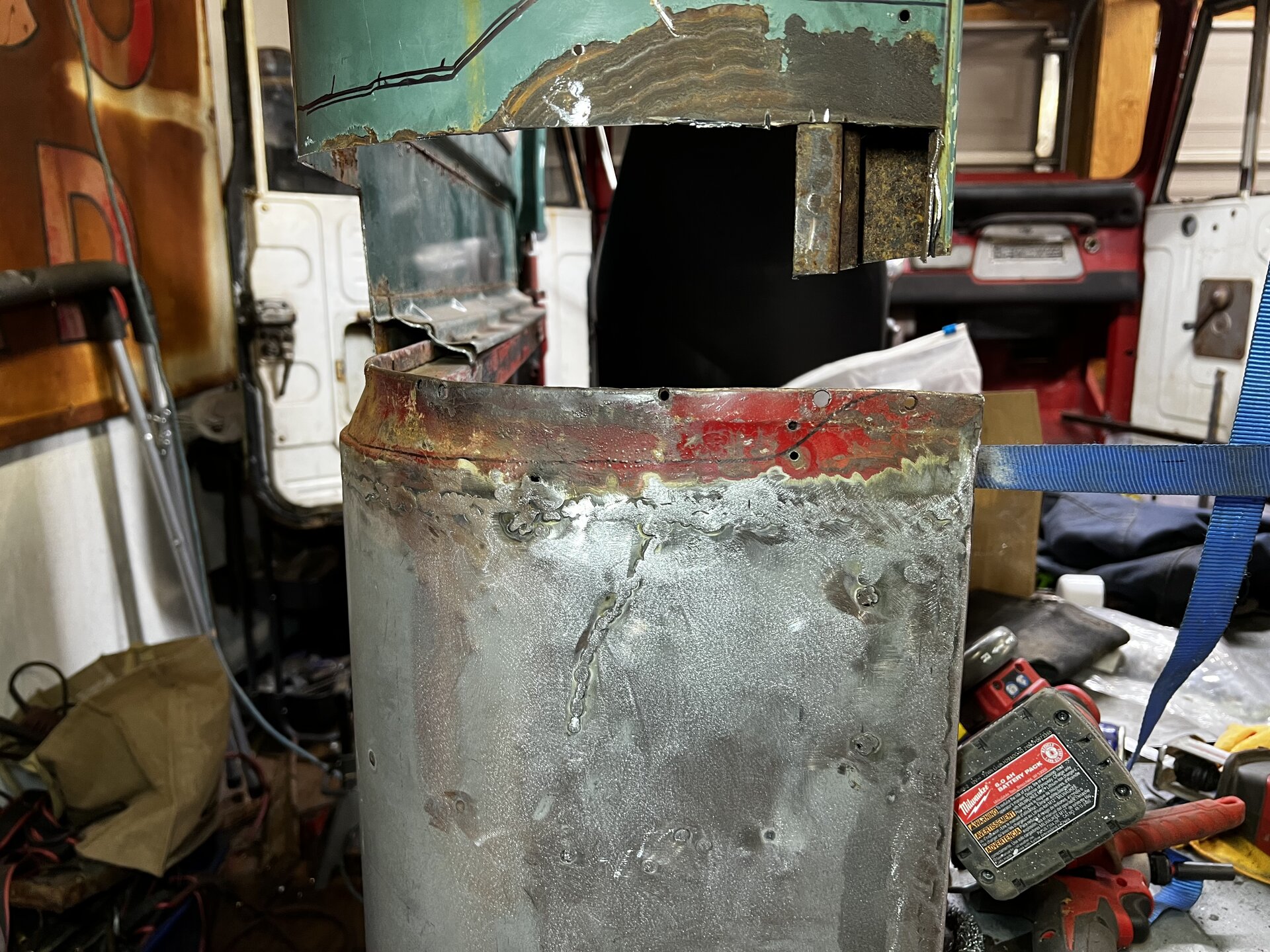

In this photo you can see what I chopped out.
Ignore the that quarter, while mostly repaired, it’s still an unfinished disaster. The truck has been wrecked. So I had to make some relief cuts on the inner tub frame and smash the tub out.

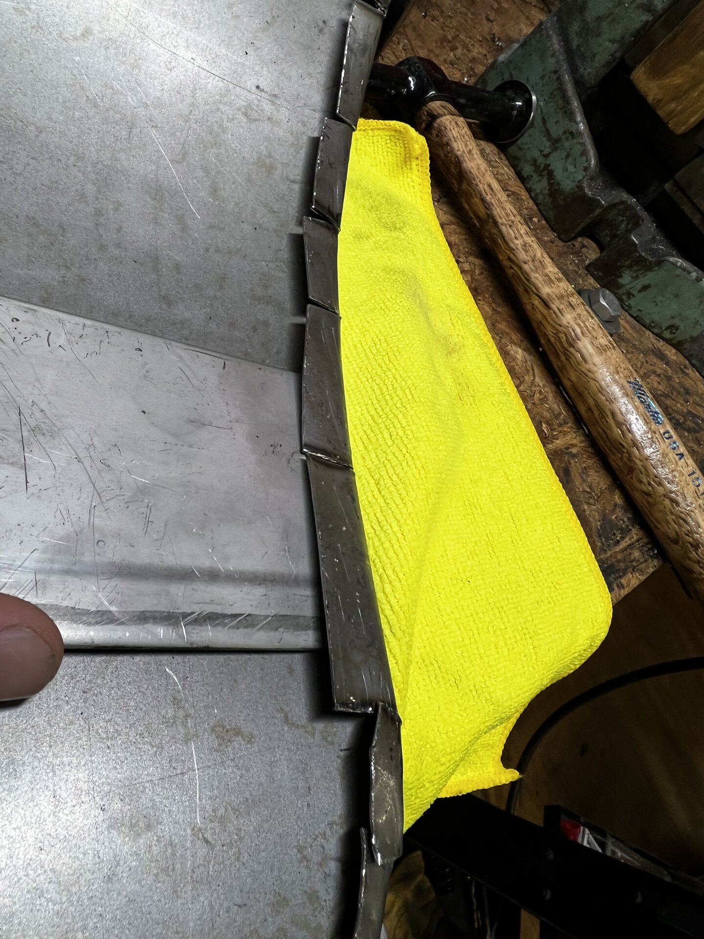

A bit difficult to get the bottom flange. A 180 bend in is called a “hem” in sheet metal terminology. I don’t have hemming dies at home… who does? So it’s not going to be pretty.
I do, however, have a finger brake and many hammers.
So I’ll cut some slices (more bite sized portions, way easier to bend) bend the slices to 90* on my brake.
Place a piece of steel, same material thickness, next to the new bend and hammer the bitch down.
The extra piece of steel butted up to your bend allows the hem to have a small radius, (looks factory) without it, hammering the hem over would result in a pointy and work hardened edge. See below:
A lot of hammering, a bit of welding and a few beers later…

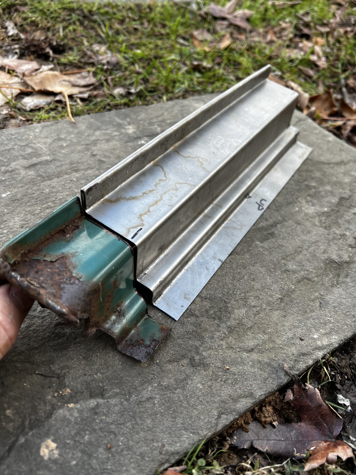

This is the culprit of my sagging top.
2 pieces. Also including a hem. Needed for left and right sides.
Taking some measurements. Wont be able to get it perfect. The inside radius is different for every bend on this piece. But thats what filler wire is for, haha
Bending a 9” section. I think I’ll only need 3.5” (x2 for each side) and a little extra, because you never want to end up too young and have to do it again.
Sharpie precision. No back gauges here.
Old and new. What do you want for 8 bucks an hour??
Here’s the full piece lined up with the old.
Oh yeah!!!
I’m really thrilled with this piece. Looks just about right.

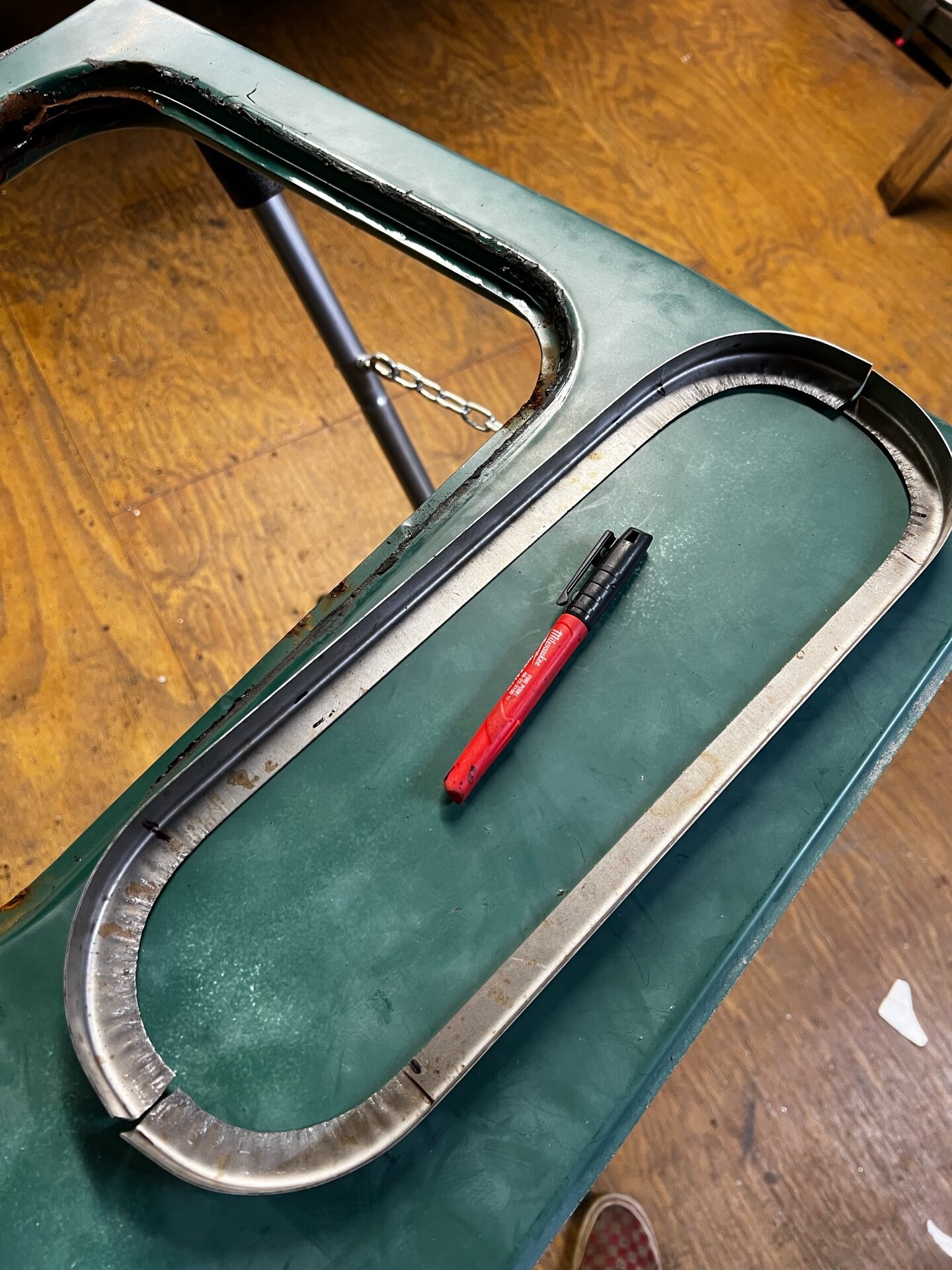

Fixing one of the ambulance doors rust - this was a done a bit ago, but hadn't shared in this thread.
Made these with the shrinker/stretcher and brake.
Good practice for making the lower mount corner of the hard top that's coming up next.
Done, doesn't need to be perfect, as its going to hide under a fat seal anyways.

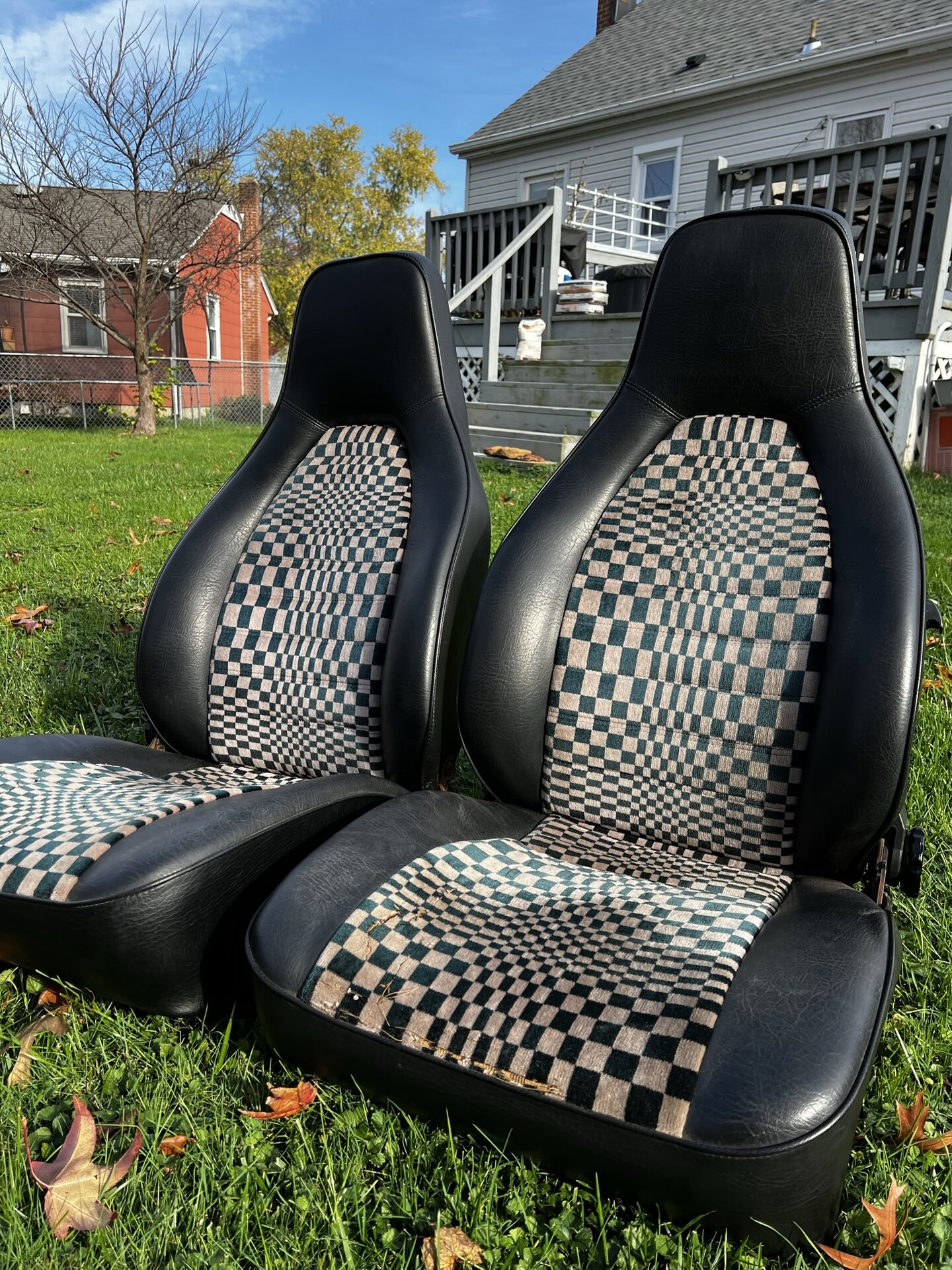

I have decided to use a spare set of buckets seats I had laying around. They are amazing and should fit well with the truck.
These are mid 70's Porsche "Pascha" seats. Pattern used in the both 911 and 928.
