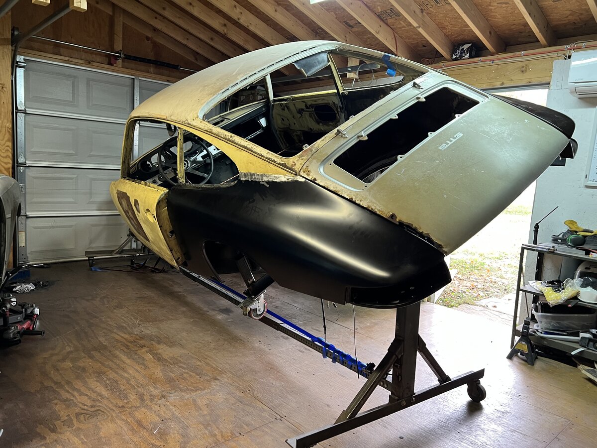

And for any interested, here are some quick snaps of my other projects:
My '69 912, and a customer's '67 on the rotisserie getting all the metal work done.
Quarters, suspension pans, R style mods, rockers, etc.
Also for good measure, this is my '71 914. I did a full metal restoration on, rear end, floors, longitudinals, rockers, etc. I also built a sweet little 1911cc motor for it.
Obviously I love old rusty stuff.

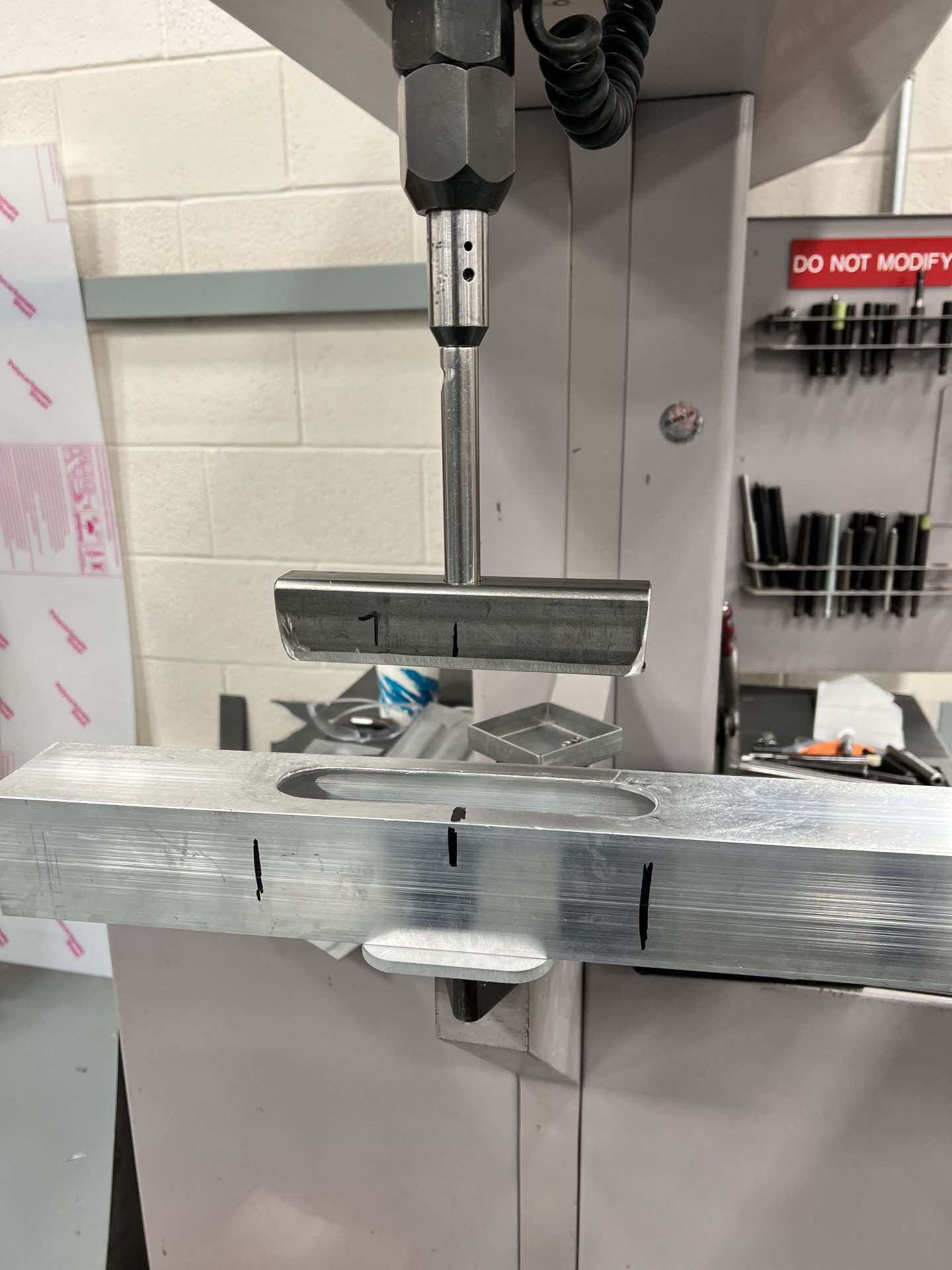

I made up a shakey and kind of corny stamp and die fixture.
Tested out:
Make 18 or 20 of em and flatten the edge in a big vice.
Lay them out:
Idea is to make 2 pieces for each tub. 24” flat, and a 16” with the rear quarter radius.

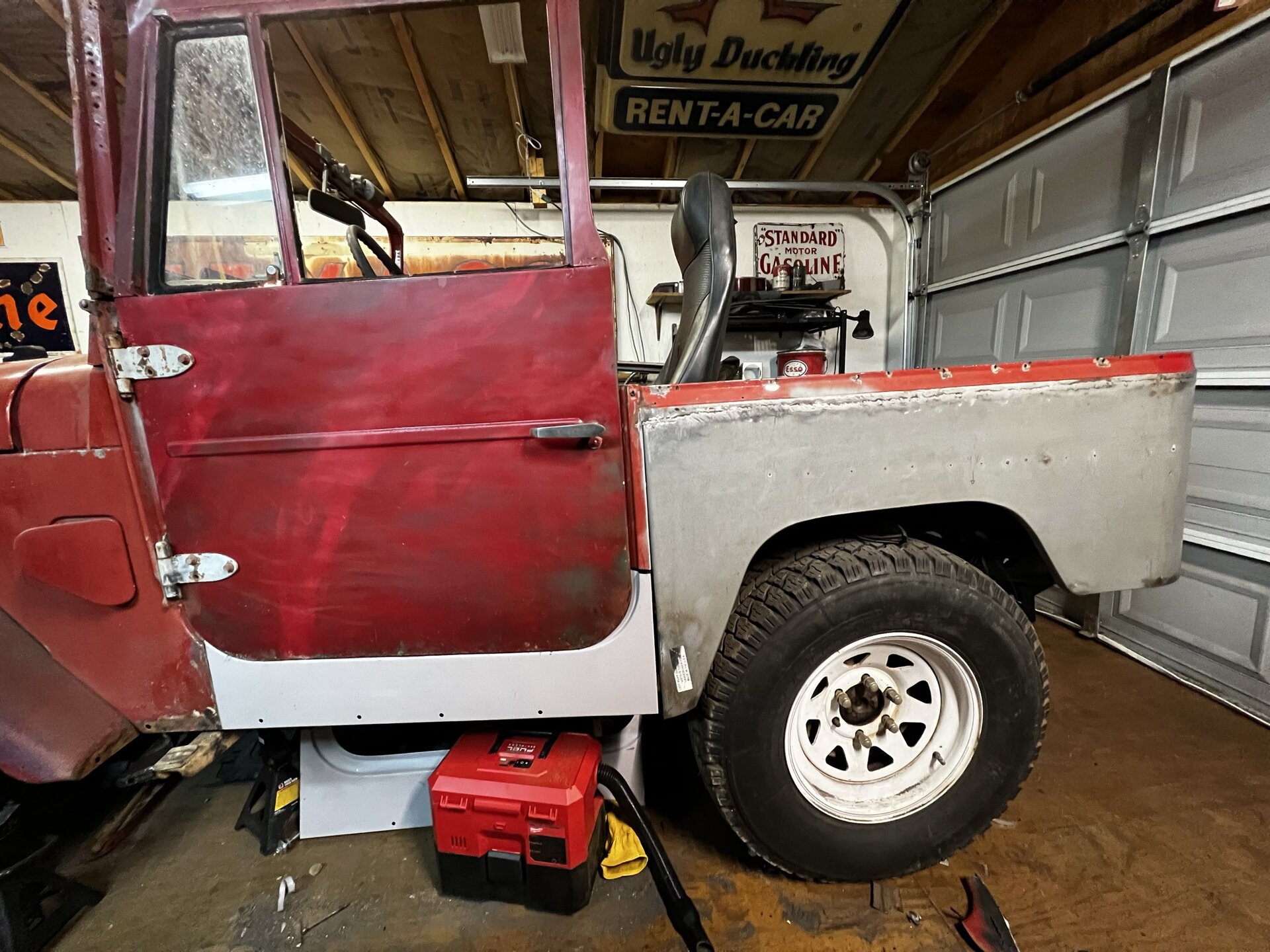

Drivers quarter on, time to deal with the rocker:
A kind member who's name I'm forgetting donated these to my build:
Much better than the half height pieces I got.

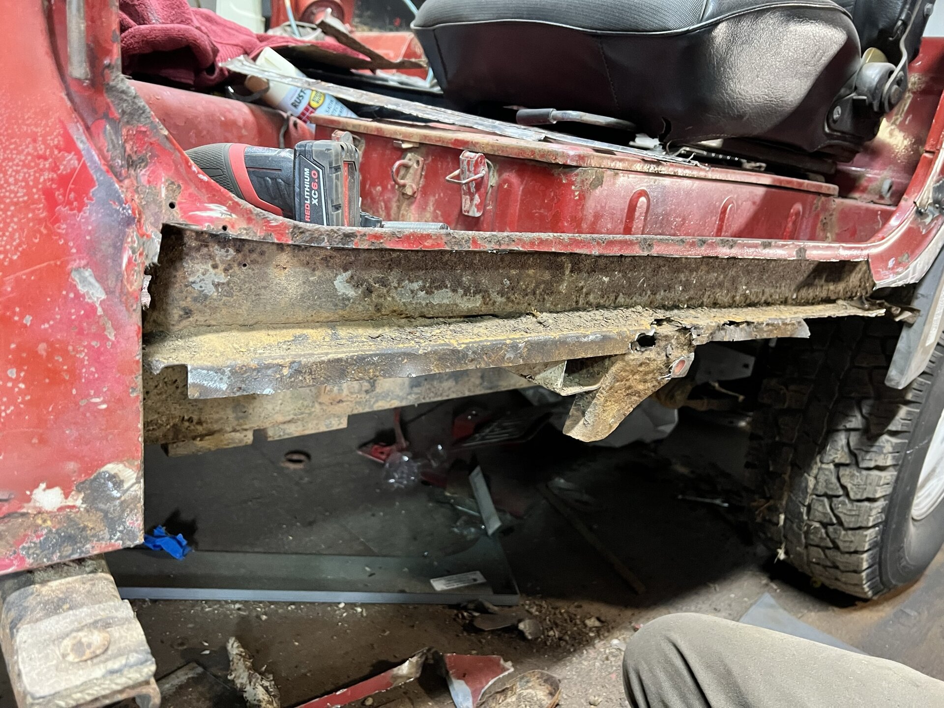

Couldn't find a photo, but I rebuilt the inner rocker structure. Easy peasy.
Fitting up. This was more diffucult than I thought. I couldn't brace the door opening, because the fit was already way off.
Truck didn't have the correct sill when I received it, so the dimensions were all over the road.

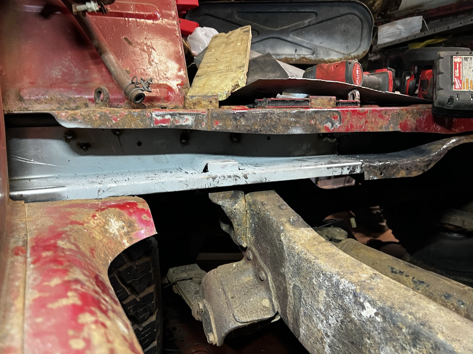

Fitting up with the top half:
LOTS of lifting and shoving the body around to find the correct door gap. Once done I welded in a brace to hold it in place @ 32.5"
I didn't know this yet, but a huge mistake was already made.
This truck should have been on leveled on jackstands before I attempted any of this. Would have saved me many hours.

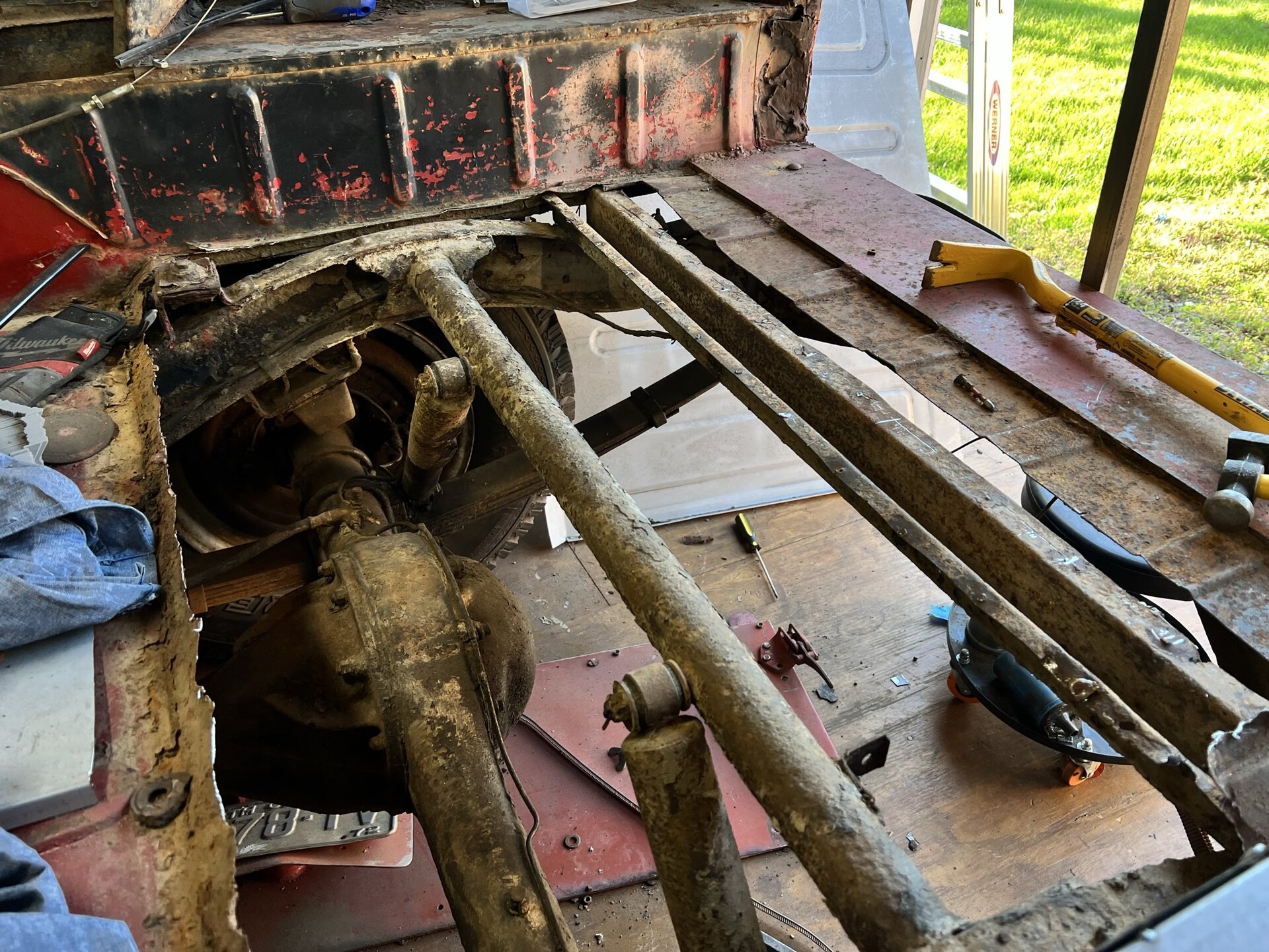

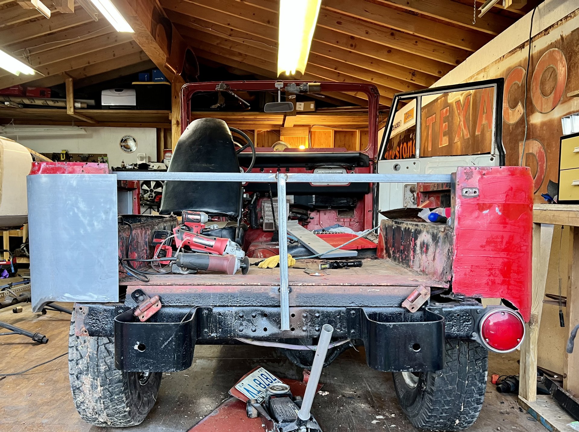

Cutting the bed out and working with a fresh metal for the wheel wells:
I SHOULD replace the vertical sides, but I'm really pressed for time to get this out of the garage. Maybe on a deeper resto...
Yikes: (peep the bondo wall near the back of the passenger side, haha!)
