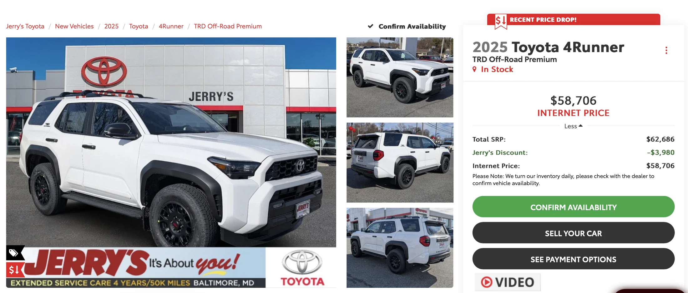

Starting to land locally... nice looking truck but $10k premium over the 5th gen for the TRD Off-Road Premium. Anyone test driven or bought one yet?
