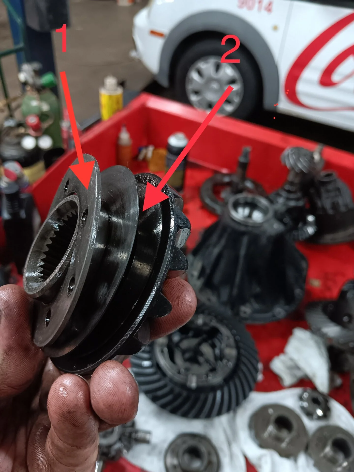

I bought a 100 series rear axle and used just the whole carrier assembly but not the axle housing. The only 80 series carrier parts that were used were the side gears.
Final setup is:
1) 80 series axle housing, side gear oiler washer with GM oiler washer added (due to slack) and side gears.
2) 100 series rear carrier
3) PDI ring and pinion kit (front/rear)
4) PDI bearing kit (front/rear)
If you were going to add lockers, I wonder what setup you would buy? 100 series locker? Or 80 series?
For clarification:
Number 1 is the original oiling washer for the 80 series and number 2 is the oiling washer out of a GM 8.5 28 spline open unit. They were both used together. The photo shows how they were stacked.

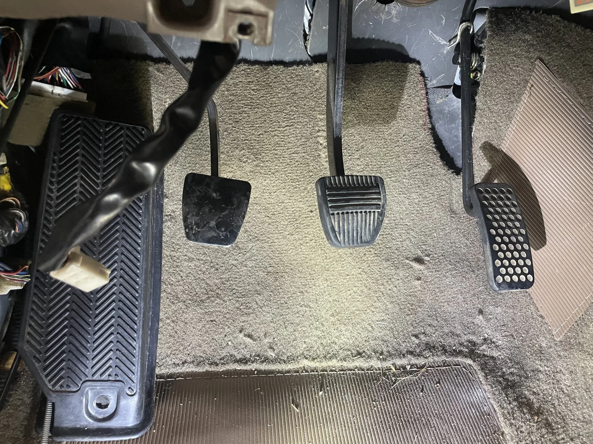

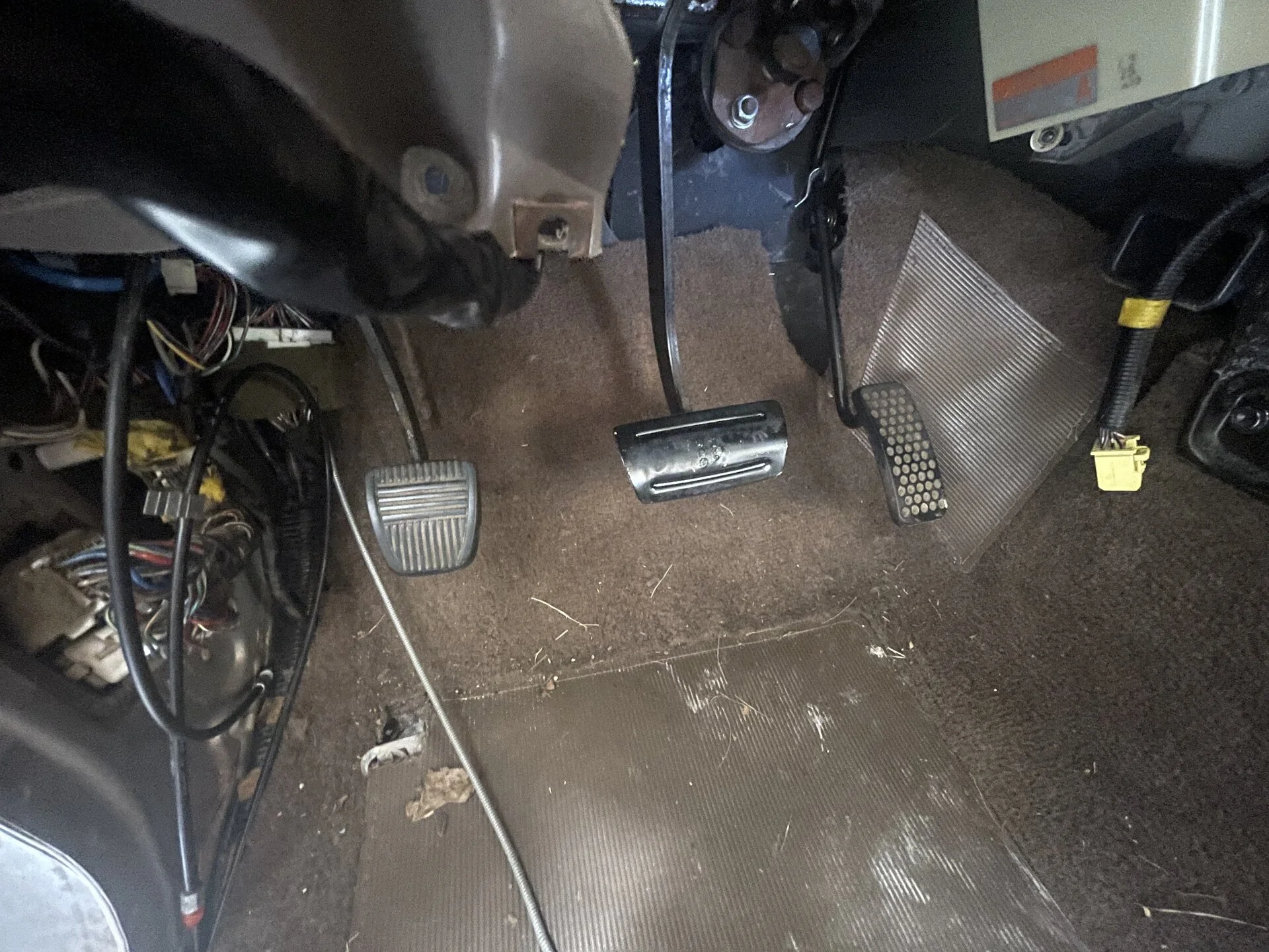

Lately, I've been addressing my brake and clutch pedal. I bought the clutch pedal off ebay from an Australian salvage yard several years back, not thinking that it was a right hand drive setup. I mounted the clutch pedal and realized it was very close to the firewall. I also realized the brake pedal needed to be modified after talking to several others ( @mattimooseprime @Will Van ).

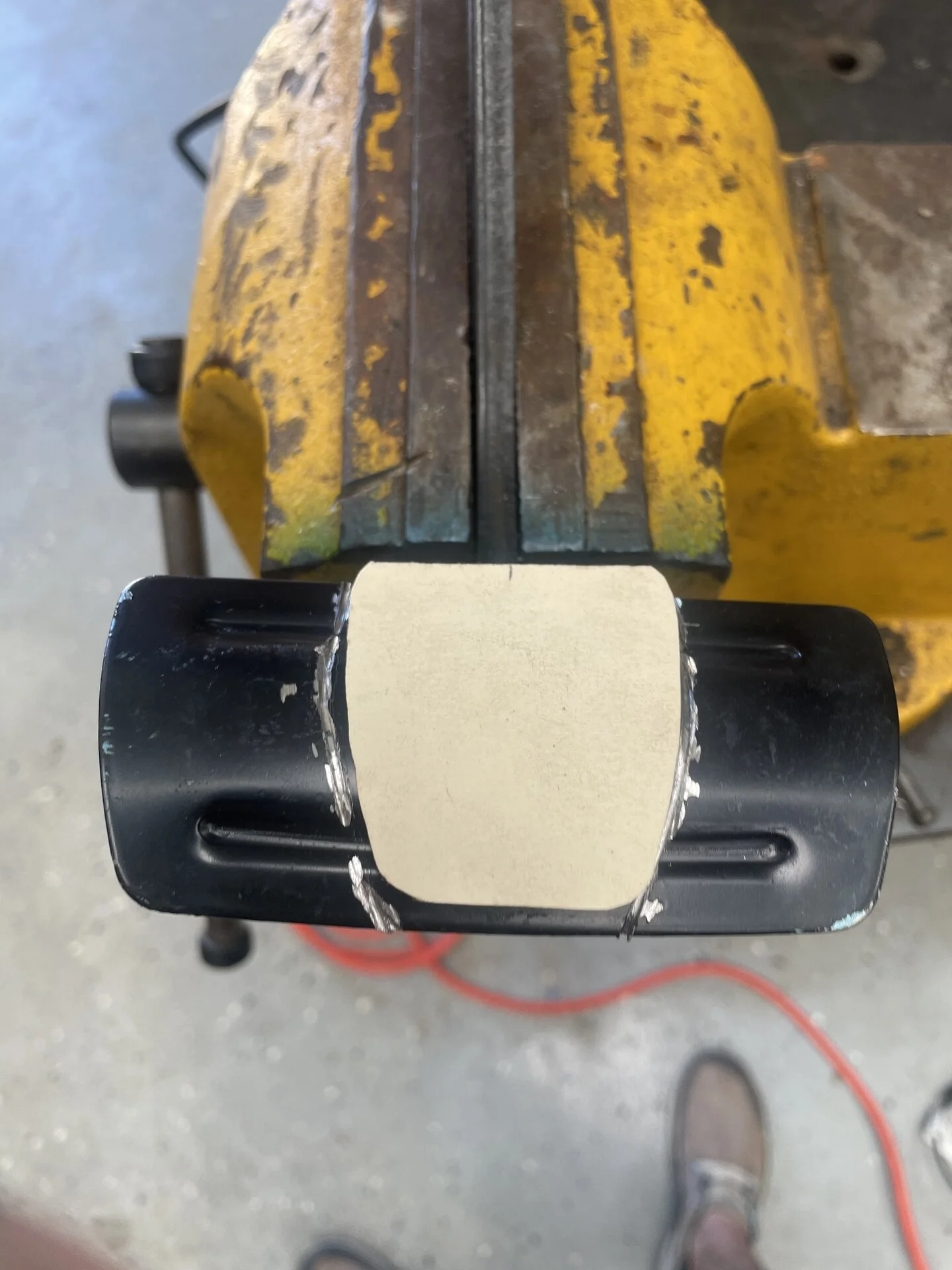

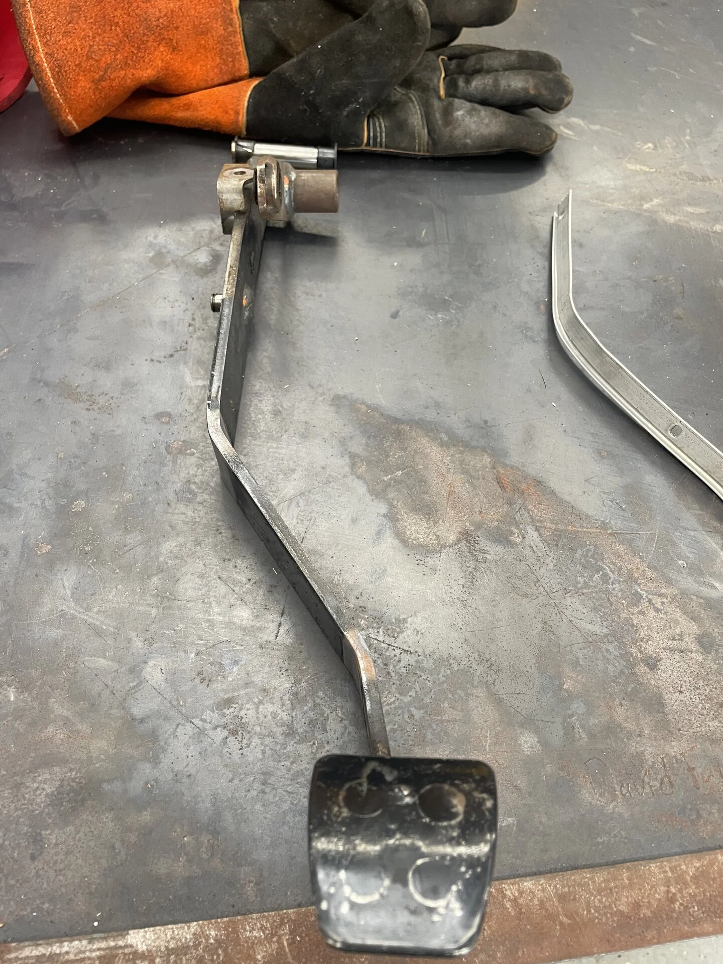

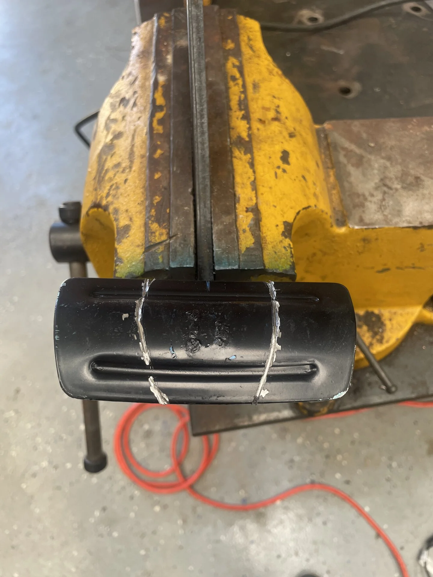

Clutch pedal modification:
I cranked up the cutting torch and put a little heat on the pedal. Just enough heat to slightly change to a orangish-red color. The pedal easily bent with slight pressure from a crescent wrench while in the vise. It was very easy to adjust the shape of the pedal. I added several gussets for my sanity.
