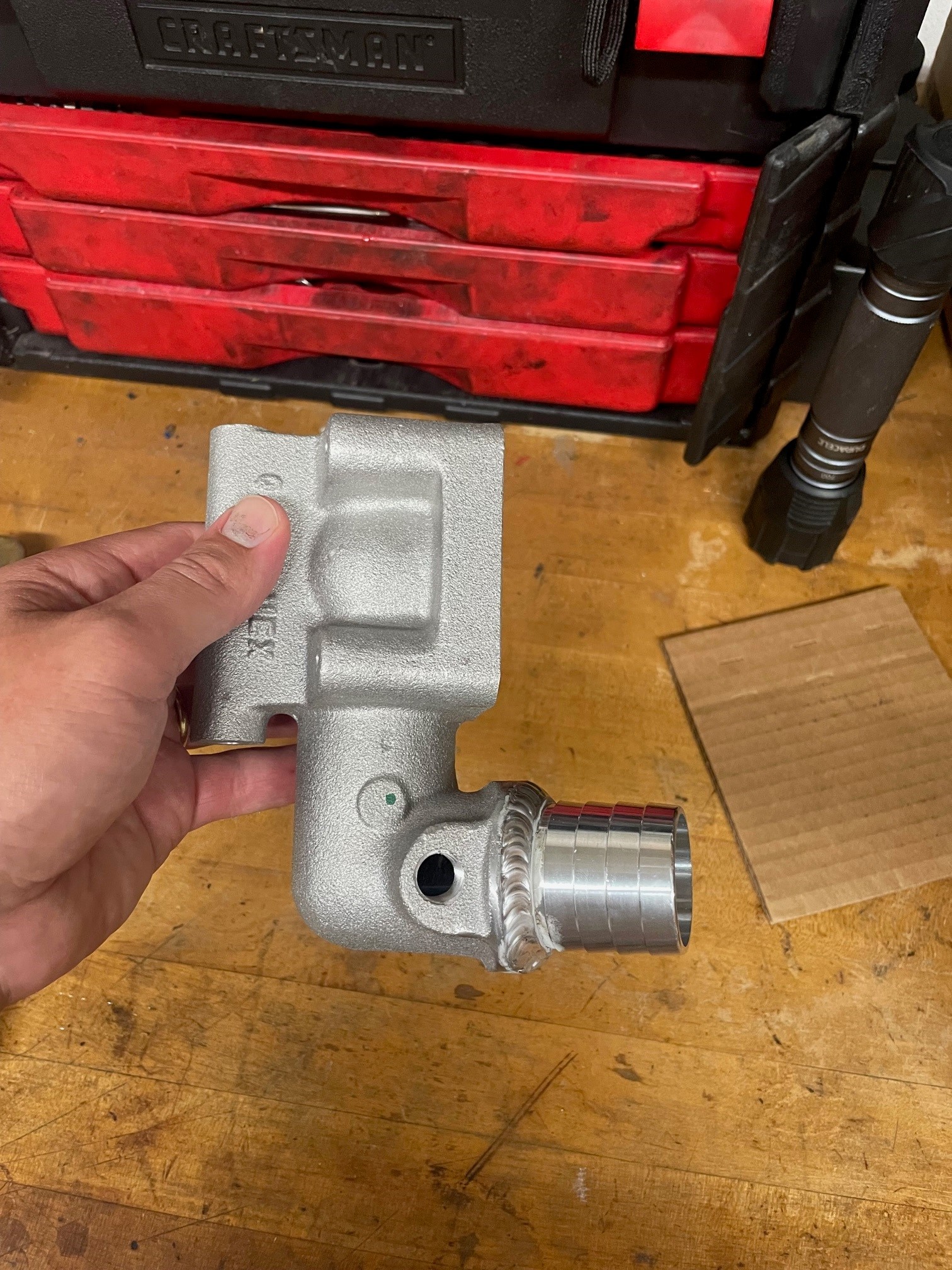

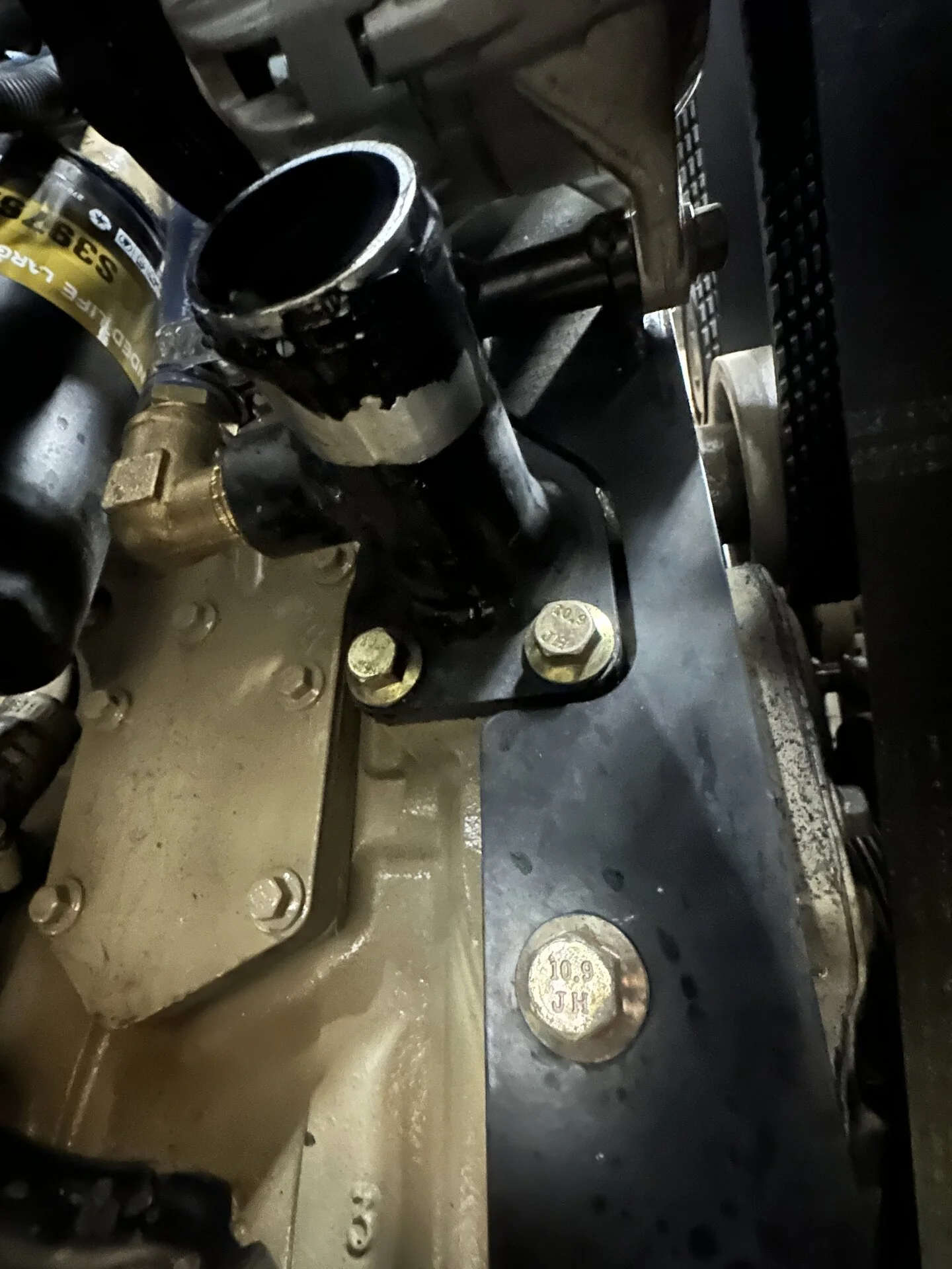

I'm working on my lower radiator hose right now. Radiator hose size is 45mm (1.75") ID and the nipple on the jonesy kit is 1.5". Overall hose lenght is needing to be 20-22" and has two elbows that are perpendicular.
Right now, it's a sloppy splice job for testing. I'm trying to slowly improve the feng shui.
I also realized I didn't have a clean way to drain the coolant, so I'm building a drain in the lower radiator.

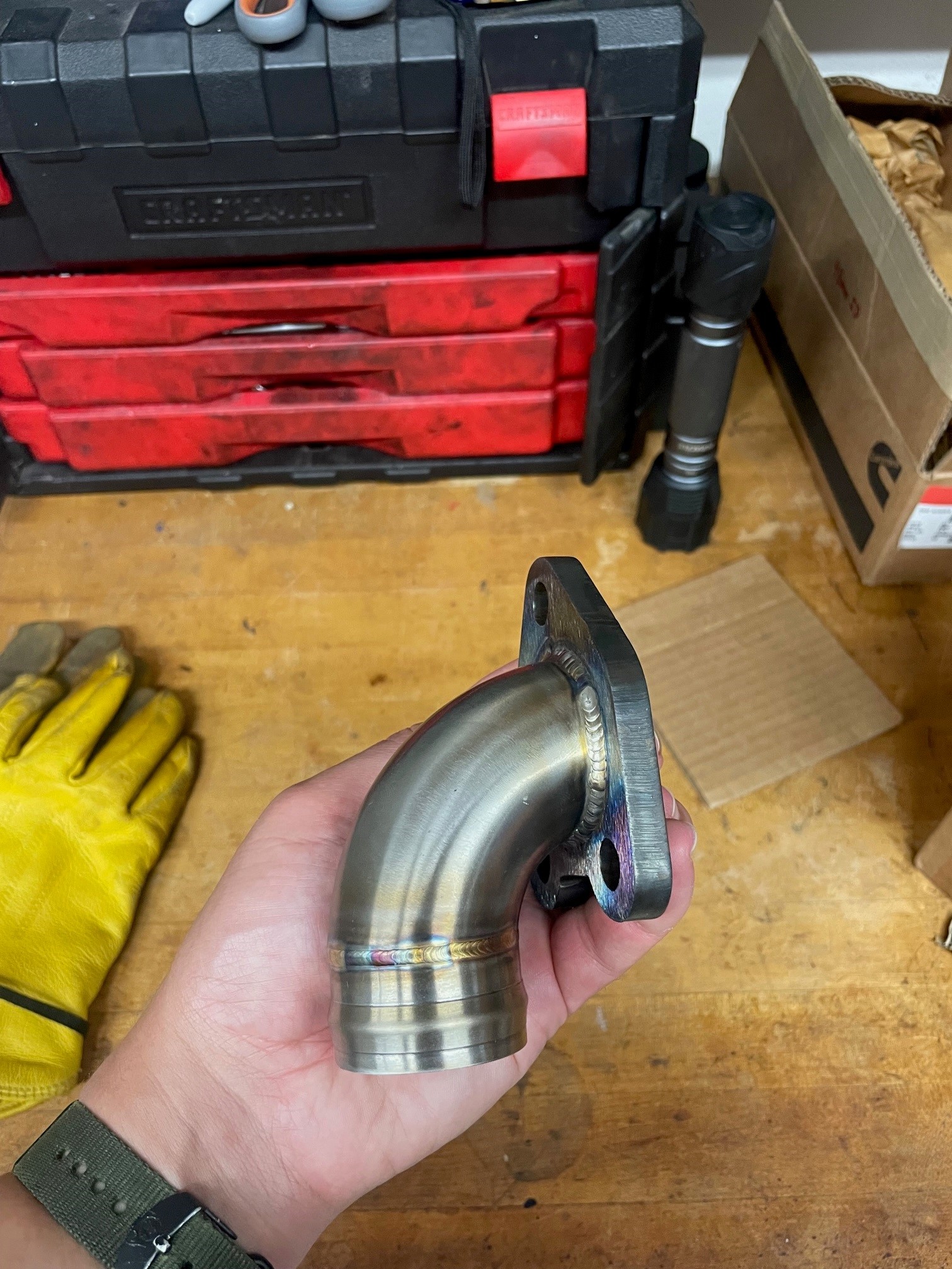

Toyota radiator outlet is 1-5/8" OD (you could probably squeeze 1.5" hose on it).
You need a Cummins lower inlet flange with a 1.5" diameter and a 90° bend.
Then you could use any 1.5" diameter radiator hose with a 90° bend in it.

Thank you for sharing!!!! I'll take all the help I can get. I measured the lower radiator outlet earlier and got 1.75". I just re-measured and you're right it's 1-5/8". Thank you for pointing that out. I also was able to cram a 1.5" hose on it but right now I have a hose that's 1.75" and tapers to 1.5" and the 1.75" end also fits. There's plenty of Gate's hoses that will work as you recommended that have a 1.75" end and then taper to 1.5". For now I'm going to use a splice, but later, I will modify the intake on the motor as you did and then have one hose without a splice. Thats a great idea.

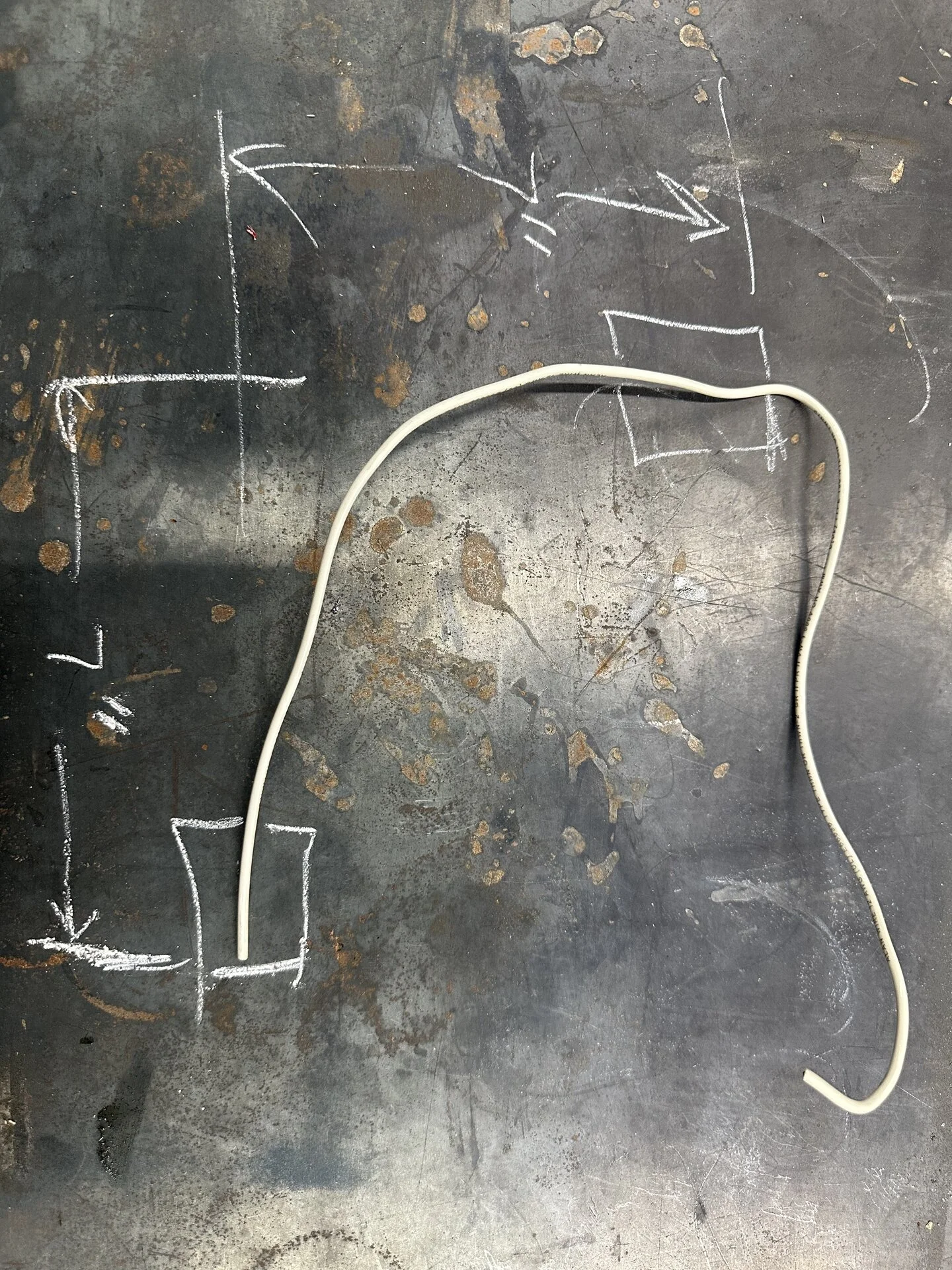

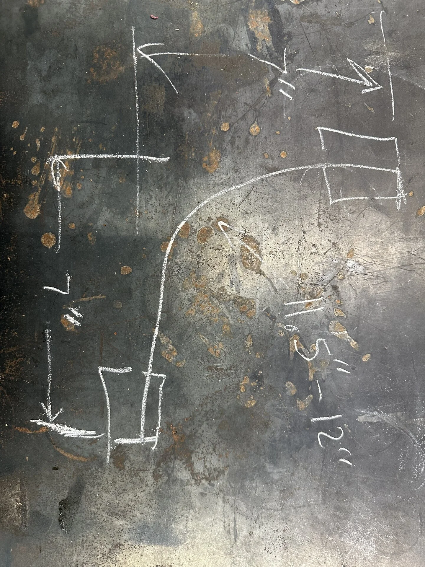

I took a piece of wire and tried to figure the radius. It looks like you need at least a center line lenght of 11-12" and a 7" radius should be sufficient.

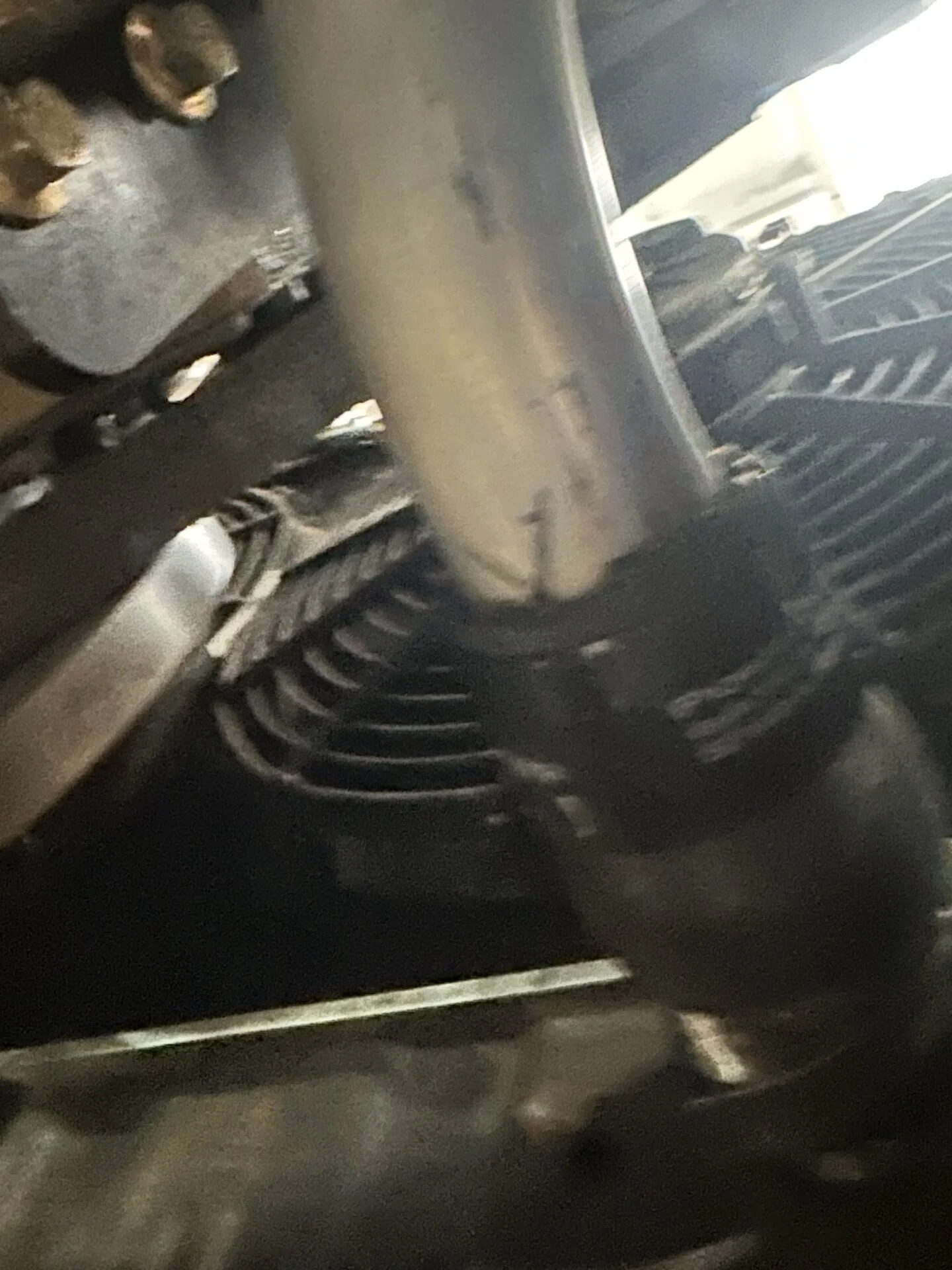

Here's a couple of followup shots of my lower radiator hose. I had a muffler shop put a bend in a piece of 1.5" pipe. I used gates powergrip hose clamps to attach the hose to the pipe. Top hose connection (to the motor) was a 1.5" x 1.5" elbow. The bottom hose connection (to radiator) was 1.5" x 1.75".
Gates Powergrip Hose Clamp - Shrink Clamp: 1 3/4 in – 2 in Clamping Dia, Thermoplastic, 1 1/4 in Band Wd (Grainger)

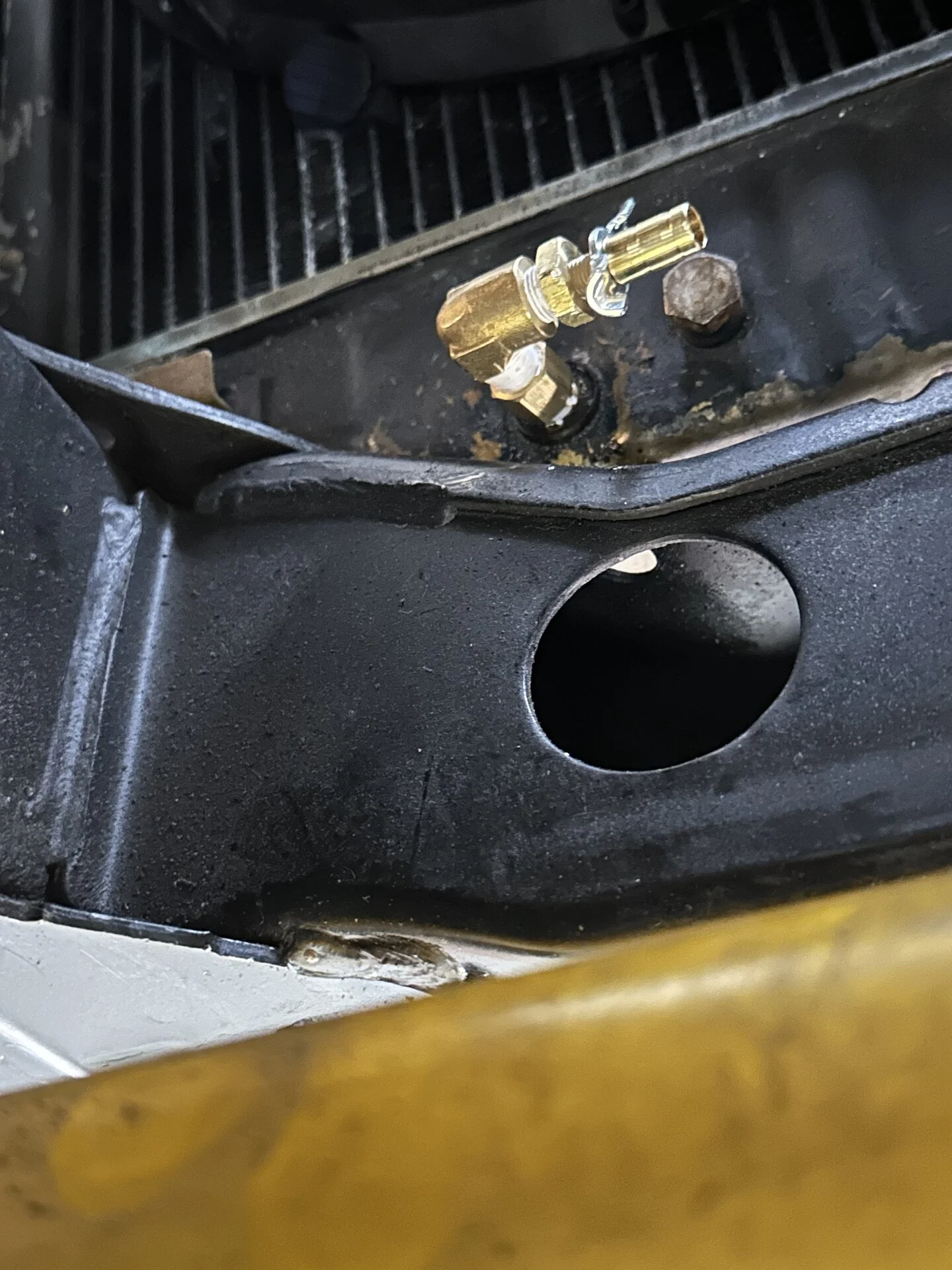

I also put a petcock on the radiator drain.
Specs:
1) Grease Fitting, M10x1.5 mm Male x NPT 1/8Female (McMaster Carr).
2) Drainage Valve with Wing Nut Handle, 1/8 NPT Inlet and Barbed Outlet (McMaster Carr).
3) Brass elbow 1/8 NPT.

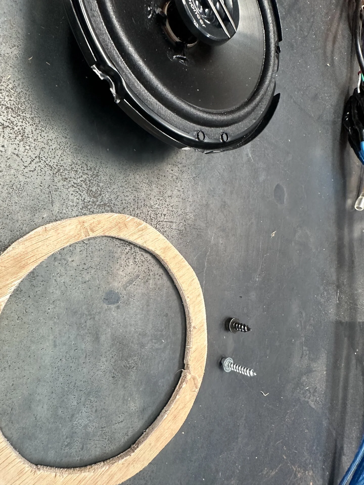

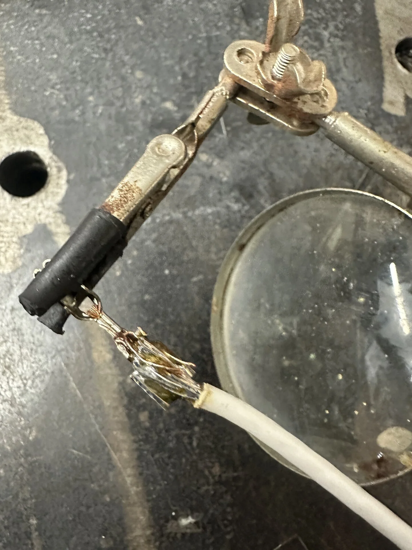

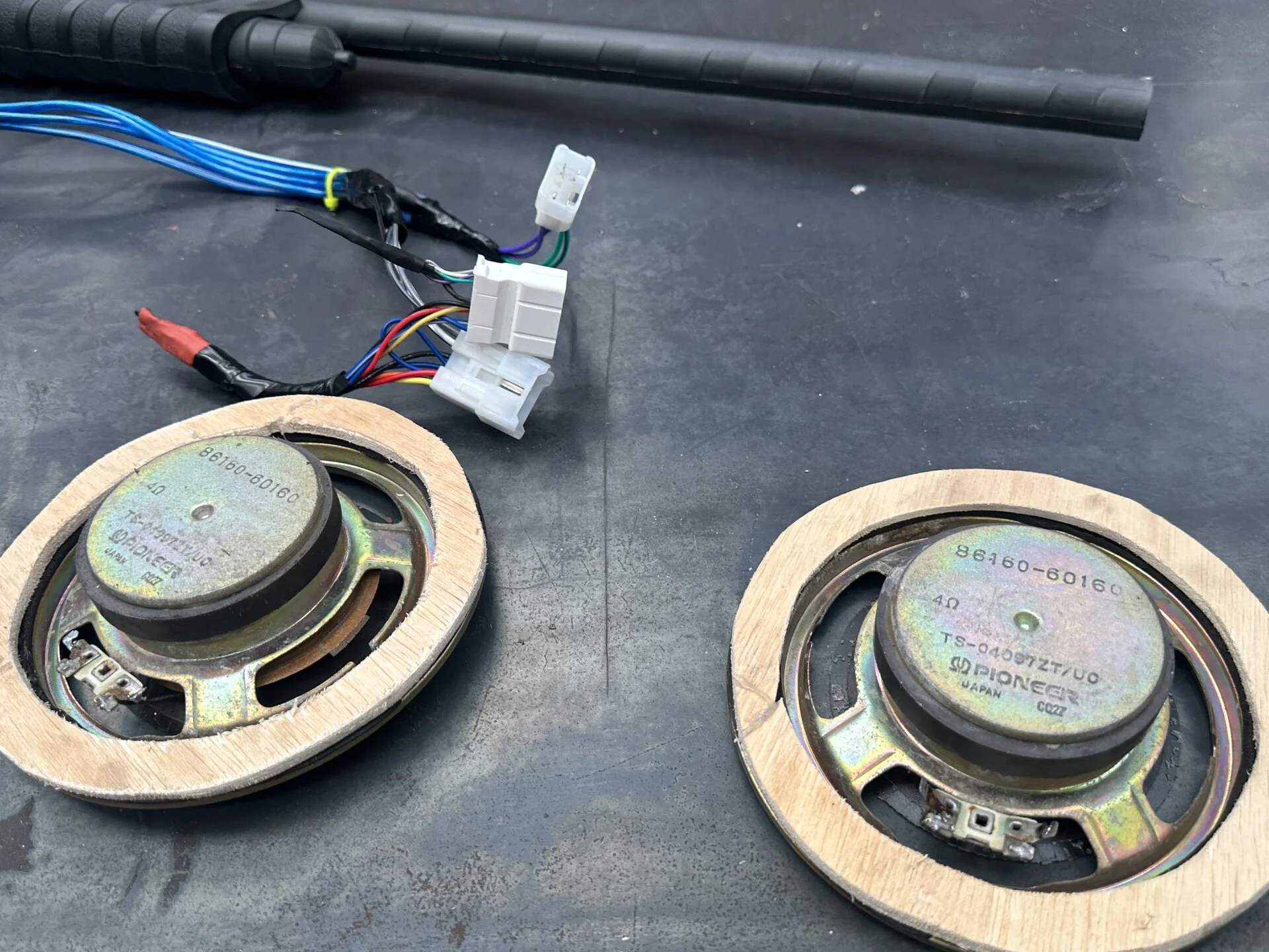

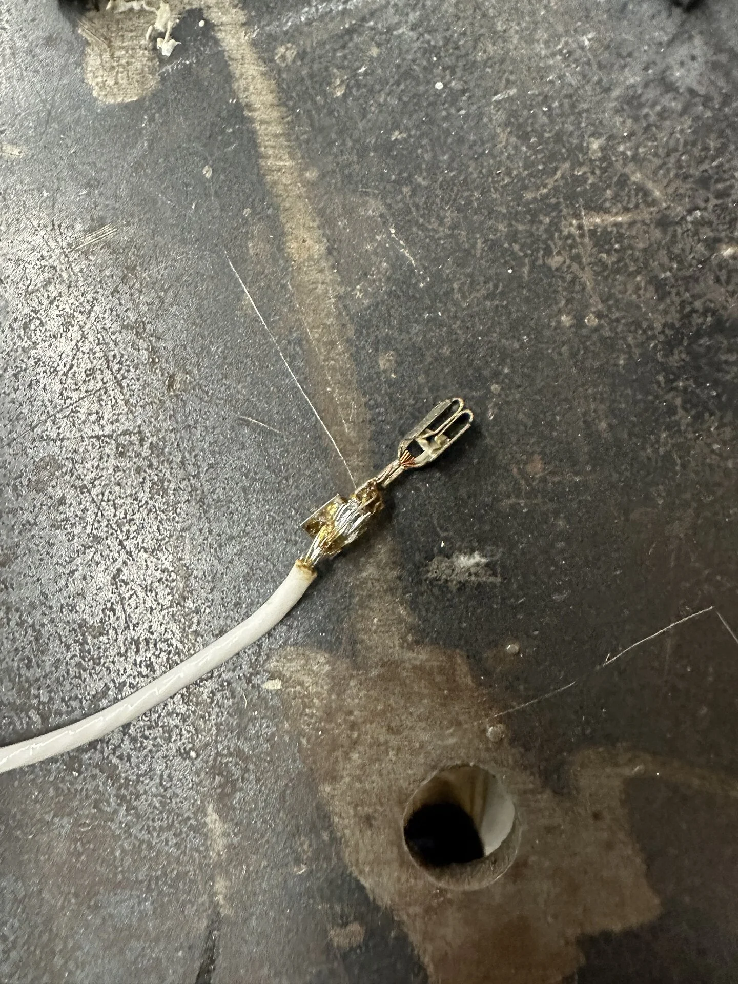

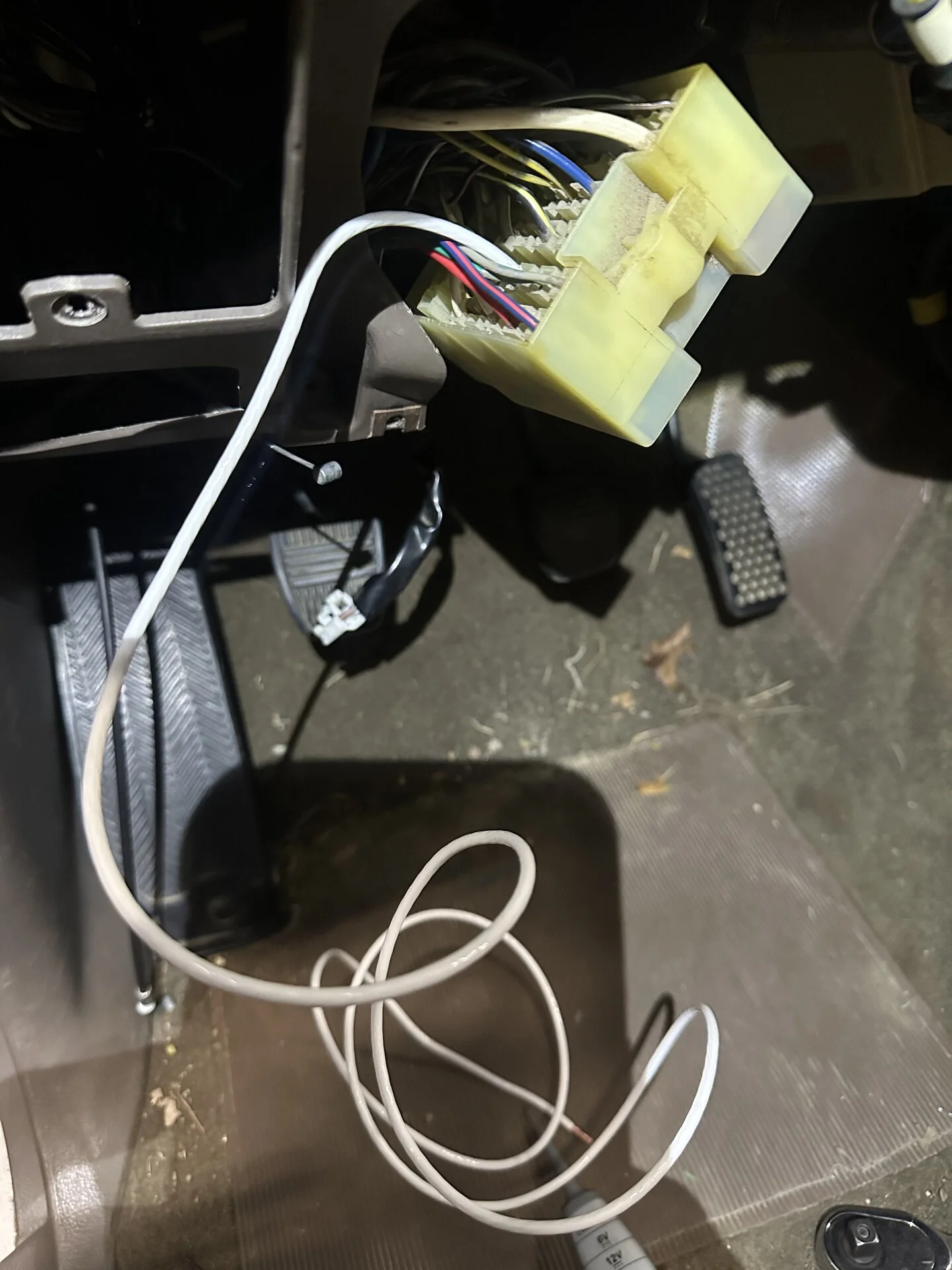

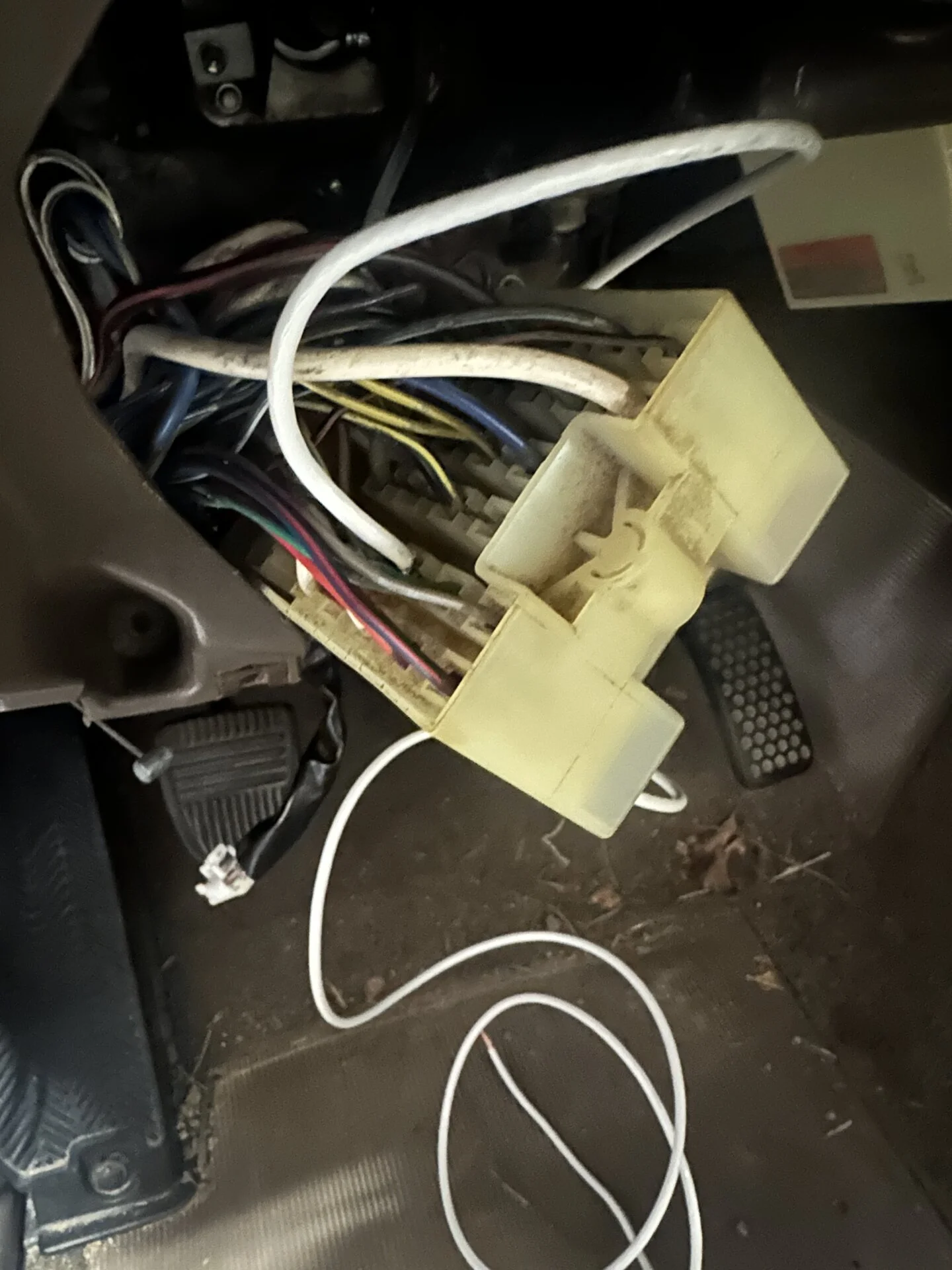

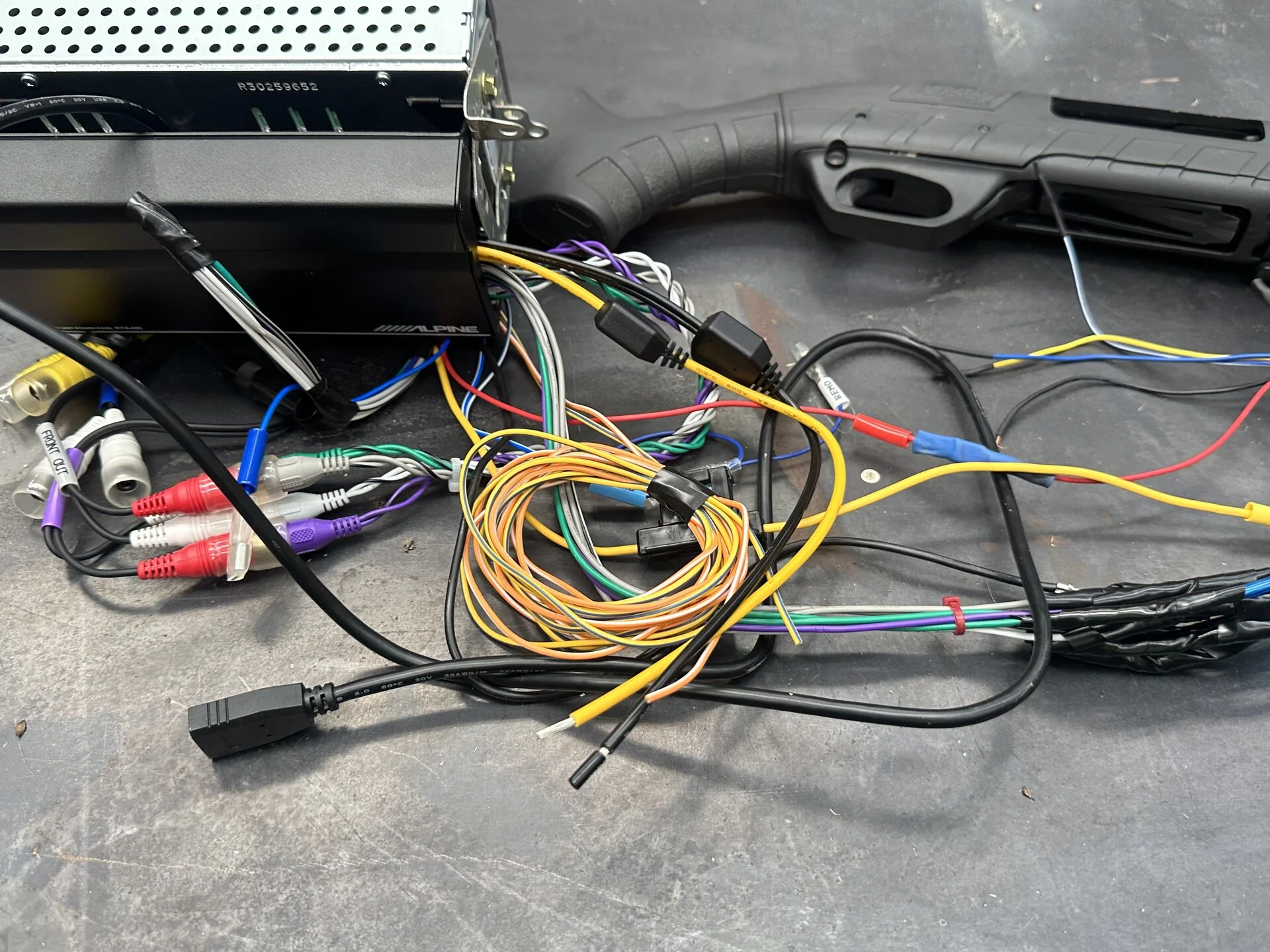

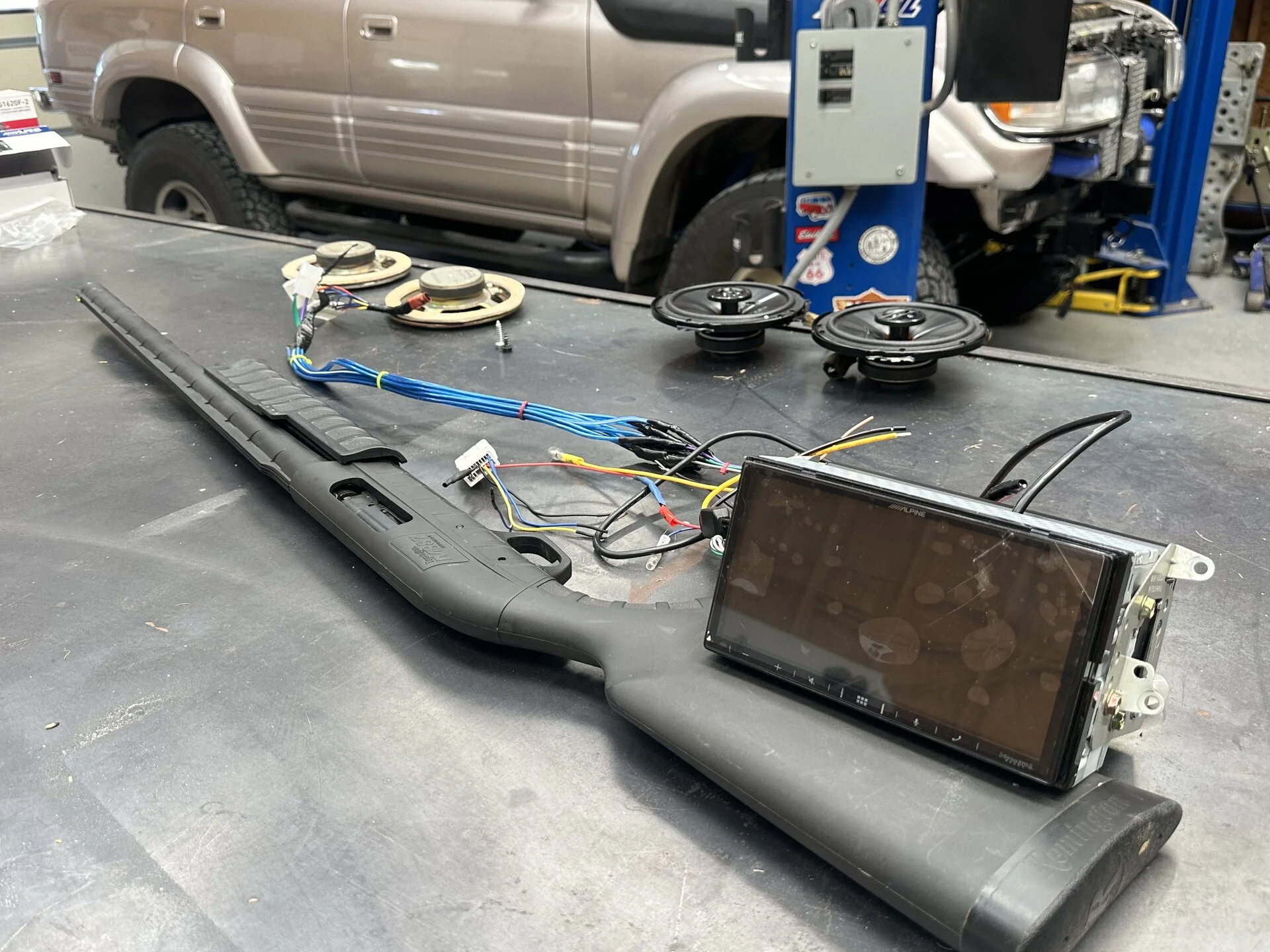

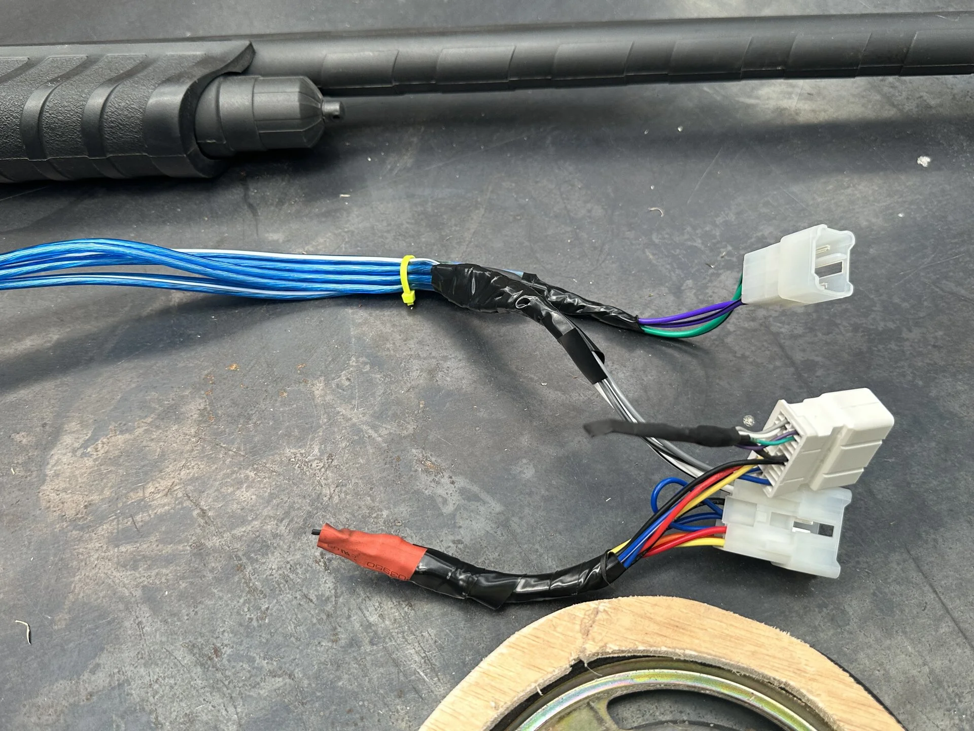

The Alpine and security system are installed (12g is for my boy JD). I used a small Alpine amp with some basic speakers. I'll add some extra speakers later as time allows. For now, I have some tunes and can operate CarPlay.
My OBD circuit was deleted so I tapped into that circuit in my fuse panel to power my radio. For the amp, I ran a circuit off my secondary fuse panel (added near battery).
Factory amp bypass thread: LX450 Stereo wiring - https://forum.ih8mud.com/threads/lx450-stereo-wiring.938277/page-2#post-11533050 by @steve604
