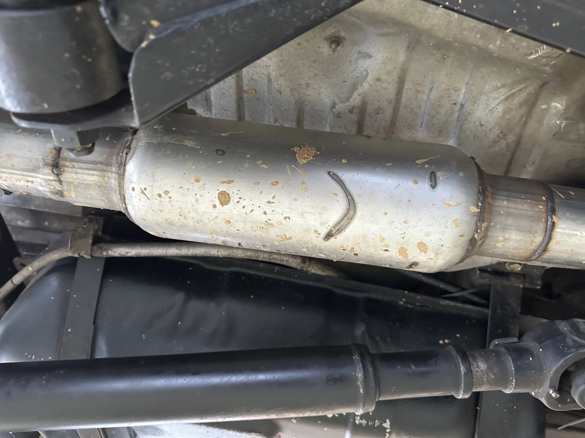

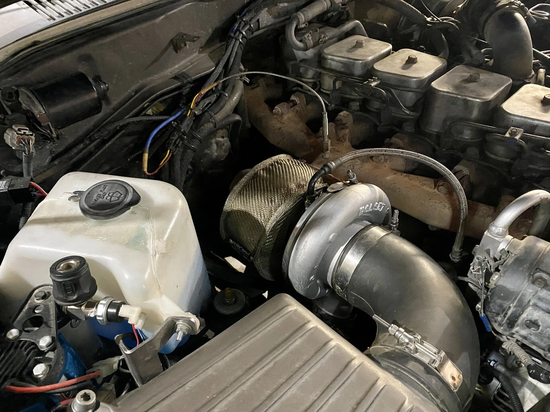

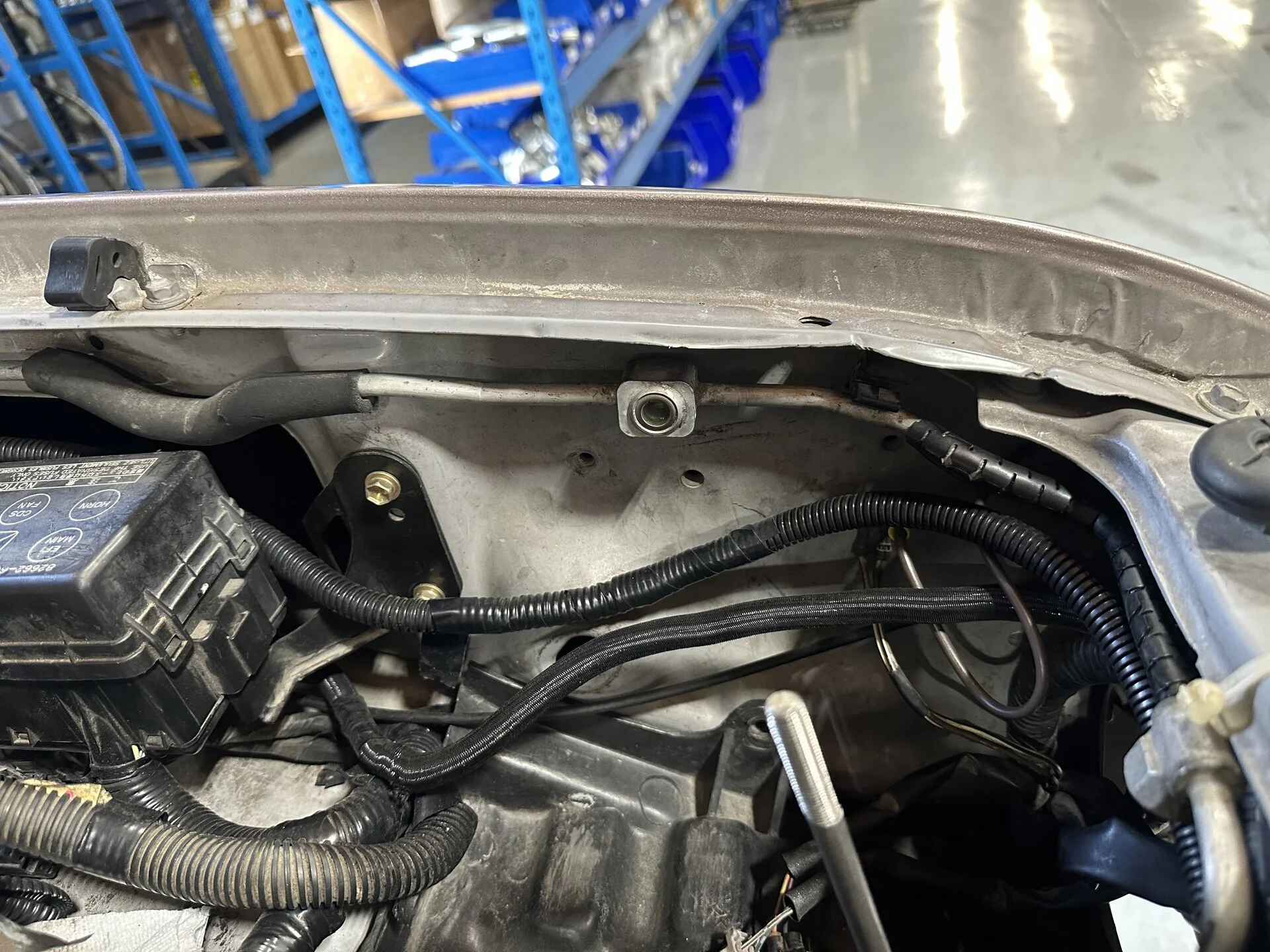

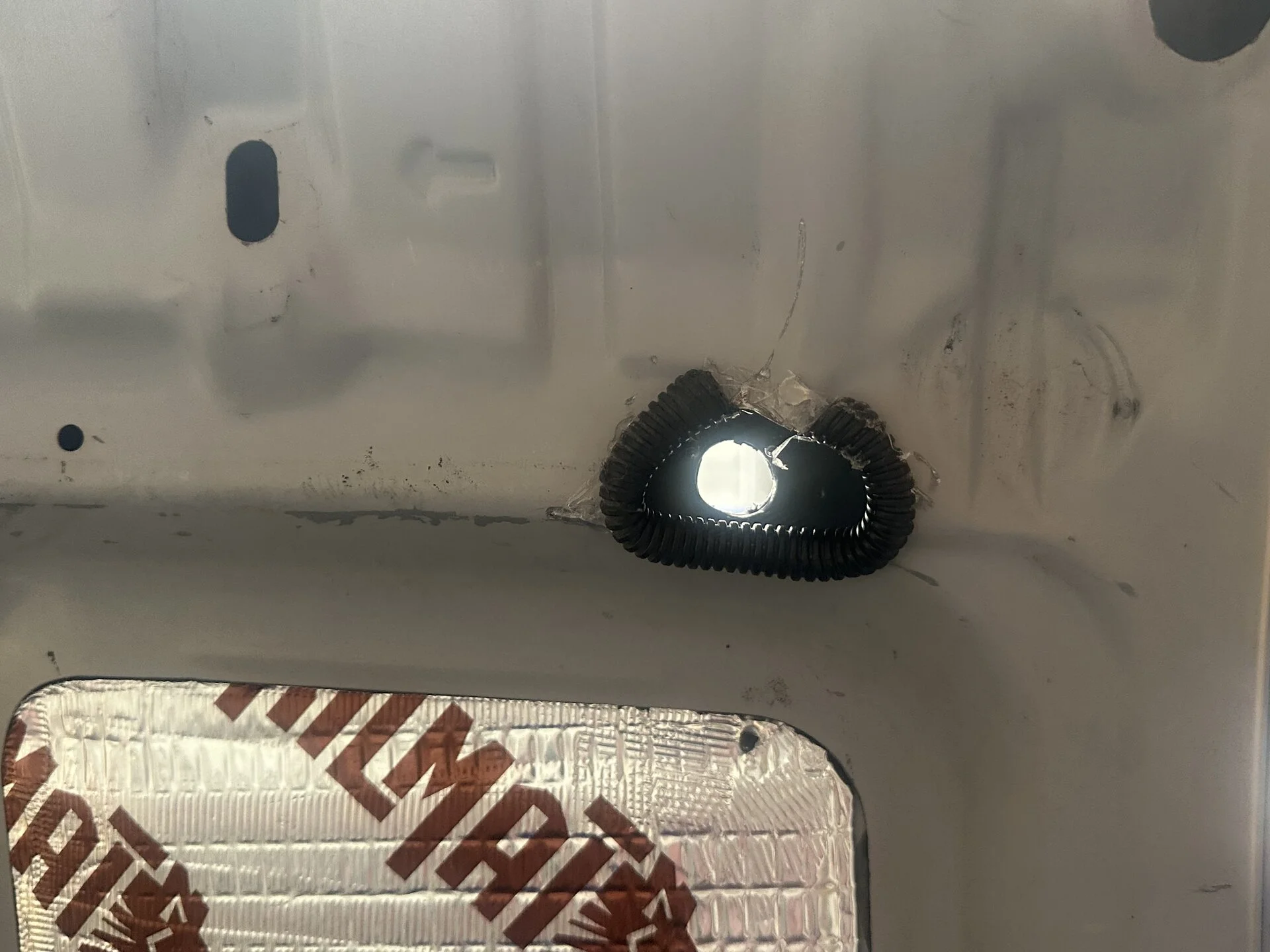

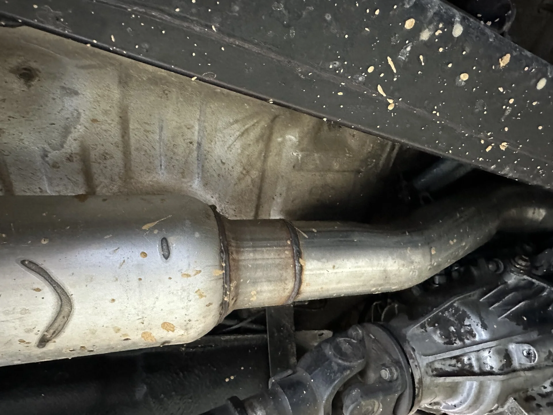

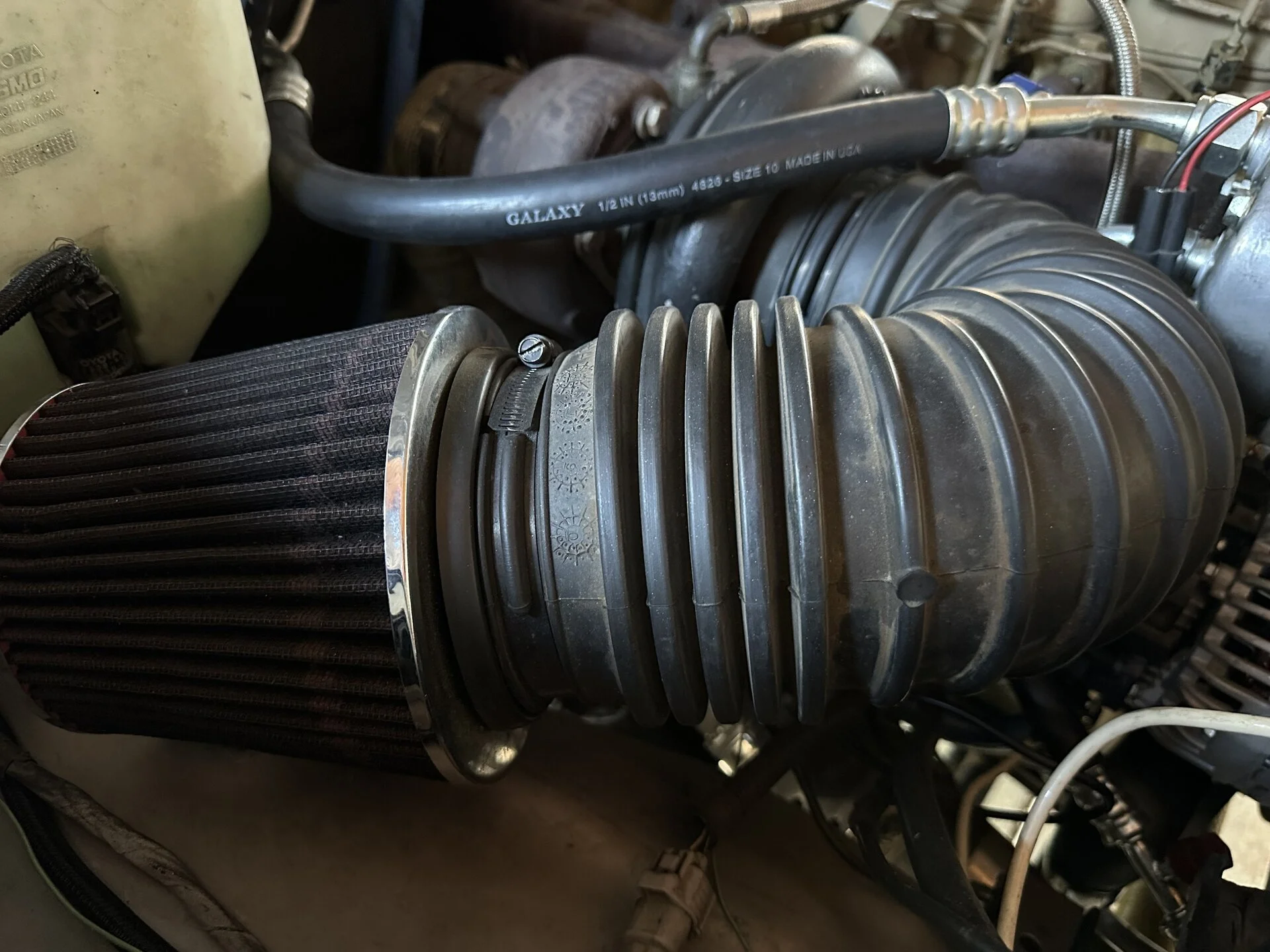

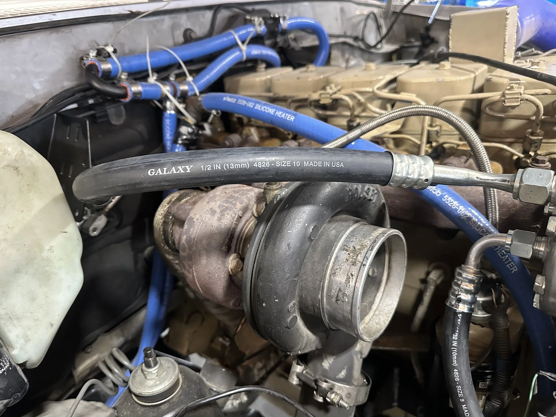

Thank you, Sir! Here's several photos of my exhaust and air intake. I'm running a 3 inch exhaust with a small muffler. For now, I have a KN cone filter and my snorkel is not hooked up. The snorkel has a 3 inch intake and my turbo is 4 inch. I'm planning to build a new snorkel with a 4 inch intake out of carbon fiber along with an air box to use the stock Dodge air filter. I think I removed the ring in the turbo to make it louder.
I also need to adjust my valve lash. I don't know if that might contribute to the sound as well.

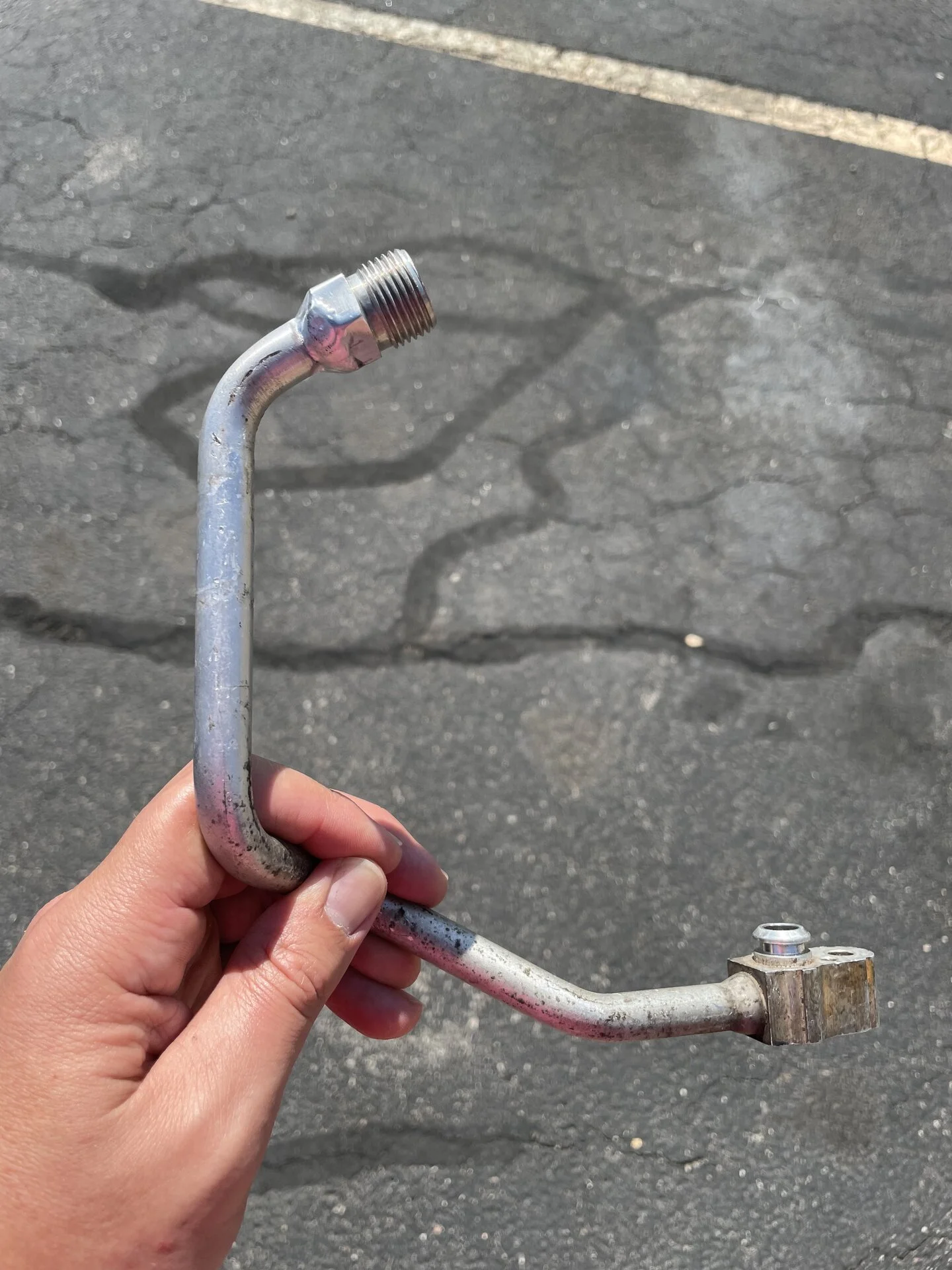

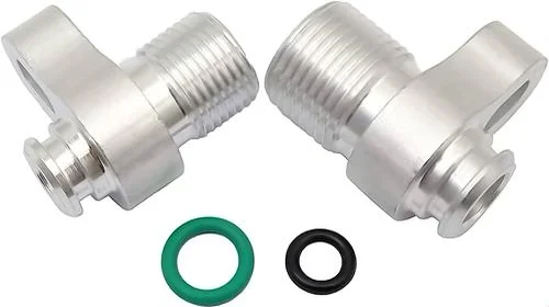

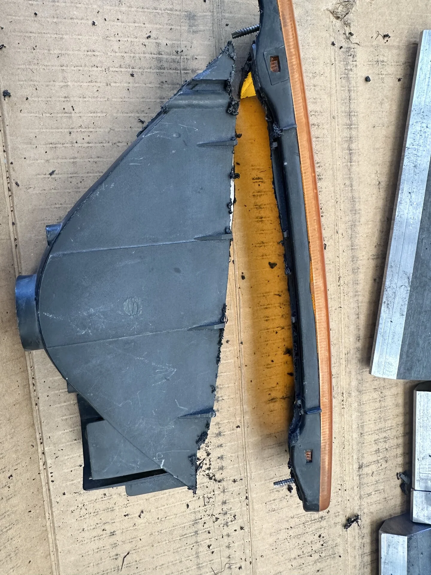

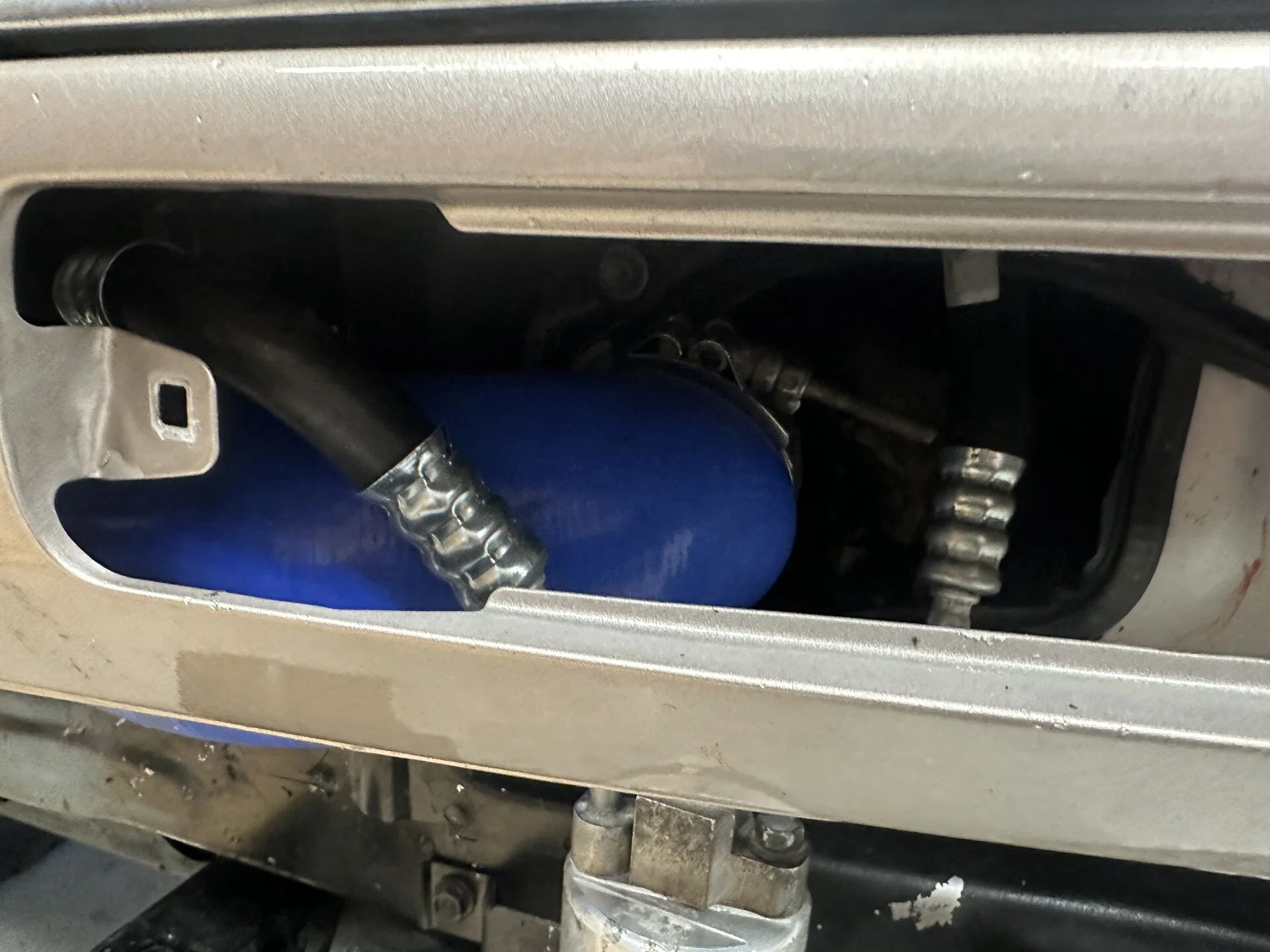

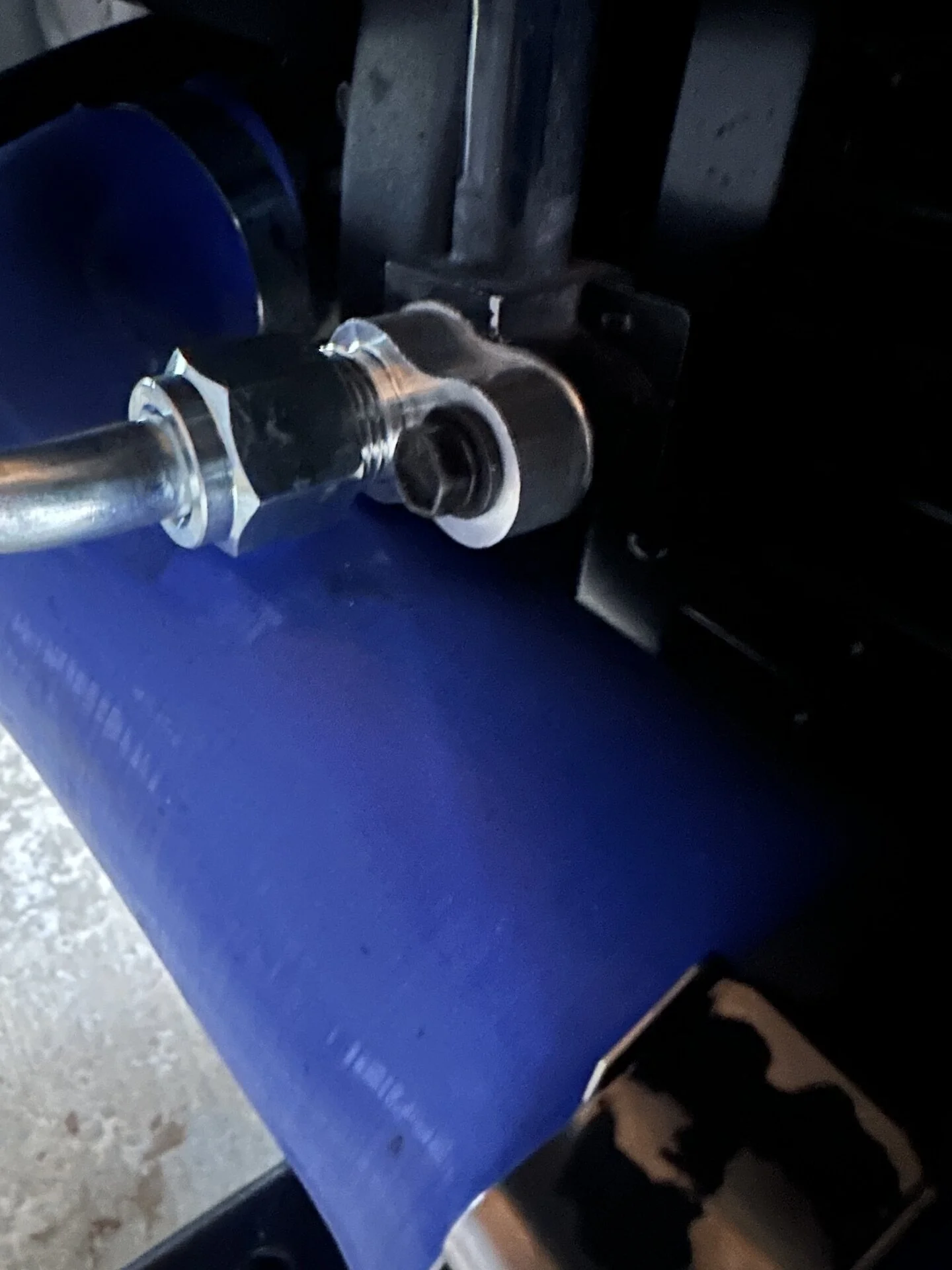

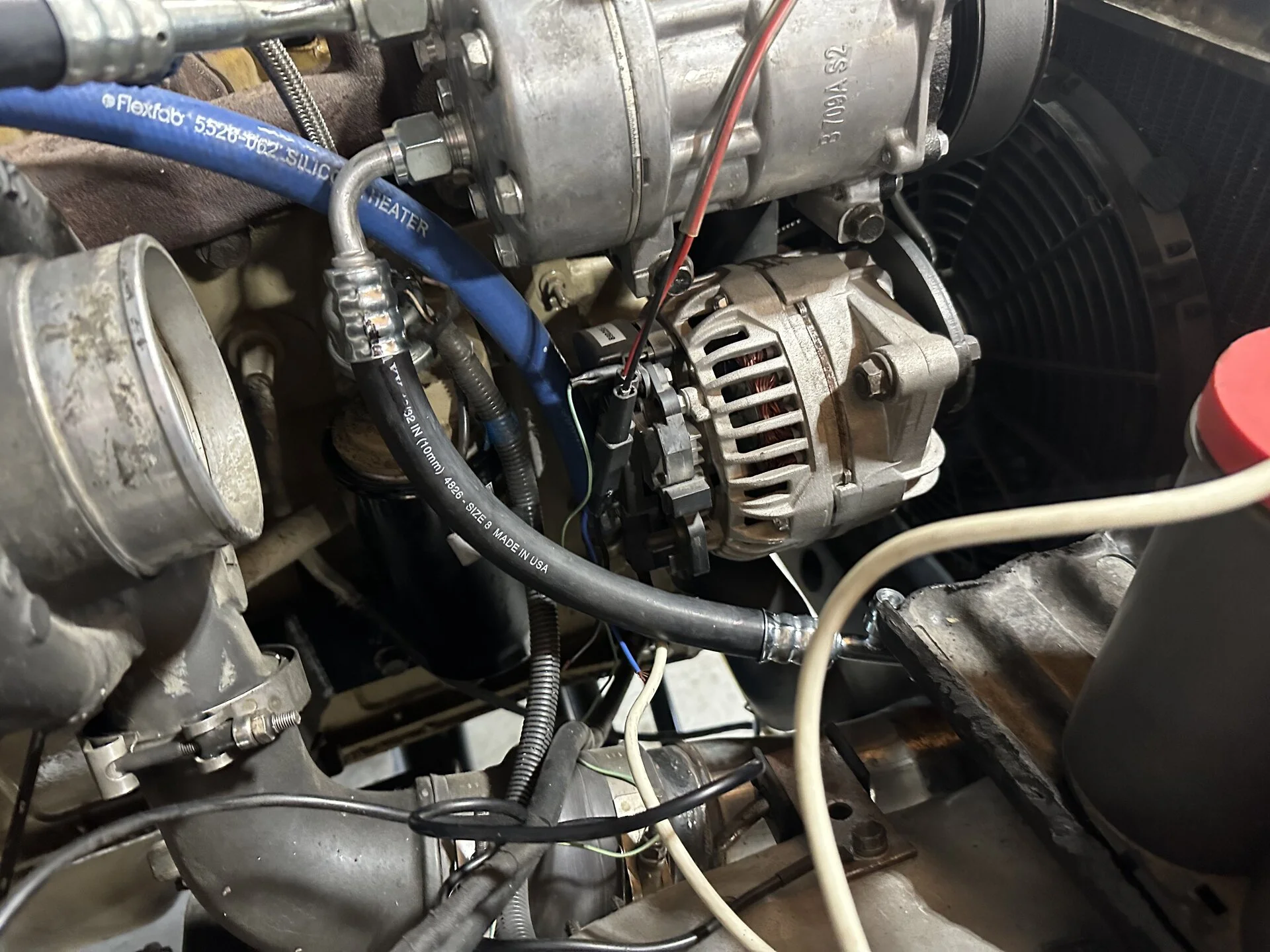

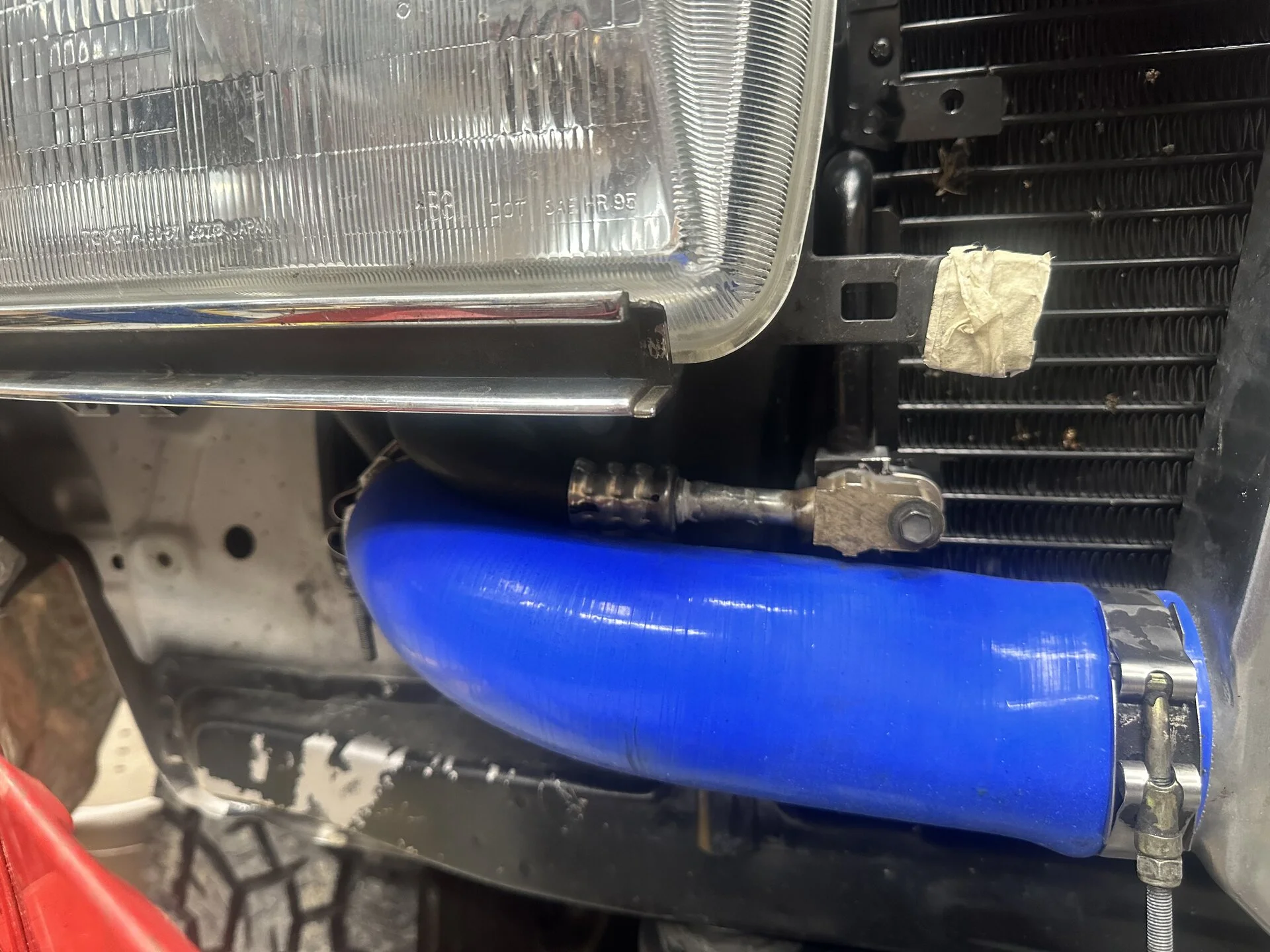

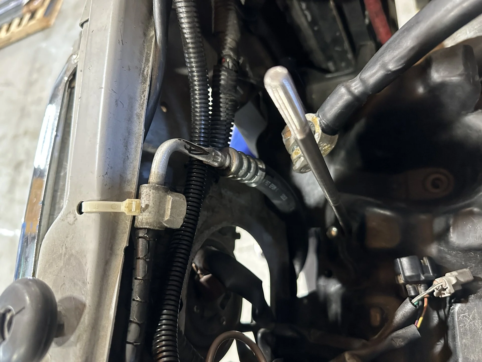

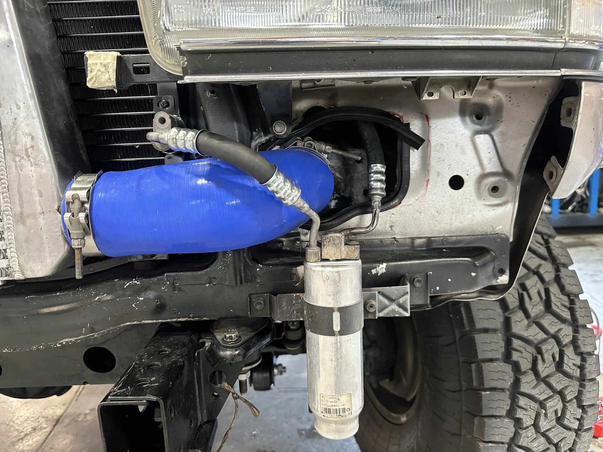

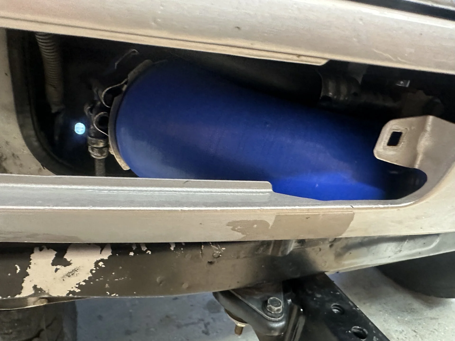

At first I used the AC line adapter on the condenser intake connection but there was clearance issues with the lower grill valance as seen below. The elbow on the AC fitting caused the issue.

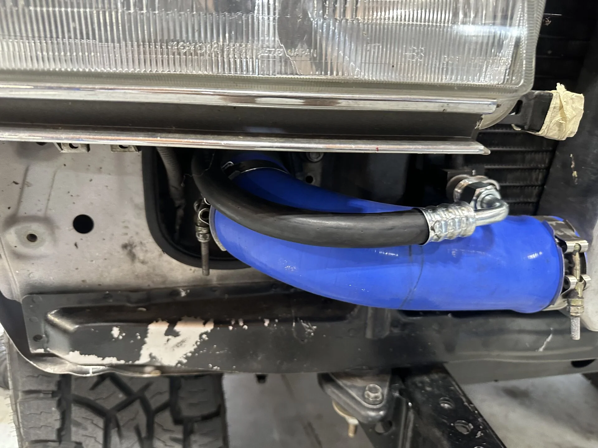

After remembering that @Will Van told me to modify that line, I had the AC shop modify my OEM line as seen below.

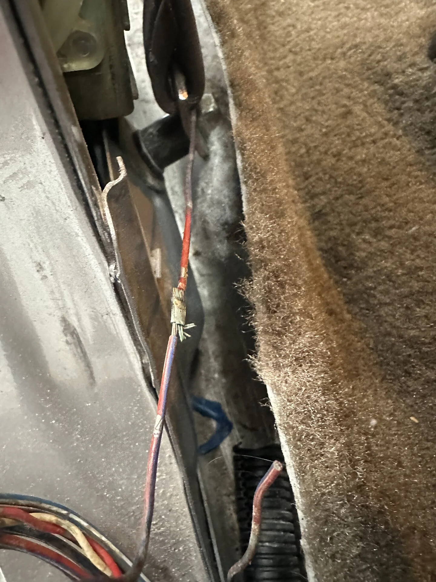

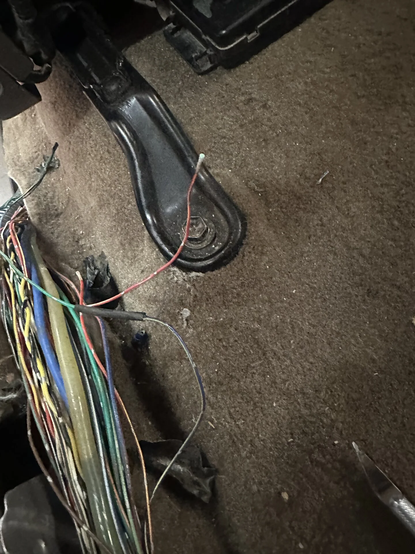

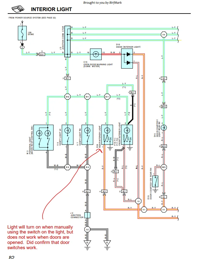

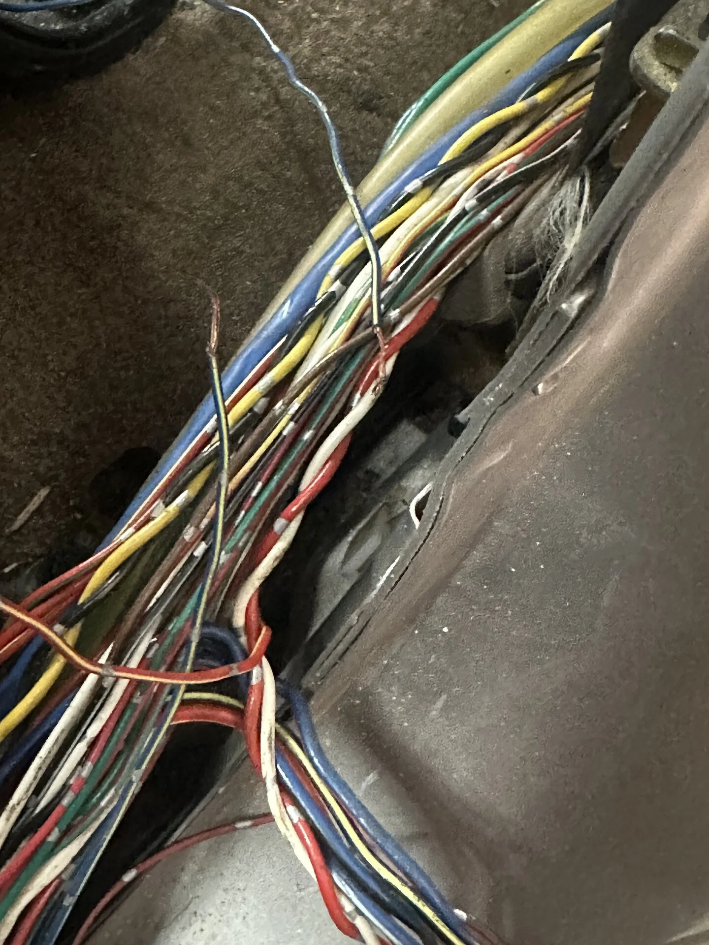

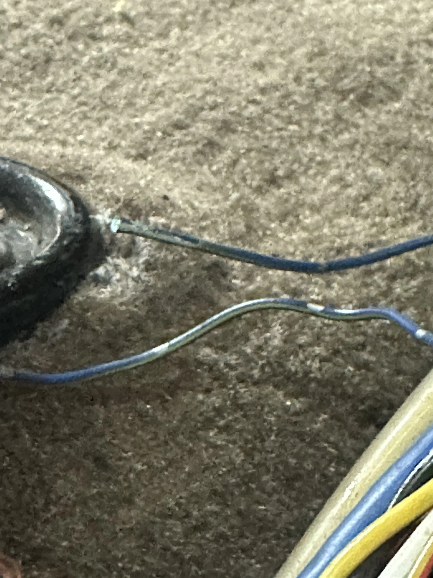

Looking for some advise on chasing down an interior light wiring issue.
  1. The door courtesy light (rear LH) isn't working. I checked for a current and had no power at the light plug nor power at plug BN2 located in the center pillar above the seat belt. Not sure where to check next. Any help would be appreciated.
  2. Rear interior light only comes on when I manual switch it on. The door switches aren't causing it to work when switched to "door". Did verify the door switches are working.
